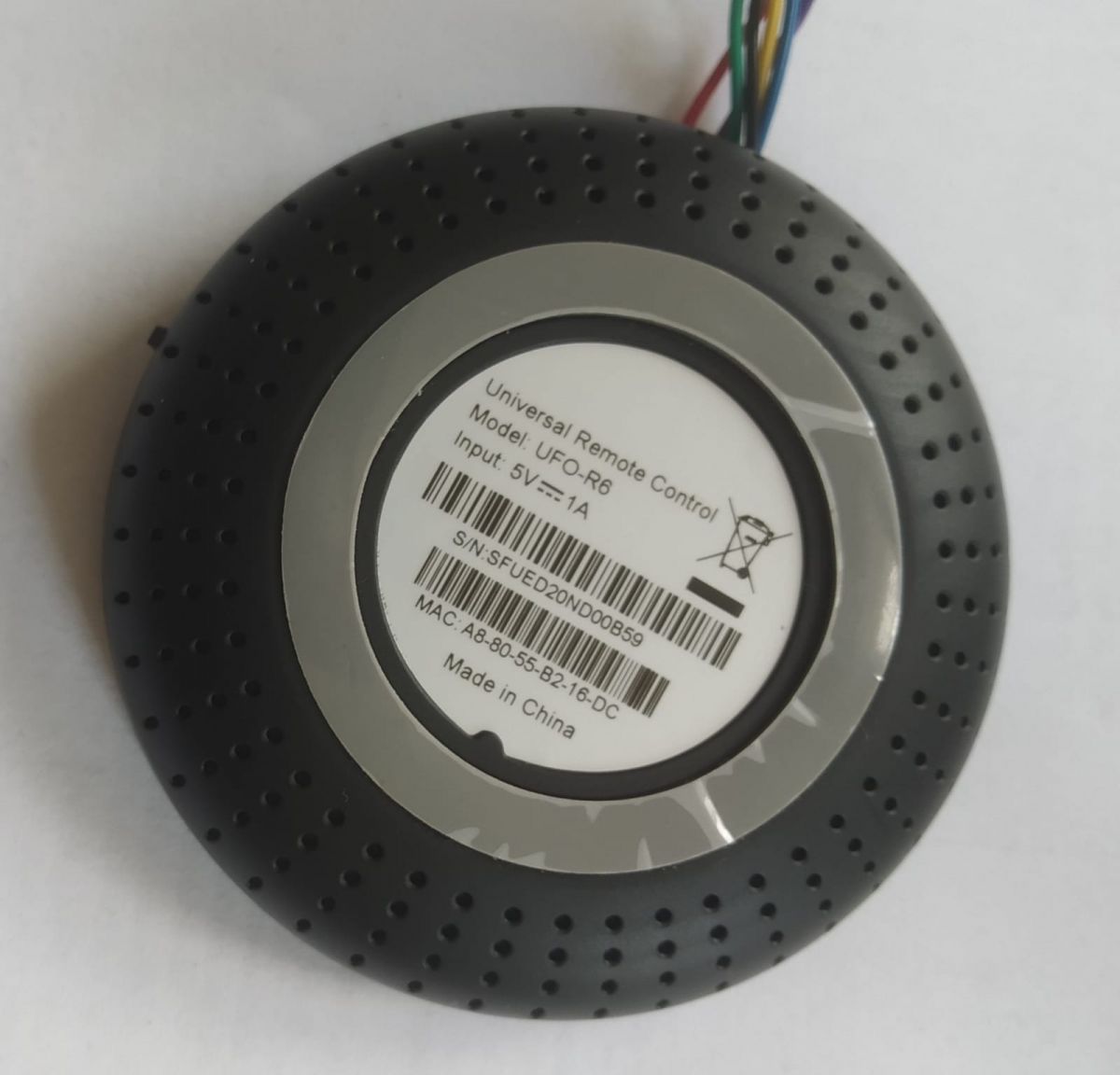

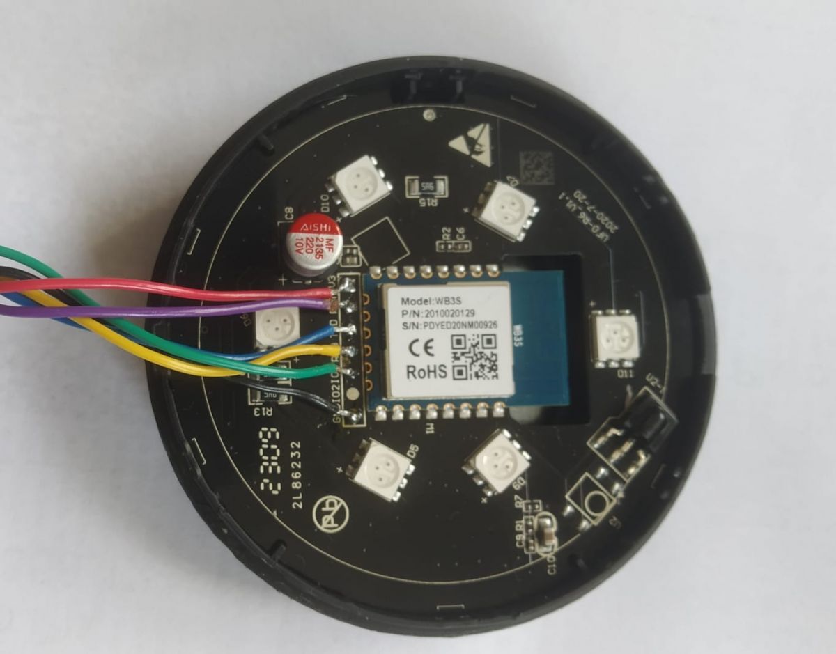

    The device was purchased in China and is very well built.

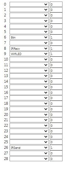

    I found no difficulties in installing the new firmware, and in the photos I include the pin configuration. (Firmware used: openBK7231T_UA_1.17.306.bin)
    But I was very disappointed with the reception behavior of IR codes, especially HVAC codes. I have an LG and a Hitachi, they are long and are not recognized in any way.
    I have a very similar device that uses the TYWE3S chip and installed Tasmota works wonderfully.
    I am interested in supporting the Elektroda project.
    Can anyone comment on where I might be going wrong or when this longer code handling part will be available?
    Thank you very much.

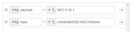

    And this is the code for a simple remote control for an MP3 player, and works OK
    MQTT message configuration in Node-RED.
    MQTT Payload: NEC 0 45 1
    Topic: cmnd/obk55B216DC/IRsend
    Info: MQTT: Publishing val IR_NEC 0x0 0x45 0 to obk55B216DC/ir/get retain=0
    Info: IR: IR MQTT publish IR_NEC 0x0 0x45 0 took 6ms
    Info: MQTT: Publishing val {"IrReceived":{"Protocol":"NEC","Bits":32,"Data":"0xBA45FF00"}} to obk55B216DC/RESULT retain=0
    Info: MQTT: Publishing val IR_NEC 0x0 0x45 1 to obk55B216DC/ir/get retain=0
    Info: IR: IR MQTT publish IR_NEC 0x0 0x45 1 took 4ms
    Info: MQTT: Publishing val {"IrReceived":{"Protocol":"NEC","Bits":0,"Data":"0x0"}} to obk55B216DC/RESULT retain=0

  • #2 20811934
    Posts: 14764
    Rate: 12898
    Hello, are you using development IR build with new codes or the basic one?
  • #3 20811949
    Dinoc
    Hello, thank you for your attention and time.
    I only use the binary that the writer pulled from the web:
  • #4 20813328
    Posts: 14764
    Rate: 12898
    We have a newer IR integration which is in the testing stage. It is not currently merged because its sometimes unstable.
    You can find it here: https://github.com/openshwprojects/OpenBK7231T_App/pull/723
