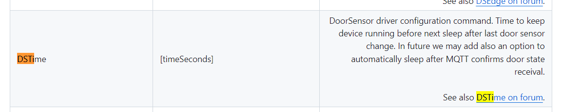

    The battery life of OpenBeken sensors depends strongly on the sensor configuration. In case of non-TuyaMCU devices, you can choose any sleep interval, even the very long one, just to prolong battery life.
    If you are suspecting that there is a WiFi connection issue, you can check whether your MAC address ends with 00 00, that indicates that you have deleted your RF calibration partition.
    I haven't experienced this issue yet, but it might be worth to double check whether your autoexec.bat contains an emergency sleep mechanism or/and change the emergency sleep mechanism in the driver. Something like: "If there is no wifi connection for 30 seconds, then go back to sleep".
    Can you show which script are you currently using on your sensors? Are you using our hardcoded door sensor driver or are you using a custom one written in autoexec.bat script?
    If you are using specifically our DoorSensor driver, have you tried adjusting DSTime setting?
    Configuration of DSTime command for DoorSensor driver.
