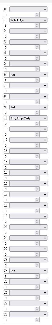

    I have
    "pins": {
    "1": "WifiLED;0",
    Should it be what you posted?
  • #32 20950202
    Posts: 14790
    Rate: 12937
    Well, both WifiLED and WifiLED_n are acceptable, but people usually prefer to have WiFiLED_n set, because it's off when it's connected and people don't like extra distracting light. Still, the final choice is up to you.
  • WiFiLED setting fixes always-on indicator brightness
    #33 20950219
    omniron
    Posts: 114
    Got it, yes, I prefer that too, like Tasmota!
    Good to know, I have some other devices which bother me, they have "flashlight" white LEDs.
    But this is at the (dark at night) entrance, so some guide light is good.
    Now it is quite bright, can I set it so it's just powered by the pullup?

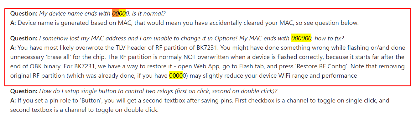

  • Restore BK7231 RF config after MAC loss
    #37 20954290
    Posts: 14790
    Rate: 12937
    I think you'd benefit a lot from reading our FAQ:
    https://github.com/openshwprojects/OpenBK7231T_App/blob/main/docs/faq.md
    Screenshot of the FAQ section related to configuring BK7231T devices with questions and answers about MAC and buttons.
    Question: My device name ends with 00000, is it normal?
    A: Device name is generated based on MAC, that would mean you have accidentally cleared your MAC, so see question below.
    Question: I somehow lost my MAC address and I am unable to change it in Options! My MAC ends with 000000, how to fix?
    A: You have most likely overwrote the TLV header of RF partition of BK7231. You might have done something wrong while flashing or/and done unnecessary 'Erase all' for the chip. The RF partition is normaly NOT overwritten when a device is flashed correctly, because it starts far after the end of OBK binary. For BK7231, we have a way to restore it - open Web App, go to Flash tab, and press 'Restore RF Config'. Note that removing original RF partition (which was already done, if you have 00000) may slightly reduce your device WiFi range and performance

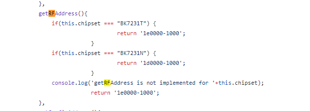

  • RF calibration data starts at offset 0x1000
    #39 20990193
    Posts: 14790
    Rate: 12937
    omniron wrote:
    So I thought that maybe the RF data and MAC can be extracted from the dump I posted?
    RF data can be indeed extracted from a backup file if you have it, but it would require some little manual work, we don't have a tool for that. It could be done even in Linux terminal I think. And indeed, using original RF calibration instead of a stub one is better for your WiFi range.
    I would need to actually check myself what's the offset for that is.
    Hmm
    https://github.com/OpenBekenIOT/webapp/blob/gh-pages/vue/flash.vue
    JavaScript code snippet determining the RF address for different chipsets.
    This is the offset at the binary where you would need to copy a one sector from (0x1000 - 4096 bytes).

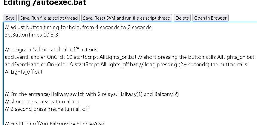

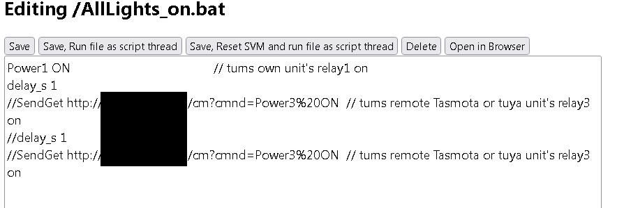

  • Long-press script starts at missing label //
    #40 21064467
    omniron
    Posts: 114
    Hi
    as mentioned here
    https://www.elektroda.com/rtvforum/topic4033215.html#21052330

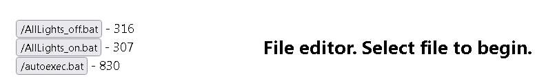

    after flashing to Build on Apr 3 2024 07:20:17 version 1.17.532 my precious autoexec etc files were gone!
    It was a work in progress and I hadn't backed up those files yet.
    "It's a recurring bug due to the OTA file size growing, we will update WebApp to have a warning or something"
    "Autoexec.bat should work, just restore old script and it should be ok."

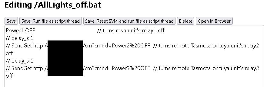

    As mentioned, I cannot even get the simple btn_scriptonly going, what am I doing wrong?
    Attached please find the files I tried to run plus a (cleaned) log.
    I left one channel (pin24) with Btnand that works, the relay switches on and off.
    But the other channel (pin10) with longpress etc and using "Btnscriponly" doesn't work.
    It seems it cannot find "AllLights_off.bat"
    Label // not found in AllLights_off.bat - will go to the start of file
    but then
    Info:CMD:CMD_StartScript: started AllLights_off.bat at label //
    the log:
    Info:GEN:24 Button_OnInitialPressDown
    Info:GEN:24 key_short_press
    Info:MQTT:Channel has changed! Publishing 1 to channel 1
    Info:MQTT:Channel has changed! Publishing 0 to channel 1
    Info:GEN:10 Button_OnInitialPressDown
    Info:GEN:10 Button_OnLongPressHoldStart
    Info:EVENT:EventHandlers_FireEvent: executing command startScript AllLights_off.bat // long pressing (2+ seconds) the button calls AllLights_off.bat
    Info:CMD:Label // not found in AllLights_off.bat - will go to the start of file
    Info:GEN:10 key_short_press
    Info:EVENT:EventHandlers_FireEvent: executing command startScript AllLights_on.bat // short pressing the button calls AllLights_on.bat
    Info:CMD:Label // not found in AllLights_on.bat - will go to the start of file
    Info:CMD:CMD_StartScript: started AllLights_on.bat at label //

12. Why does a BK7231T device show a MAC address ending in 00:00:00 after flashing, and how do I restore the RF config or original MAC behavior?
That MAC usually means the RF configuration area was overwritten. The FAQ quoted in the thread says the TLV header of the RF partition was likely cleared, often by incorrect flashing or an unnecessary erase. The built-in recovery path is the Web App’s Restore RF Config, but it restores a usable config, not necessarily the factory-original MAC. [#20954290]
13. What is the RF partition or TLV header on BK7231, and why can erasing it reduce Wi-Fi range or break the MAC address?
"RF partition" is a flash area that stores radio calibration and identity data, including the TLV header that controls MAC-related settings and Wi‑Fi tuning. If you erase it, the device can lose its original MAC behavior, and the thread warns that replacing it with a stub can slightly reduce Wi‑Fi range and performance. [#20954290]
14. How should the blue LED on pin P1/RXD2 be configured in the Xenon SM-PW801-U2 template, and when should I use WifiLED versus WifiLED_n?
The final template mapped P1 to WifiLED_n;1. The maintainer later confirmed that both WifiLED and WifiLED_n are acceptable, but many users prefer WifiLED_n because the light stays off when Wi‑Fi is connected. The completed Xenon SM-PW801-U2 template also kept relays on P6 and P9, with buttons on P24 and P10. [#20950196]
15. Why do BtnScriptOnly events in OpenBeken start AllLights_on.bat or AllLights_off.bat but appear not to run the script, and what does "Label // not found" actually mean?
The event system did start the script, but it did not find a label named //. The log explicitly says Label // not found ... will go to the start of file, then confirms started AllLights_off.bat at label //. So BtnScriptOnly was firing on pin 10, but the thread does not show a final fix for why the script body still produced no visible action. [#21064467]
