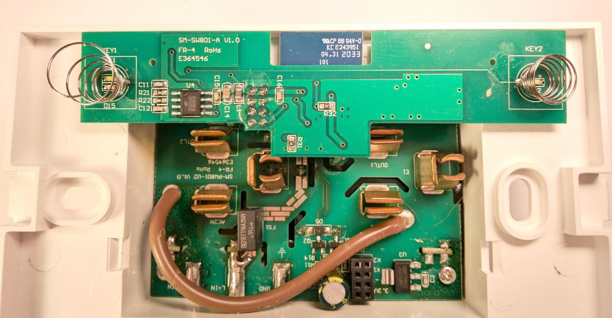

How can I flash this Xenon SM-PW801-U2 outlet over OTA when the WB3S CEN pin is tied to VCC?
OTA flashing is only possible after someone has first dumped the full 2 MB flash and created a profile for the device; otherwise, the recommended path is UART/wired flashing [#20818301] For this outlet, the later recommendation was to use the Xenon SM-PW801-US Wall Outlet profile, and a Wi‑Fi flashing guide was provided for flashing without soldering wires [#20828299] If you do use UART, the thread says CEN is not required: connect GND, RX, TX and 3.3 V, start the flasher, then momentarily disconnect/reconnect 3.3 V to make the flasher get bus [#20819236]
  • WB3s CEN hardwired to VCC blocks OTA flashing

    Anybody know how to flash this OTA?
    WB3's CEN is hardwired to VCC

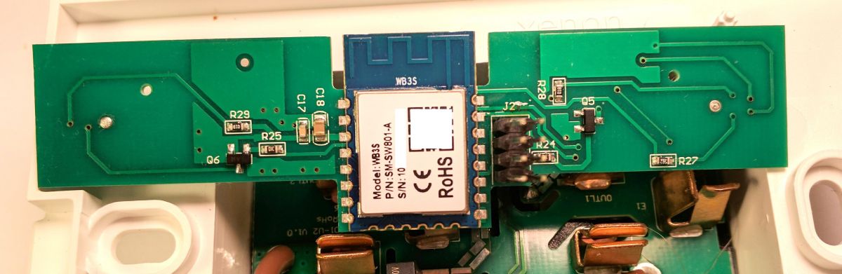

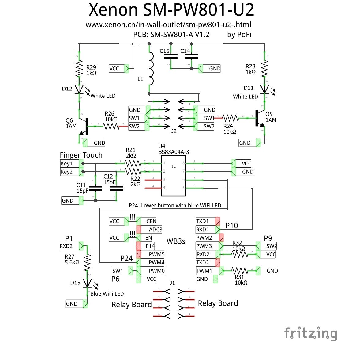

    I tried that, but as you can see in the schematic I drew, both CEN and EN are tied to VCC.
    Couldn't get the reader Program start/synch.
    And I cannot solder this small, can only flash OTA unfortunately.

    You can do the reset without CEN.
    Just:
    1. connect common GND, RX and TX and 3.3V
    2. start flasher tool
    3. disconnect 3.3V (you can also connect 3.3V from the BK7231 side to GND for a second, just remember, the BK7231 side, not the power supply one! That would make a short circuit!)
    4. reconnec that 3.3V from BK7231 to 3.3V from power supply
    The flasher should "get bus" correctly. I've tested it many times.
    These days I do not even use CEN/EN for flashing.

  • Serial boot log shows BK7231S firmware, OTA still blocked

    I think you may be using wrong port.
    TXD2/RXD2 is debug log output, here you can read that log.
    TXD1/RXD1 is flashing port.
    Are you using TXD1/RXD1 for flashing?

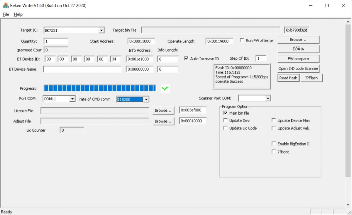

    Can you try with bkWriter 1.60, just make sure to first read 2MB of device flash, to get a 2MB file that I can extract GPIO from?
  • #11 20827024
    omniron
    Posts: 114
    this is the result, it's just 1Mb, don't know how to make it read 2MB.
    I read twice, to make sure I got the right thing.
    Thanks
    • bk_writer1.60.bk7231s_dump.01.zip (934.22 KB) You must be logged in to download this attachment.
  • #12 20827028
    Posts: 14790
    Rate: 12937
    You need to enter 0x200000 in read lenght
  • #13 20827057
    omniron
    Posts: 114
    User interface of Beken Writer V1.60 software used for programming microcontrollers.
    It was all default, I don't see read lenght, are you talking about "Operate Length"?

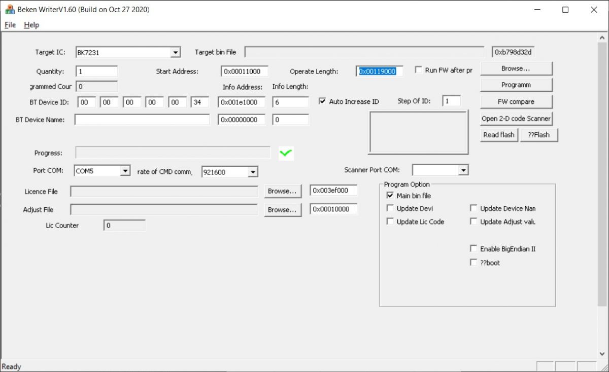

    What about "Start Address"?
    Screenshot of Beken Writer V1.60 software with various configuration settings for a device.
  • #14 20827066
    Posts: 14790
    Rate: 12937
    Do not change start address, it will wrap, but it will be okay. Just set operate length to 2 megabytes. Then if you provide flash 2MB dump here, I can try to decode GPIO config for that.

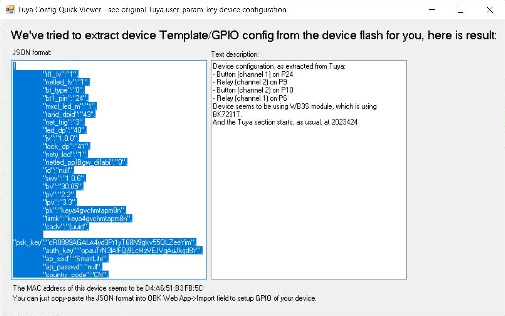

  • Tuya config extracted from WB3S at offset 1953792
    #16 20827147
    Posts: 14790
    Rate: 12937
    The following read is correct. Good job!
    Extracted GPIO (it seems NETLEd failed to extract):
    - Button (channel 1) on P24
    - Relay (channel 2) on P9
    - Button (channel 2) on P10
    - Relay (channel 1) on P6
    Device seems to be using WB3S module, which is using BK7231T.
    And the Tuya section starts at UNCOMMON POSITION 1953792
    Now you can flash OBK...

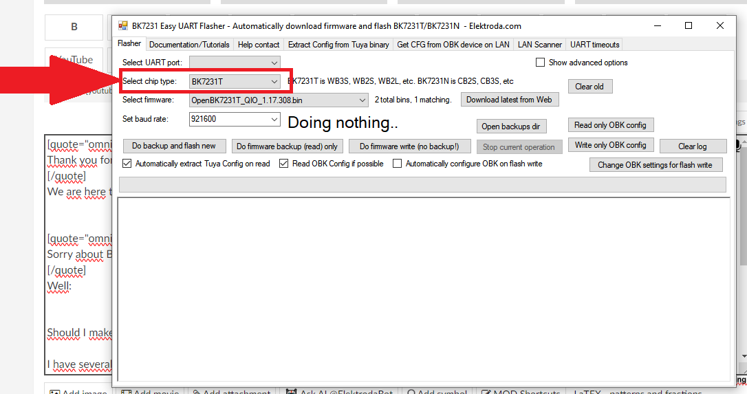

    @omniron btw I also noticed now why previously flash read failed. You used BK7231N mode to read BK7231T... no wonder that it didnt work.
  • Need BK7231N mode setting for OTA flashing
    #17 20827155
    omniron
    Posts: 114
    Super!
    Finally.
    Thank you for your patience, I was going to drop that days ago.
    Sorry about BK7231N mode vs BK7231T, don't know where to set that??

    Thanks
    Yes, I noted WB3s in the schematic above
    https://www.elektroda.com/rtvforum/topic4015180.html#20818224
    We are here to help, don't give up, just ask on our forum
    Well:
    Screenshot of BK7231 Easy UART Flasher with the chip type selection option highlighted.
    omniron wrote:
    Should I make another read just to make sure?
    The created binary is 100% correct, there is no need for that.

    I hooked up the unit again and tested it with the other flash program and it worked as you said, mostly probably because of the swapped serial ports, right?
    Screenshot of Tuya Config Quick Viewer showing device configuration in JSON format and GPIO section description.
    I'm going to hook up the other units (with serial #1) especially this one:
    https://www.elektroda.com/rtvforum/topic3958242.html#20803474
    thanks

    It's not just about template, we need 2MB dump to flash next pieces by OTA.

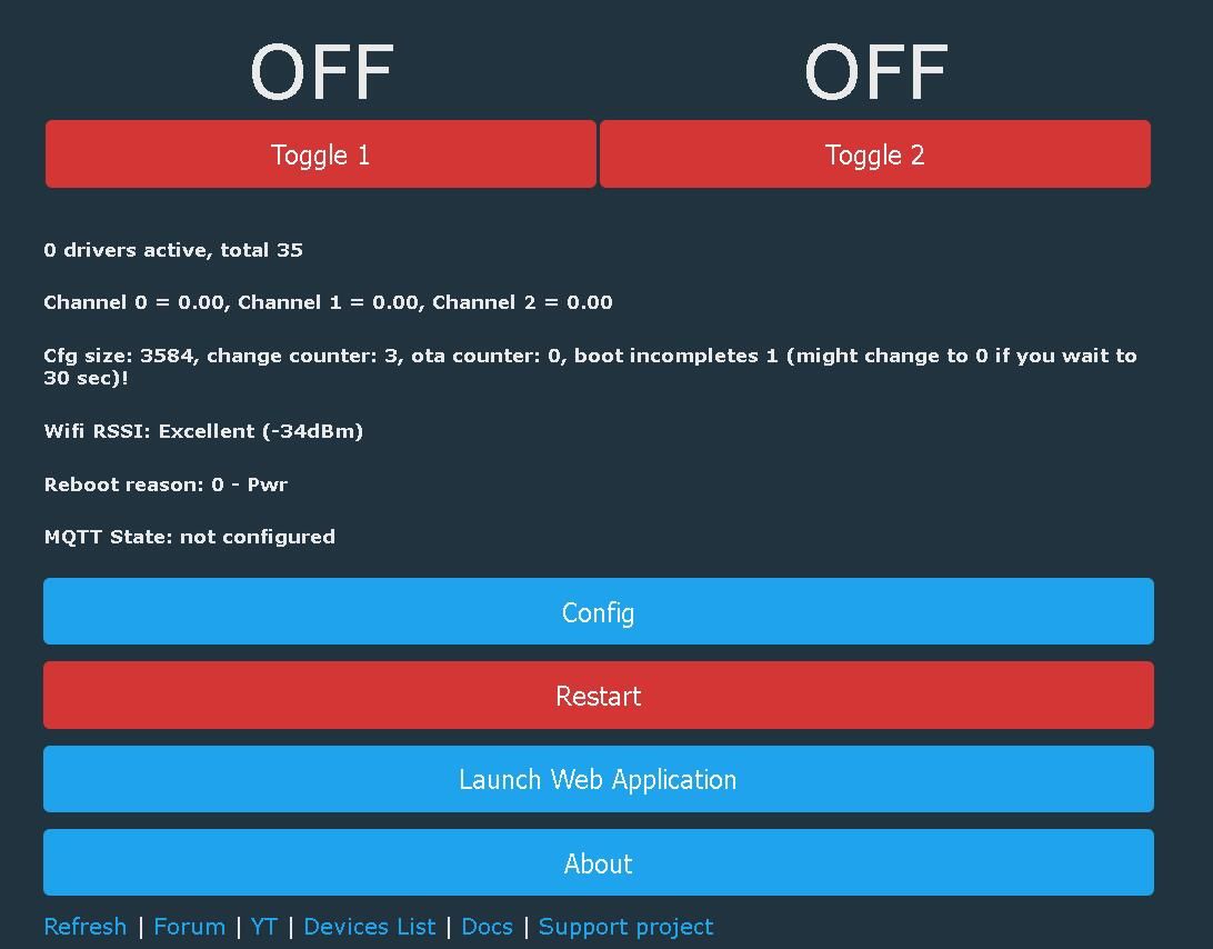

  • How to rename buttons in OpenBK7231T
    #23 20838803
    omniron
    Posts: 114
    I'm trying to rename the buttons of the freed Xenon SM-PW801-U2:
    User interface with two red buttons labeled Toggle 1 and Toggle 2 and technical information.
    In Tasmota it was a simple
    WebButton1 xyz (I tried that, thought commands are compatible)
    WebButton2 zyx
    So I researched
    https://github.com/openshwprojects/OpenBK7231T_App/blob/main/docs/commands-extended.md
    which talks about
    toggler_name0
    toggler_name1 etc.
    That command didn't work, so I tried
    https://www.elektroda.com/rtvforum/find.php?q=toggler_name
    None of those worked either.
    Question, how do I change the names of these buttons please???

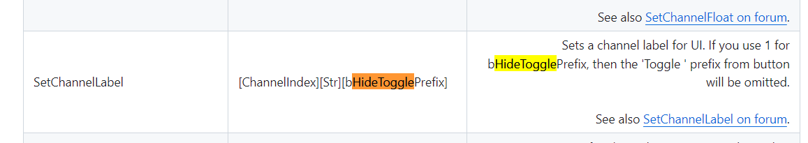

    #24 20838808
    Posts: 14790
    Rate: 12937
    it's for toggler driver.
    You might rather use:
    setChannelLabel 1 Xyz
  • #25 20838941
    omniron
    Posts: 114
    Got it, now that this is not a toggle unit, how do I get rid of the "Toggle" text in the labels?
    Thanks! (for all)
    #26 20838965
    Posts: 14790
    Rate: 12937
  • #27 20839170
    omniron
    Posts: 114
    So cool!
    I really searched that page for "name" and "text" as mentioned, never thought of "label."
    Thanks

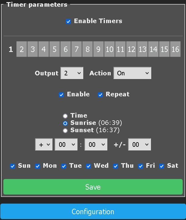

  • Sunset and sunrise scheduling for Tuya chips
    #28 20850824
    omniron

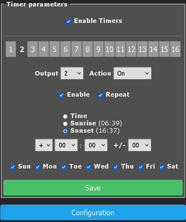

    Posts: 114
    Is there a way to set one of the switches to turn on/off at sunset/rise?
    This is sooo easy with Tasmota
    Screenshot of timer settings with options for sunrise/sunset trigger. Screenshot of timer parameters settings with options to activate at sunrise or sunset.
    I checked the autoexecs, like here:
    https://github.com/openshwprojects/OpenBK7231.../autoexecs/automatic_day_and_night_lights.bat
    but the times are hardwired.
    Maybe I didn't search well the code on GitHub, does a sunset/rise feature exist for Tuya chips?
    thanks!
  • #29 20950173
    omniron
    Posts: 114
    I found that the blue LED on the device (P1 please see schematic at the top) is not mentioned in the unit's template.
    Had it wrong in the schematic anyway (corrected).
    It was always on, tested it with WifiLED at P1 (RXD2) and it works/blinks!
    Could this please be added to its template?
  • Blue LED mapped to P1 in final template
    #30 20950196
    Posts: 14790
    Rate: 12937
    It has been added recently, please see this topic:
    OpenBeken Scripting - Time and scheduling with NTP and addClockEvent
    Had it wrong in the schematic anyhow (corrected).
    Could this please be added this to it's template?
    Ok, so the final template is:
    I've added it to our devices list.
