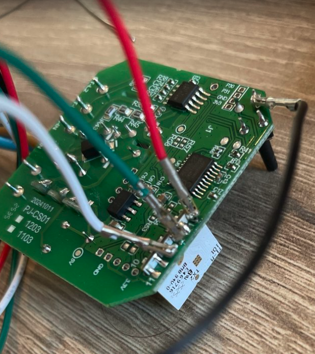

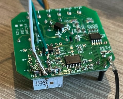

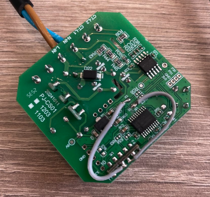

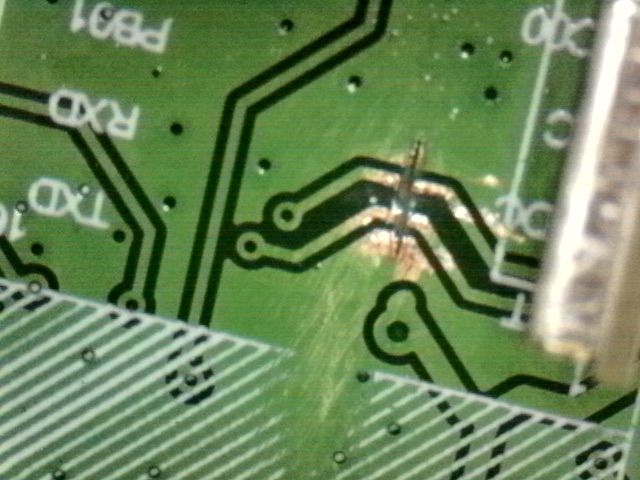

    feiltom
    small resume for PJ1103C, with a T1-M WiFi module (BK7238-based) and an N32G430 MCU for the TuyaMCU which interfaces with the HLW8112
    Cut RX / TX trace
    Damaged trace on green printed circuit board with visible corrosion
    Flash with BK7238 firmware
    Close-up of a green PCB with colored wires and surface-mounted integrated circuits.
    Detail for RX / TX pin not good on previous photo
    Printed circuit board with integrated circuits and soldered wires
    Rebuild the trace
    Green PCB with wires, microchips, and printed technical markings
    autoexec.bat good for me
    startDriver TuyaMCU
    tuyaMCU_setBaudRate 115200
    tuyaMcu_defWiFiState 4
    // request full state from time to time (every 10 seconds, -1 repeats - forever)
    addRepeatingEvent 10 -1 uartSendHex 55AA0008000007
    // dpID 20 is voltage * 0.1
    setChannelType 1 Voltage_div10
    linkTuyaMCUOutputToChannel 20 val 1
    // dpID 18 is current * 0.001
    setChannelType 2 Current_Div1000
    linkTuyaMCUOutputToChannel 18 val 2
    // dpID 19 is power * 0.1
    setChannelType 3 Power_Div10
    linkTuyaMCUOutputToChannel 19 val 3
    Thanks all, for your post, it's helped me

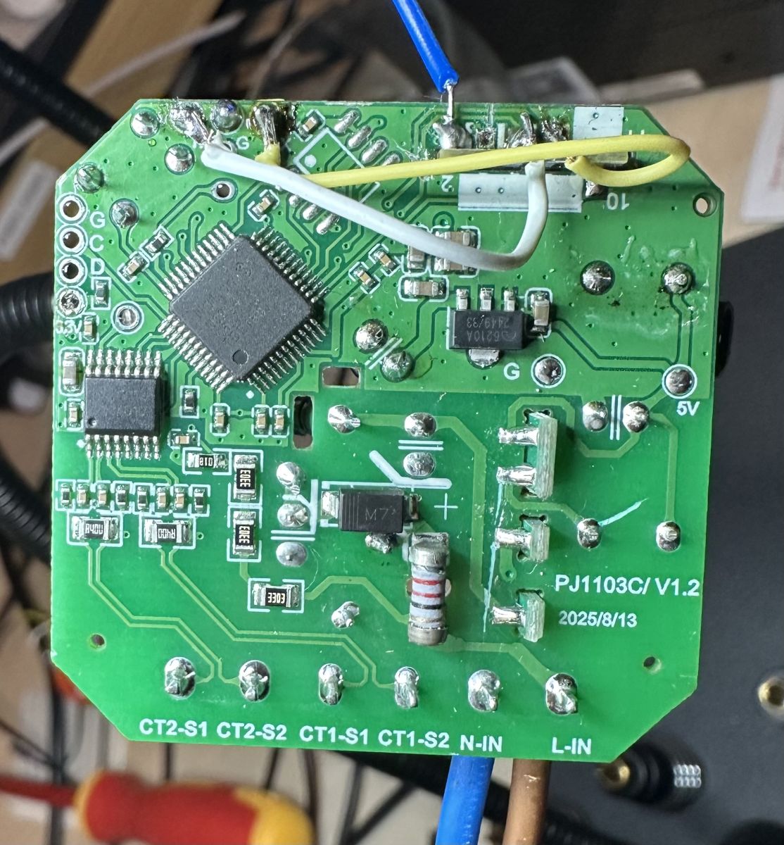

    I have a similar device marked PJ1103C/V1.2 with T1-M (BK7238) + N32G430 + HLW8112.
    Green PCB with SMD components and PJ1103C/V1.2 printed in the corner
    I followed feiltom's approach (cut traces to isolate T1-M, flashed OpenBeken, reconnected traces), but using his or alexan's autoexec.bat config just gives me all zeros in the web UI.
    Looking at the logs, I see the N32 is sending plain text debug output, not TuyaMCU protocol:
    Info:TuyaMCU:Consumed 150 unwanted non-header byte in Tuya MCU buffer
    Info:TuyaMCU:Skipped data (part) 5B 49 2F 68 6C 77 5D 20 2A 2A 2A 2A 2A 43 48 41 2A 2A 2A 2A 2A 0D 0A 5B 49 2F 68 6C 77 5D 20 56 2F 46 72 65 71 2F 50 46 3A 20 32 33 30 30 2C 20 34 39 30 34 2C 20 31 30 30 0D 0A 5B 49 2F 68 6C 77 5D 20 49 2F 50 2F 45 3A 20 30 2C 20 30 2C 20 30 0D 0A 5B 49
    Decoding this hex gives RT-Thread debug messages:
    [I/hlw] *****CHA*****
    [I/hlw] V/Freq/PF: 2300, 4904, 100
    [I/hlw] I/P/E: 0, 0, 0
    [I/hlw] *****CHB*****
    [I/hlw] I/P/E/PF: 0, 0, 0, 100
    The readings seem valid (230.0V, 49.04Hz, PF 100%) — the N32 is clearly reading the HLW8112 correctly. But it's outputting plain text instead of TuyaMCU binary protocol (which I understand starts with 55 AA ...).
    Is it normal that I see this debug output? Did anyone else encounter this with PJ1103C? If not normal, how do you get the N32 to switch to TuyaMCU protocol mode?
    I am very new/inexperienced at this. Any advice appreciated!

  • #70 21781239
    frath
    >>21770525
    Hi, new to the forum , hope we can help each other. from what i see you have the V1.2. With mine i didn't have to change the TX RX, juste flash with BK7238 and add this in the startup command line , you should see lots of things comming up:
    startDriver TuyaMCU
    tuyaMcu_setBaudRate 9600
    setChannelType 2 Frequency_div100
    setChannelType 3 Power_div10
    setChannelType 4 Current_div1000
    setChannelType 5 PowerFactor_div100
    setChannelType 6 EnergyTotal_kWh_div100
    setChannelType 7 Power_div10
    setChannelType 8 Current_div1000
    setChannelType 9 PowerFactor_div100
    setChannelType 10 EnergyTotal_kWh_div100
    setChannelType 11 ReadOnly
    setChannelType 12 ReadOnly
    setChannelType 13 Power_div10
    linkTuyaMCUOutputToChannel 112 val 1
    linkTuyaMCUOutputToChannel 111 val 2
    linkTuyaMCUOutputToChannel 101 val 3
    linkTuyaMCUOutputToChannel 113 val 4
    linkTuyaMCUOutputToChannel 110 val 5
    linkTuyaMCUOutputToChannel 106 val 6
    linkTuyaMCUOutputToChannel 105 val 7
    linkTuyaMCUOutputToChannel 114 val 8
    linkTuyaMCUOutputToChannel 121 val 9
    linkTuyaMCUOutputToChannel 107 val 10
    linkTuyaMCUOutputToChannel 102 raw 11
    linkTuyaMCUOutputToChannel 104 raw 12
    linkTuyaMCUOutputToChannel 115 val 13
    setChannelLabel 1 "Tension"
    setChannelLabel 2 "Frequence"
    setChannelLabel 3 "Puissance A"
    setChannelLabel 4 "Courant A"
    setChannelLabel 5 "PowerFactor A"
    setChannelLabel 6 "Energie A"
    setChannelLabel 7 "Puissance B"
    setChannelLabel 8 "Courant B"
    setChannelLabel 9 "PowerFactor B"
    setChannelLabel 10 "Energie B"
    setChannelLabel 11 "Direction A"
    setChannelLabel 12 "Direction B"
    setChannelLabel 13 "Puissance nette"
    More things to come up i'm sure, cause i didn't check for the buzzer yet or else, but can easily be found.i'll try to udpate this.
