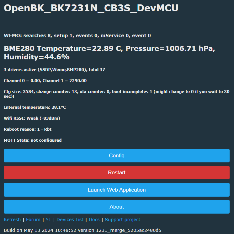

    BME280 working with build 1231_merge_5205ac2480d5
    Screenshot of OpenBK_BK7231N_CB3S_DevMCU interface displaying BME280 sensor readings.

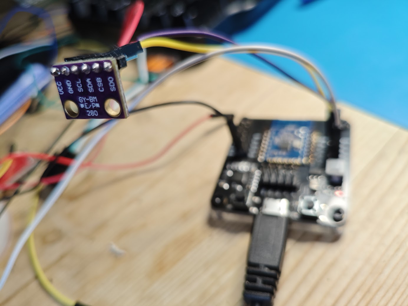

    Address 0x76 (dec 118)
    for me:
    P7 - SDA
    P8 - SCL
    Close-up of a BME280 module connected to a microcontroller with colored wires.

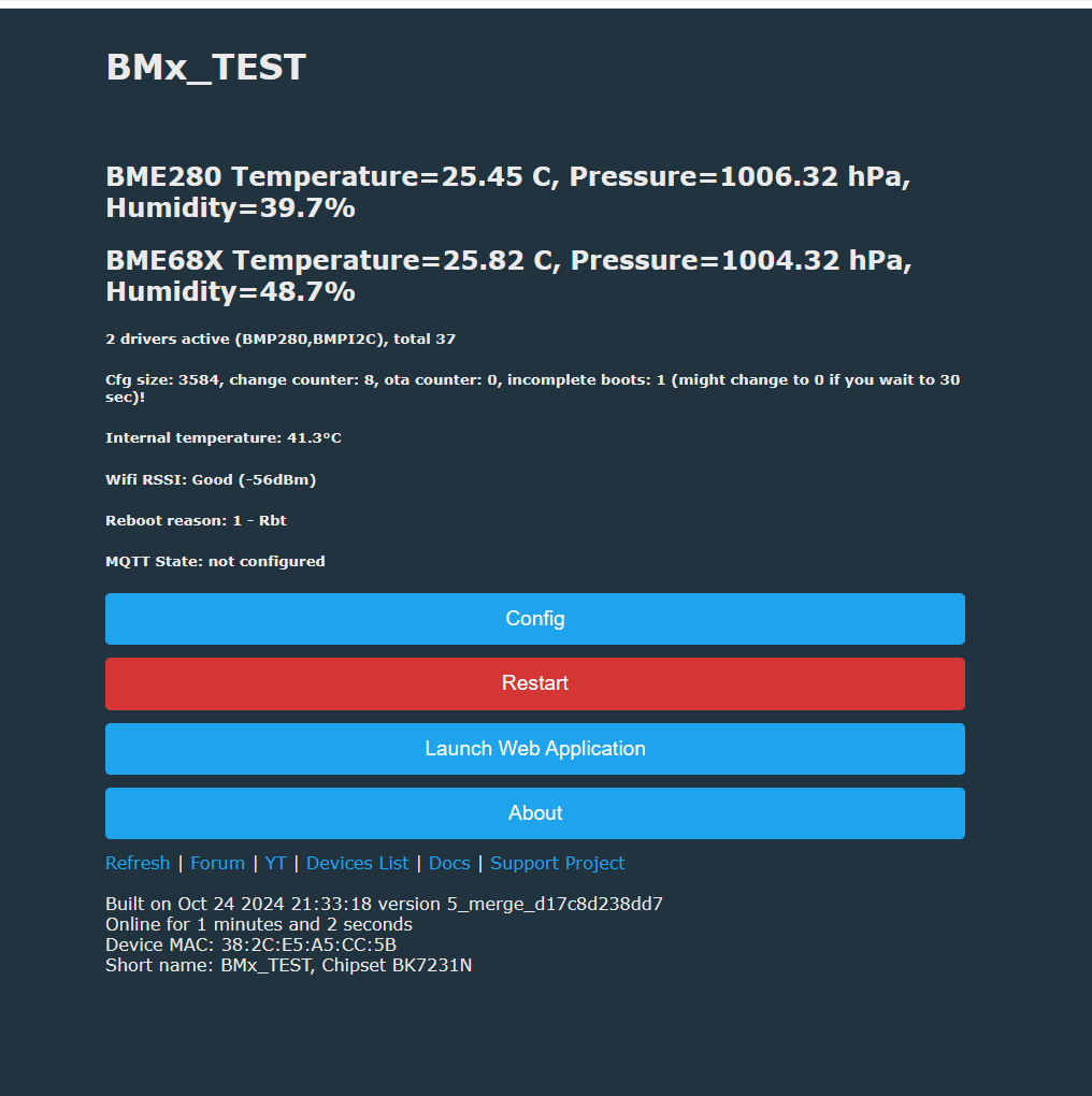

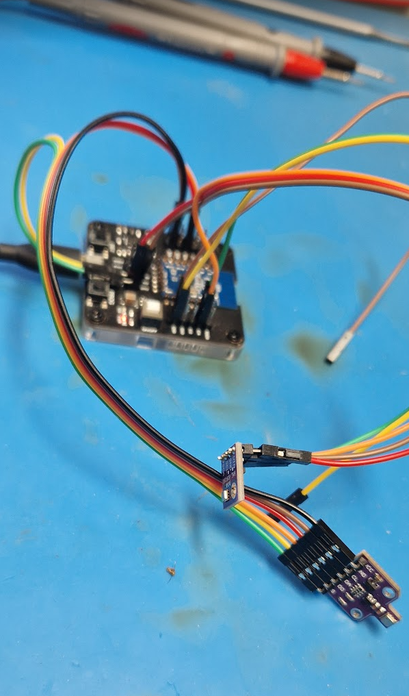

    After enabling BMPI2C driver I managed to get both BME680 and BME280 running on the same board, will let run for some time for testing purposes.
    This is the autoexec script with some explanations
    // startDriver BMPI2C [CLK] [DATA] [ChannelForTemp] [ChannelForPressure] [ChannelForHumidity] [Addr]
    //SDO to GND for Adr8bit 236 for 0x76 or set SD to VCC for Adr8bit 238 for 0x77
    //set CSB pin to GND for SPI mode and to VCC for I2C mode
    // startDriver BMP280 8 14 1 2 3 236
    // startDriver BMP280 [CLK] [DATA] [ChannelForTemp] [ChannelForPressure] [ChannelForHumidity] [Adr8bit]
    // Adr8bit 236 for 0x76, 238 for 0x77
    startDriver BMPI2C 26 24 4 5 6 238
    //BMP680_Adr 0x77
    startDriver BMP280 8 7 1 2 3 236
    //BMP280_Adr 0x76
    Pictures or it didn't happen :)
    Screen showing test results for BME280 and BME680 sensors.
    BME680 and BME280 modules connected to a prototype board.

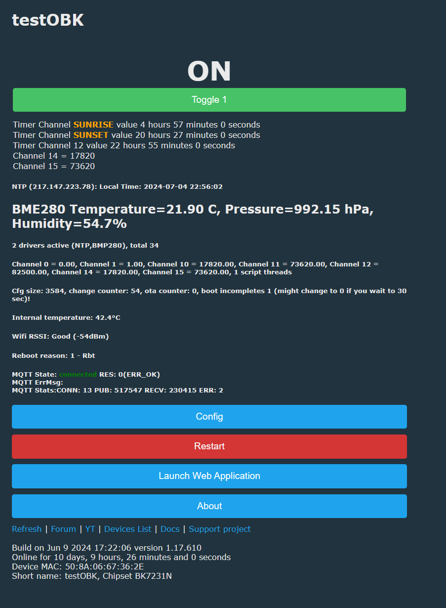

  • #76 21510838
    UserNameTaken
    >>21510692 Ah OK, I'll add the other driver BMPI2C tomorrow, and test again. Thanks.
    Added after 1 [hours] 34 [minutes]:
    >>21510838 added & all working fine. Had to add a placeholder for humidity channel, even though there won't be a reading from a bmp280, in the config.
    startDriver BMPI2C 11 10 1 2 3 1
    BMPI2C_Cycle 60
    thanks again.

How far can I get using a BME680 with OpenBK today, and what still needs extra driver work compared with BME280 support?
You can get partial detection and some experimental operation, but BME680 still needs extra driver work compared with BME280. One contributor added BME680 chip-ID detection only and stated that the driver itself still needed more work to function properly on BME680. Later, another user reported both BME680 and BME280 running on the same board with a custom BMPI2C-enabled build, but that was from a personal fork, not a standard public binary. So BME280 support is the mature path today. [#21275971]
