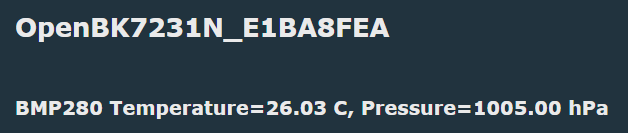

    Hello and greetings to all. I am in the same case as my colleague bilbs84. The problem is that I am even newer to this and I have several WB2S modules, with OpenOBK installed and I want to integrate BME680 sensors and have these readings in Home Assistant. But no matter how much I have read on the internet, I don't see an easy way, for a beginner. Thanks again for your answers and greetings.
    P.S. Sorry for my English language, but I use a translator.

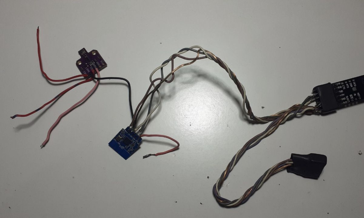

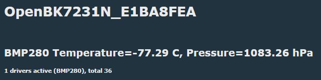

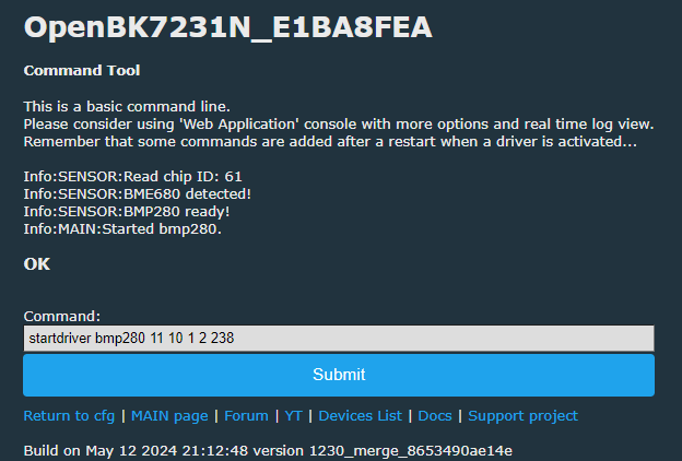

    Thanks for answering. It is BME680, which has some more features than 280. I bought them on Aliexpress at a good price, with the intention of integrating it with an ESP32 in home assistant, but since I have several CB2S with OpenBK, I wanted to see if it is possible.
    Here is a photo with the tests and Aliexpress link. BME680 and CB2S modules connected by wires on a white background.
    Greetings!
    https://es.aliexpress.com/item/10050059703827...t_main.11.21ef194dbFEnlm&gatewayAdapt=glo2esp

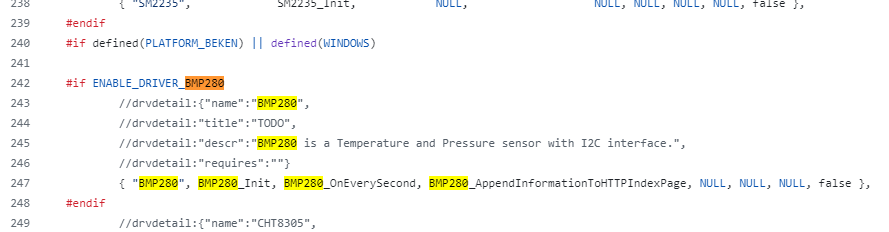

    I apologize for the confusion. The code is still here, but the driver may be disabled because we are slowly running out of the flash memory.
    If you want to get a build with BME280 driver, you need to add:
    #define ENABLE_DRIVER_BMP280 1
    to obk_config.h .
    Alternatively, I can do the same for you, here:
    https://github.com/openshwprojects/OpenBK7231T_App/pull/1064
    Once it builds, you can click into build results, scroll down to "Summary" and click "Download artifacts" to get a binary file with BMP280 support

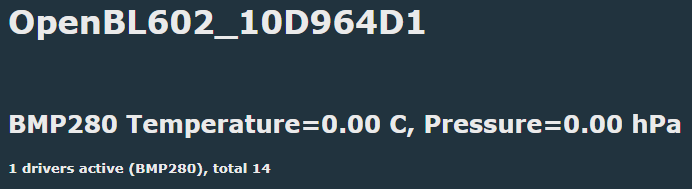

    Can this BME280 controller also be enabled in BL602? I would like to use the rx and tx pins for this (i2c to the sensor), I do not use them in "normal" mode. Is this even possible? And do you have to compile it yourself or is this driver included in normal builds?
    Thank you for the information.
  • #39 21010867
    Posts: 14616
    Help: 655
    Rate: 12633
    BL602 is low on memory, BMP280 is not enabled there. You need to enable it and compile it yourself. Here is the configuration file:
    https://github.com/openshwprojects/OpenBK7231T_App/blob/main/src/obk_config.h
    Here is #define:
    //#define ENABLE_DRIVER_BMP280 1
    Here is an instruction to compile online on Github without installing anything on your computer:
    OpenBeken online builds system - firmware compilation for all platforms on Github
    Additionally, you may need to add missing files to the Makefile, but that will come out in the end. Try it, I`ll help you if you need it.

    I forked the project, changed "#define ENABLE_DRIVER_BMP280 1" to "#define ENABLE_DRIVER_BMP280 1" in the obk_config.h file. It compiles without errors (this compiling function on GitHub is amazing, I wonder who pays for it...), I uploaded it to magichome with BL602.:
    In the webapp I enter: "startDriver BMP280 0 1 1 2" (I`m not sure about the pins, but this is a later issue)
    Info:MAIN :D river BMP280 is not known in this build.
    Info:MAIN:Available drivers:
    Info:MAIN:NTP
    Info:MAIN:, RN8209
    Info:MAIN:, BL0942
    Info:MAIN:, BL0937
    Info:MAIN:, CSE7766
    Info:MAIN:, DDP
    Info:MAIN:, SSDP
    Info:MAIN:, DGR
    Info:MAIN:, Wemo
    Info:MAIN:, SM2135
    Info:MAIN:, BP5758D
    Info:MAIN:, BP1658CJ
    Info:MAIN:, SM2235
    Info:CMD:[WebApp Cmd `startDriver BMP280 0 1 1 2` Result] OK
    ... looks like there is no driver.
    Second attempt: I looked at the obk_config.h file: there is its own part for BL602, so I added the driver there:
    #elif PLATFORM_BL602
    // I have enabled drivers on BL602
    #define ENABLE_TASMOTADEVICEGROUPS 1
    #define ENABLE_NTP 1
    #define ENABLE_DRIVER_LED 1
    //#define ENABLE_DRIVER_BL0937 1
    //#define ENABLE_DRIVER_BL0942 1
    //#define ENABLE_DRIVER_CSE7766 1
    #define ENABLE_DRIVER_WEMO 1
    Compilation without errors, but "Info:MAIN :D river BMP280 is not known in this build."
    Third attempt: I took the compiler from here: https://github.com/openshwprojects/OpenBK7231T_App/pull/1111 - I uploaded it, unfortunately the same thing again: "Driver BMP280 is not known in this build"
    It seems that the "#define ENABLE_DRIVER_BMP280 1" option is ignored when building the binary for BL602....
    Should the driver start like this? "startDriver BMP280 xx 1 2"?

    I found the problem:
    Screenshot of a source code snippet in a text editor.

    No, it's like yesterday (2nd attempt)
    There is apparently no problem with the build, it also works, after the update I have a new build number (Build: Build on Mar 20 2024 08:40:07 version bl602-bmp_0204362d2fcd)
    But when I type "startDriver BMP280 0 1 1 2" in the Logs section in the new webapp, I get:
    Info:MAIN :Driver BMP280 is not known in this build.
    Info:MAIN:NTP
    Info:MAIN:, RN8209
    Info:MAIN:, BL0942
    Info:MAIN:, BL0937
    Info:MAIN:, CSE7766
    Info:MAIN:, DDP
    Info:MAIN:, SSDP
    Info:MAIN:, DGR
    Info:MAIN:, Wemo
    Info:MAIN:, SM2135
    Info:MAIN:, BP5758D
    Info:MAIN:, SM2235
    But really, it's not that important, it's more of a gimmickry, so there's no point in wasting your precious time on it.
    After update:
    Oh, I see. then this driver simply does not exist for bl602. At least everything is clear now :)

    This controller uses I2C software, it should work with BL602 without any problems, have you checked the latest version from my PR?
  • #44 21011686
    olekwal
    Posts: 12
    yes, now I can load the driver.
    do you know what pins are rx and tx on bl602? I started looking for it, but I think I`ll miss it...
    oh, and one more thing: when using bme280 I have "info:SENSOR:BMx280 wrong ID!" but I read that the controller itself looks for the appropriate ID, so it`s just a matter of finding the right pins?
    OK: Update, I found the pins, (on bl602: p16 - scl; p7 -sda) everything works, great!

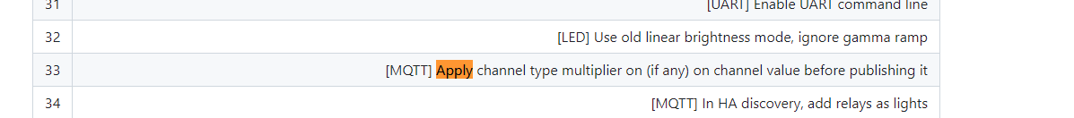

    There is a flag on the divider. It`s all because of the TuyaMCU standard that we based on at the beginning. Turn on:
    Screenshot of a feature list with a highlighted MQTT feature: Apply channel type multiplier on channel value before publishing it.
    I`m wondering whether I should try to add some universal solution, maybe, for example, it would be possible to change the driver tick period, which is now one second
  • #48 21013368
    olekwal
    Posts: 12
    Ah, great. Thank you for the tip from there flag33.

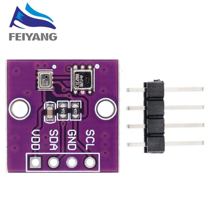

    I have a BMP280/AHT20 combined sensor module.
    Combined sensor module BMP280/AHT20 with Feiyang logo.
    Does anyone know if this should work with the BMP280 PR? I couldn't get an i2c result in soft scan previously and wondered if that was because of the two sensors. Also, does OBK have an AHT20 driver? I tried all the others but no results.
    Both sensors work in Tasmota so the module itself is operational.
  • #52 21054355

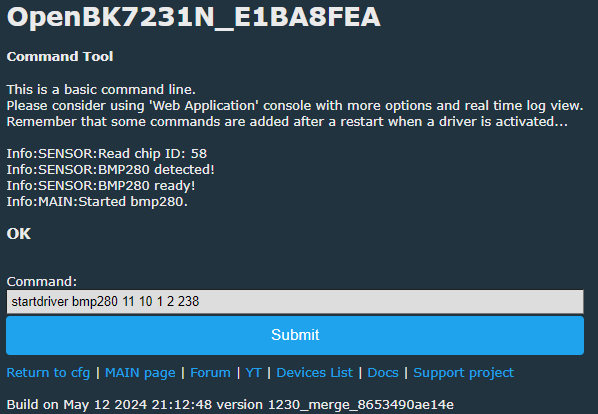

    hmmm
    Screen showing error messages for BMP280 sensor.
    startDriver BMP280 16 7 01
    Info:SENSOR:BMx280 wrong ID!
    Info:SENSOR:BMP280 failed!
    Info:MAIN:Started BMP280.
  • #53 21054975

  • #55 21072813
    Posts: 5062
    Help: 438
    Rate: 893
    So I'm not sure where the 0x58 ID for BME/BMP280 came from but the consensus Googling around is that the BME/BMP280 and BME680 are mostly 0x77.

    I've been playing with the BMP280 driver. I've added something to output the detected ID to help with troubleshooting. I also added BME680 chip ID for detection only. The driver itself needs more work to function on BME680 properly.
    https://github.com/openshwprojects/OpenBK7231T_App/actions/runs/9054242982
    BMP280/AHT20 combined module test
    Screenshot of the OpenBK7231N command tool with BMP280 module test results.
    Screenshot displaying the OpenBK7231N_E1BA8FEA identifier and BMP280 readings: temperature 26.03°C and pressure 1005.00 hPa.
    BME680
    Screenshot of the Command Tool interface displaying messages about detected BME680 and BMP280 sensors.
    Screenshot of BMP280 driver test results.

    Merged, but first I disabled it in obk_config.h, if you need a new binary, open new PR
