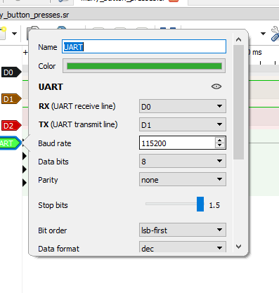

    Baud settings:
    Settings window for UART transmission configuration with options such as RX, TX, baud rate, data bits, and parity.

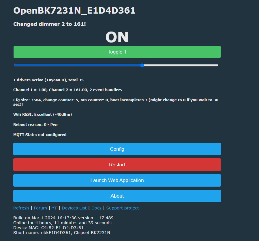

    Screenshot of OBK script editor with autoexec.bat
    Result:
    OpenBK7231N dimmer control panel.

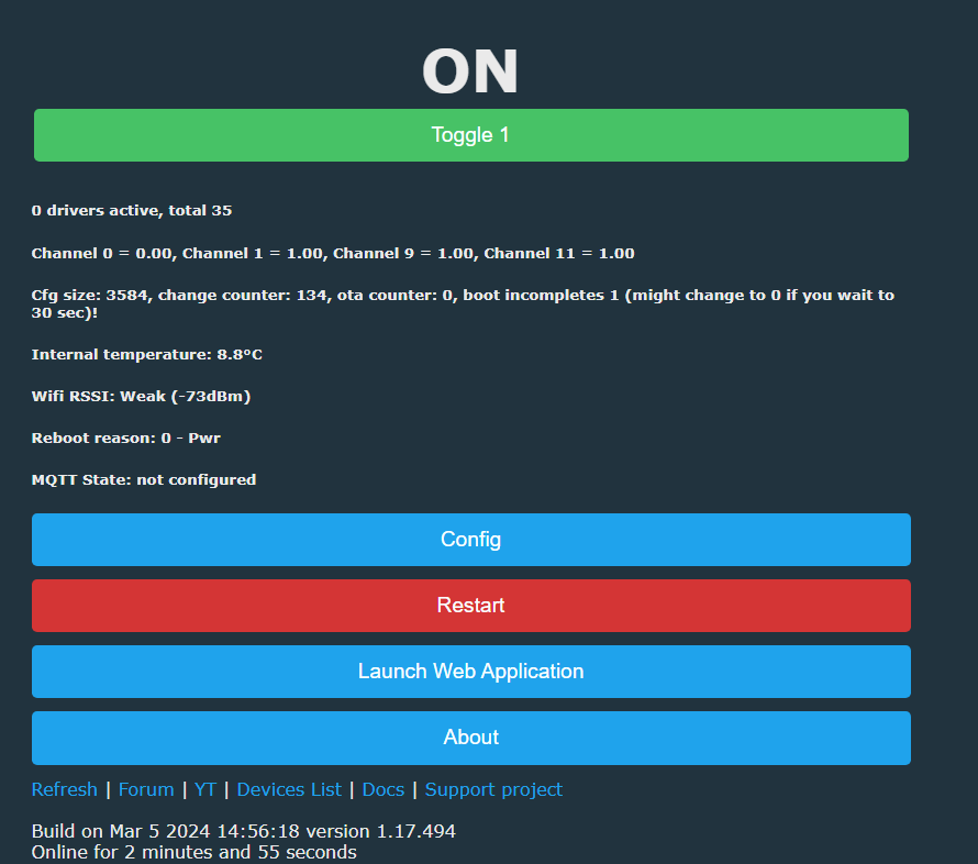

  • Web page returns after deleting autoexec.bat
    #46 20992265
    lbelleboni
    Posts: 23
    Ciao.
    I delete the autoexec.bat, left the device without lamp connected (as previously done) and the temperature is less respect before. The web page is still not available at the moment. This evening, when I'll be back I'll check again both, temperature, web and if it still working with the physical switch.
    Thanks again.
    Luca

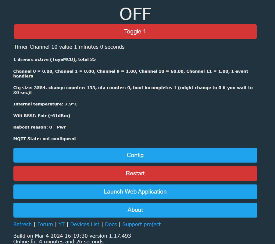

    Update:
    Web page active at the moment:
    Device interface screen with buttons and status information.
    Temperature on screen 8.8°C (I don't know if for you this value has sense)
    the row with --> Online for 2' 55" meaning that the device reboot?

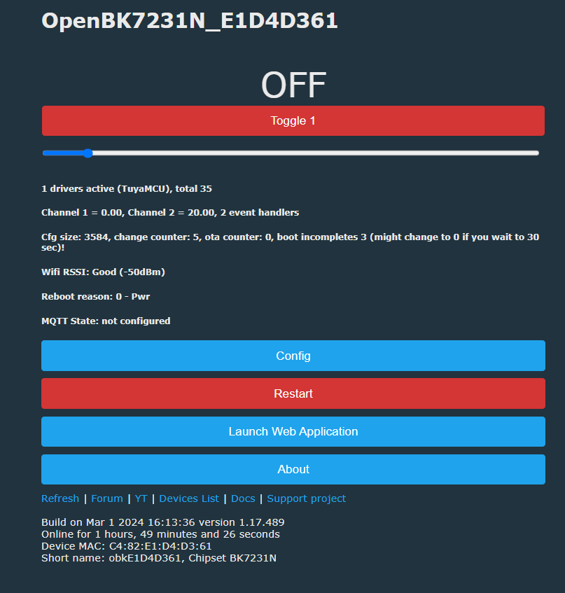

  • #47 20992281
    Posts: 14705
    Help: 658
    Rate: 12757
    The 2 minutes online time means it rebooted. So it reboots even without my script?

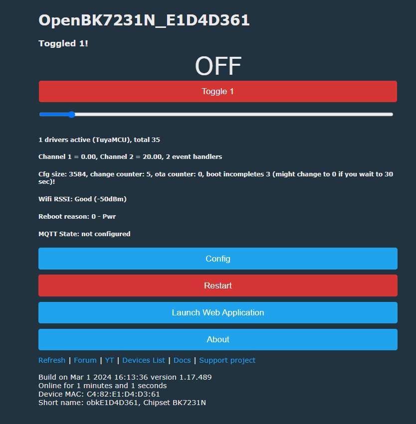

    Okay, let's check, I will run my device now and we will see if my one is rebooting.
    User interface of OpenBK7231N system with buttons and device status information.
    I will let you know..
    Added after 1 [hours] 48 [minutes]:
    After more than hour, it's still working:
    Control panel of device OpenBK7231N_E1D4D361 showing status and configuration information.

  • Long-term uptime test shows dimmer remains stable
    #49 20992588
    Posts: 14705
    Help: 658

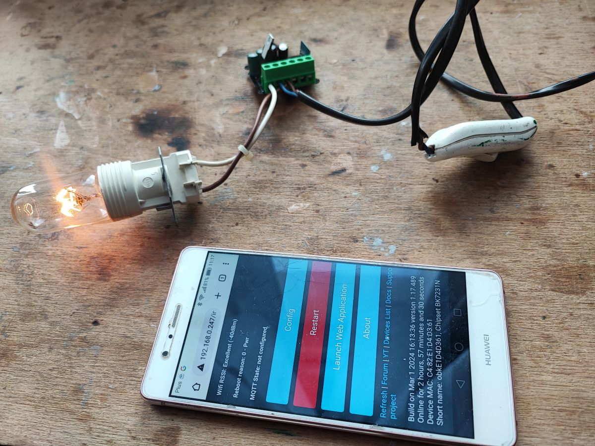

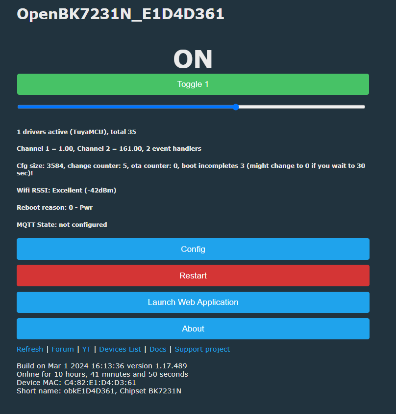

    Rate: 12757
    I think the temperature counter will not show if you had more than 1 boot failure. I was playing around the device so it didn't show for me. I will reboot later and check, but first I want to keep it online to see if it will break.
    3 hours uptime and counting, dimmer still works:
    A smartphone displaying an online control panel next to a lit bulb connected by wires to an electronic setup on a wooden table.
    And now 4h:
    Screenshot of the control panel for OpenBK7231N_E1D4D361 with active channel 2 set to 161.
    Added after 6 [hours] 32 [minutes]:
    Almost 11 hours online and counting, but it seems I will have to settle for this now as I need to go to sleep soon.
    No restarts so far, light is working
    Screenshot of the OpenBK7231N user interface displaying device status information.

    Info:TuyaMCU:Consumed 512 unwanted non-header byte in Tuya MCU buffer
    Info:TuyaMCU:Skipped data (part) BB AA 3C BB AA 3B BB AA 3B BB AA 3B BB AA 3B BB AA 3B BB AA 3C BB AA 3B BB AA 3C BB AA 3C BB AA 3B BB AA 3C BB AA 3B BB AA 3C BB AA 3B BB AA 3B BB AA 3C BB AA 3B BB AA 3B BB AA 3C BB AA 3B BB AA 3B BB AA 3B BB AA 3C BB AA 3B BB AA 3B BB AA 3B BB AA 3C BB
    Info:MAIN:Time 41649, idle 50928/s, free 71856, MQTT 0(2603), bWifi 1, secondsWithNoPing 41579, socks 2/38 POWERSAVE
    Info:MAIN:Time 41650, idle 772/s, free 71944, MQTT 0(2603), bWifi 1, secondsWithNoPing 41580, socks 3/38 POWERSAVE
    Info:GEN:dhcp=0 ip=192.168.1.229 gate=192.168.1.254 mask=255.255.255.0 mac=xx:xx:xx:xx:xx:xx
    Info:GEN:sta:rssi=-75,ssid=InfostradaWiFi--CXXXXX,bssid=80:cc:9c:f9:7e:2a,channel=13,cipher_type:CCMP
    Info:MAIN:Time 41651, idle 64880/s, free 72176, MQTT 0(2603), bWifi 1, secondsWithNoPing 41581, socks 2/38 POWERSAVE
    Info:TuyaMCU:Consumed 8 unwanted non-header byte in Tuya MCU buffer
    Info:TuyaMCU:Skipped data (part) 3B BB AA 3B BB AA 3B BB
    Info:MAIN:Time 41652, idle 138467/s, free 72176, MQTT 0(2603), bWifi 1, secondsWithNoPing 41582, socks 2/38 POWERSAVE
  • #53 20994022
    Posts: 14705
    Help: 658
    Rate: 12757
    This is normal. The dimmer sends some strange data to the WiFi module on UART which doesn't seem to be necessary for the system to work.

  • One unstable unit reported a bogus internal temperature of 8.3–8.8 °C and an online time of only 2 min 55 s, both strong signs of repeated rebooting. [#20992265]
