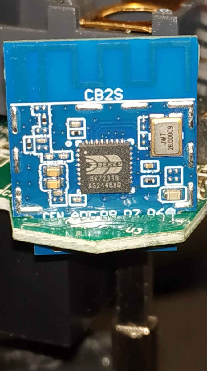

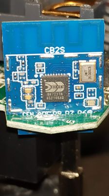

    I added an ESP8266 module to such a plug, onto which I threw Tasmote and then added it to domoticz.
    Of course CB2S soldered out and in its place on the ESP8266 wires
    If anyone would be interested in the topic of converting to ESP 8266 and Tasmote it downloads:

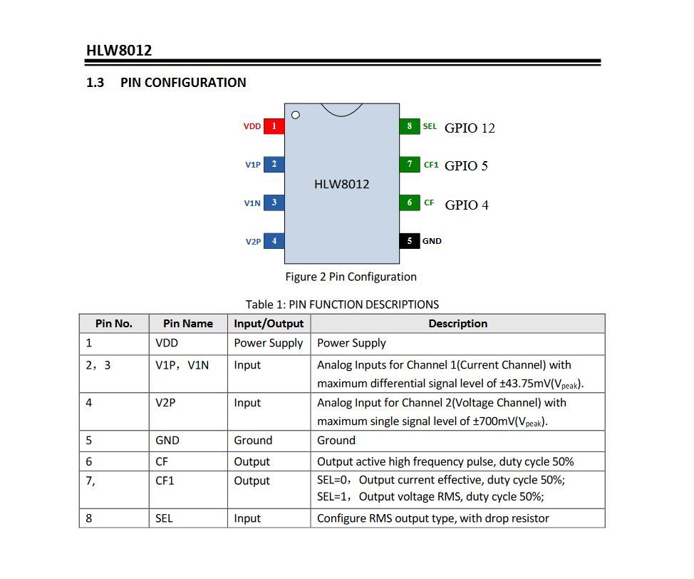

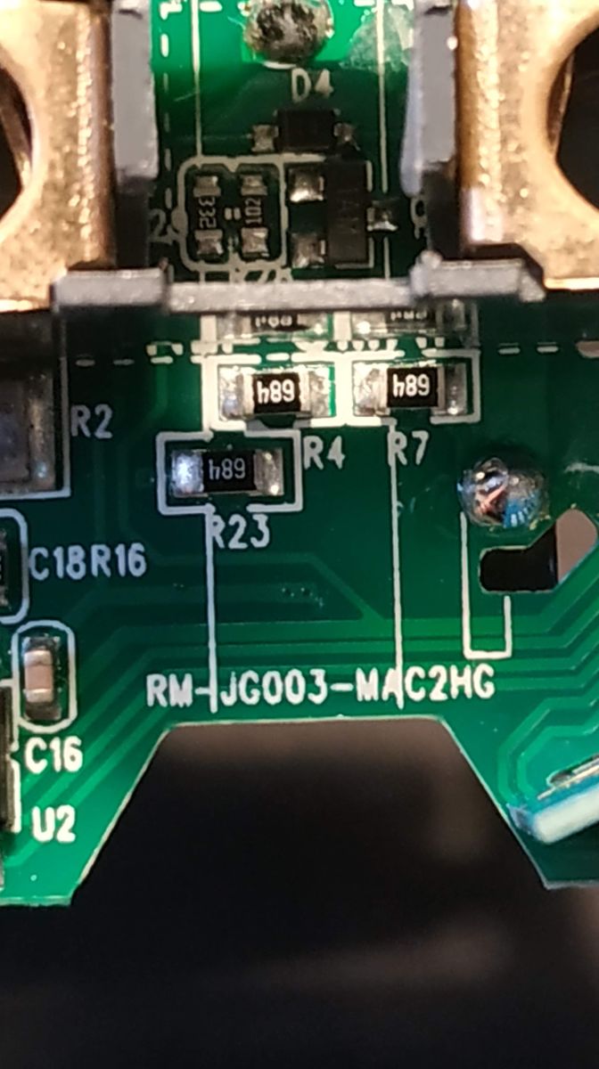

    PCB with marked pin numbers for connecting ESP8266. .
    1. VCC +3.3V
    2. GND
    3. button -> GPIO 0
    4. hlwbl SEL_i -> GPIO 12
    5. relay -> GPIO 15
    6. HLWBL CF1 -> GPIO 4
    7. BL0937 CF -> GPIO 5
    8. LED -> GPIO 2
    Works ok already 3 pieces so converted function in home automation. Switching on and off devices and measuring energy consumption all in Domoticz. Much better value than the SP111, just a little of your own time at night.

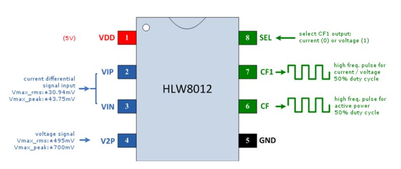

    Maybe the above list will help someone. To get there, take a meter and look along the paths.
    It will also be useful then:
    HLW8012 pin configuration diagram with function descriptions. .

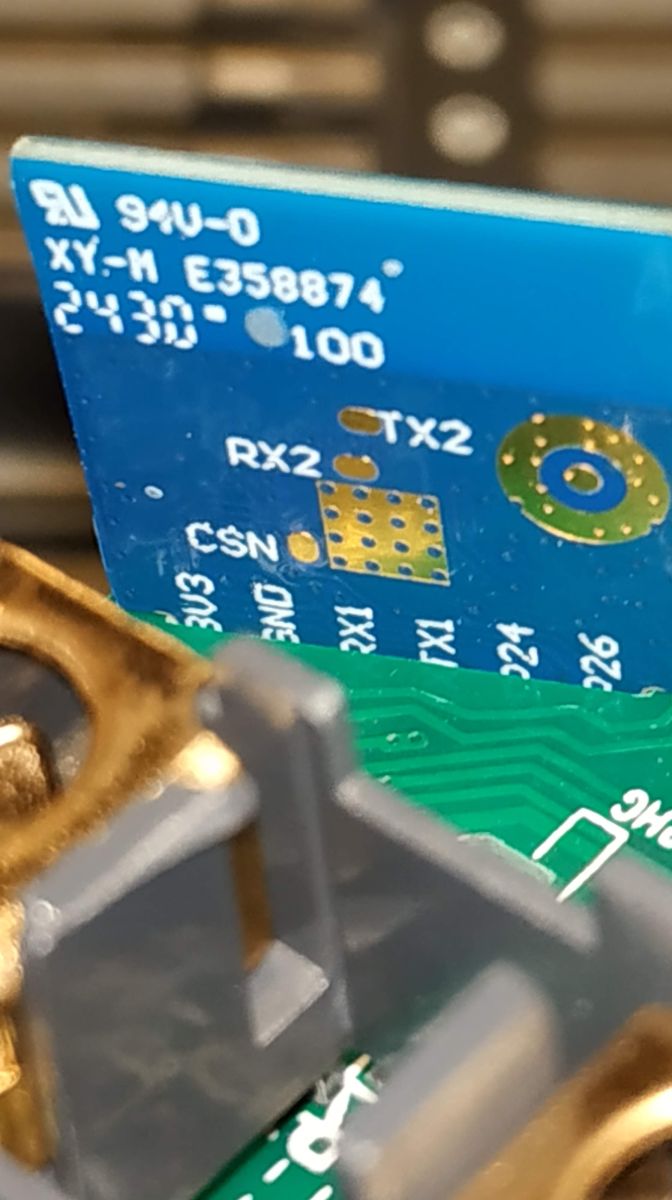

    tun0
    Posts: 12
    None of those look promising. Still, what are those 3 soic chips at the bottom of the blue one?
    Yeah, that's pretty much what I was afraid of. I haven't been able to determine any of those 3 chips, yet. Perhaps with my microscope I can, but haven't gotten around to try that yet.
    Also, pretty sure I should have a "known good" adapter "somewhere". But those things tend to be darn good at playing hide and seek 😂

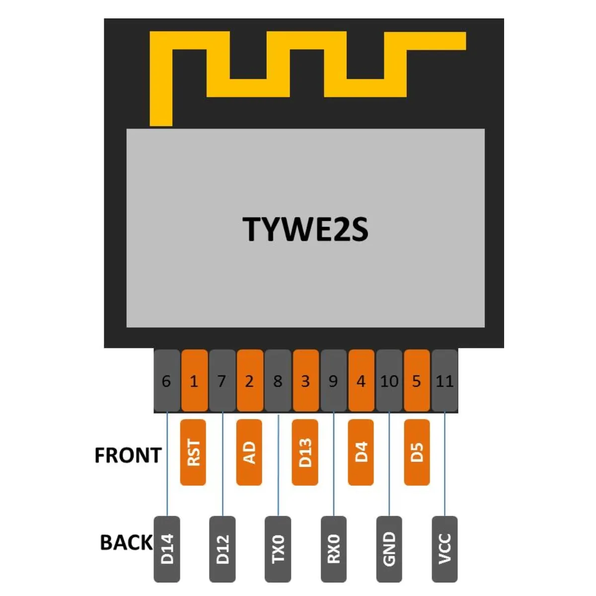

  • #33 21177527
    Posts: 14782
    Rate: 12920

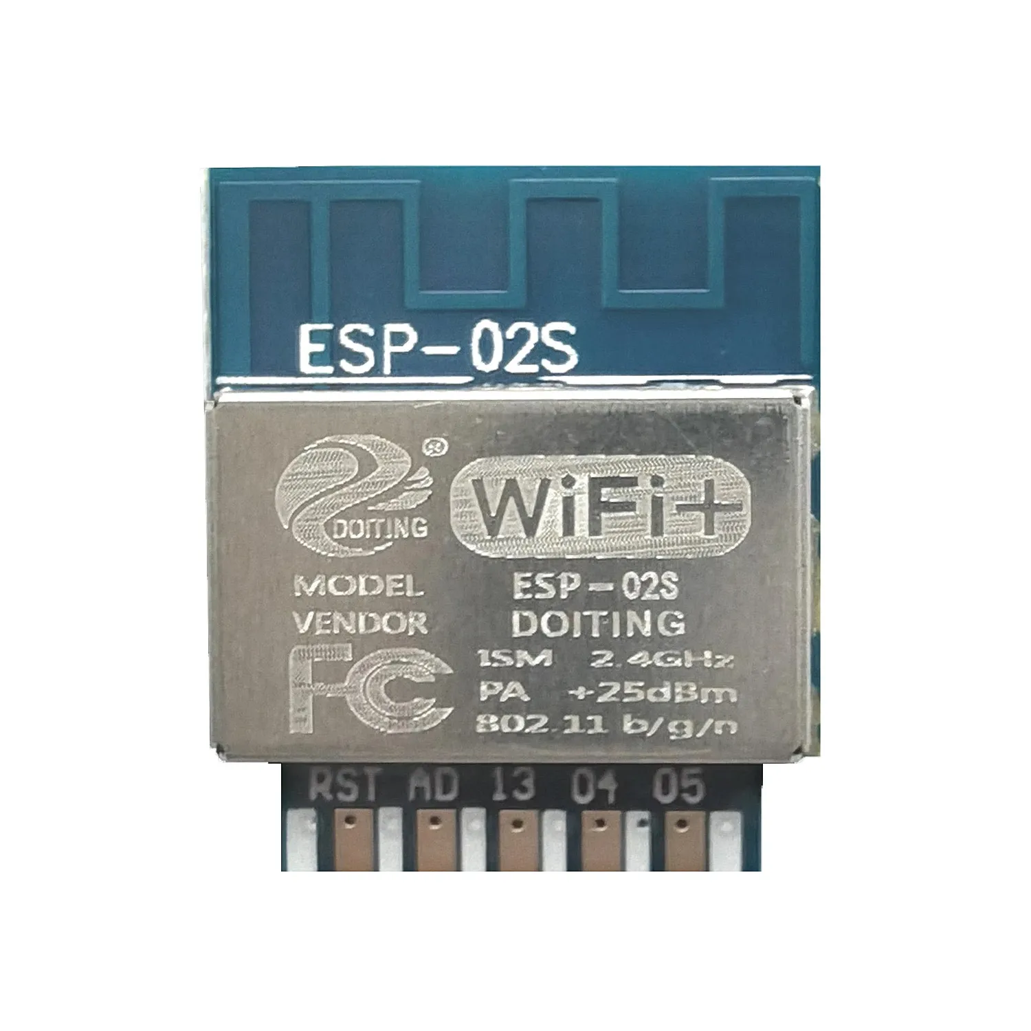

    CB2S/WB2S can be replaced with TYWE2S or ESP02S.
    Diagram of the TYWE2S module with pin descriptions. WiFi module ESP-02S with markings from Doiting.
    To quote Blakader: This module can replace modules such as: BT2S, CB2S, ESP-02S, FL_M99_V1, TYWE2S, TYZS6, TW-02, WR2, WB2, WBR2, WBR2D, WR2E, WB2S, WA2, XT-BL02, ZS2S

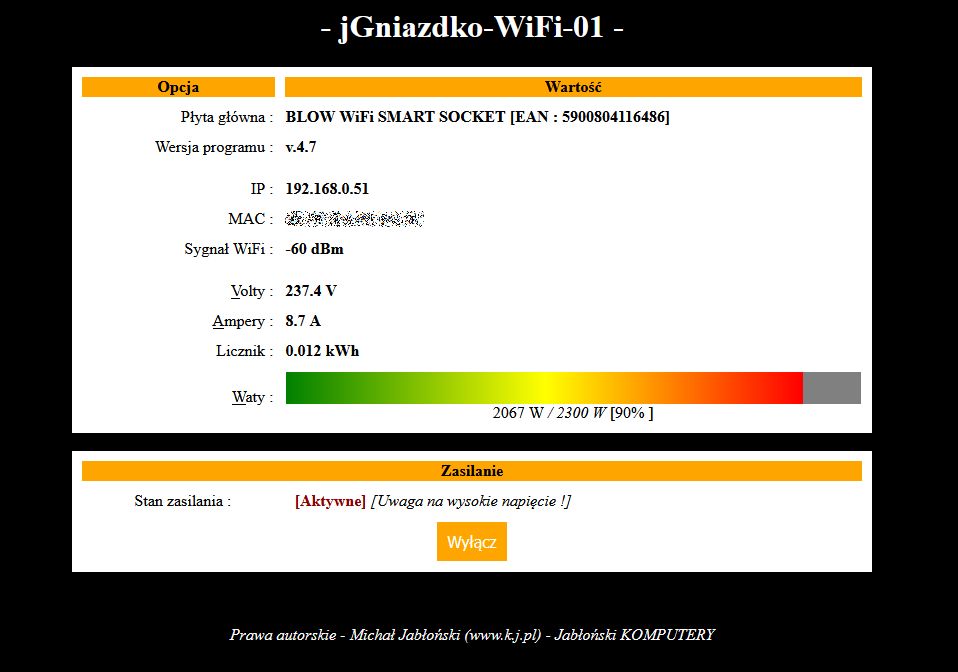

    I converted a BLOW WiFi SMART SOCKET (about 25 PLN on Allegro) with Volt and Amp meter just like that. All the pins match, only for the LED instead of GPIO2 I used GPIO14 because under 2ka is the built-in LED in the ESP8266.
    I soldered out the CB2S module using braid and soldered a clean ESP8266MOD chip in its place with wires to these pins. On the ESP8266 I connected the EN pins with a 10k resistor to VCC and GPIO15 with a 10k resistor to GND. This fits snugly, no extra PCB to the ESP8266 will go in.
    I have currently uploaded SUPLA on a test basis and it works ok, ultimately I want to write my own program in the Arduino IDE.

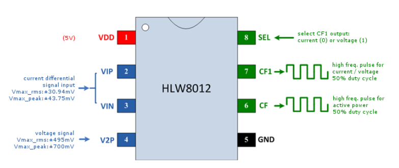

    Have you calibrated?
    The watts are on CF, and the current and voltage are on CF1. You need to set the state on SEL.
    Diagram of the HLW8012 integrated circuit with pin labels and functions. .

    I obtained the same CB2S smart plug as OP. Initially I had problems with flashing, but after I removed the module and set the reply delay to 5 and everything worked smooth as butter. I can post the JSON and backup but they match OP:

    #44 21275863
    mjab
    Posts: 188
    Rate: 15
    Web interface of a smart WiFi socket showing device status and energy consumption. .

     int SilaWiFi = WiFi.RSSI();
     if (SilaWiFi < -65) html += "<tr><td style='text-align: right;'>Sygnał WiFi : </td><td style='text-align: left;'><b>" + String(SilaWiFi) + " dBm</b> [ SLABY SYGNAŁ ! ]</td></tr>";
     else html += "<tr><td style='text-align: right;'>Sygnał WiFi : </td><td style='text-align: left;'><b>" + String(SilaWiFi) + " dBm</b></td></tr>";
     html += "<tr><td style='text-align: right;'> </td><td style='text-align: left;'> </td></tr>";
     html += "<tr><td style='text-align: right;'><u>V</u>olty : </td><td style='text-align: left;'><b>" + String(Volty,1) + " V</b></td></tr>";
     if (Ampery < 0.1 and Ampery > 0) html += "<tr><td style='text-align: right;'><u>A</u>mpery : </td><td style='text-align: left;'><b>" + String(Ampery,2) + " A</b></td></tr>";
     else html += "<tr><td style='text-align: right;'><u>A</u>mpery : </td><td style='text-align: left;'><b>" + String(Ampery,1) + " A</b></td></tr>";
     if (kWh > 0) html += "<tr><td style='text-align: right;'>Licznik : </td><td style='text-align: left;'><b>" + String(kWh,3) + " kWh</b></td></tr>";
     html += "<tr><td style='text-align: right;'><u>W</u>aty : </td><td>";
     float wattPercentage = (Waty / MaxWaty) * 100;
     if (wattPercentage > 100) wattPercentage = 100;
     else if (Waty < 1) wattPercentage = 0;
     html += "<div class='progress-bar'><div class='color-bar' style='width: " + String(wattPercentage) + "%;'></div></div>";
     if (Waty > 0 and Waty < 1) html += "<span><center>" + String(Waty, 1) + " W <i>/ " + String(MaxWaty,0) + " W</i>  [" + String(wattPercentage, 0) + "% ]</center></span></td></tr>";
     else html += "<span><center>" + String(Waty, 0) + " W <i>/ " + String(MaxWaty,0) + " W</i>  [" + String(wattPercentage, 0) + "% ]</center></span></td></tr>";
     html += "</table><br>";
     html += "<table>";
     html += "<tr><th colspan='2'>Zasilanie</th></tr>";
     html += "<tr><td style='text-align: center;'>Stan zasilania : </td><td>";
     int StanGPIO15 = digitalRead(15);
     if ((StanGPIO15 == HIGH and Volty > 0) or Waty > 0) html += "<b class='status-active'>[Aktywne] </b> <i> [Uwaga na wysokie napięcie !]</i></td></tr>";
     else html += "<b class='status-inactive'>[Wyłączone]</b></td></tr>";
     html += "<tr><td colspan='2' style='text-align: center;'>";
     if (BlokadaPrzycisku == 0) html += " <button onclick=\"window.location.href='ustaw?blokada=tak'\">Zablokuj</button> ";
     else html += " <button onclick=\"window.location.href='ustaw?blokada=nie'\">Odblokuj</button> ";
     if (StanGPIO15 == HIGH) html += " <button onclick=\"window.location.href='ustaw?zasilanie=0'\">Wyłącz</button> ";
     else html += " <button onclick=\"window.location.href='ustaw?zasilanie=1'\">Włącz</button> ";
     html += " <button onclick=\"window.location.href='ustaw?wyzeruj=tak'\">Reset kWh</button> ";
     html += " <button onclick=\"window.location.href='ustaw?restart=tak'\">Restart</button> ";
     html += " <button onclick=\"window.location.href='update'\">Aktualizacja</button> ";
     html += "</td></tr>";
     html += "</table>";
     html += "<br><br><br><i>Prawa autorskie - Michał Jabłoński (www.k.j.pl) - Jabłoński KOMPUTERY</i></center></body></html>";

    All the code looks like this and works. There is already button support and sending to Domoticz works.
    To control the relay in Domoticz we have the url http://192.168.x.x/ustaw?zasilanie=0/1 (1 = on, 0 = off).
    It is also possible to restart it under the url http://192.168.x.x/ustaw?restart=tak and we can change the kWh status under the url http://192.168.x.x/ustaw?kwh=1.123.
    You can update the software at http://192.168.x.x/update and upload the compiled *.bin file there.
    This works fairly stably and the measurements seem quite accurate. Apparently there are poor quality 3.3v power supplies in these plugs, and there is something in that, because after removing the cube from the power supply you can feel that the "pins" are slightly warm. However, there seems to be no way to save some current to "unload" the stabilisers. :)

    I have several smart plugs with energy meter that have the same PIN configuration as the plug in the topic, but a bit different designation RMC005. CB2S board has more recent (as I understand it) version number.
    Close-up of a circuit board with visible electronic components, markings, and traces.CB2S board with BK7231N chip and other electronic components.Close-up of a circuit board with markings RX2, TX2, and CSN.
    I flashed one of them with no problem, but had to de-solder CB2S board first. For some reason I could not make flashing work when I soldered wires in place.
    In any case, my question is this:

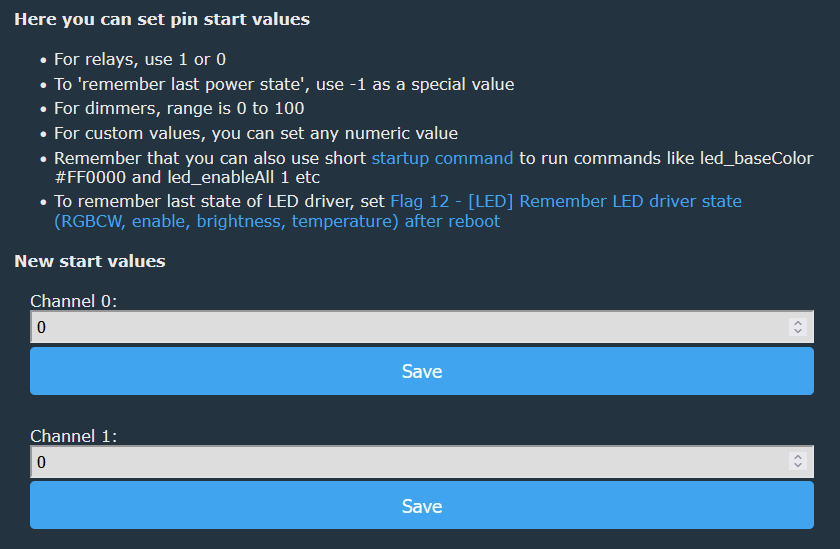

    All in all, it is not just about features/commands but how to expose them to Home Assistant in a form of buttons/sliders/etc. Can you point me to explanation(s)? I'm very very new to all these things. And, I guess, I'm not the first one with such questions.
    I saw it in WEB APP, but am looking into a way to trigger it from HA.
    Relay status - we have gui (startup menu) and command for that
    Are you talking about this menu?
    Pin start value setting interface with channels for saving.
    Light mode - set AlwaysHigh, or AlwaysLow, or LED or LED_n or WiFiLED
    Can you point me to a link where I can read about these? (Found the doc about it)
    Overcharge Switch - could be scripted, scripting samples are here, including the "trigger event when energy exceeds" https://github.com/openshwprojects/OpenBK7231T_App/blob/main/docs/autoexecExamples.md
    If you need a working script, tell me, I can try to prepare one later.
    Such script might be usable not only for me. When I plug the plug into socket (with metering capabilities) the plug initializes connection but stays OFF (by default), and meter shows that the plug consumes around 0.2Wh in "wifi-connected" state, but once I press the On/Off switch the metering socket starts to show 1.1-1.2Wh. So, I guess, people which are used to save every bit of electricity might benefit from such script.
    From the description I understood that once flag set it will ignore any button presses, however in original Tuya firmware you had to hold the button pressed for 4 seconds to unlock the child lock. How does current implementation work?
