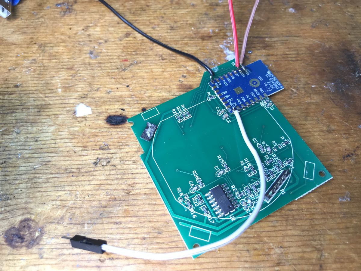

    We solder four wires:
    Close-up of a circuit board with wires soldered to a module
    Here`s my whole layout:
    Workbench with a circuit board connected to a breadboard with wires

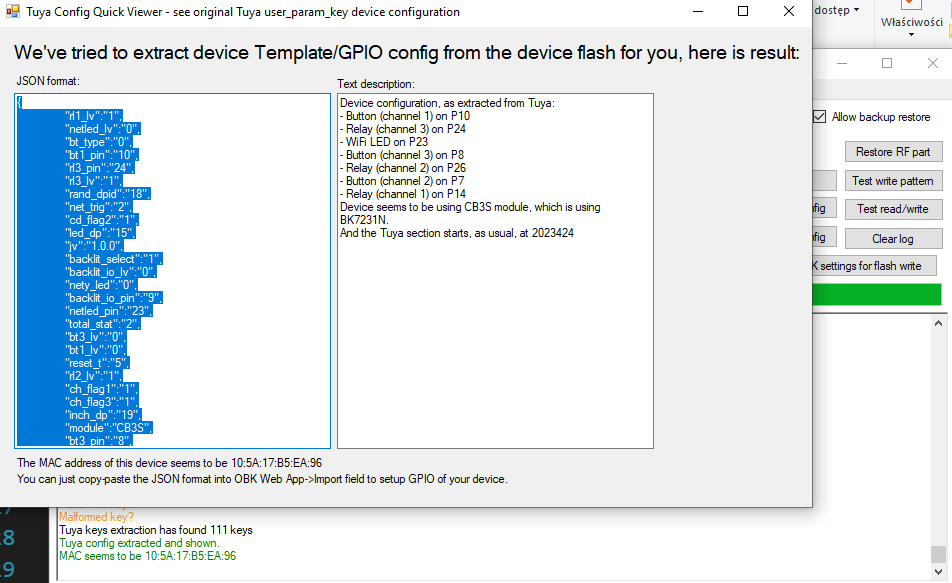

    Flasher is able to correctly load the Tuya configuration:
    Screenshot of Tuya configuration for AVATTO TS02-EU-W3 device.
    2MB copy of the batch:
    https://github.com/openshwprojects/FlashDumps/commit/54d00ea1ed2031dba8180b3e7fb0b14181a91026
    OBK template:
    After such configuration, it can be connected, for example, to Home Assistant : :
