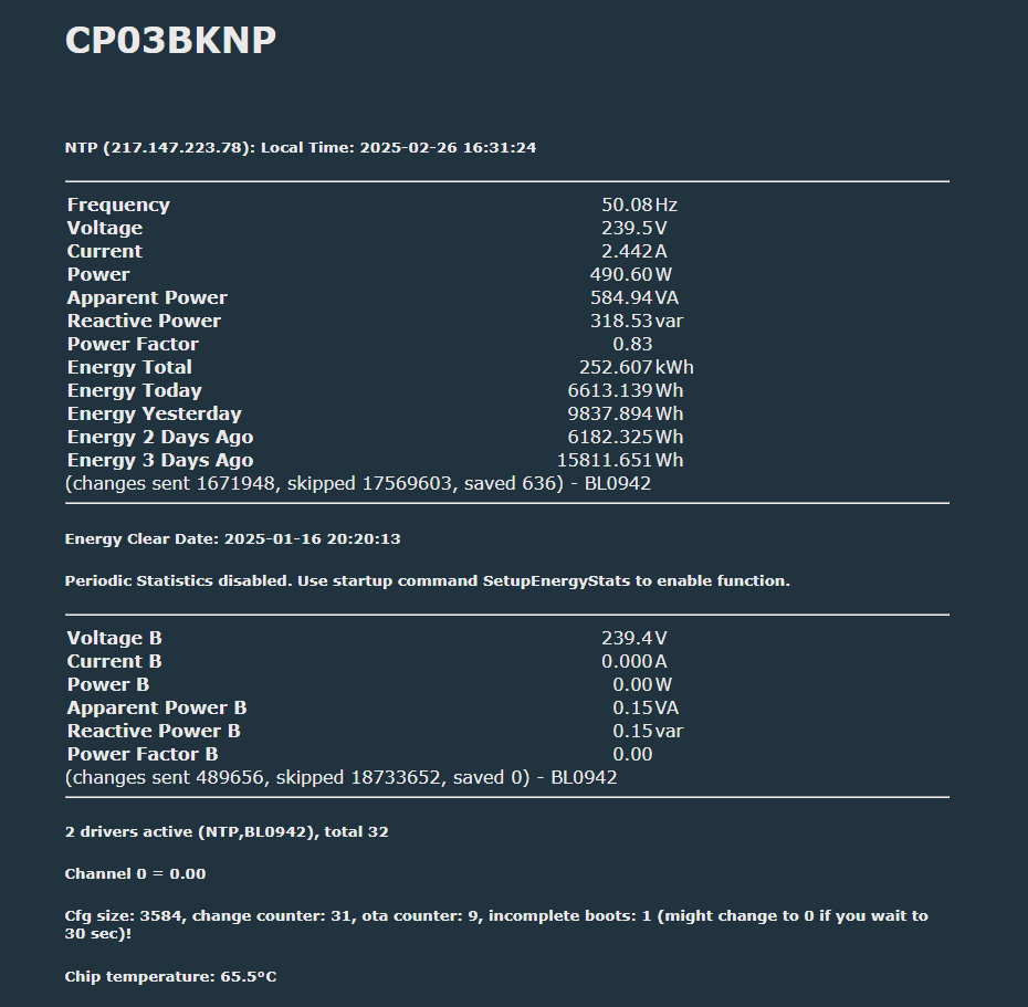

    WebUI using two BL0942:
    Display with electrical energy data.

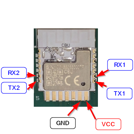

    Flashing instructions:
    Always use an external power supply [3V3] to ensure sufficient power. As bonus, on most devices you don't need to connect the CEN pin and just turn off/on to start flashing.
    1. Connect the CBU module to the USBTTL converter using the CBU pins:
    VCC , GND , RX1 , TX1
    Electronic module highlighting RX1, TX1, RX2, TX2, GND, and VCC connections.
    2. Backup the original using BK7231Flasher.exe
    - select the correct com port + speed (my USBTTL converter works fine up to 1500000 baud for BK7231N)
    - processor set type BK7231N
    - read backup
    - on / off - reading flash will start
    3. Compile your own flash for BK7231N with the ENABLE_BL_TWIN flag enabled
    - save the compiled bin to the BK7231Flasher.exe folder with the firmware
    4. Upload a new flash using BK7231Flasher.exe
    - select correct com + speed 1500000
    - select compiled bin (the one with ENABLE_BL_TWIN enabled)
    - flash backup write
    - on / off - flash write starts
    4. BK7231Flasher.exe - Change OBK settings for flash write
    - set SSID+pass
    - write only OBK configuration
    - on / off - obk config write starts

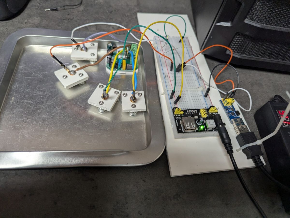

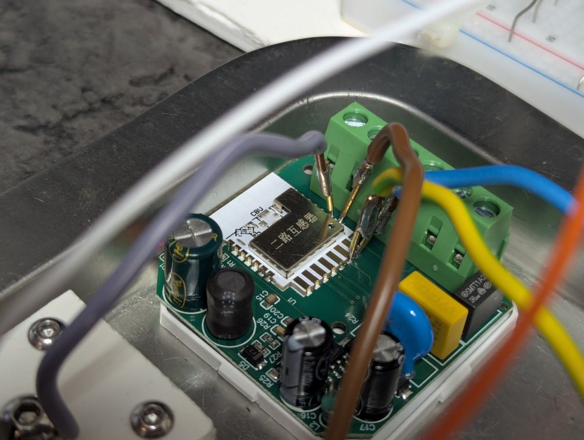

    This is my "How do I that"
    Electronic circuit with sensors placed on a metal tray
    Using "spring contacts" pins without soldering.
    Circuit board with connected wires and electronic components.

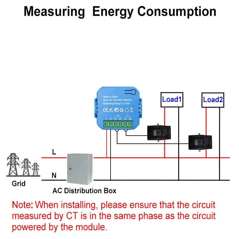

  • Twin BL0942 better suited to one-phase dual load measurement
    #5 21459166
    _Arecki_
    Posts: 247
    Rate: 110
    it is useful for various energy measurement purposes, such as finding out which phase is using the most electricity
    Different phases are probably hard to measure, or at least accurately, as there is only one voltage input. So it could well measure the energy consumption of two consumers on one phase.
    And this is probably what the manufacturer suggests.

    On each of them, the main BL0942 /UART1/ measures the total power consumption of that particular phase. The second BL0942 /UART2/ on the same phase, for measuring the heating consumption. That way I get the total consumption plus informatively how much of that it is the heating.
    For those who don't know, one device with two measuring clamps CANNOT be used to measure two phases (it would give a meaningless power factor).
  • #7 21459616
    Posts: 14771
    Rate: 12914
    Correct, I meant it's good for two different devices, not phases. This device is single phase only.
