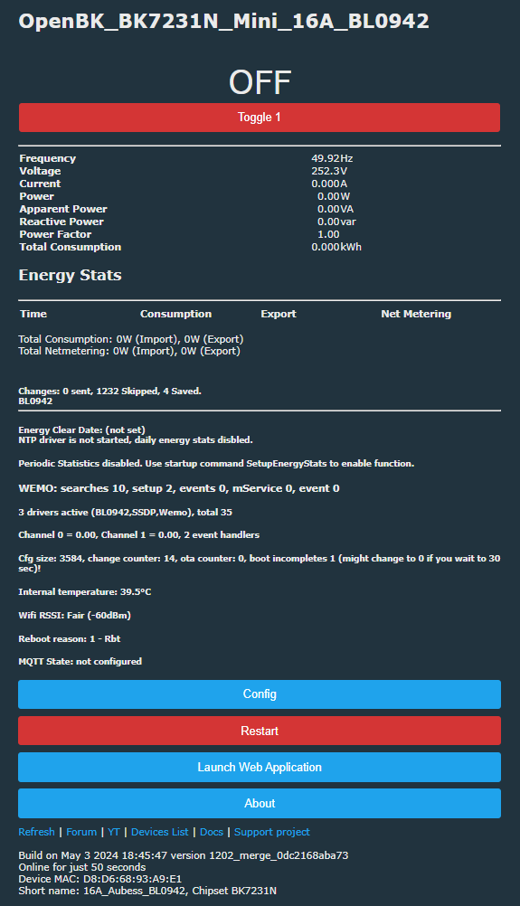

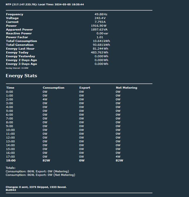

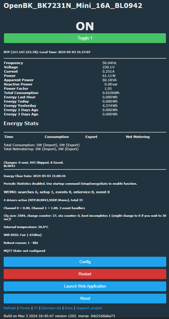

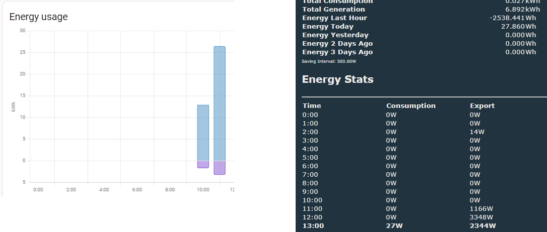

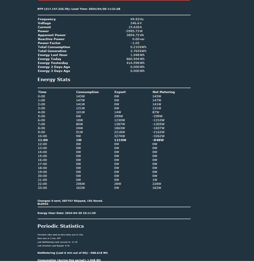

    I made some modifications to the code, after trying it for a few days and looking into how the utility companies process net billing.
    It works as follows:
    AC meters still report everything that goes through them. They have no facility to average out the power. What they do is they report the meter readings to the supplier with a time stamp. The supplier them makes adjustments based on your production and consumption and the level of netmetering they give you, if any at all.
    So all of a sudden, the readings on your smart meter are useless as they do not correspond to the data used by the supplier for billing, altough presently this is to the consumer advantage. One should be carefull if changing supplier, though. At some point, I would expect utilities to just remove netbilling, as without a separate counter on the meter itself to calculate the average - this is all a big mess!
    So I decided to leave the consumption meter as is, and the export meter to measure export, instead of netmetering.
    These values will then match the supplier meter readings, so can be used to check the accuracy of both systems.
    That leaves us with the need for a third counter - which is the netmetering for period set by the supplier. What we are actually being billed upon - and what we can use to better make use of our produced energy, including running automations.
    For debugging purposes, I came up with this table which shows the total values for a period of 24h
    Screenshot of energy consumption and net metering data.
    Presentlly stored on RAM - They are not permanent - altough I would like them to be (for 24h), if there is such option.
    3 arrays each with 24 positions of 1 integer (144 bytes - numbers are stored as an int, as they never go too high)
    Meanwhile, values for Netmetering are stored every hour. We do loose some data if the device crashes, but then we limit a whole house system to less than 30 writes a day, which is fantastic. Consumption and export, because they are based on real values now, can be saved as they originally were, based on a threshold.

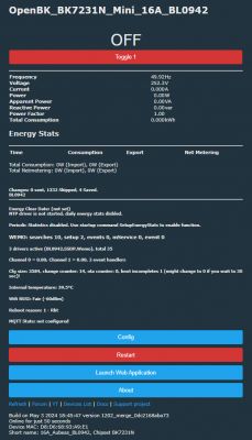

    Here are the last changes to the code:
    Table with hourly stats for energy consumed, exported and averaged under netmetering, stored on RAM (Clears on restart).
    New Flags:
    'OBK_FLAG_POWER_ALLOW_NEGATIVE' -> Allow measurement of negative energy
    'OBK_FLAG_POWER_INVERT_AC' -> Invert the direction of AC Power flow, as some devices measure backwards: (Import + / Export -)
    'OBK_FLAG_NETMETERING_15MIN' -> Calculate 15min Netmetering
    'OBK_FLAG_NETMETERING_60MIN' -> Calculate 60min netmetering
    Periodic statistics are enabled with the above two flags and the correct time (15min or 60min) is selected. Changes require a reboot.
    Periodic statistics now measure positive and negative values (The value matches Netmetering, updated once a minute)
    Removed remote relay code. Instead variable 'dump_load_relay' was used for automation purposes with the following statuses:
    - 1: The load is on. There is sufficient solar energy exported.
    - 2: The load is on in Bypass mode. The time can be set by variables: 'bypass_off_time' and 'bypass_on_time' which should be loaded with a value between 0 and 23. Provided the total run time was less than the one set in variable 'min_daily_time_on' which represents minutes the load was on
    - 3: The load is off due to insuficient exported energy
    - 4: The load is off due to overload. The variable 'max_power_bypass_off' is used to indicate the overload value. It should be loaded with a positive value, representing Watts. It takes 3 minutes to reset.
    Notes: For suppliers without Netmetering arrangments, only the Consumption and Export fields apply (Ignore Netmetering and Consumption during this period fields).
    The Starting command should be set to Enable Powersaving, BL0942 and NTP with the correct time zone.
    Example: backlog Powersave 1; startDriver BL0942; startDriver NTP; ntp_timeZoneOfs 2;

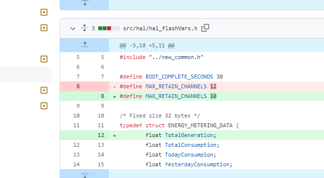

    I have made a series of merges to the main repository. Most of this was manual and needs testing once approved.
    The changes were mostly on drv_bl_shared.c and BL0942.c so shoudln't really impact anything else.
    I still didn't fix the MAX_RETAIN_CHANNELS 10. So maybe you can help me with that? I will aneed to add a new variable for netmetering, which will require two more channels, so it's a good point to review that.

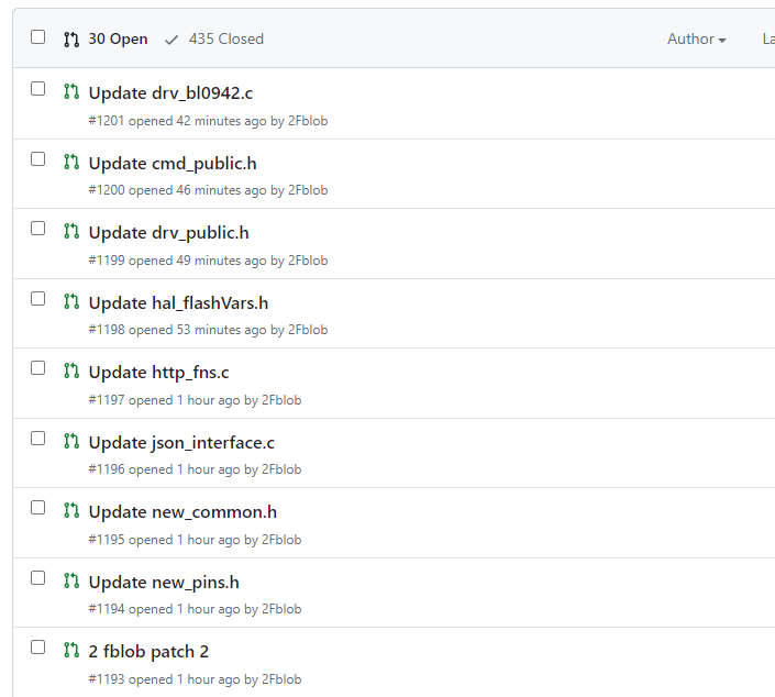

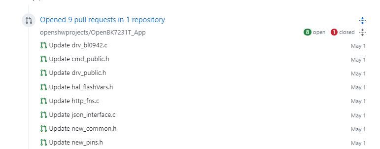

    @cdtdsilva wait a moment, before I answer, can you fix your Git branch? You are opening many pull requests to main repository...
    List of open pull requests on GitHub, including details such as file name and time opened.
  • #41 21066947
    cdtdsilva
    Posts: 171
    Rate: 15
    Screenshot of a repository showing 9 pull requests, with 8 open and 1 closed. I have cancelled the last one, but need those 8 to be aproved.
  • #42 21066960
    Posts: 14637
    Help: 655
    Rate: 12649

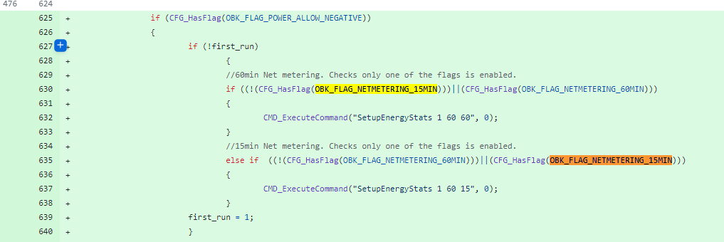

    I think you should create one single PR, creating multiple PRs makes users unable to test your code before merging it.

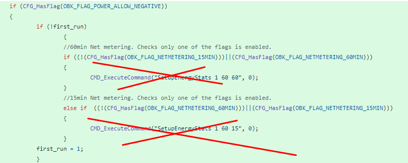

    Futhermore, what is the purpose of extra flags? Why not just let users run the command from autoexec.bat?
    Screenshot displaying a segment of source code with flag checks and the `SetupEnergyStats` command.
    You are hardcoding:
    SetupEnergyStats 1 60 60
    the same can be put in autoexec.bat by user...

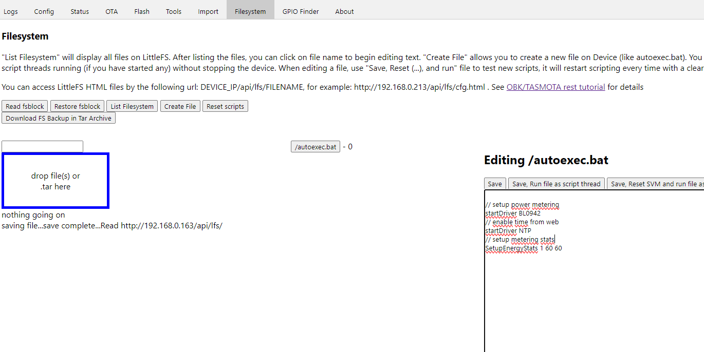

    This form is much better, good job:
    https://github.com/openshwprojects/OpenBK7231T_App/pull/1202
    You can also look into Github GUI (download github gui for desktop) to learn how to manage pull requests more easily.
    cdtdsilva wrote:
    Can you compromise a bit for now?
    Those changes will only apply to users that enable both reverse energy flag and one of the default set netmetering options.
    If they are not enabled, a random value can be selected for the time stats. It's just that at present there is no variable to save the netmetering values, so I carefully set them to save in the ram, so that they can be tracked in one hour intervals.
    But is it possible to just tell users to run:
    in autoexec.bat instead of this:
    Screenshot of C code with crossed-out lines.
    Something like:
    Screenshot of the Filesystem interface on the OpenBK7231T application configuration page.
    would this work instead of two hardcoded flags? Can you try?
    I am requesting this change because of multiple reasons:
    1. we have a limited number of flags
    2. it's a bad practice to use two flags as a select between 3 states (60 interval, 15 interval, no metering)
    3. it's a bad practice to use a flag as a wrapper for a console command call....
    cdtdsilva wrote:
    Once the code is pushed I can then work on making further changes. I just think it's important I can debug the final release and others can also use the code and provide feedback on any bugs.
    Pushing code to main repository means it goes to releases for everybody, that's why I am asking for changes first. We must be sure not to release something causing issues for users.
    cdtdsilva wrote:
    The next step would be to use the command line, simplify the netmetering functions and fix the variables for the total generation and net metering.
    If you want to split ,then let's first finish the current version so it meets basic requirements so I can integrate it ,then we can make a better version.
    Anyone can download PR binary from:
    If you don't know how, see:
    https://www.elektroda.com/rtvforum/topic4033833.html#20946719
    #45 21069092
    cdtdsilva
    Posts: 171
    Rate: 15
    That's not a problem.
    I'll have to re-write the software, which sould in principle not require the flags, if the user manualy sets time statistics.
    Since Netmetering at 60min is already implemented on the tables and that removing the flags will break compatibility with 15min calculations (as currently implemented), I have disable that section of the code. Later on, when I re-write the software thet can be added again.
    I've made changes to patch 3. Can you check it reflected them, or should I cancel the flow and send it again?
    Thanks

    This PR looks better now:
    Now, the question is, how much is it tested? How much do we test it? @DeDaMrAz , @divadiow , would you be able to give it a try before we merge it? I can also try flashing it onto my BL0942 socket as well.
    @cdtdsilva , do you use it with Home Assistant? Is Home Assistant discovery still working?

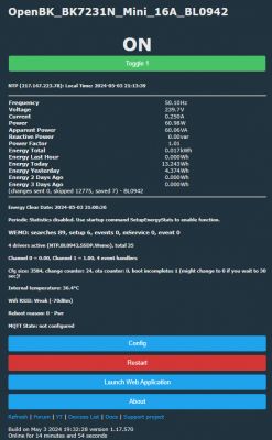

    Hi. I've not been following this change. I have maybe two BL0942 devices that I can flash. Not sure what's requested beyond that yet. I need to read through thread.
    Added after 45 [minutes]:
    two devices before and after
    Control panel of the OpenBK BK7231N Mini 16A device with BL0942 chip. Screenshot of the OpenBK software interface for the BK7231N Mini 16A device with BL0942 chip.
    OpenBK user interface showing device information and configuration options. Screenshot of the OpenBK user interface for the Atorch device showing electrical parameters and settings.

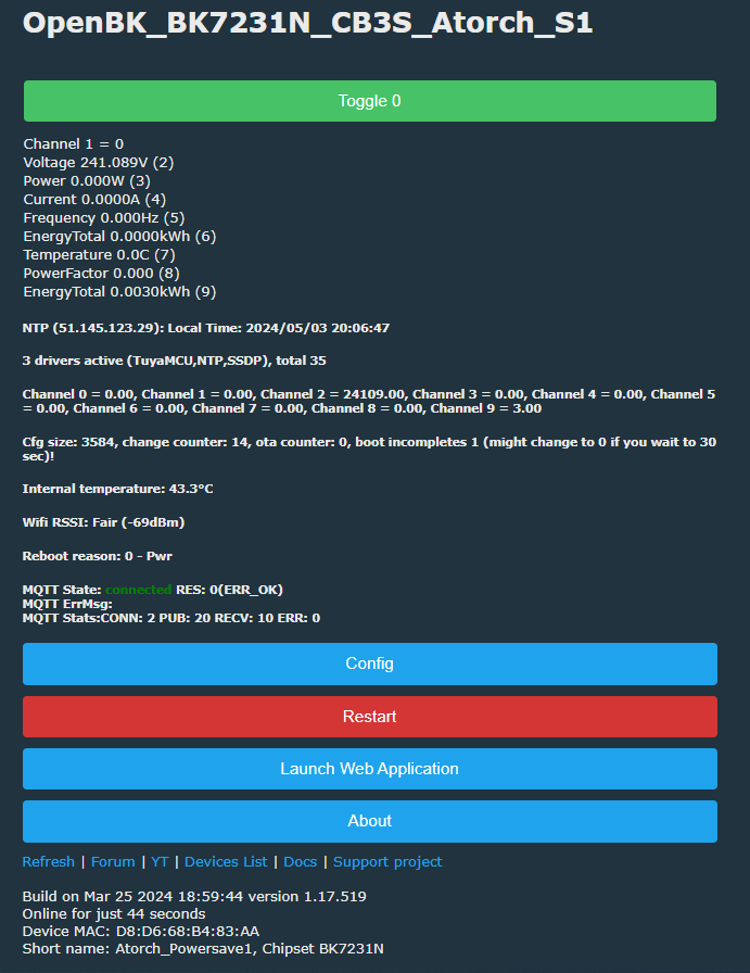

    lol. was wondering why the Atorch GUI didn't change. TuyaMCU of course.
    what am I testing with the Mini 16A? Totals over the next few days? I don't feed any power back into the grid...

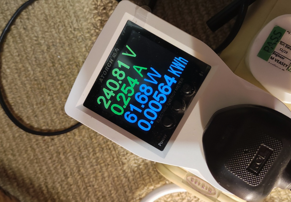

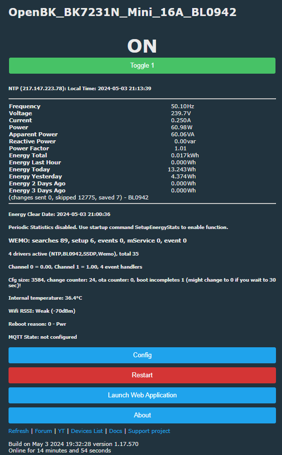

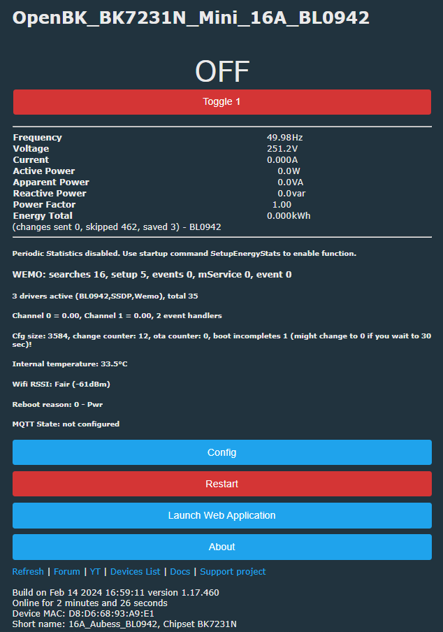

    Posts: 5076
    Help: 441
    Rate: 899
    calibrated with a 60w incandescent
    Electric energy meter display showing voltage, current, power, and energy consumption.
    before
    Screenshot of the OpenBK_BK7231N device user interface displaying energy consumption data.
    after
    Energy statistics panel of OpenBK device displaying various energy consumption data.
    Added after 9 [minutes]:
    why does today's energy count reset after flashing but yesterday's stays untouched?
    Added after 5 [minutes]:
    the previous today count does not return if you flash back

    The startup commands text is required:
     backlog Powersave 1; startDriver BL0942; startDriver NTP; ntp_timeZoneOfs 2; SetupEnergyStats 1 60 60
    I will check the case with the yesterday's counter.
    By default it should save too frequently. I changed the save threshold so I wouldn't toast the flash on my module. Need to check whenever that part of the code was put back as it was. I will also use a line on autoexec.bat to define the save threshold
    The following will help check the code:

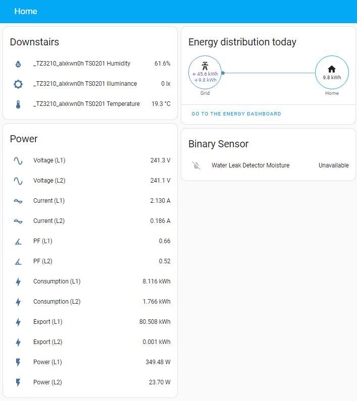

    - Enable Flag 25. If the value of energy is positive, tick Flag 48. The values should now be negative. See whenever that incremets the export counter. If so, restart the module through the webinterface (that ensures is saved). Upon restart check the counter value is saved.
    - Flash back the stock firmware and see whenever any of the counters changed. For example - Are they still the same values? The export should disapear but the rest should remain unchanged.
    Home assistant discovery works fine. Actually need to restart mine to compare the readings with my energy supplier.
    Control panel displaying energy consumption data and other parameters in a home.

    I cloned today's version of openshwprojects and manually copied over the changes.
    Energy today wasn't assigned to either consumption or generation counters. That's now fixed and linked to consumption.
    @p.kaczmarek2 - I need to change the variable 'energyCounterSampleInterval' from the default 10W a higher value. Can you tell me the correct syntax to do so on the startup commands?
    Thanks
    Screenshot of an energy statistics table with data on frequency, voltage, and consumption.

    I found another bug,
    The KW hour settings are not being divided by 1000 for consumption, when they are sent via MQTT
    I will push an update and report back later
    Energy usage chart with textual data on the right side.
    Added after 8 [hours] 26 [minutes]:
    Done.

    Which is the most recent version, that one?
    https://github.com/openshwprojects/OpenBK7231T_App/pull/1211/files
    If so, there is still at least one change pending - the one where I said I would prefer to reuse two last retain channels instead of adding a new float field
    Screenshot of comparison changes in the file src/hal/hal_flashVars.h.
