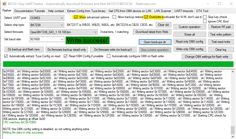

    try revealing advanced options and choosing to overwrite bootloader. I have just done this on mine and it boots into OpenBeken and broadcasts AP
    Screenshot of the BK7231 Easy UART Flasher program with a Write success! message indicating successful firmware writing.

    So... AP still doesn't appear:
    BK7238_1.0.14

    actually. oddly mine wasn't going straight into AP mode after initial burn, even though I made a point of erasing entire flash first in BKFIL. Do 5x resets to get into safe mode - does it broadcast then?
    Added after 7 [minutes]:
    erased and reflashed again. AP mode straight away now for me.

    Made "Erase all'
    Then Do firmware write with overwrite bootloade
    No AP (even after 5 time power toggle)
    Did Firmware write again.
    Still no AP.
    go os_addr(0x10000)..........

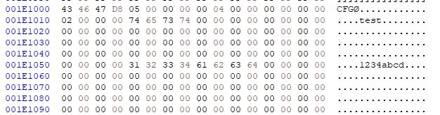

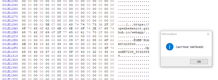

    this may not answer your question, but initial run after erase/qio flash gives me the same
    joining test AP writes config to 1E1000
    A file fragment displayed in a hex editor, showing data in hexadecimal and ASCII format.

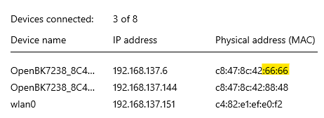

    and custom mac set works for initial reconnect after mac change (it does not reboot) but then reverts to previous mac on subsequent boots.
    A section of a connected devices list showing device names, IP addresses, and MAC addresses; one MAC address segment is highlighted.
    (on another note, that wlan0 name is a BK7231T running _7231u_t_c1b0ac146bf0)

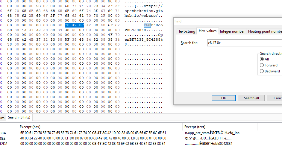

    a dump while in this custom-mac mode shows new mac has not been written anywhere
    Screenshot of a hex editor and a pop-up message stating Can't find 'c8478c426'.
    maybe custom mac was not done for BK7238?

    Do you search for MAC as ASCII string or as hex bytes?
  • #222 21564301
    Posts: 5095
    Help: 441
    Rate: 900
    both. with and without spaces. only hex shows any result and original mac

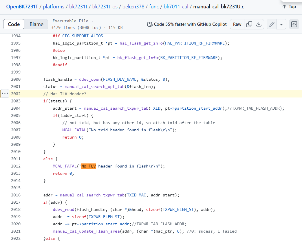

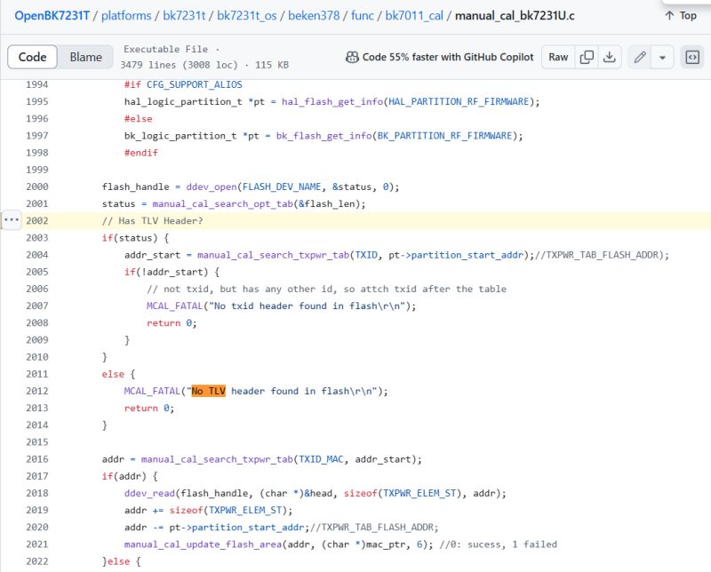

    There are multiple ways to save MAC:
    Code: C / C++
    This is BK7231T SDK, not BK7238, but similar.
    https://github.com/openshwprojects/OpenBK7231...1t_os/beken378/app/config/param_config.c#L109
    Interestingly enough, I can't find there "no TLV header" warning?
    No, this is here:
    https://github.com/openshwprojects/OpenBK7231...78/func/bk7011_cal/manual_cal_bk7231U.c#L2002
    Screenshot of C source code from the OpenBK7231T project on GitHub.
    In:
    Code: C / C++
    It seems that on BK7238, it goes into manual_cal_write_macaddr_to_flash option:
    Code: C / C++
    Well even on BK7231 it is set to:
    Code: C / C++
  • #224 21564334
