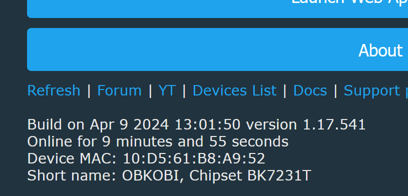

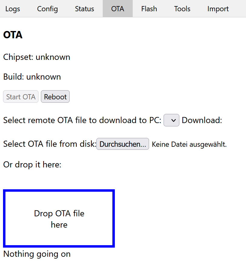

    But the web application Config says:
    The command in the template is empty ("command": "",) and OTA does not work, as the Chipset isn't known:
    View of the OTA application screen with chipset and build data not filled in.
    But:
    Screenshot of application interface with device information.
    So I think, it's a problem of the web app and not of the firmware? (If I shorten the command string, it works...)

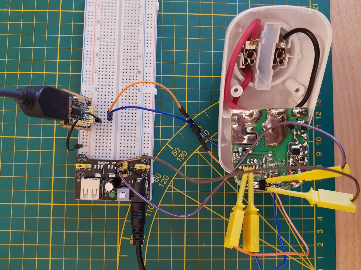

    Thanks for the reply.
    I'm just starting out with OpenBeken and found the startup command handy for simple things - so I tried it that way and suddenly my test socket had partial amnesia. That piqued my curiosity... ;-)
    Was almost about to flash it once again as before...
    Test setup with a breadboard and electronic modules.

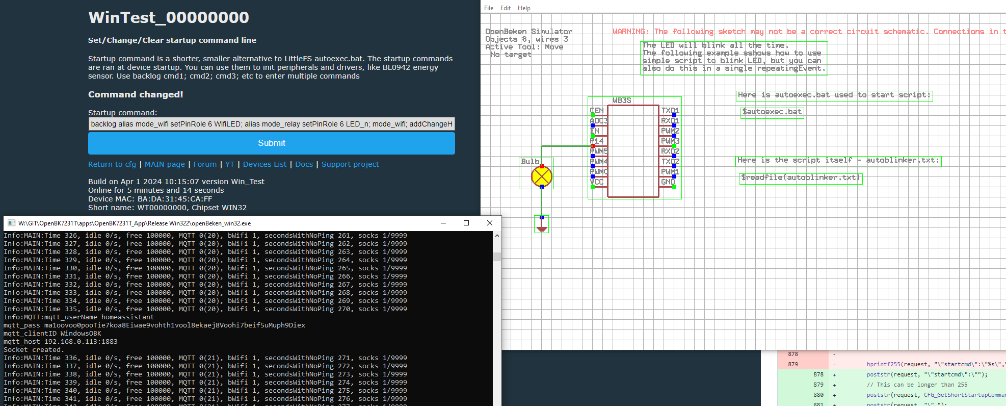

    Thank you again for reporting the problem.
    After a brief investigation, I have concluded that there was an issue with handling startup commands longer than 255 characters and you must have been the first user to try creating such a long command in startup string. Usually, everyone uses autoexec.bat.
    Still, the issue have been found and hopefully should be fixed now:
    https://github.com/openshwprojects/OpenBK7231...mmit/89fc09a921cf7b3a9431b30c09d598ec1c6f7d76
    I have only tested the problem on Windows Simulator:
    WinTest graphical interface with simulator and console.
    So I am currently not sure if it's also solved for you. Can you update to 1.17.542 once it's built and let me know if it works good for you now?
