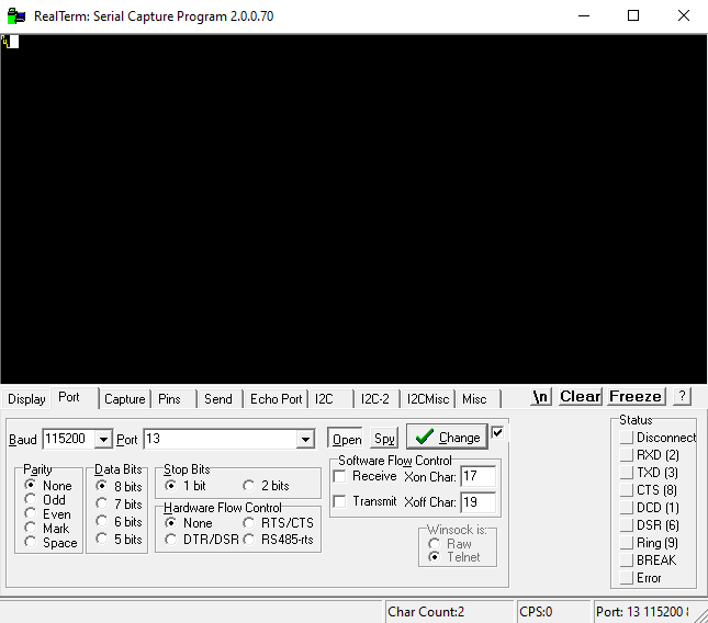

    RealTerm program interface with serial port settings. .
    When connected to 230VAC, as I expected, the device did not connect to the configured wifi network or put up its AP. I tried putting it literally next to the access point, just in case the anetna was that weak, but it didn't do anything.
    I did erase and flash a few more times with different combinations of firmware versions (latest OpenBK7231N_QIO_1.17.777.bin and older) and OBK config but no success.
    Out of curiosity I also plugged in UART2 (Pin 27 RX, Pin 28 TX) but there was no activity there either.
    Could it be that the bootlader is compacted? I didn't combine anything manually around 0x0 and only used bk7231flasher_1.3.3.
    Do you have any idea how to debug this further?
    Thanks a lot, regards!

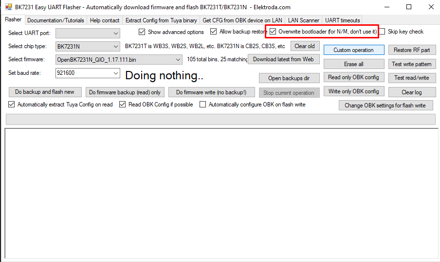

  • Use original 2 MB dump or bootloader to flash OBK
    #32 21323010
    Posts: 14754
    Rate: 12875
    As long as you have a copy of the original 2MB batch, upload it, and then write OBK on it. You may have done a full erase for yourself.
    If you don't have a copy of the original batch, then upload the OBK with the bootloader:
    Spoiler:
    BK7231 Easy UART Flasher user interface with selected settings for flashing. .
    Also, you can try uploading any 2MB dump for the N platform from my base and then record OBK on it:
    https://github.com/openshwprojects/FlashDumps/tree/main/IoT/BK7231N
    PS: The activity is supposed to be TX2, if there's nothing there then the bootloader has probably cleared, but as I wrote above you can fix it.
  • Overwrite bootloader restored UART2 output
    #33 21323031
    marekvnl
    PS: The activity is supposed to be TX2, if there is nothing there, then the bootloader has probably removed itself, but as I wrote above, you can fix it.
    Thank you very much, I used the "overwrite bootloader" option (I thought of this before but was confused by the "for N/M don't use it" note) and the output on UART2 came to life.
    The device is now booting and working properly.
    I attach a snapshot of the original batch, as if anyone ever needs it.
    Thank you and best regards!

  • #34 21323046
    Posts: 14754
    Rate: 12875
    Because in general you shouldn't perform overwrite bootloader, but from the description of the situation it seems that you have already removed it for yourself. Hence the need to do so.

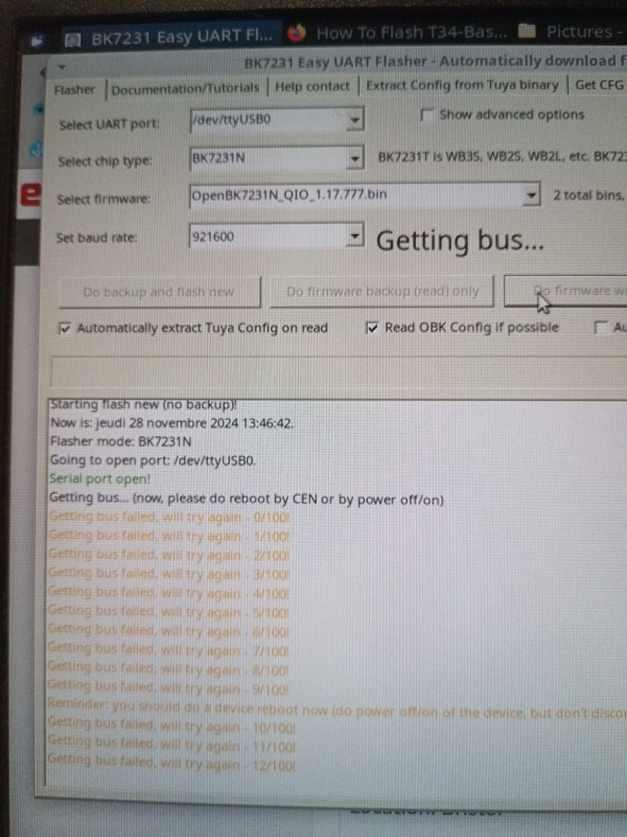

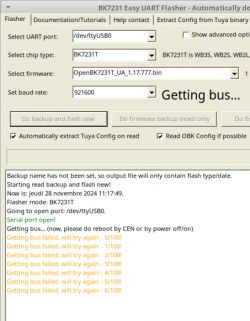

    Hello, I don't start the connection.
    Ubuntu and mono BK7231Flasher.exe
    Screenshot of BK7231 Easy UART Flasher program displaying connection error messages.
    TX of TTL to RX and RX of TTL to TX
    3V3 of USB UART and GND
    I touch the GND for CEN many times, I have many blue LEDs blinking (if I stay on the GND, she stops in blue or in black)
    I have reversed RX and TX for test but nothing.
    Thank you for any help.
    Close-up of an electronic circuit with a connected module via wires and USB UART. Close-up of a display showing an image of an electronic circuit board, with the label WADEO visible.

    T34 is BK7231N chip not BK7231T
    Screenshot of BK7231 Easy UART Flasher program with BK7231T option highlighted.
    and have you tried lower baud rates? 115200

    no_cloud wrote:
    3V3 of USB UART
    This might be a problem, too. You might also try to use another power supply. This adapters usually only supply a very limited current.

  • Clarifying CEN pin and baud rate changes
    #40 21323531
    no_cloud
    Posts: 20
    >>21323475 thanks, I have seen this videos ;-)
    Added after 26 [minutes]:
    ok, i have changed the baud rate and changed type (7231N)
    but nothing.
    I take this video for you see the blinking, it's ok after the reset action?
    Computer screen with BK7231 Easy UART Flasher application showing error messages.
    Big thank for your help!

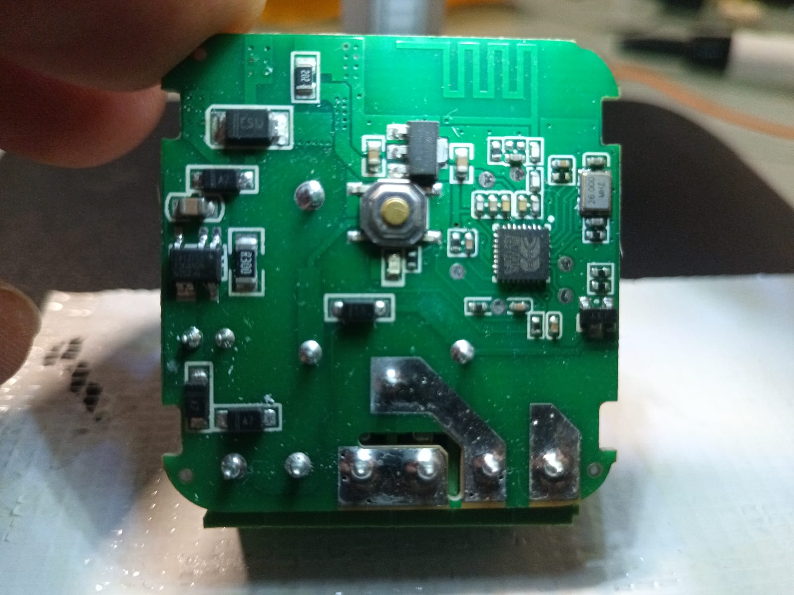

    I have this variant.
    Close-up of a green circuit board with various electronic components.
    Should I post this variant somewhere on the site and then share it?
    Do you have an idea for the ground and the 3V3?

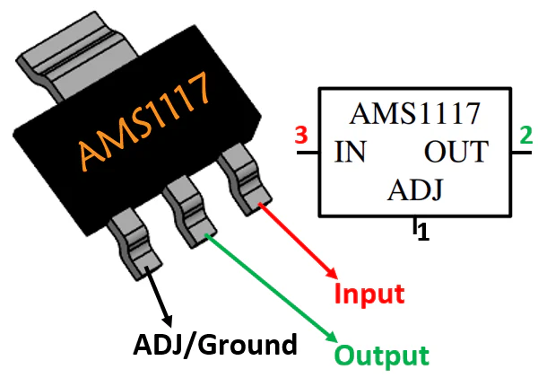

  • #48 21327748
    Posts: 14754
    Rate: 12875
    One of good and reliable methods of finding GND and 3.3V pins is to look for the LDO regulator on the board. Your board has AMS1117-3.3V available, which pinout is widely known, as shown below:
    Diagram of AMS1117 regulator with pin labels.
  • #49 21327808
    no_cloud
    Posts: 20
    Big thanks but I have tried many times.
    I have not the alimentation, I have not the led blinking.
    A other day, maybe ;-)

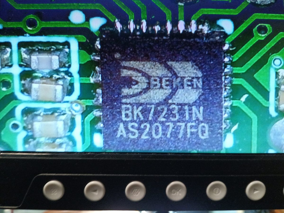

    ok, it's the good alimentation, I have blue blink.
    But I can't flash.
    I have this component, it's the same as T34?
    Close-up of BK7231N integrated circuit on a circuit board.
  • #55 21352205
    zilplayzil
    Yes, T34 is a cod for BK7231N.
  • #56 21352245
    no_cloud
    Posts: 20
    >>21352205
    thanks, I retry ;-)
    Added after 1 [hours] 2 [minutes]:

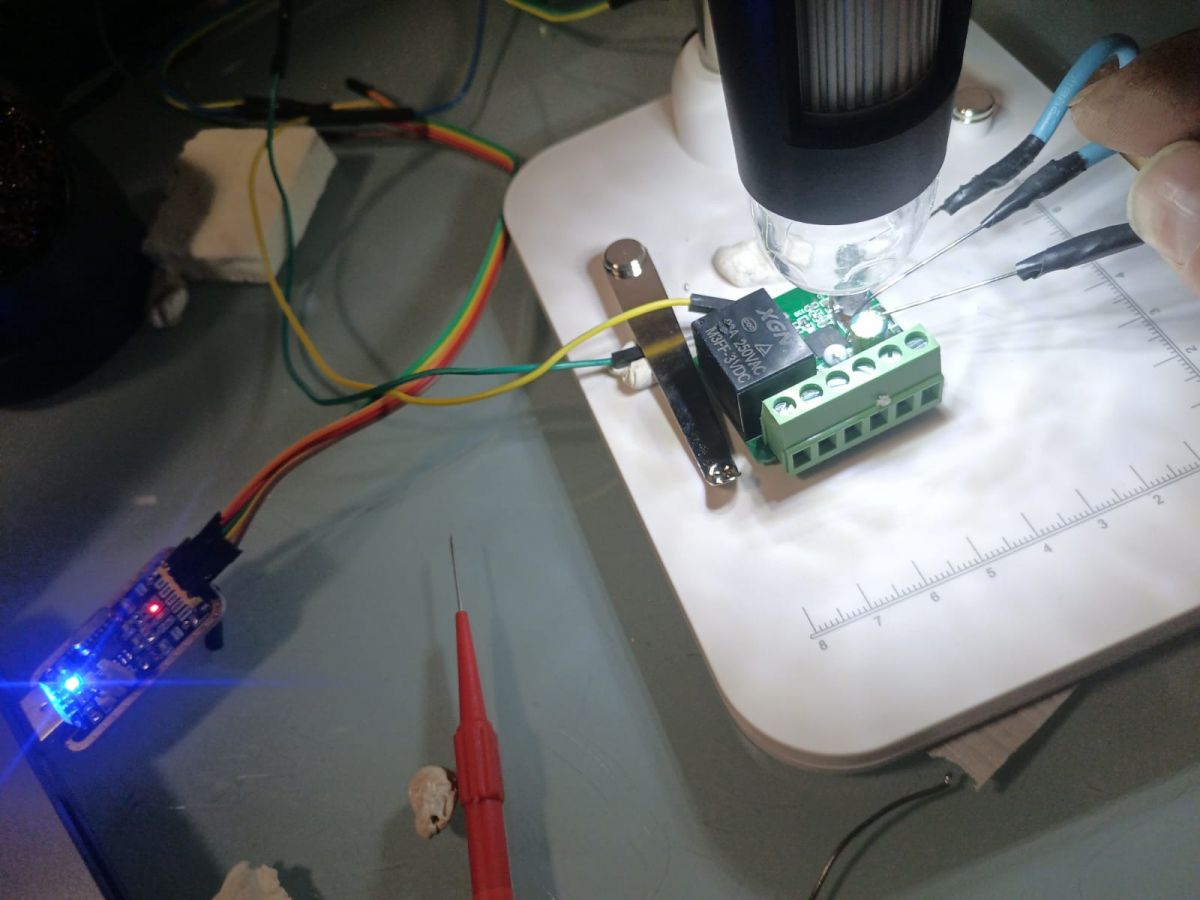

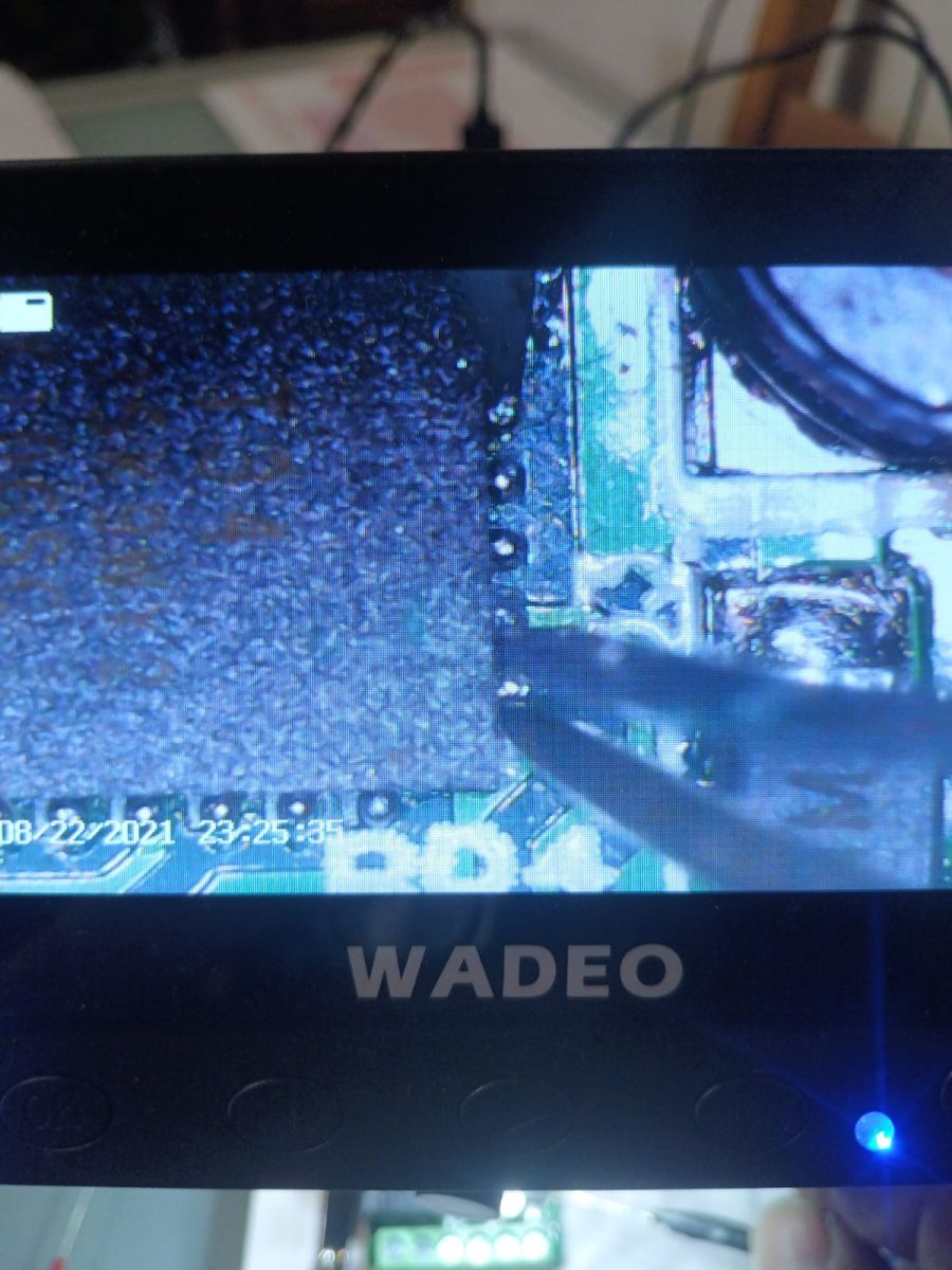

    i'm sorry, i have not falshing thos model.
    i takes photos, do you have a idea?
    i post video for binking.
    Circuit board with attached probes on a desk.
    Close-up of a circuit board with electronic components under magnification.

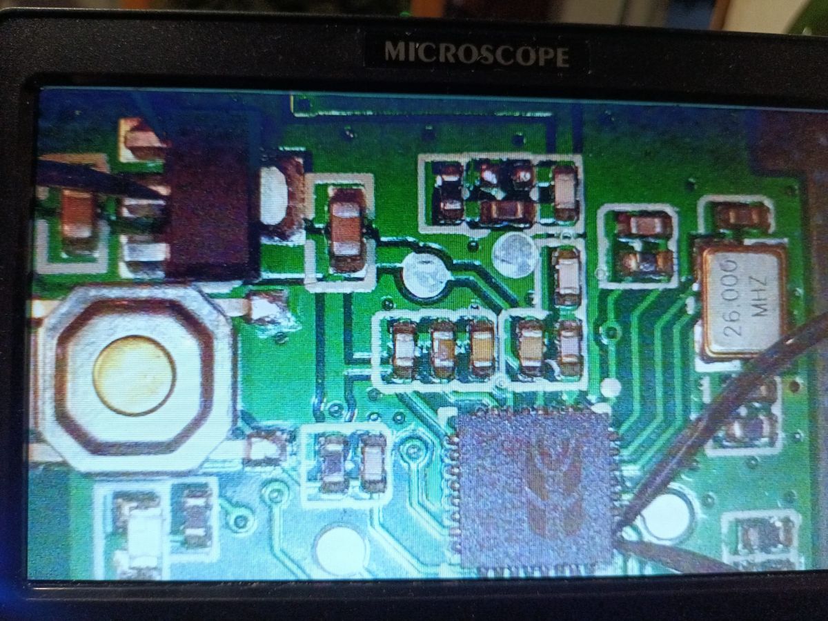

  • #57 21352342
    Posts: 5208
    Help: 446
    Rate: 914
    how come you're going for the legs directly? are these two test pads not RX/TX?
    Close-up of a circuit board with an integrated circuit and traces.

    no_cloud
    Posts: 20
    >>21352342
    Hello, you are in the right, it's pass for test but not for TX, just RX.
    I try this morning....

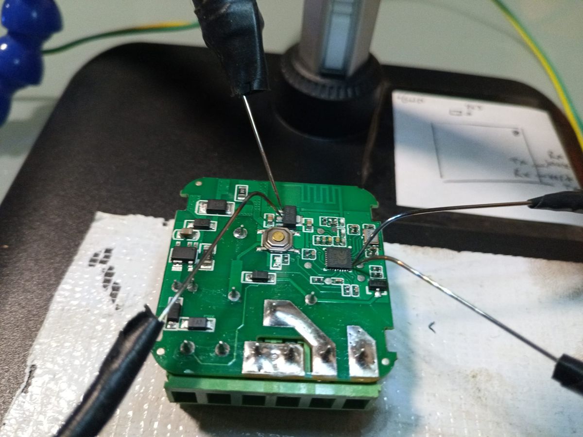

  • Suspected TX/RX wiring and blink-pattern issue
    #60 21355507
    no_cloud
    Posts: 20
    >>21352342
    I think you are in the right!
    I have no T34 but bk7231n and I have read pins is not the last and before but just one before.
    I have moved TX and RX but nothing.
    I don't understand.
    I post 2 videos.
    First for you see my installation (maybe I have a problem? (green for TX in my USB/TTL in bottom in my BK)
    The second video is for the blinking.
    I have seen 3 blinking different, slowly, middle and very fast.
    I think very fast is for flashing.... no?
    ps: my dupont power pin is very bad and a little move is perfect for <250ms stop power and I see the TX light green. It's ok.
    Any help is very appreciated for me. I working 3 days and I have no results.

  • The board mapping reported for the original T34 switch is relay on P15, external S1/S2 on P14, onboard button on P24, and an active-low LED on P6. [#21062328]
  • Multiple users reported that 115200 baud helped unstable reads, but one successful write completed only after switching back to 921600 baud after erase. [#21310912]
  • Power stability matters more than tool version: one failed setup triggered a Windows USB unplug sound every time 3.3 V was reconnected, pointing to inrush or overload. [#21224931]
  • The device backup size shown in the thread is 0x200000 bytes, and a full dump was saved as 2 MB before recovery work. [#21321496]
  • A later hidden-pin board revision may require removing a 10 kΩ pull-up network near pin 25 and microsoldering because pin 26 had no usable pad. [#21523814]

What is the T34 module in these Tuya smart switches, and how does it relate to the BK7231N chip?
T34 is the Tuya Wi-Fi module built around the BK7231N chip. "T34" is a Tuya radio module that provides Wi‑Fi control, and its key characteristic in this thread is a BK7231N-based design hidden or glued onto the switch PCB. Users repeatedly identified these mini switches as T34 boards and selected BK7231N firmware when flashing them. One reply even corrected a failed setup by noting that T34 is BK7231N, not BK7231T. [#21323333]

Where can I access RX and TX on glued-down T34 modules, including the BR4 resistor trick for pin 26?
Access RX directly on T34 pin 25 and access TX either on pin 26 or at resistor BR4. The useful shortcut is that BR4 exposes the TX line on the side marked “4,” while the other side is GND. That leaves only pin 25 to touch on the module itself, which is easier because it sits on the outer corner. Several later users confirmed the BR4 method made contact much easier. [#21264891]
Why does BK7231Flasher read the chip successfully but fail during erase or write on these T34 switches?
It usually fails because the wiring or power is marginal under write load. One user read the full 2 MB dump successfully, including the encryption key, but erase failed at sector 69632 with a serial buffer error. After changing the UART converter, shortening wires, and stabilizing power, the same board erased and wrote normally. Read operations can succeed even when write current spikes expose a weak setup. [#21321513]
What is the best way to power a T34 board during flashing: USB-TTL 3.3V, an external 3.3V supply, or feeding 5V into the AMS1117 input?
Use a solid external 3.3 V supply first; use USB-TTL 3.3 V only as a last resort. Several failures were traced to weak adapter power, while stable external power or a better regulator fixed them. If you avoid a separate LDO, one thread expert suggested feeding 5 V into the board’s AMS1117 input so the onboard regulator still produces 3.3 V, though success depends on the board’s capacitors. [#21357215]
Why does reconnecting the 3.3V wire make Windows play the USB disconnect sound during flashing attempts?
That sound usually means your power setup is overloading the USB port. The thread diagnosis was inrush current from the board’s capacitors or an accidental 3.3 V-to-GND short. In the reported case, reconnecting only the 3.3 V wire still made Windows play the plug/unplug sound, which pointed to a power problem rather than a flasher bug. A stronger supply or separate device power was the recommended fix. [#21224931]
How should I put a BK7231N/T34 device into flashing mode: power cycling VDD, using CEN, or holding the onboard push button?
Power cycling only the device VDD is the most reliable method in this thread. One expert explicitly said he no longer uses CEN because disconnecting and reconnecting VDD works better, while keeping the USB-UART adapter powered the whole time. Another user reported that holding the small onboard push button also made entry easier than cycling power on some units. Use CEN only if VDD cycling is impractical. [#21335520]
When flashing fails on a T34 switch, what troubleshooting steps help most with wire length, baud rate, UART adapters, and contact quality?
Shorter wires, lower initial baud, better probes, and a stronger adapter help most. 1. Keep RX/TX leads under about 10 cm if possible and inspect for bridges under magnification. 2. Try 115200 baud first, then test higher speeds if write fails. 3. Swap the USB-UART converter and verify RX/TX contact with a meter. One expert summarized the process: “it’s fiddly but totally doable.” [#21121760]

What does the 'overwrite bootloader' option do in BK7231Flasher, and when is it appropriate on BK7231N devices?
It rewrites the bootloader area, and you should use it only to recover a board that already lost its bootloader. The maintainer said you should not use overwrite bootloader in normal BK7231N flashing. He recommended it only after symptoms showed the bootloader had already been erased, such as no TX2 startup output and no AP after flashing. In that recovery case, the option brought the device back to life. [#21323046]
