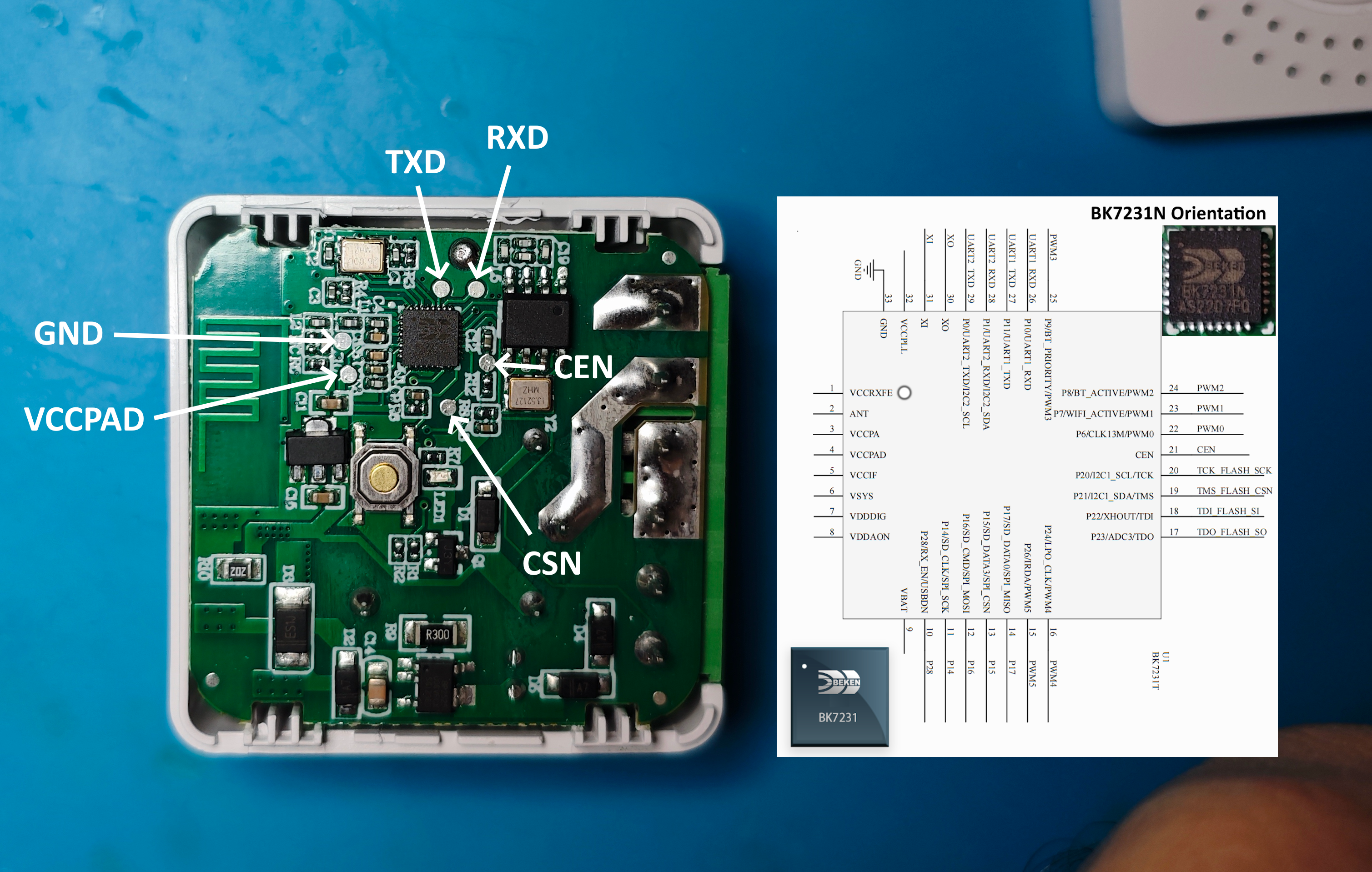

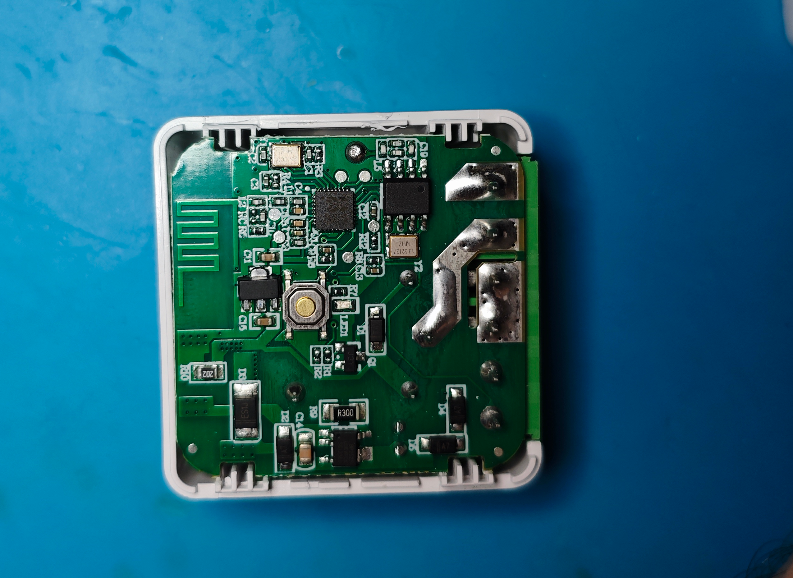

    your RX/TX cables look quite long. I tend to keep mine <10cm.
    So your primary source of power is the 3V3 from the USB-TTL adaptor going to here on this component?

    well, my success is always with soldering short cables and using an external 3.3v PSU, not the USB-TTL power. Common grounds PSU<->USB-TTL

  • Shorten wires and feed AMS1117 from 5V
    #65 21357215
    Posts: 14754
    Rate: 12875
    I would say your circut have no chances to work. You've made at least two mistakes:
    - your wires are way too long, it has been proved many times on this forum that shortening the wires helps a lot
    - you seem to be powering your device from 3.3V directly from USB to TTL, it does not have enough current to power WiFi module well
    If you really don't want to use external LDO like I do on my videos https://www.youtube.com/@elektrodacom , you can consider taking 5V from USB and connecting it to the INPUT of AMS1117-3.3V on the board, so the WiFi module still gets 3.3V from AMS1117-3.3V output. This method may or not may work, depending on the capacitors on the board...

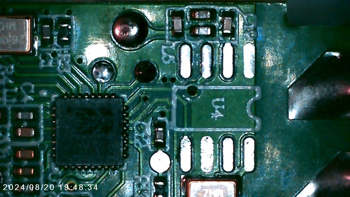

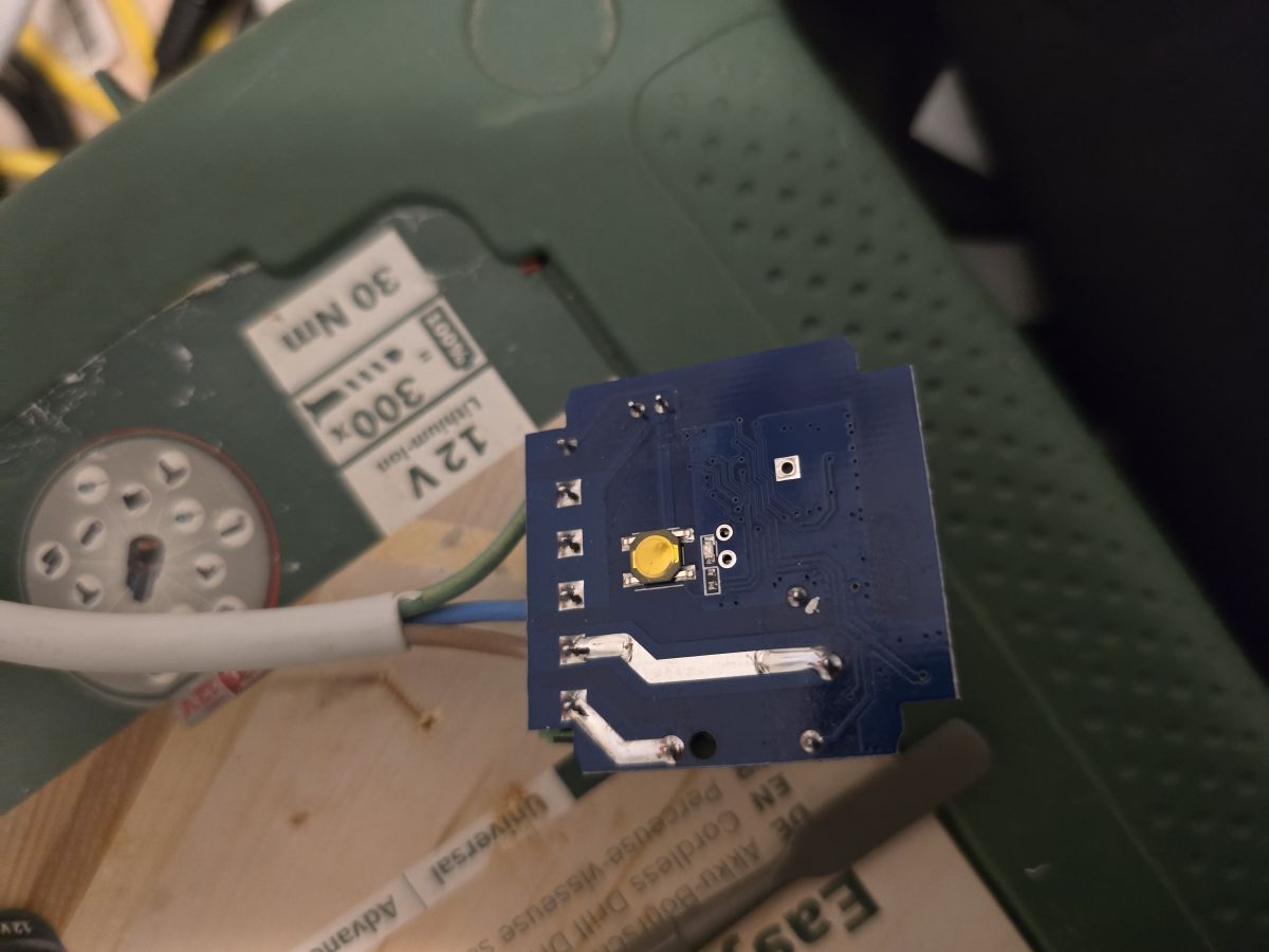

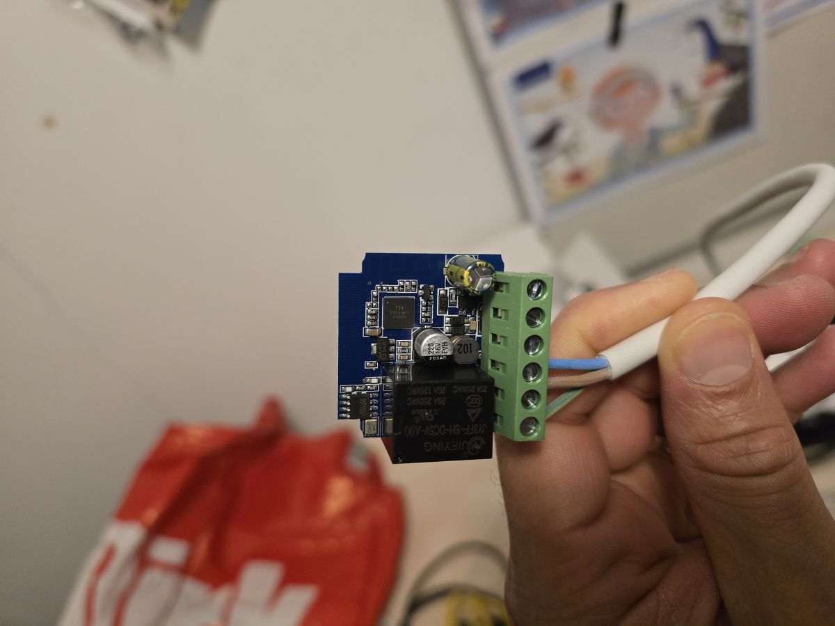

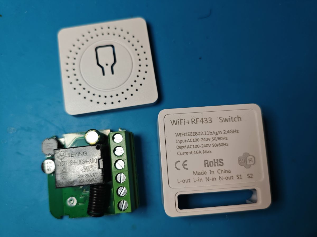

    I've since got something similar but with unmarked RF chip to the right of the BK7231N.
    https://www.aliexpress.com/item/1005007562059714.html
    WiFi+RF433 switch module with opened casing on a blue background. Circuit board with various electronic components on a blue background. Close-up of a green PCB with a JQX-105F relay and several electronic components. Circuit board with short wires connected to TXD, RXD, GND, VCCPAD, CEN, and CSN pads and a BK7231N orientation diagram.
    short wires direct to pads

    So how is this RF chip connect? It sounds like we need to have RF driver...
  • Questioning how the RF chip is connected
    #69 21423826
    Posts: 5208
    Help: 446
    Rate: 914

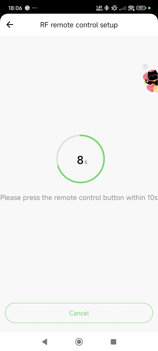

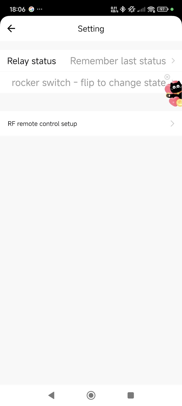

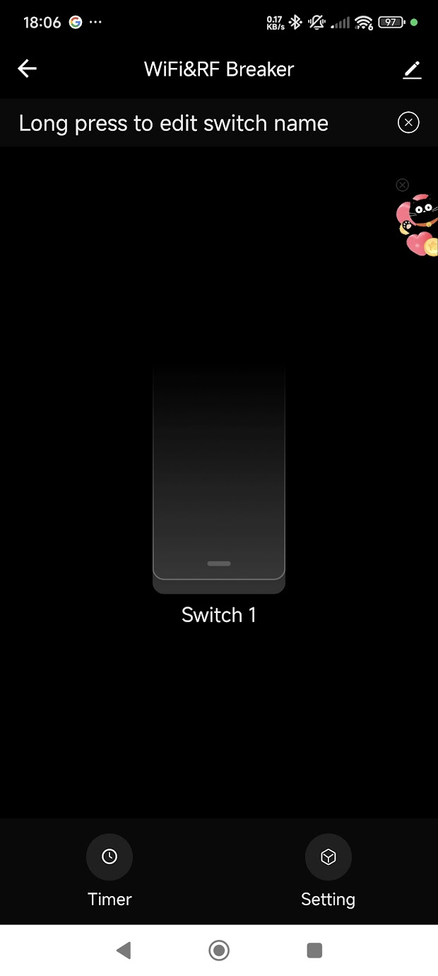

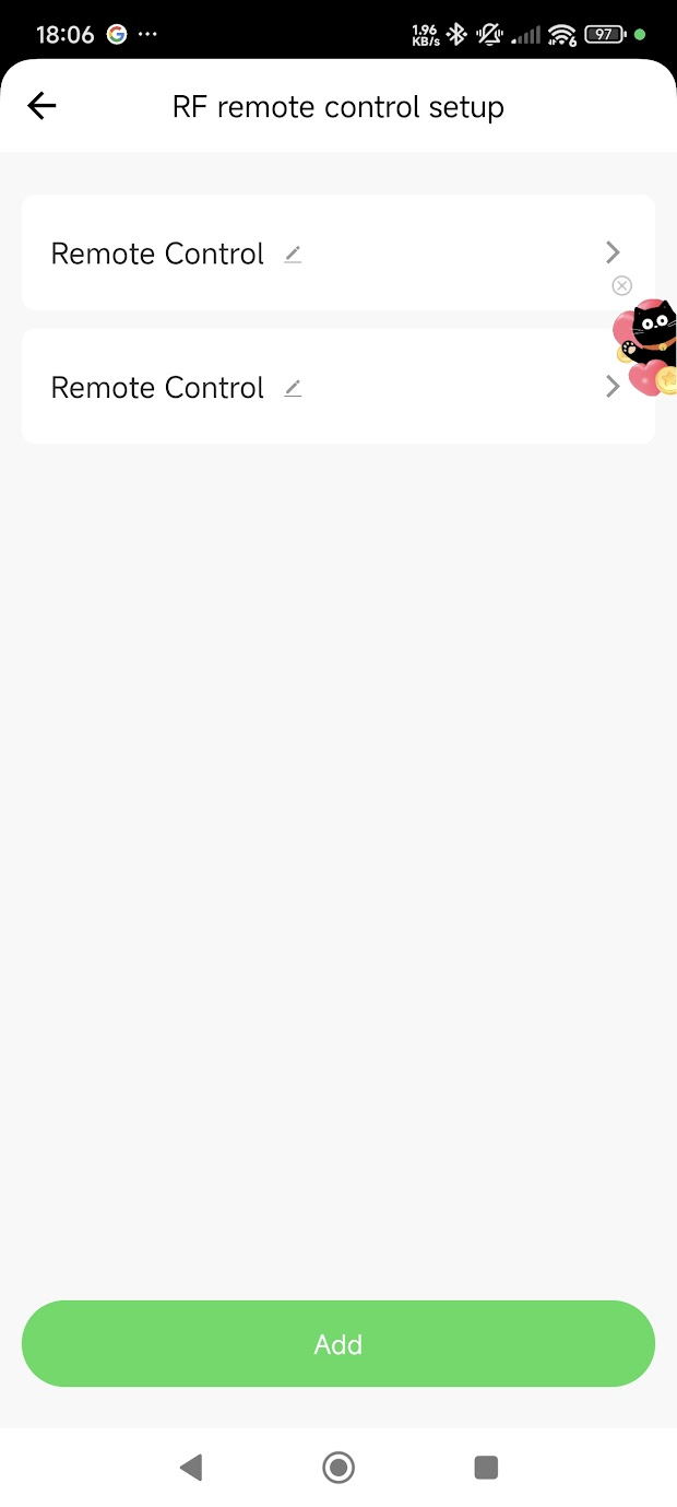

    I've yet to explore further. RF remotes are added through the app with this device, unlike some, so there must be some comms to work out
    Added after 11 [minutes]:
    App interface for managing a WiFi and RF switch. App settings screen with relay status and RF remote control setup options. RF remote control setup screen with countdown timer and cat icon. App screen for RF remote control setup with two entries. Device update screen showing no available updates.

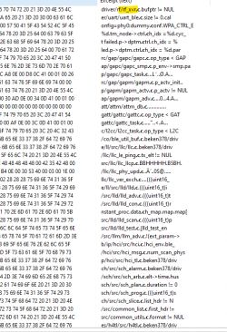

    any interesting driver clues?
    Screenshot showing a section of code with various file paths and functions related to RF drivers.

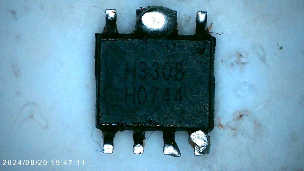

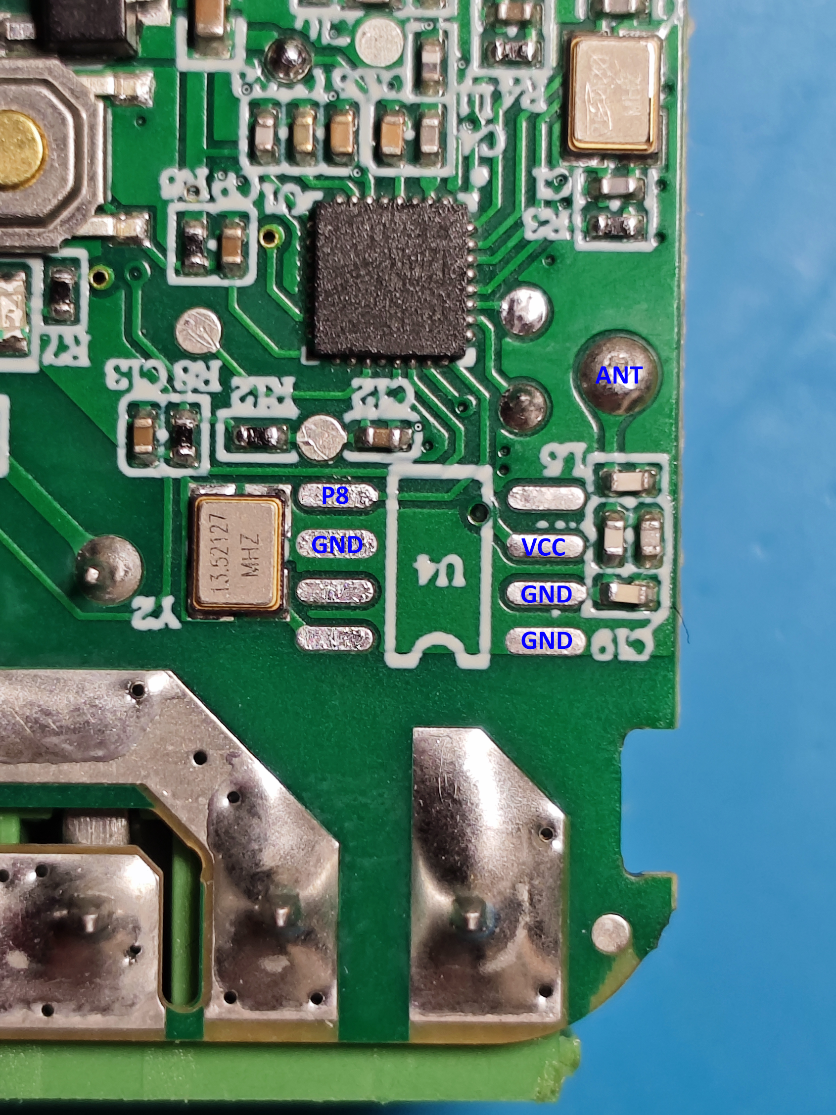

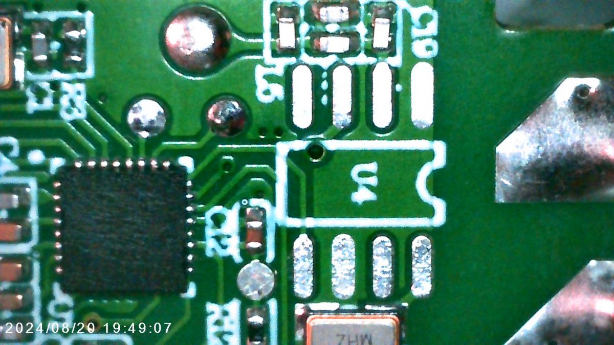

    Close-up of an integrated circuit labeled H3308 H0744 with the date 2024/08/20. Close-up of a circuit board with visible electronic components and an integrated circuit. Close-up of a circuit board with an electronic component marked H3308 H0744.Close-up of a green circuit board with various electronic components and labels.
    can't find any info on that RF chip - H3308 H0744

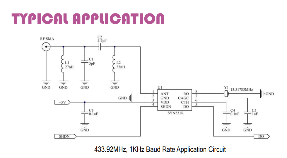

    So it's a receiver?
    This is probably something like that:
    https://tasmota.github.io/docs/RF-Protocol/#receiving-rf-codes
    This is probably something like SYN531R C77785
    Circuit diagram of SYN531R application for RF signal reception.
    • 2410121855_Synoxo-SYN531R_C77785.pdf (1.05 MB) You must be logged in to download this attachment.

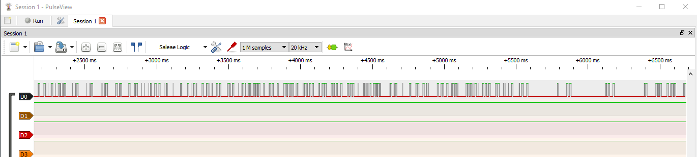

    interesting. I have one of the cheapie logic analysers but not really engaged with it properly. Is that the next step? to sniff what it's up to?

    seems I need to watch some basic Sigrok YouTube vids again.
    Screenshot from PulseView software displaying a logic analyzer with visible digital signals on multiple channels.
  • #75 21427880
    Posts: 14754
    Rate: 12875
    I'd say change the sampling rate, 20kHz in the dropdown, change it to higher frequency, maybe?

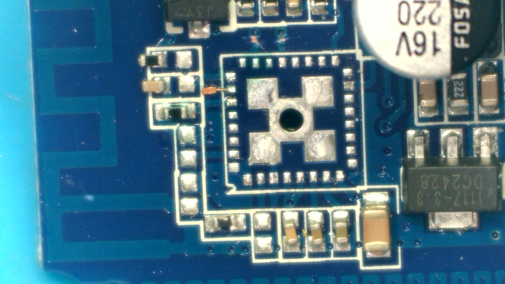

    I received a different version of the mini smart switch. I was unable to flash the board over the air with tuya cloudcutter. As you can see the T34 pins are hidden. I understand that I can get 3.3V and ground pins from the AMS1117 chip but I have no idea where to get TX and RX from. Does anyone have the same board and was successful in flashing it?
    Mini smart switch with visible components held in hand. Mini smart switch PCB with hidden T34 pins.

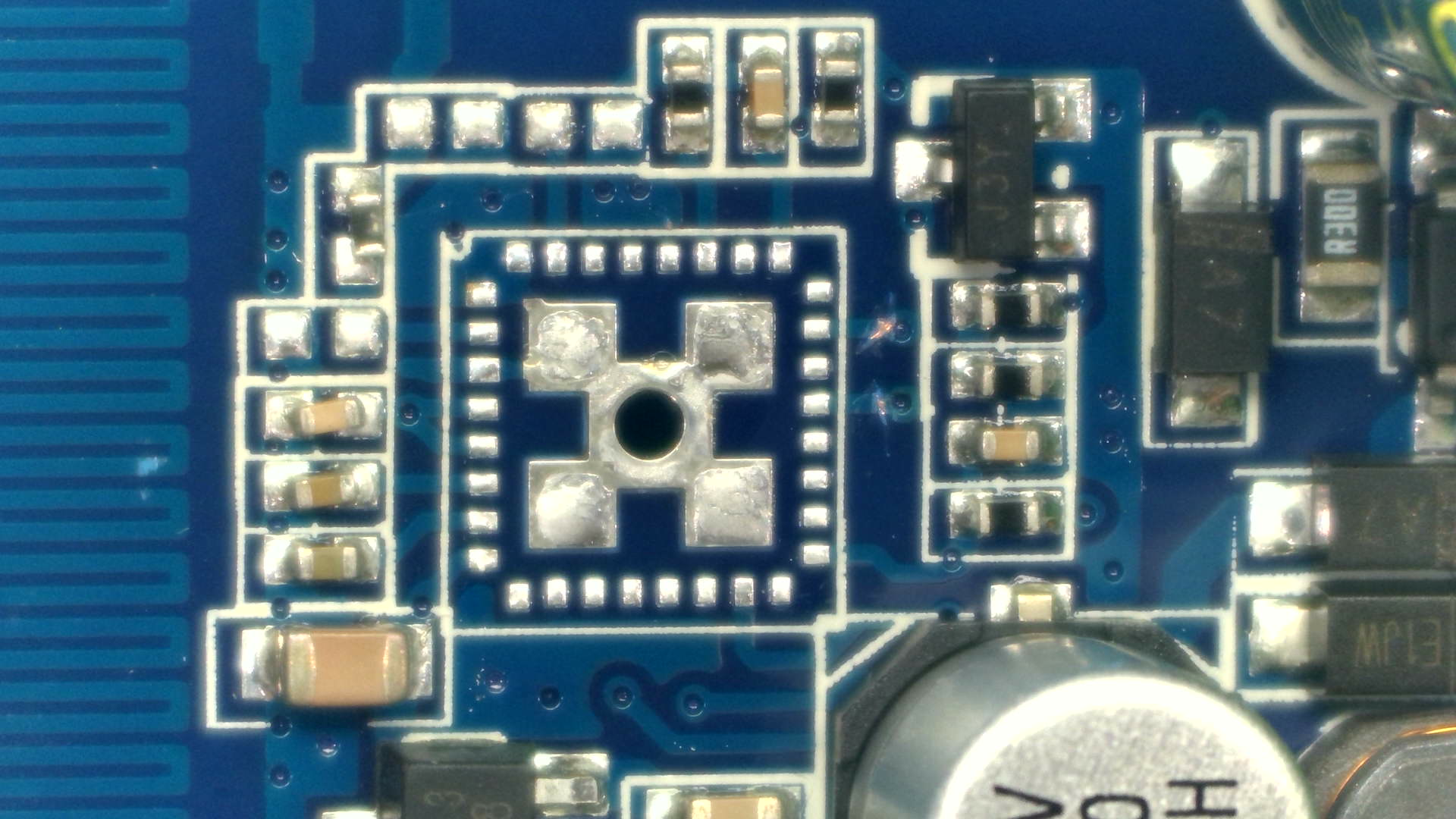

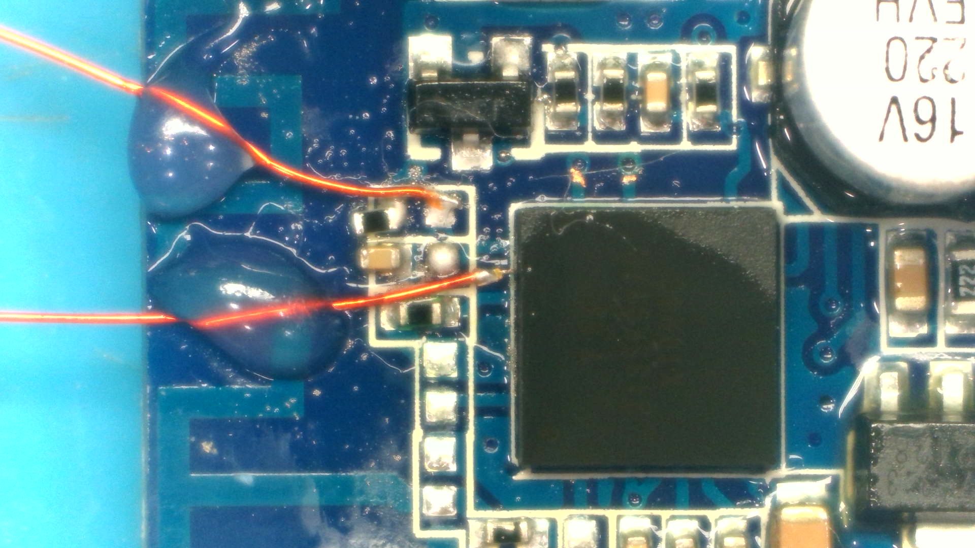

    For the new chips, it's almost impossible to do it without microsoldering. The pad for the pin 25 is pulled up with a 10k resistor and a capacitor, I don't know why. I had to remove both. Also, the pad for the pin 26 is not connected to anything. I had to remove the chip, add a fake pad, resolder the chip and finally flash firmware.
    Images for reference. I'll only buy modules from the "brand" Avatto from now on. They're much simpler to flash and to work with, and the build quality is better than the Tuyas. If you're buying modules to flash new firmware, I highly recommend buying from this brand. Cheers!
    Macro photo of a PCB fragment with SMD components and an empty spot for an integrated circuit.
    Close-up of a blue printed circuit board with SMD components and an empty socket for an integrated circuit.
    Close-up of a PCB with two thin wires soldered to specific pads and secured with glue.
