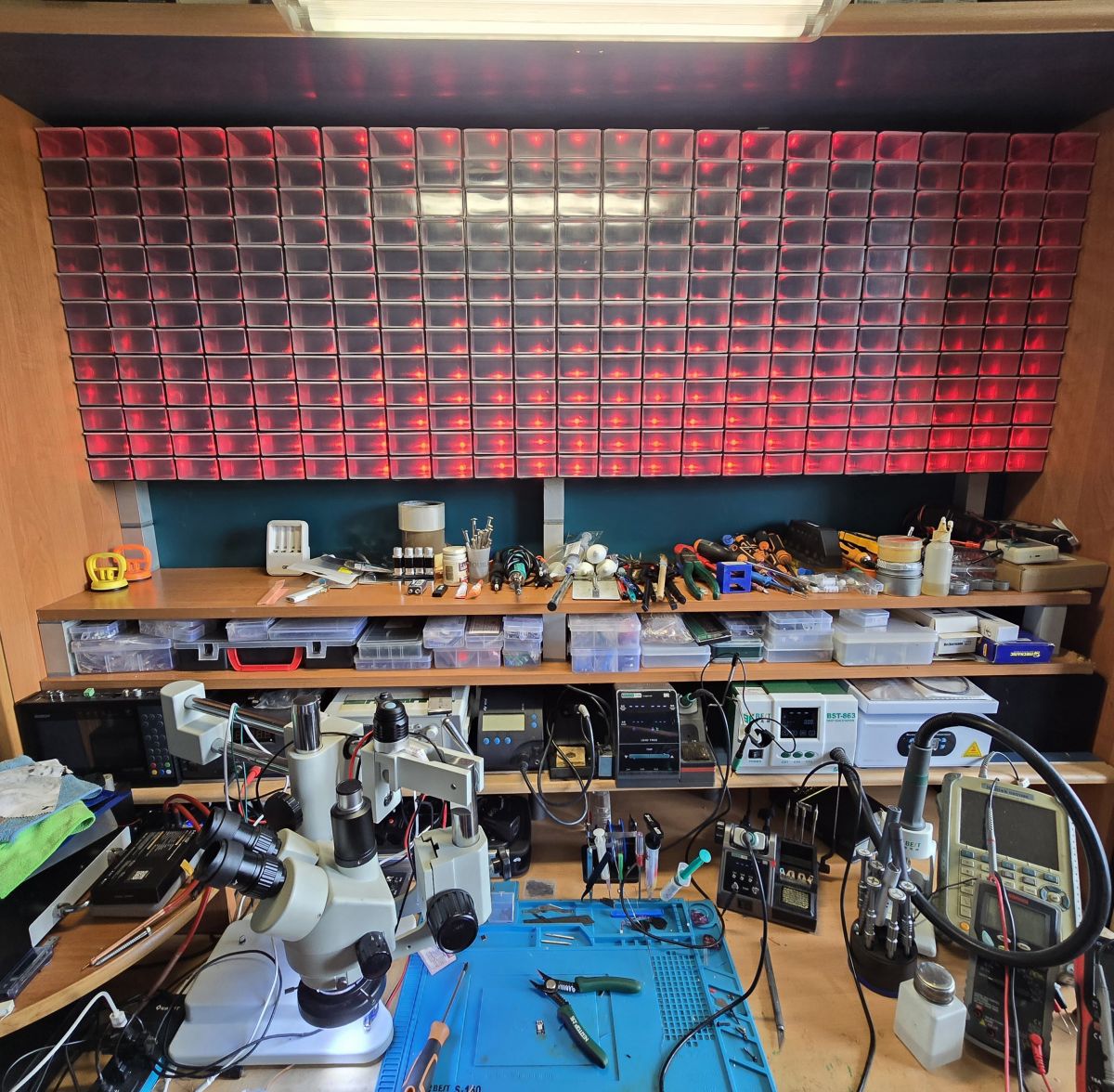

  • Built smart workshop drawers with WS2812B LEDs and a database that highlights the drawer cells containing a searched part.
  • Each drawer gets one diode, controlled by BK7231N or ESP8266 through REST requests from a browser, phone, or computer.
  • A 60-drawer segment uses a 1 metre, 60 LEDs per metre WS2812B strip, a NodeMCU, and a 5V 5A power supply.
  • The PHP site lets you add, delete, view, and update parts, while JavaScript triggers the controller to light matching drawers and ambient colours.
  • The final setup works and is responsive, but soldering the LEDs is time-consuming and careful drawer-to-LED indexing is critical.

    Piter3040 wrote:
    "capacitor10k"
    10k of what? Because I don't think it's Farads, it would rather not fit in the drawers if it exists at all :)

    Piter3040 wrote:
    It would be nice to have a remote control that says "capacitor10k" for example. - click and the correct drawer lights up:)
    In this case a red light should go on because what is a "10k" unit in relation to a capacitor?

    Clinging to details... After all, I wrote e.g. (for example).... Anyone can write whatever they want, their own password...... The general idea was to make it a bit easier to search....
  • Voice control is more practical than a button remote

    I have bad memories of this soldering, you have to be patient. It's not that it's difficult, because the solder came out the first time, but it was time consuming
    I agree with this opinion. I do not recommend it.
    A fully equipped workshop station with a microscope and electronic tools.

    Congratulations on your patience, on such a segment you can already display some animation or play Snake
