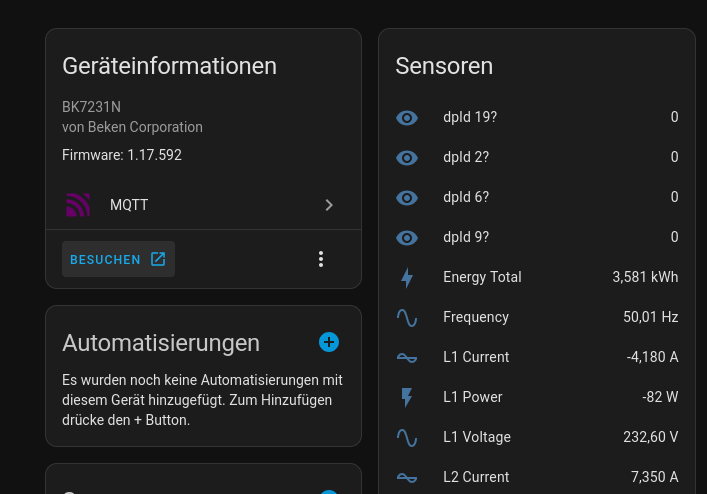

  • Questions channel mappings for phase, fault, and breaker ID
    #35 21274110
    vincenzoernst1
    Posts: 100
    Rate: 7
    @p.kaczmarek2

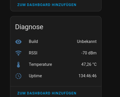

    im missing the openbeken  build in HA info. it shows "unkown", also the IP doesnt show up in HA. since the info is in mqtt there might be a glitch in the posted topic?
    Diagnostic screen showing Build as unknown in the application.
    Added after 58 [minutes]:
    >>21095146
    @divadiow
    im trying to get the rest of the dpid working. now im searching for reasonable channel types for:
    "DPID 6,7,8: "phase", raw,
    9: "code": "fault", "type": "bitmap",
    "DPID 17,18,19": { "code": "alarm_set_1", "type": "raw",
    any suggestions on what channels to use?
    "DPID 2": { "code": "cur_neutral", "type": "value", this is not reasonablecause this unit has a neutral but its ONLY for self powering the unit. there you only can measure the units power consumption. this is not very usefull.
    16 is "switch" but how?! this is physically simply not possible by design?!?!
    maybe like so?
    //phase_a
    setChannelLabel 14 "L1"
    setChannelType 14 OpenClosed_Inv
    linkTuyaMCUOutputToChannel 6 raw 14
    // breaker_id
    setChannelLabel 17 " breaker_id"
    setChannelType 17 ReadOnly
    linkTuyaMCUOutputToChannel 19 string 17
    // fault
    setChannelLabel 18 "device fault"
    setChannelType 18 ReadOnly
    linkTuyaMCUOutputToChannel 9 bitmap 18
    breaker id shows 0. also its shown as: "Channel breaker_id". channel is not a nice wording here.
    for "OpenClosed_Inv" setChannelLabel 14 "L1" is NOT working. it shows "CLOSED (ch14)". Why?

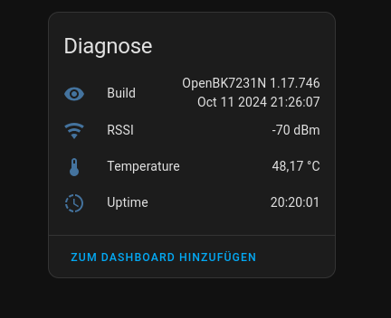

    Does executing publishAll fix the missing information in MQTT HA (with a delay)?
  • #37 21275240
    vincenzoernst1
    Posts: 100
    Rate: 7
    @p.kaczmarek2
    with publishAll build is shown correctly. 👍 is this a bug or does it intended behave this way?
    Diagnostic interface displaying software version, signal strength, temperature, and uptime.
    IP doesnt show up though. so the link ("Besuchen" / "visit" in the english version, i guess) to the OB gui does link to the wrong IP:
    Screenshot of a user interface displaying device and sensor information.

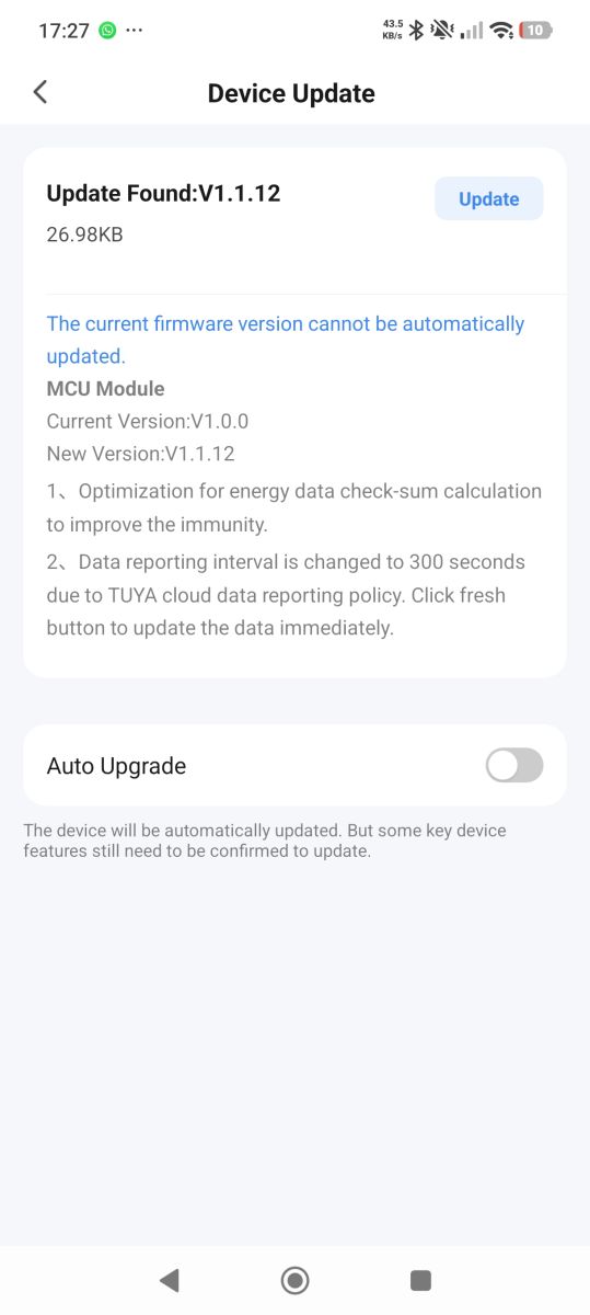

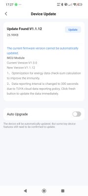

    Tuya model exposes phase A telemetry format
    #46 21819489
    Posts: 5220
    Help: 449
    Rate: 918
    you might have a TuyaMCU update too
    Firmware update screen showing version V1.1.12 found and Auto Upgrade toggle off
