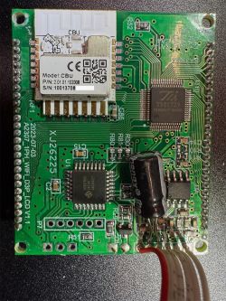

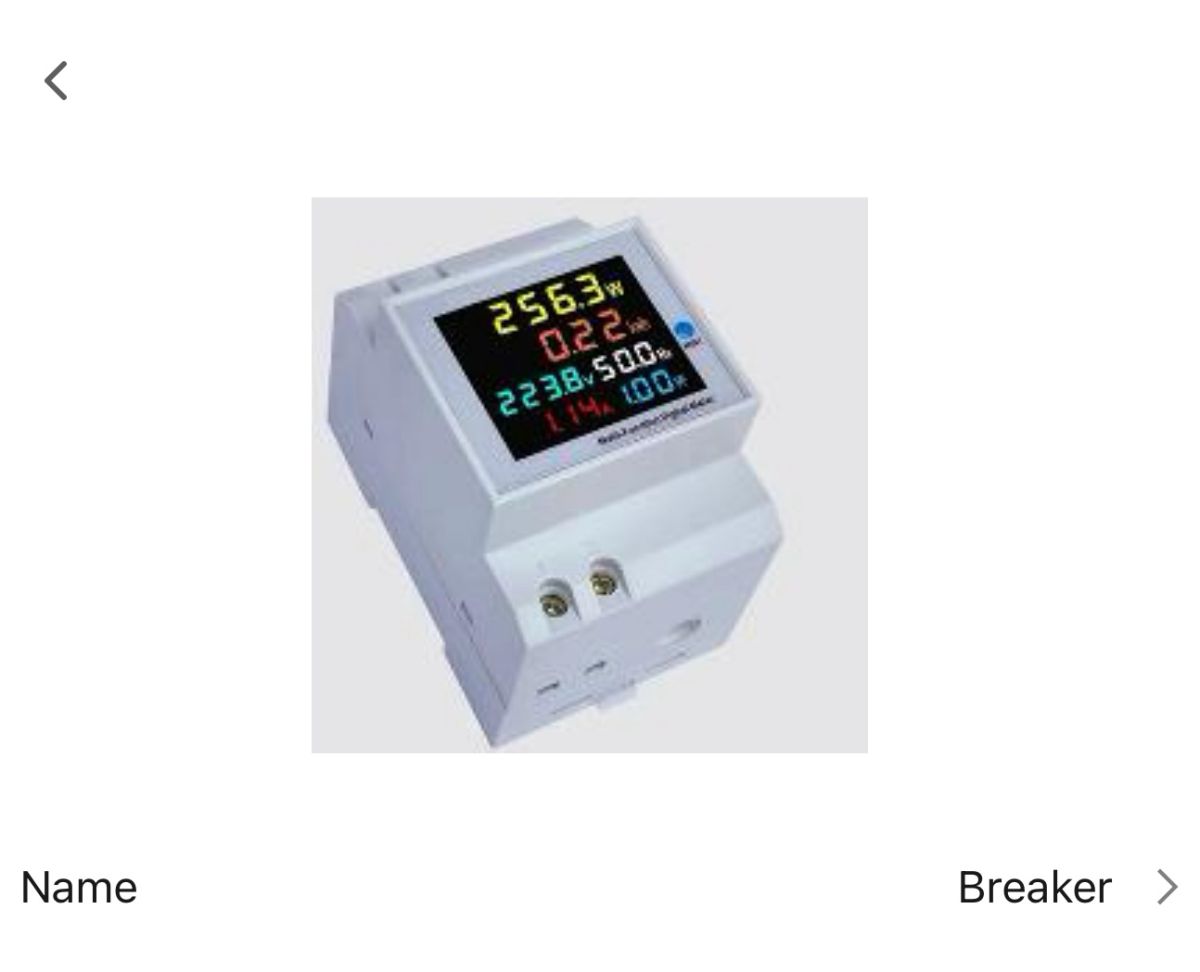

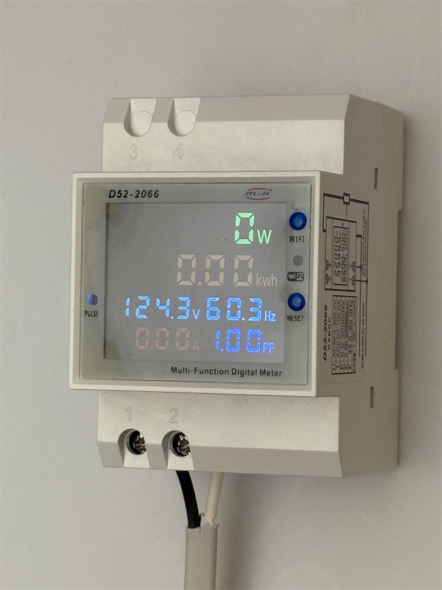

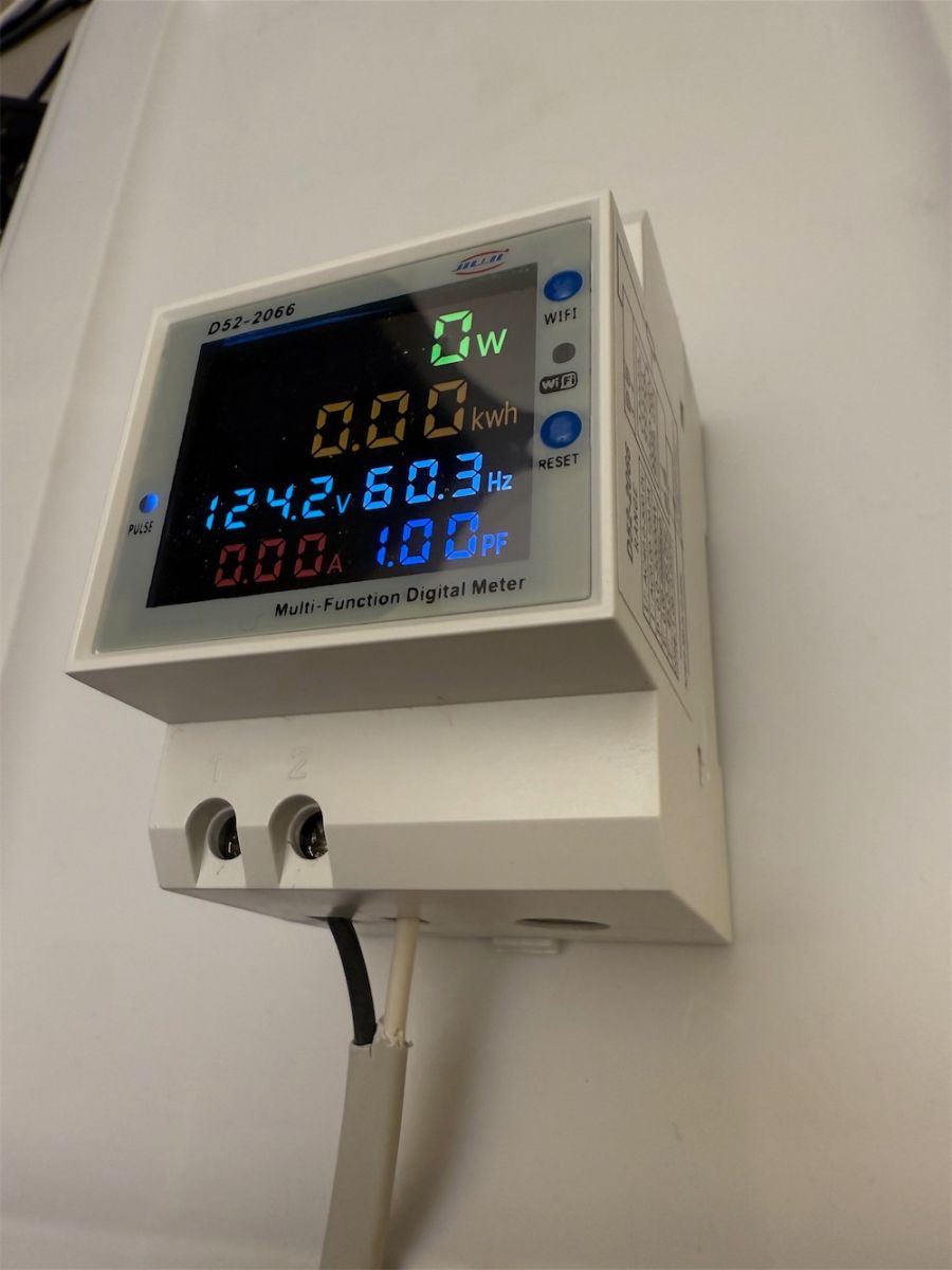

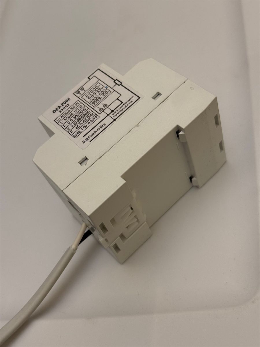

    Hello, I am new to OpenBeken and trying to get a D52-2066 DIN-rail-mount energy meter working. In the Smart Life app it shows up as a "breaker" and it uses the bk7231n chip (model CBU, p/n 2.01.01.103308 and internal product id c3xogekcff60tlig ) I was able to use Tuya Cloud Cutter with the TAXNELE TVPS1-63LW Circuit Breaker v2.1.6 profile to flash OpenBeken. However, I'm not sure how to configure OpenBeken now.

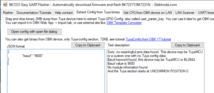

    I tried template extraction as shown in this video but seems like I got no useful info:
    Screenshot of BK7231 Easy UART Flasher showing missing pin data and default serial communication settings.

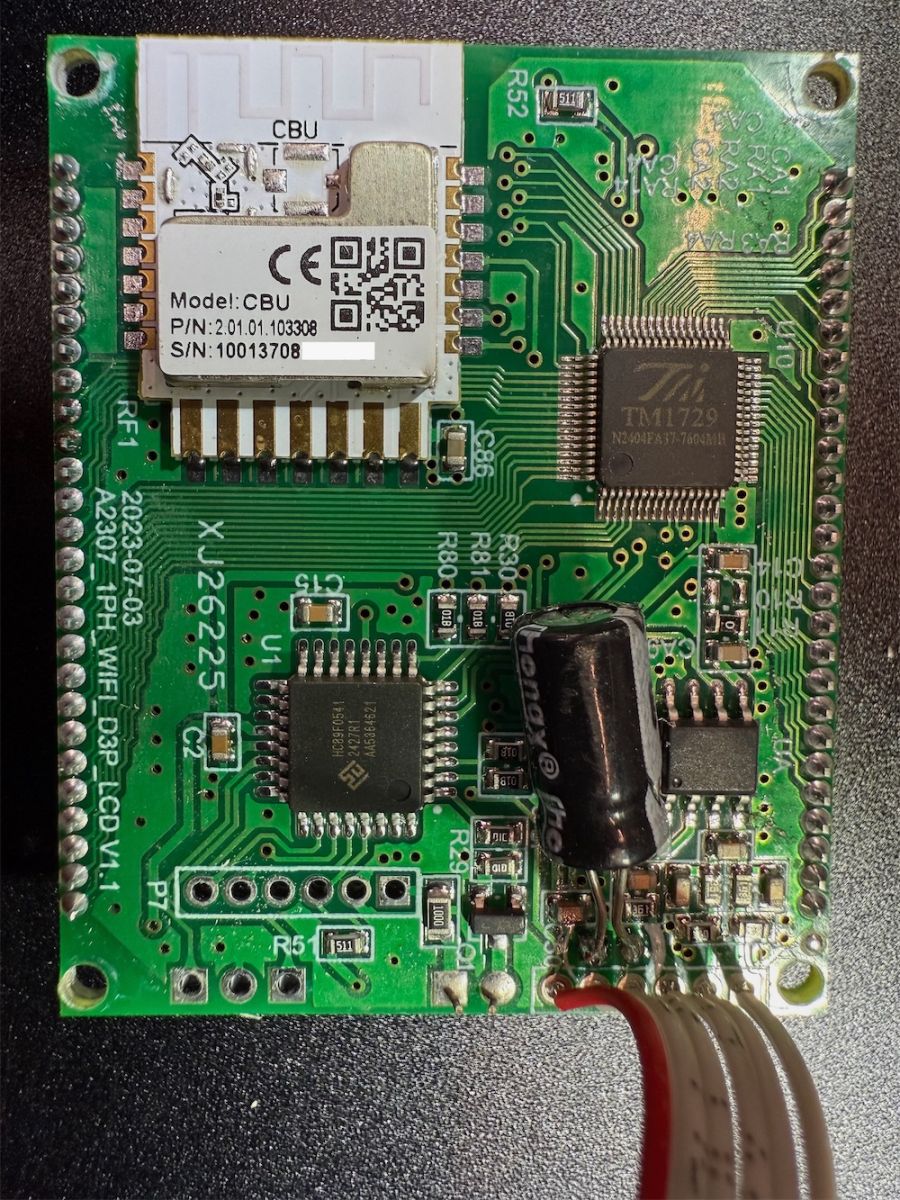

    As the chip appears to only be connected via RX, TX, GND, POWER, and RESET(CEN) I assume it is using tuyamcu to pass data.

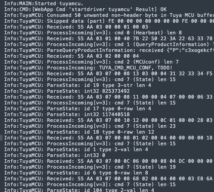

    So, running
    startdriver tuyamcu
    in the "app" console (http://192.168.4.1/app? logs tab) gives
    Info:CMD:[WebApp Cmd 'startdriver tuyamcu' Result] OK
    and then I seem to be getting some of the 55 AA console messages which I believe might be related to the tuyamcu energy data:
    Screenshot of OpenBeken console showing TuyaMCU log messages after running the startdriver tuyamcu command.
    I also tried these commands (for channels 2-9) recommended in another post but the values just show up as zeros:
    setChannelType 2 voltage_div10
    setChannelLabel 2 "Voltage"
    linkTuyaMCUOutputToChannel 101 val 2
    etc, etc.
    If anyone can point me in the right direction that would be much appreciated.
    AI: Do you know which TuyaMCU protocol version your device is using, or have you been able to identify the DPIDs (Data Point IDs) that correspond to voltage, current, power, etc.?
    there are some info in tuya-cloudcutter/device-profiles/taxnele-tvps1-63lw-circuit-breaker-v2.1.6/device.json, for example schemas 000004x6ux, id:1, id: 9, id: 11 etc.
    AI: Could you provide a sample of the raw 55 AA serial messages (from the console logs) that appear after running startdriver tuyamcu? This might help in figuring out the correct channel mappings.
    yes they are included in the post

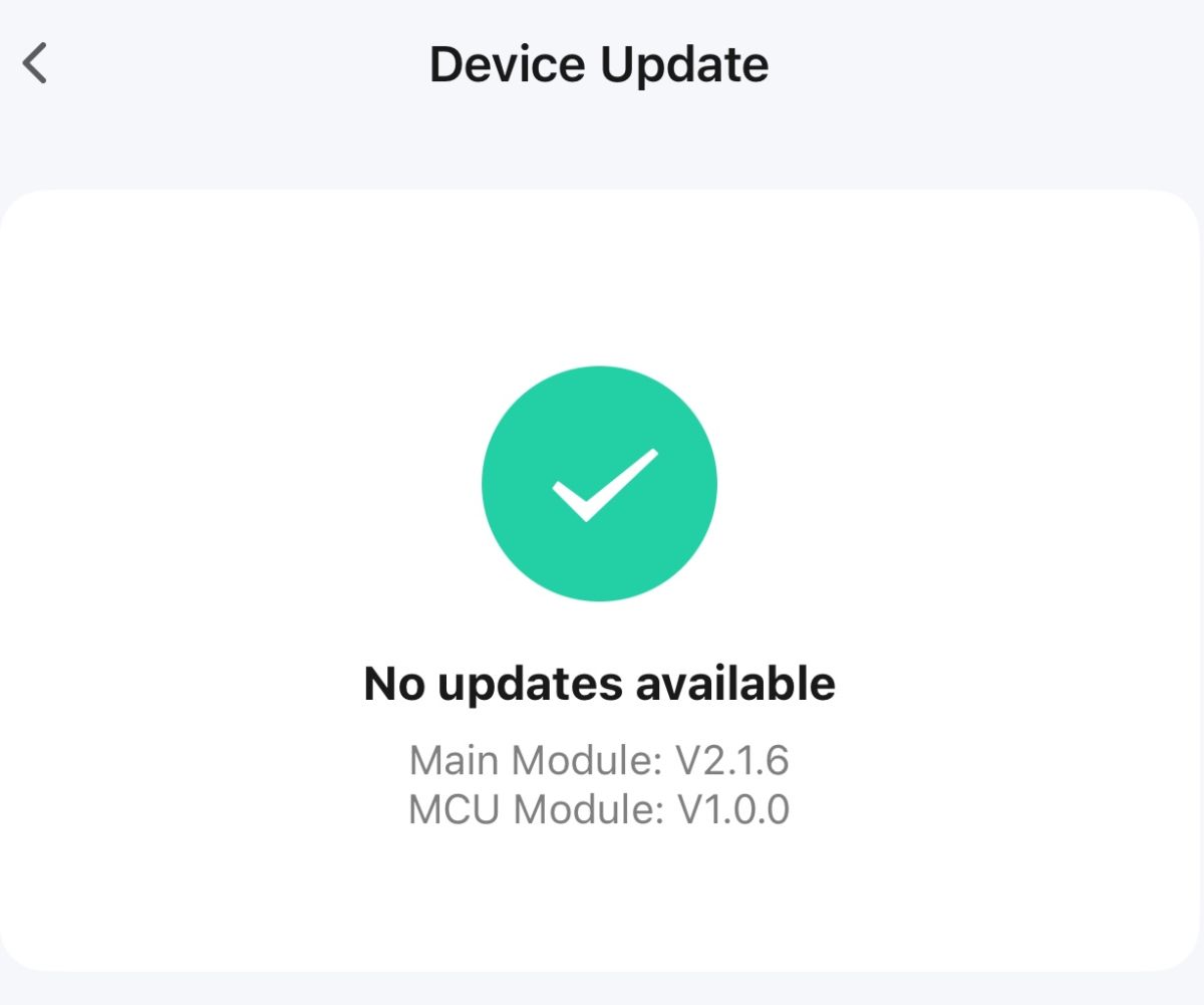

    I wouldn't rely on this schema and the dpID descriptions for taxnele-tvps1-63lw-circuit-breaker because it worked on your device. Firmware version is the most important thing to match in trying a cloudcutter profile to see if it works.

    OpenBeken Configuration for D52-2066 Energy Meter (BK7231N, TuyaMCU, CBU 2.01.01.103308)
    Added after 9 [minutes]:
    this is typically the extent of the extraction from TuyaMCU devices using Easy Flasher and is still useful

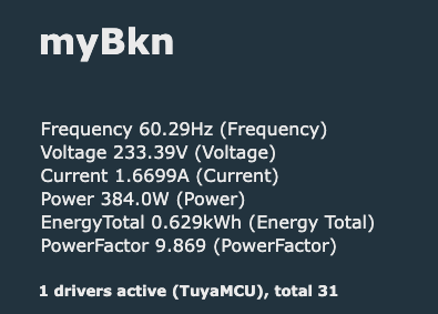

    In the console I ran startdriver tuyamcu and was able to figure out the DPIDs from the hex responses.
    I can then run these commands in the console and get the data to show up:
    linkTuyaMCUOutputToChannel 116 val 2
    setChannelType 1 frequency_div10
    setChannelLabel 1 "Frequency"
    linkTuyaMCUOutputToChannel 105 val 1
    setChannelType 3 current_div100
    setChannelLabel 3 "Current"
    linkTuyaMCUOutputToChannel 117 val 3
    setChannelType 4 Power
    setChannelLabel 4 "Power"
    linkTuyaMCUOutputToChannel 118 val 4
    setChannelLabel 5 "Energy Total"
    setChannelType 5 EnergyTotal_kWh_div100
    linkTuyaMCUOutputToChannel 1 val 5
    setChannelLabel 6 "PowerFactor"
    setChannelType 6 PowerFactor_div100
    linkTuyaMCUOutputToChannel 104 val 6
    tuyaMcu_sendQueryState ( to populate data )
    Screenshot of the TuyaMCU dashboard displaying electrical parameters: frequency, voltage, current, power, total energy, and power factor.
    The Channel Types seem to survive a reboot but the channel labels do not, nor do any of the linkTuyaMCUOutputToChannel commands.
    So, my Startup Command is currently this:
    backlog startdriver tuyamcu; linkTuyaMCUOutputToChannel 116 val 2; linkTuyaMCUOutputToChannel 105 val 1; linkTuyaMCUOutputToChannel 117 val 3; linkTuyaMCUOutputToChannel 118 val 4; linkTuyaMCUOutputToChannel 1 val 5; linkTuyaMCUOutputToChannel 104 val 6;
    I think I may need to add the setChannelLabel commands in there, too. Seems like I may also need to enable the script driver and set it to send the tuyaMcu_sendQueryState command periodically as from what I can tell the values are only updated when requested. I think I may also need to enable the NTP driver to have the correct time in order to get the energy use over time.
