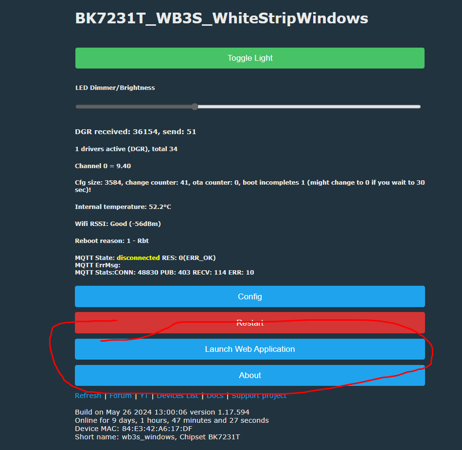

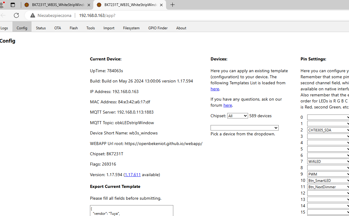

    You need to open it via OBK panel:
    BK7231T control panel with configuration options and buttons to launch a web application.
    Then it will work:
    Screenshot of an IoT device configuration page.

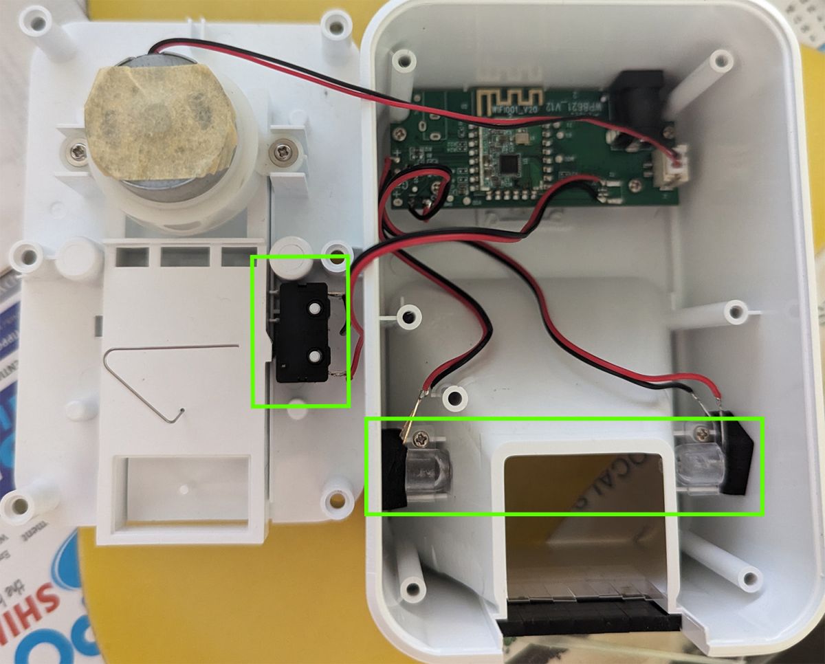

    Interior view of a fish feeder with electronic components, highlighted switch, and infrared sensor.
    Highlighted in green in the above you can see the switch for feeder tray and infrared sensor for feed level.
    These are the inputs I have figured out from GPIO FINDER in webapp, which match what was in previous posts by @Nordlicht77.
    P0 LED RED (i guess wifi indicator)
    P1 LED BLUE
    P4 Wifi Status ?
    P7 Switch for open/close indicator of feed tray. High is open. Low is shut.
    P9 Rear top button to activate feed tray manually
    P15 activate motor for feed tray.
    P22 Feed bin IR sensor
    P23 IR Sensor enable
    How do I configure them in openbk so that the feed tray stops when P7 switch is activated ?.
    Thanks

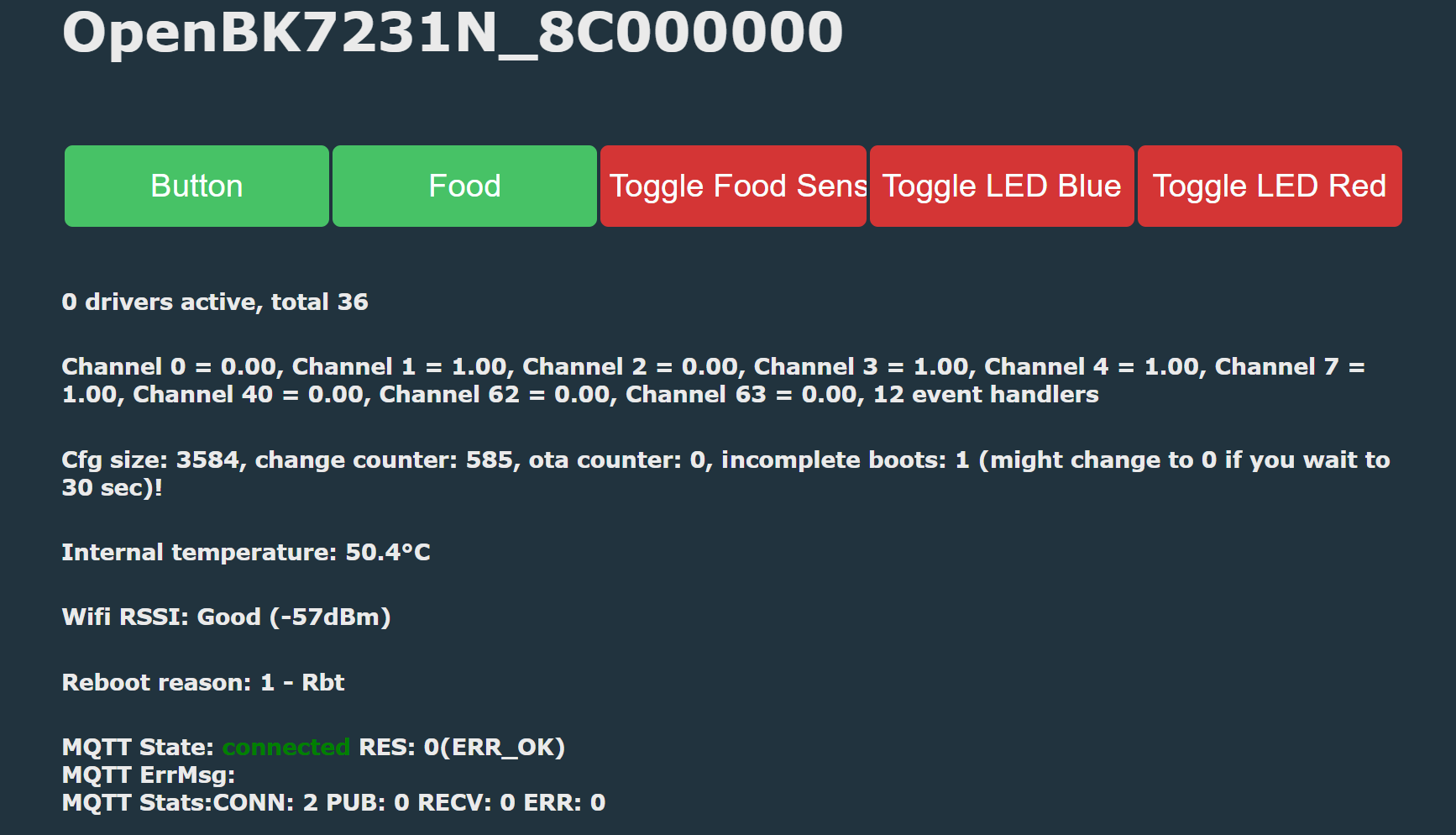

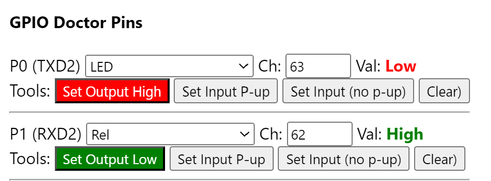

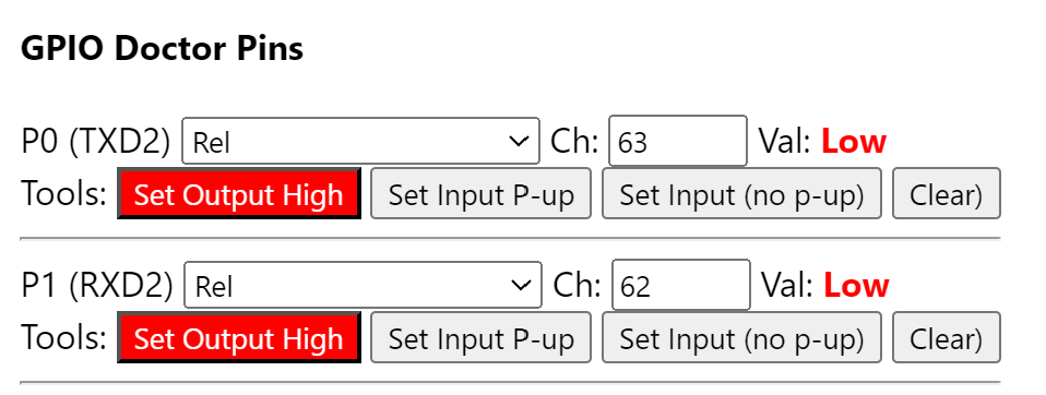

    I have managed to get it working mostly. The issue I was having is that the autoexec.bat wasn't being saved between boots. However, after disconnecting / reconnecting to power a few times, then leaving off overnight it seems to be saving the autoexec.bat now.

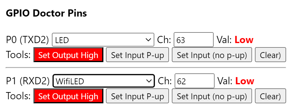

    The other issue is that the P0 and P1 settings are different from what @Nordlicht77 has. Initially, he had pins "0": "LED;63", and "1": "WIFLED;62", then changed them to pins "0": "LED;5", and "1": "WIFILED;4",
    When I set to pins "0": "LED;5", and "1": "WIFILED;4", the LED has a pink colour as both blue and red LEDs are on.
    In GPIO FINDER:
    When I click on SET OUTPUT HIGH to turn P0 / P1 off it sets it to pins "0": "LED;63", "1": "WIFILED;63", and the LEDs are turned off.
    Screenshot of GPIO Doctor Pins tool showing settings buttons and output status.
    When I click on SET OUTPUT HIGH again the pins are set to "0": "rel;63", "1": "rel;62", and the LEDs stay turned off.
    Screenshot of GPIO Doctor interface with pin settings.
    When I click on SET OUTPUT HIGH for pin 1 it stays "1": "rel;62", and the blue LED is turned on.
    Screenshot of the GPIO Doctor interface showing settings for pins P0 and P1.
    Should I leave as "0": "LED;63", "1": "WIFILED;63", ?
    I am guessing it sets to "0": "rel;63", "1": "rel;62", as that is the default label?
    @Nordlicht77 why did you change the pins to "0": "LED;5", and "1": "WIFILED;4", ?
    Below is my autoexec.bat which mostly works. But I can not work out how to set the setChannelLabel 3 "Button" to red on startup, remove the word toggle from setChannelLabel 40 "Food Sensor" 1 - bHideTogglePrefix of 1 doesn't seem to work, and hide both setChannelLabel 63 "LED Red" 1 and setChannelLabel 62 "LED Blue" 1 from UI - setChannelVisible 63 0 doesn't seem to work.. or have I stuffed it up ?
    I would only like to see Button, Food and Food Sensor on UI.

    Screenshot of the OpenBK7231N system interface displaying various settings and system information.

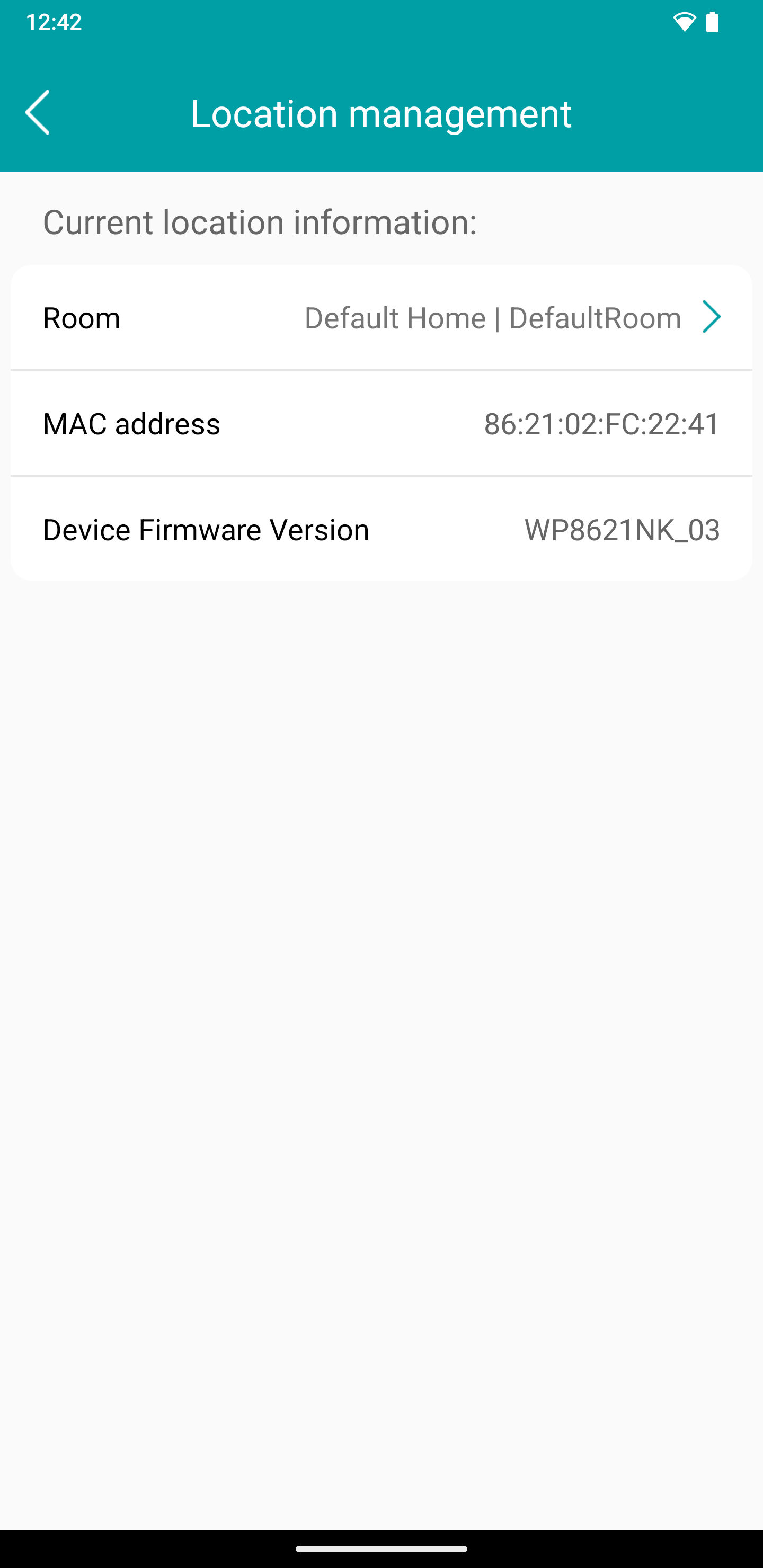

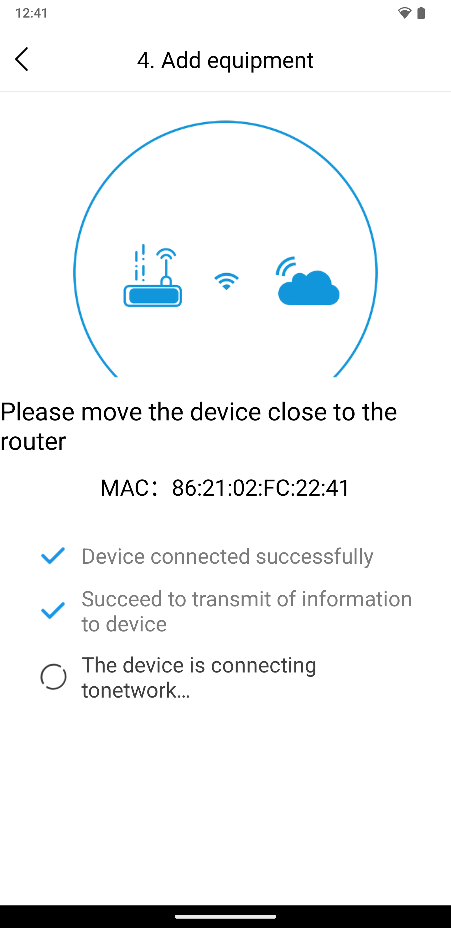

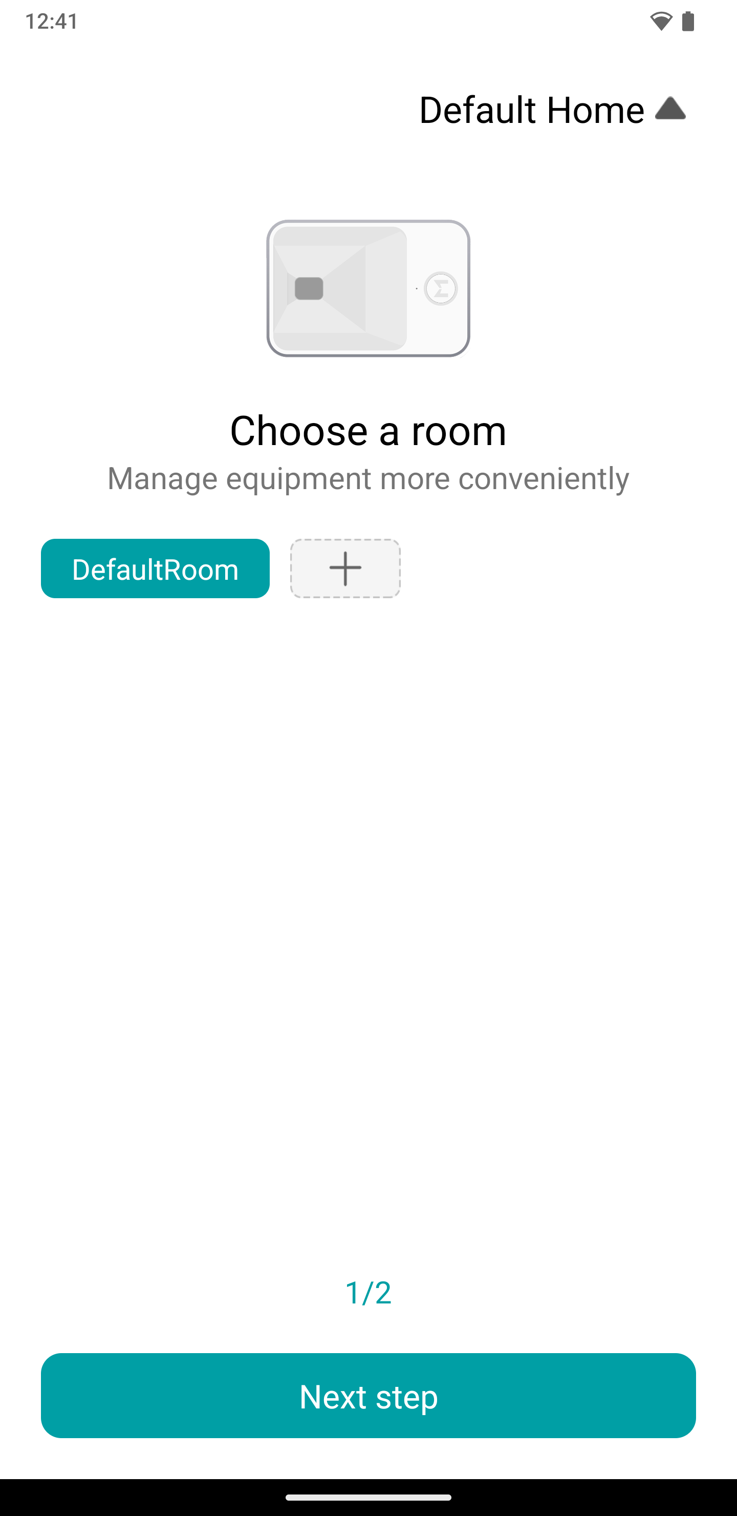

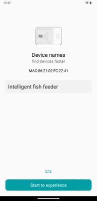

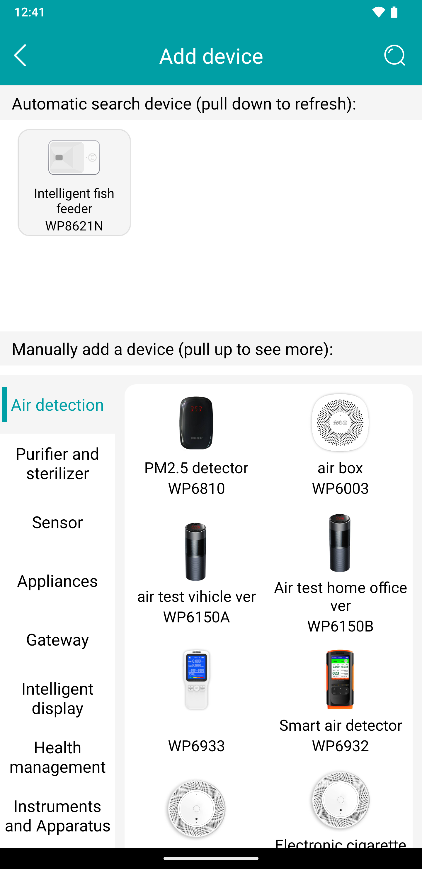

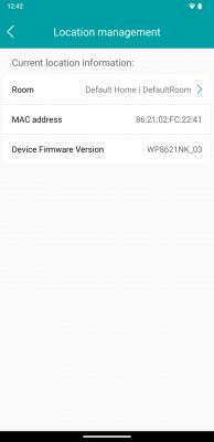

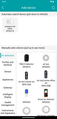

    just adding that the firmware from this device boots on XH-CB2S module where efuse key is 00000000 00000000 00000000 00000000
    I was not able to get the backup you posted earlier into pairing mode though, however many times I grounded P9. I notice there are two other dumps in that Discord thread and one of them starts in pairing mode.
    TX2 is silent. TX1:

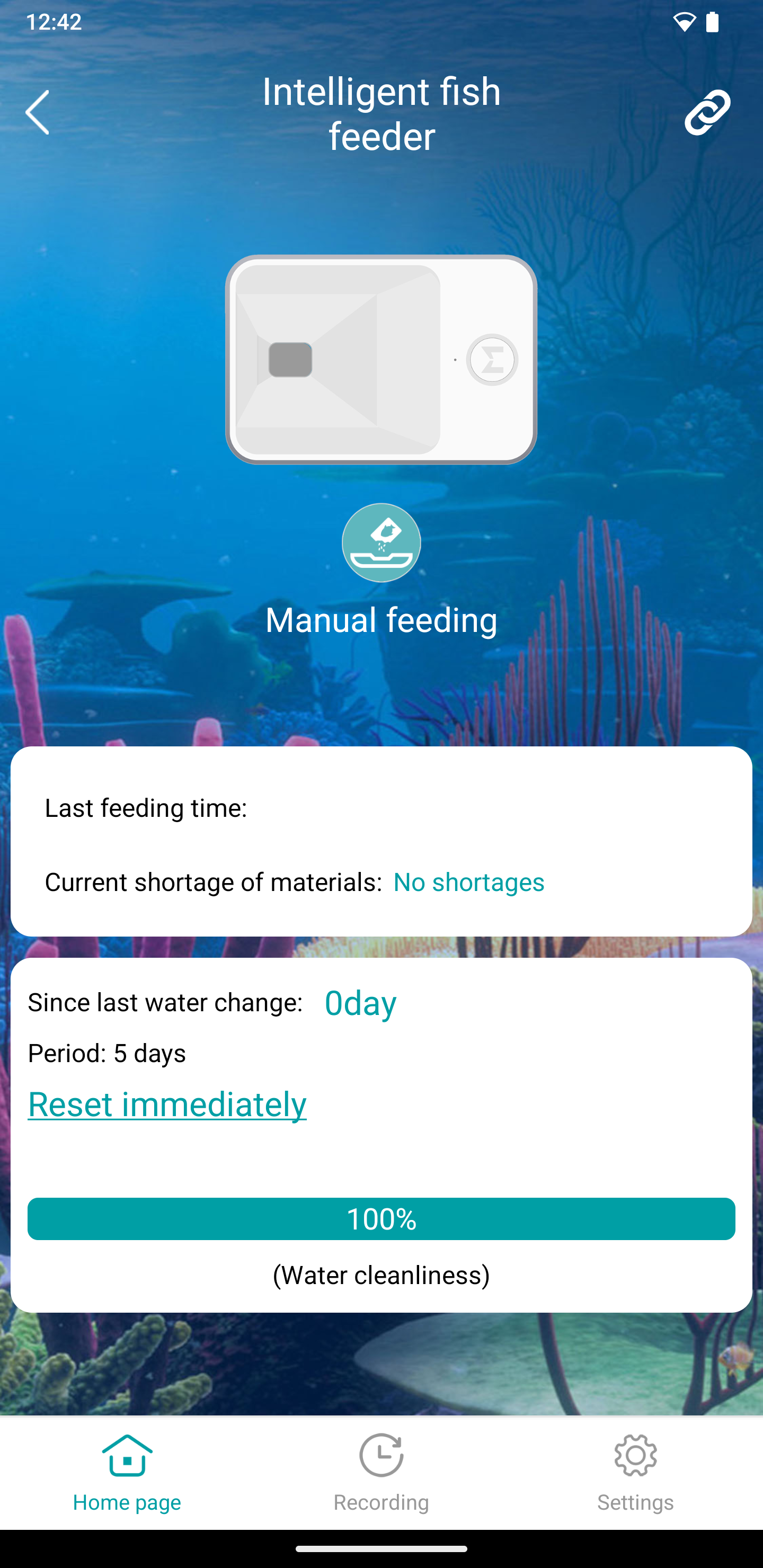

    and paired by the XiaoMei Smart app
    List of smart devices in the app, including the fish feeder WP8621N. Device addition screen with illustration of router and cloud Smartphone app screen showing room selection option. App screen with an intelligent fish feeder Smart fish feeder app settings interface Smart fish feeder app displaying information on last feeding and water cleanliness. Screenshot showing location management with information about room, MAC address, and device firmware version.
    XiaoMei_WP8621N_Fish_Feeder_WIFI002_V20_WP8621NK_03.bin
