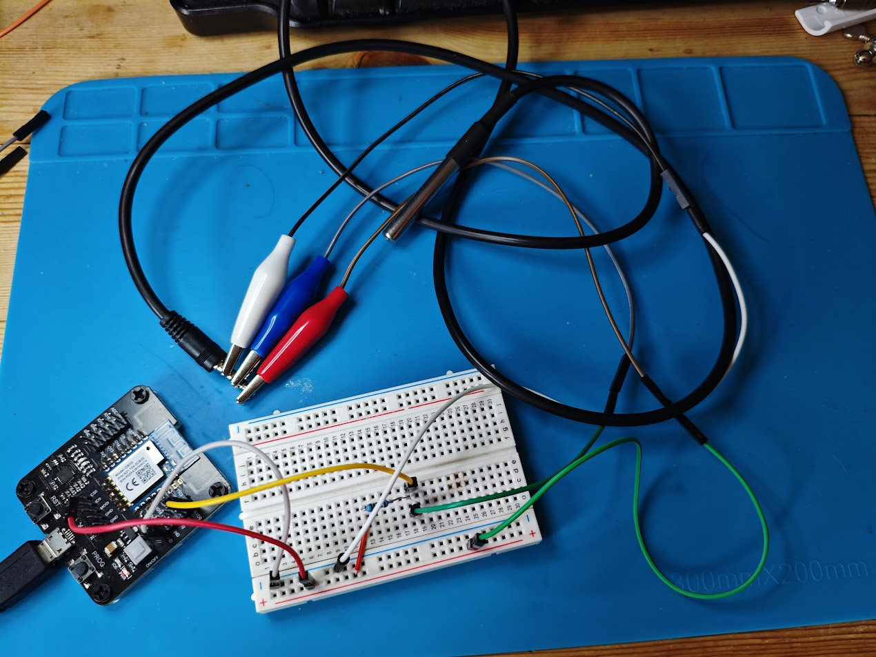

    max4elektroda wrote:
    And you are using PWM pin.
    Stupid idea, but maybe timing differs if using different pins?
    indeed.
    P26/ADC1/IRDA/PWM5
    will have a play with diff pins
    Added after 3 [hours] 46 [minutes]:
    P10/RX1 CB3S - 1.17.648
    Breadboard with wires and an electronic module connected to a prototype board.
    Added after 7 [hours] 3 [minutes]:
    Actually, maybe that CB3S test should be ignored as I'm using a 5.1k resistor to pull up. I do not have any 4.7s to hand. Could that make a difference?

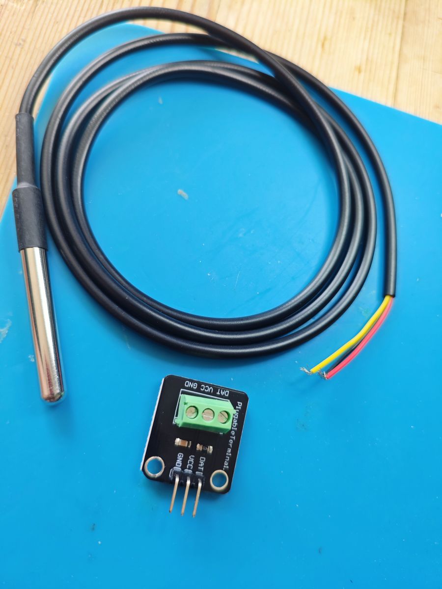

  • BKfact 18 works with DS18B20 on pin 10
    #40 21165112
    Posts: 5223
    Help: 449
    Rate: 918
    divadiow wrote:
    second probe with 4.7k now anyway
    was expecting it to be another Sensylink but reporting as
    Family A1: Maxim DS18B20
    Discovery result: don't know
    original
    Added after 14 [minutes]:
    from here if anyone wants to try their luck https://www.aliexpress.com/item/1005006459164363.html
    Added after 2 [hours] 43 [minutes]:
    well that's really annoying. the character limit on my long post wiped out all my updates so I saved what I did have available on screen as a single file. That single file is missing the content of all the spoilers where the logs were. anyway. the sweet spot was BKfact 18
    Added after 20 [minutes]:
    This is with 1296_merge_7117258cf00e and Sensylink CT1820B and 4.7k ohm - P10 - startDriver DS1820 9999
    BKfact 18-20

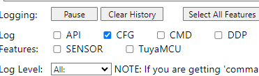

    Calculated from a full log of just CFG
    Screenshot of control panel with CFG option selected.

    DS18B20 on pin 10 shows intermittent CRC errors
    #44 21190145
    Posts: 5223
    Help: 449
    Rate: 918
    This is with 1296_merge_19c501f2bad3 and Maxim DS18B20 and 4.7k ohm - P10 - PowerSave 0

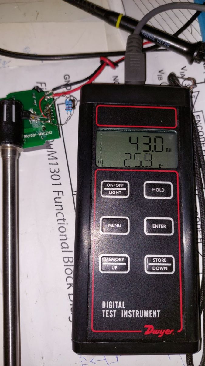

  • DS1820 readings differ from trusted device
    #47 21195847
    omelchuk890
    Posts: 70
    Rate: 10
    My tests with the long-awaited sensor.
    BL602, sensor from aliexpress for a few cents on pin 17.
    startup cmd:
    backlog startDriver NTP; ntp_setServer 217.147.223.78; ntp_timeZoneOfs +03:00; powersave 1; startDriver DS1820
    Packing in the console
    Info:CFG:DS1820 - Pin=17 temp=+35.00
    Info:CFG:DS1820 - High=2 Low=48 Val=560 Tc=3500 -- Read CRC=73 - calculated:73
    Info:CFG:DS1820 - asked for conversion - Pin 17
    Info:CFG:DS1820 - Pin=17 temp=+34.87
    Info:CFG:DS1820 - High=2 Low=46 Val=558 Tc=3487 -- Read CRC=9e - calculated:9e
    Trusted device readings
    Dwyer digital test instrument displaying humidity and temperature readings.
    Readings differ significantly.
    There is one error in the console for more than 100 CRC measurements.
    Sensor quality or?
  • Suggests checking sensor on another device
    #48 21196002
    max4elektroda
    Posts: 758
    Help: 49
    Rate: 189
    If CRC is shown as correct, the readings should be highly likely the ones transmitted by the sensor.
    If they differ very much from other sources, it could be quite some reasons:
    The code doesn't work well, e.g conversion is not finished when we request the temperature
    the sensor is read too frequently (reading will heat up the sensor a bit)
    The two sensors (with different readings) are not close enough (so e.g. if I see the image, you might retry with the DS1820 connected with a longer wire connection, so that the sensor is not so close to the module)
    The sensor really reports this (wrong) values.
    Do you have the possibility to check the sensor on another device, especially with another code (e.g. an ESP32 with Arduino).
  • DS1820 readings improved after sensor replacement
