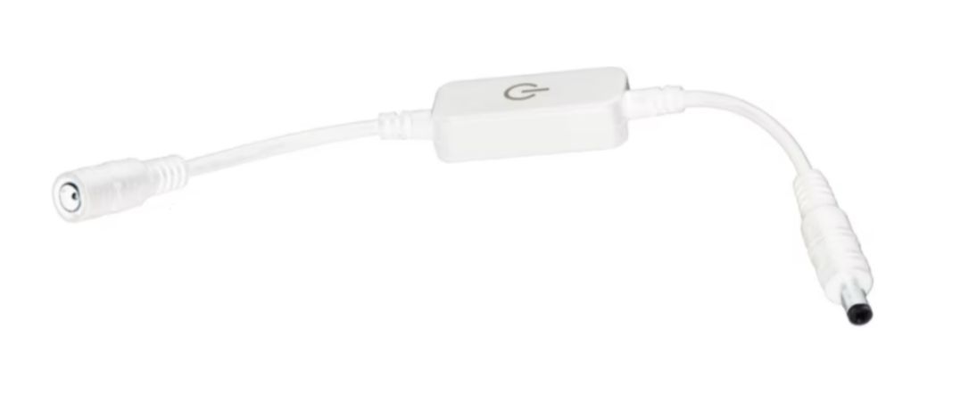

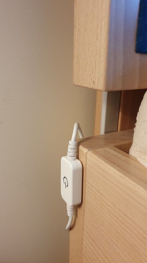

    In my bedroom, the motion detector did not work at all. First of all, what I wanted: soft lighting, easy to switch on when it's dark... but sometimes you have to get up. The lights on the bedside tables are a bit too strong, and with the model I have you have to search for the switch in the dark. I first tried a ready-made light from Castorama or Leroy, a motion detector integrated with a low-power LED. I placed it under the bed. It worked as it wished, sometimes it wouldn't switch on, other times it would 'self-start' on a dangling piece of duvet.
    I finally solved the problem a couple of weeks ago as follows, by:
    Acquiring touch switches for the LED strips, with brightness control, by the way. Two - for each side of the bed, so that the nicer half also has its own independent "lamp". At Castorama circa PLN20/pc. Maybe on the internet, e.g. at A-services (domestic or Far East) would be cheaper, but I didn't want to wait.
    Such:
    White touch switch for LED strips with power connectors. .
    https://www.castorama.pl/wlacznik-dotykowy-ze...em-do-paskow-led-bialy/5901508318657_CAPL.prd
    Plus a metre of 12V led tape for each side of the bed (source of purchase: Ant, they sell there by the metre, price a few zloty/m for the lowest brightness of 200 or 300lm/m, because I specifically wanted it to "natively" shine as weakly as possible). In addition, 2 dedicated 1m aluminium profiles for LEDs (Castorama, about 50PLN for both). I had a recycled power supply from a defunct SAT decoder. The set was completed with 2m of 2-core cable, ⌀ 5mm connectors, which I also already had (Castorama switches-dimmers, as you can see in the photo, are in this "power supply" standard of 5mm). The total cost of the "work" approx. 100PLN.

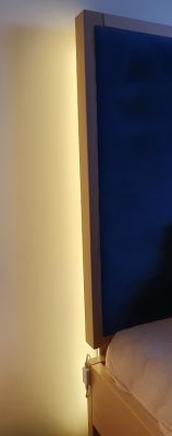

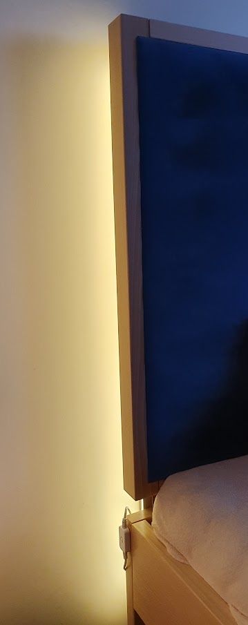

    I fixed the profiles with the LEDs vertically with double-sided tape at the back of the "headboard", or whatever that part of the bed is called. In my case, it is shaped like a large vertical rectangle, so assembly was trivial. I taped the switches to the sides of the bed frame in convenient locations.
    Overall, it turned out pretty well. The LED strips can serve a decorative role in the evening. To switch on/off, all you have to do is 'tap' your hand on the appropriate spot. Getting used to where, it took... it didn't take, it came straight away. I find this much more reliable than all sorts of motion detectors. In addition, you can adjust the brightness - and very well, because in practice at night, the smallest that a castorama dimmer allows is sufficient.
    And most importantly - the whole thing was approved, and even pleases the more beautiful half ;-) .
    Anyway, as they say, pictures can replace 1,000 words. The left side of the "headboard", the right side is analogous:
    Touch LED switch mounted on a bed frame Vertically mounted LED strip behind the bed in the bedroom. .
    I will not publish the schematic so as not to offend fellow forum members ;-)
    Oh, I did not measure the power consumption of the power supply at idle or during operation. To tell the truth, I didn't even think about it. Switching power supply, so I'm thinking idle up to 1W, and probably less. But even if it draws this watt, somehow these few zlotys a year I will survive ;) .
    P.S. I know: there are ready-made LED strips on sale in various lengths, with a touch switch already built in. All you have to do is stick it on, connect the power and you're done. However, in my case - specifically the location of such a strip somewhere at the back, behind the "headboard". - I didn't know if it would pass the test. Especially when it came to the location of the switch. You would have to reach somewhere "behind the headboard". Here I was able to place both strips and switches where I wanted. And with an hour of "DIY" it was ;-) .
