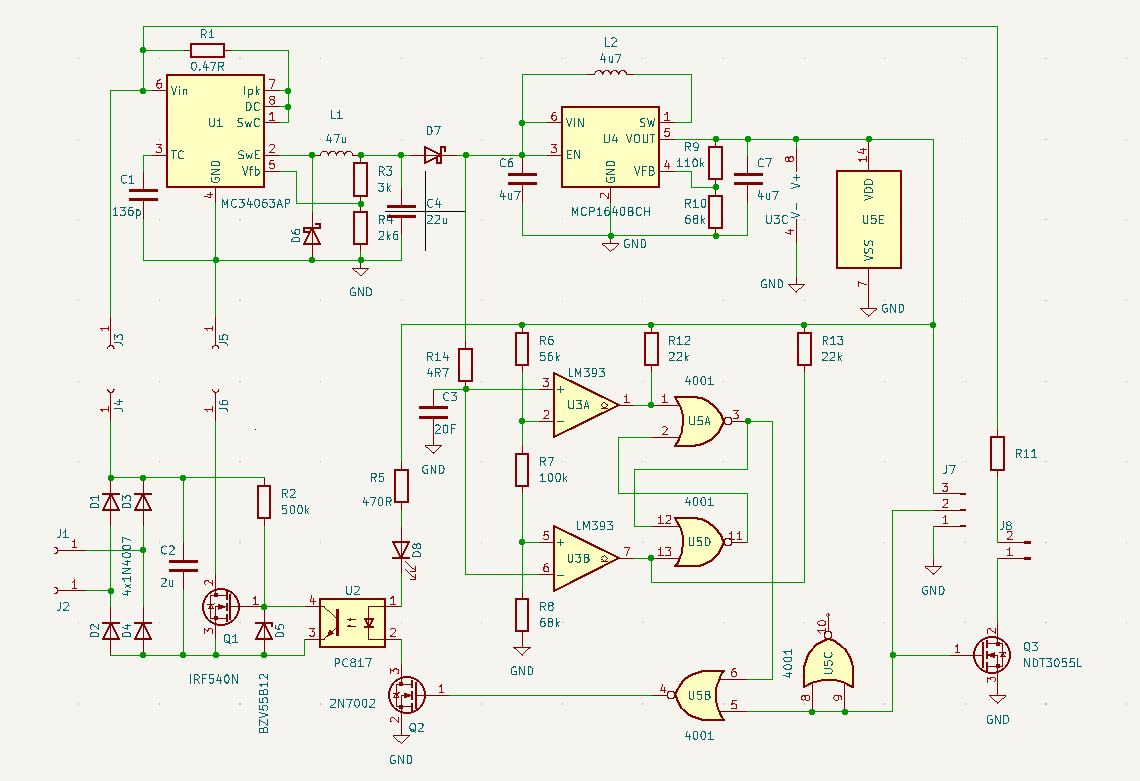

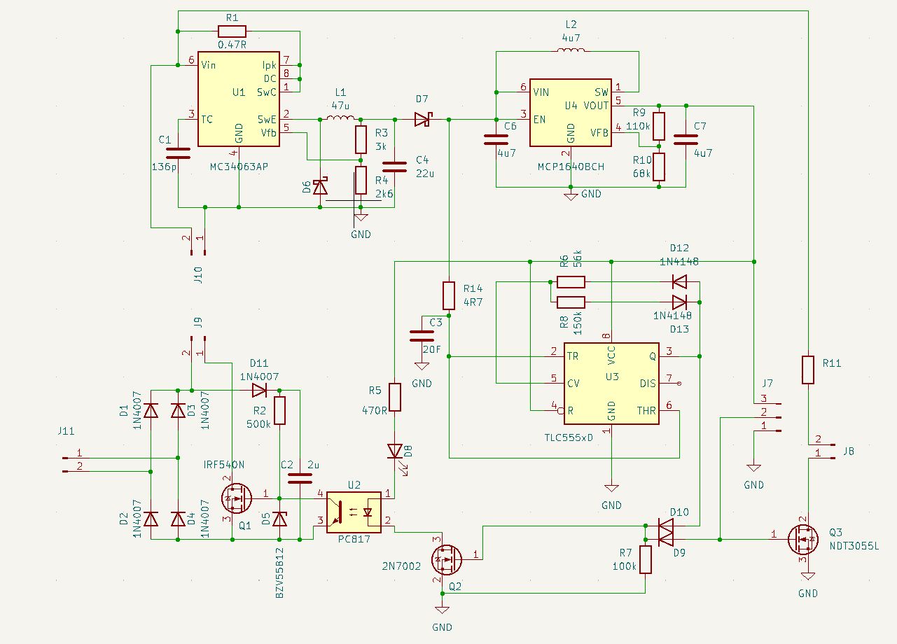

    To begin with, of course, the schematic diagram:
    Electronic schematic of an LED lighting system with a PIR sensor. .

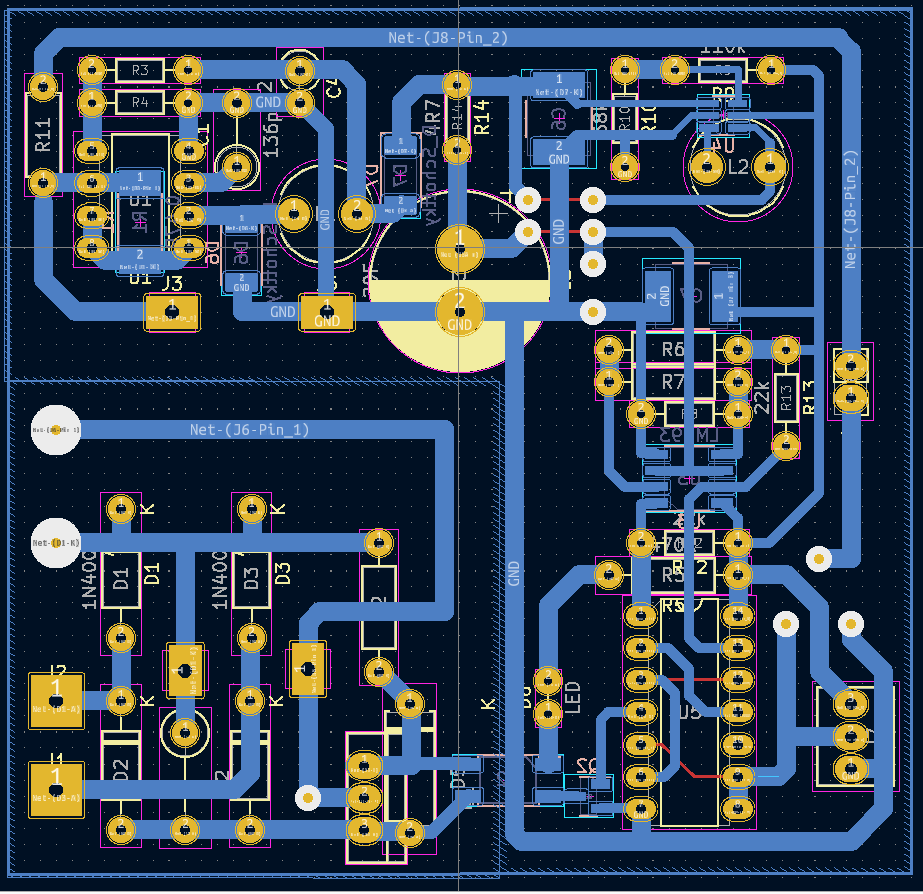

    and the circuit board, as usual made by myself:
    Printed circuit board showing an electronic circuit for LED lighting activated by a PIR sensor. .
    It's worth saying a few words about the electronics themselves.
    I don't have a problem with using processors where it makes sense, but in this case I preferred to use "more discrete" circuits, as using a processor in such a circuit wouldn't simplify anything circuit-wise, and you'd have to write some nonsense control software in addition.
    So how does the circuit work?
    Let's start with the fact that the circuit remains in standby for 100% of the time while being powered by the supercapacitor. When the voltage on the supercapacitor is sufficient, the circuit blocks the mains voltage through a circuit consisting of an optocoupler, an NMOS transistor and a bridge rectifier.
    When the voltage on the supercapacitor drops below a designated level, the mains voltage is switched on and goes to a DC/DC converter or, more precisely, an AC/DC converter working as a DC/DC in this circuit. The inverter is an ordinary power supply from some mobile charger giving 12V and about 400mA at its output.
    This voltage is used to power our LED strip and, when reduced to a value of about 2.7, charges our supercapacitor.
    When the voltage on the supercapacitor reaches the required value, the mains voltage is disconnected from the circuit. The charging time of the supercapacitor is two to three minutes, and then the system operates for about six hours on the supercapacitor alone.
    When movement activates the PIR detector, the mains voltage is switched on to power the lighting connected via the NMOS transistor, while the supercapacitor is charged.
    Sensitivity and duration of illumination are adjusted by Pr-controls in the PIR detector (obviously of Chinese manufacture).
    The mains voltage switching circuit is made on LM393 comparators and a CD4001 chip.
    It is strikingly similar to the NE555 circuit, which gave me the idea to replace the LM393 and CD4001 tandem with some NE555 type circuit.
    Unfortunately, the standard NE555 has improperly set switching thresholds and also draws considerable current, which is undesirable in such a device.
    So I found Texas TLC555 circuits in my stash and reworked the circuit diagram for these. They have negligible resting current, small dimensions (SMD) and replace (after minor modification) a pair of LM393 and CD4001, saving space and standby current consumption.
    Below is a diagram of the device with the TLC555 chip:
    Electronic circuit diagram for LED lighting with PIR sensor. .

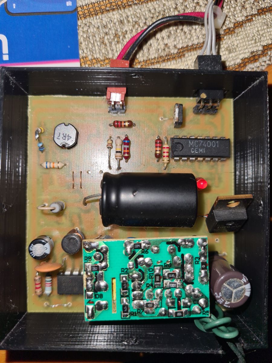

    The finished circuit in the box looks like this:
    View of the interior of an electronic device with a mounted printed circuit board featuring various components..

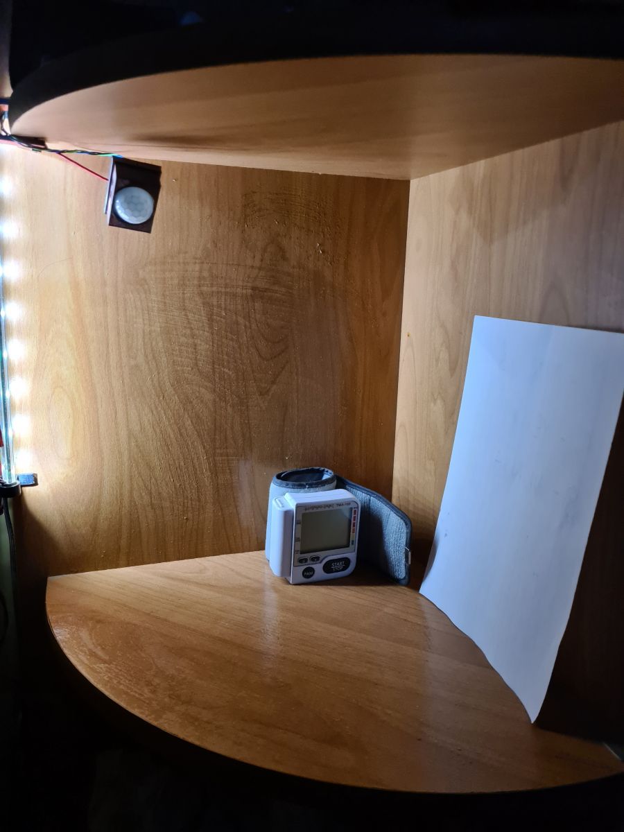

    And then there's the same arrangement mounted on a bedside cabinet:
    Corner of a room with installed LED lighting and a PIR motion sensor. .

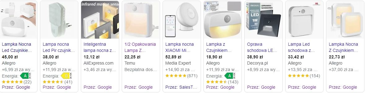

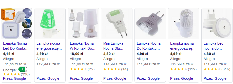

    It's nice to look at the analogue logic and your work put into it, but additionally with me you would have won the monthly form over content contest ;) .
    You don't write specifically what the current draw of the PIR sensor used is, but if it's really so small that you decided to power it with a supercapacitor, why not just power it with ordinary batteries or a Li-Ion cell? All the logic and expensive supercapacitor circuitry would be superfluous, if you were stubborn you could add a detector and low battery voltage indication. Or a little differently - a transformerless power supply on a capacitor in a plug-in housing (e.g. from an old transformer power supply) permanently plugged into an electrical socket.... and you have a ready-made device for a dozen or so zloty...
    Screenshot of various night light offers with motion sensors on online store websites.

    Plus for the independent construction. I see some drawbacks here. Firstly, the circuit does not have a light sensor and will also switch on during the day. I also don't quite understand what the point of using a supercapacitor is. It charges from the power supply anyway, so the amount of energy taken from the mains is the same as with a direct power supply. It unnecessarily complicates the circuit.
    Such a driver for an LED strip with external light detection and motion detector, powered from a 5V micro USB charger on Ali costs PLN15. Probably not worth knocking down an open door in such a case.

    Such lights at a price of PLN11 I think are still on ali of course with a brightness sensor, the only problem is during the day you have to expose them to the sun.

    An idea that is impractical in every way. The motion sensor will react to any movement of the sleeping person and the light may be on all night.
    Ready-made devices of this type can be bought, not as written above, for over PLN20 as they are under PLN5.
    Screenshot of offers for night lights on Allegro. .

  • Side-mounted motion sensor for wake-area activation
    #13 21141508
    yego666
    Posts: 2175
    Help: 239
    Rate: 564
    @md
    I didn't write that there aren't any, but they all either have an on/off switch, are battery operated, are expensive, don't give room for your own creativity, and are certainly Chinese made which in my eyes completely disqualifies them.
    As far as switching on the device is concerned, it can be positioned not in front of the nose of the sleeping person but somewhere to the side behind them, so that the field of reaction covers the area we are interested in.
    The system will then switch on when the awake person makes a movement in the area we have selected, O!

  • Set 34063, LM393, and TLC555 thresholds correctly
    #15 21141984
    yego666
    Posts: 2175
    Help: 239
    Rate: 564
    I have three more comments on the design of the device.
    The output voltage of the 34063 regulator should be set so that the voltage on the cathode of diode D7 does not exceed the maximum permissible operating voltage of the super-capacitor minus 0.1V, i.e. for a capacitor with the permissible voltage of 2.7V a voltage of 2.6V should be set on the cathode of diode D7, which means that the output of the 34063 regulator should be set to 2.7V ( maximum 2.75V ) because the drop on diode D7 ( schottky ) is from 0.1V to 0.15V depending on the current.
    At the output of the U4 circuit, a voltage of at least 4.1V should be set, as the LM393 comparator responds correctly to an input excitation of 2.6V when its supply voltage is 1.5V higher, i.e. at 4.1V.
    For the TLC555 chip, this voltage may even be below 3V, but remember that this voltage controls the gates of transistors Q2 and Q3 (so it must be sufficient to drive them fully) and supplies the PIR detector, which starts at 3V.
    In the TLC555 circuit, it is additionally necessary to calibrate ( preferably with PRs ) the switching thresholds of the comparators contained in the TLC555 circuit so that the lower threshold ( set by R8 ) is about 1V, and the upper threshold ( set by R6 ) is 2.6V.
    Unfortunately, the TLC555 circuits have quite a spread in the parameters of the internal voltage divider, hence the need to calibrate them for a particular circuit.
    For my copy, the resistance values of R6 and R8 are as shown in the schematic, but other copies may differ significantly in this regard.

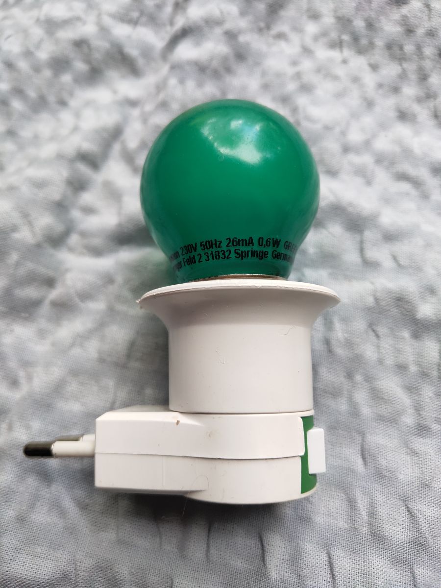

    You take a green LED light of very low power (here 0.6W) and plug it into a socket.
    At night, once your eyes have become accustomed to it, you can see everything, and the illumination does not disturb your sleep (thanks to distant ancestors who lived in the green twilight and evolved the greatest sensitivity of sight for green...).
    Small green LED bulb with 0.6W power connected to a plug.

    I like structures made from scratch. Quite unusual in this design.
    But wouldn't a small illuminated switch within arm's reach be enough?

    #26 21142618
    yego666
    Posts: 2175
    Help: 239
    Rate: 564
    Dear Colleagues, I very much appreciate your comments and guidance.
    Undoubtedly, the solutions with green and pink lights are cool and simple to make ( or buy ), but that's what we have a head and free time for, so that instead of buying various gadgets that don't quite meet our expectations, we can think, design and make ourselves what meets our assumptions 100 per cent and not 10.
    A lamp or any other device plugged into a socket and switched on for 8 or 10 hours a day consumes a certain amount of energy, for which you have to pay, and also first burn a forest (there aren't many of them) or a fossilised dinosaur to produce this energy while letting some CO2 into the atmosphere we breathe.
    My device only takes as much energy as it needs to live and occasionally light the way to the glass.
    It certainly saves on the electricity bill, and reduces the carbon footprint, if only slightly.
    We don't know how to do things so that we can still pay someone to do them for us - even if only for 5 zloty.
    In addition, it is worth noting that self-construction of various devices is based to a large extent on recycled parts and components, so by using them we do not increase the need for new components, ergo we protect the environment.
    One cannot base an assessment of the desirability of constructing one's own appliances solely on the criterion of profitability. "Man does not live by bread alone". There are other, more relevant criteria, which unfortunately we do not always recognise.
    The presence of the human species, for example, is completely unprofitable for our planet, yet it sustains and feeds us, and according to the doctrine of profitability, we should not be here.
    As for the PIR, with me it responds in about 1/2 a second, so it's just a matter of getting the sensor positioned properly so that a hand or head entering the field of observation triggers the device in advance. I don't have ADHD, so I don't have compulsive behaviour either, hence the 1/2 second is all too well.
    In addition to lighting the way to the glass, I installed the same device in the hallway to light the way to the kitchen.
    I know that there are LED bulbs with built-in PIR detectors, but they fall into the category of those adequate only 10 per cent of the time.
    So leave such solutions to those who have no idea about electronics and are condemned to buy such pseudo-energy-saving gadgets.
    One more comment on the PIR detector. As you can see from the diagram, the detector is not permanently connected to the device and power is available at the connector. So instead of it, you can make yourself a laser or other sensor that will light the way for someone faster than the PIR detector.
    Oh, and a note to the use of a supercapacitor for a "non-kosher" purpose.
    To give an example: no one is forbidding cars from racing on the F1 circuit even though in principle they should be driven on roads and carrying people or goods, and yet people do it.
    So why shouldn't I use a supercar where I like it and it makes sense? Should the small imagination of supercapacitor makers limit my creativity?
    The essence of progress is the negation of what exists and not Talmudic adherence to dogmas set by those who know better.

    You can always think of a microwave sensor - it can be inside an opaque housing....
    From there, there are ready-made ones: https://pl.aliexpress.com/item/32996528902.ht...n.753.39e21c24pFz60i&gatewayAdapt=glo2pol
    I gave one such at my place, with a green light, after getting very painfully knocked out on a cat puke ;)
    "My device only takes in as much energy as it needs to live". - well, then you would still have to count the energy required to produce its components ;)
    The green light has been tried and tested in practice - my old Mother, who had to get up at night, praised it highly.
