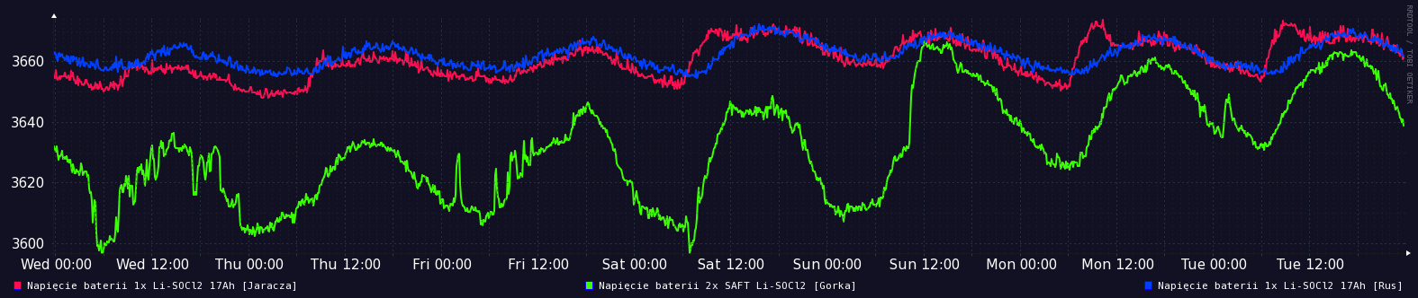

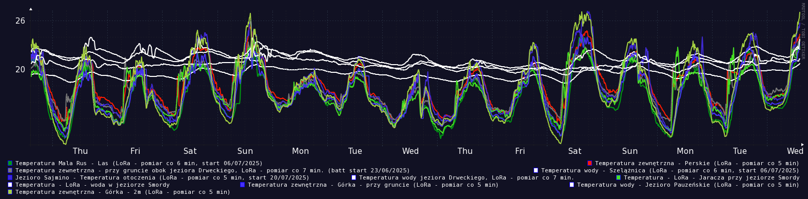

    Two weeks have passed and the sensors are still sending data without problems.
    On the graph, the water temperature in several lakes.
    Graph showing water temperature changes in five lakes measured every few minutes .
    It's also cool to see where I used a lithium battery from a different company in one unit and the voltage fluctuates differently.
    Graph of voltage for three lithium batteries in measurement devices over 7 days
  • #32 21633519
    jarekgol
    Level 40  
    Posts: 5147
    Help: 642
    Rate: 1137
    Why does the red have such sharp pins and the yellow is so smooth? Some depth of immersion or access to sunlight?

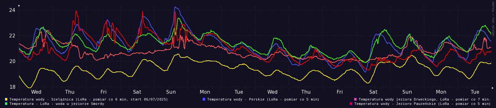

    >>21633519 Sensors at a depth of about 1m, it varies sometimes 2m from the shore sometimes 10m, access to the sun is at this depth but that's not it. There are quite a lot of different vessels floating on this lake, I have a PTZ camera there and I have already observed that when something passes close by it just makes such temperature fluctuations.
    In the graph the white colour is the water temperature and the coloured ones are the outside temperature next to the lakes.

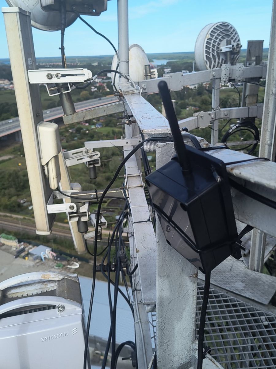

    I see on the charts that the average RRSI over -100 and no problem with reception, I have a problem receiving all the packets from the basement to the fifth floor of the same block, at my place RRSI between -102 and -107, SNR -20. Out of 3 short packets sent 1-2 arrive.
  • #38 21743697
    dktr
    Level 26  
    Posts: 937
    Help: 45
    Rate: 729
    >>21742985 I already have a total of 6 gateways with different antennas in different locations, from observation the most important thing is the background/noise level, with a shorted antenna input the SX1278 indicates -137 dBm with a 125 kHz channel width set, the worst radio conditions I have are on the chimney of a heating plant, even though it is very high there - about 100 m, in a very short distance there is a whole bunch of different devices, radio links, sector antennas of probably all operators, a few of my sectors at 5 GHz, a few radio links at 60 GHz, and a tangle of twisted-pair cat7 causes that on a small antenna the background does not go below -100 dBm and despite the fact that this gateway is the highest it receives the worst and the fewest packets compared to the rest. The gateway works best on a 50m pole where there is no mobile operator and only my toys at 5/60 GHz.

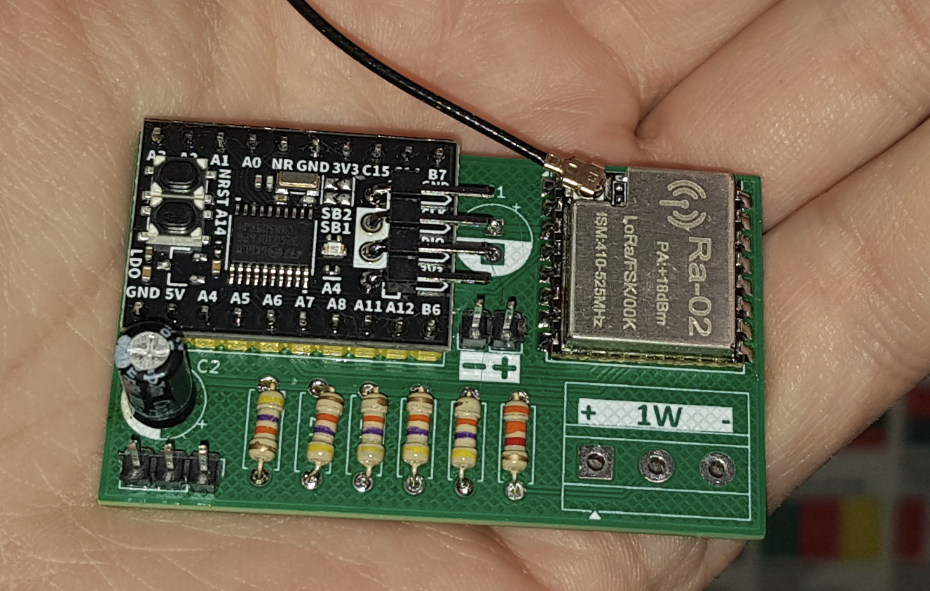

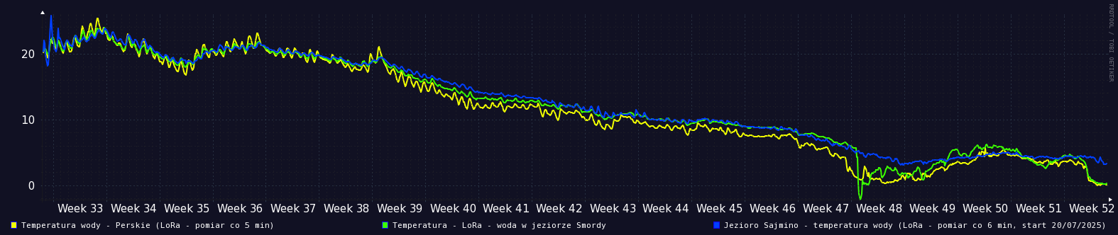

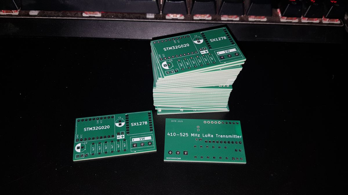

    Six months have passed. 3 of the 8 temperature transmitters scattered around the site are still working properly, 4 have been destroyed by animals - mostly beavers. They knock over the trees on which the transmitter was mounted, bite through the wires to the sensor, so that there is a short circuit and the battery runs out, or so that only one sensor is working. One has been stolen, simply disappeared.
    During this time I found a few bugs in the code - in the transmitter the temperature values were incorrectly sent from -1.0 to +1.0 which only came out in winter, in the gates I found a problem that caused unexpected reboots of the device, but there I have implemented OTA so I can do the update remotely.
    By the way, I also made PCBs for the transmitters so I don't have to solder it on wires all the time.
    Water temperature for the last 20 weeks

    New tiles for transmitters
    PCB with Ra-02 module and microcontroller held in a hand
    Stack of green PCB boards labeled STM32G020 and SX1278 on black surface

    No it won't work, listening to the RX all the time draws too much power, and it would be difficult to synchronise it all and only run it when needed. Currently I have changed the type of housings to ones with 4 holes and screw it to the tree with 4 screws, hardly anyone walks in the woods with a screwdriver, I changed the cable to the sensors from random thin wires (like in headphone cables) to a thick microphone cable. There is a sticker on the case saying not to destroy and a link to a page where there is a map with measurements.
