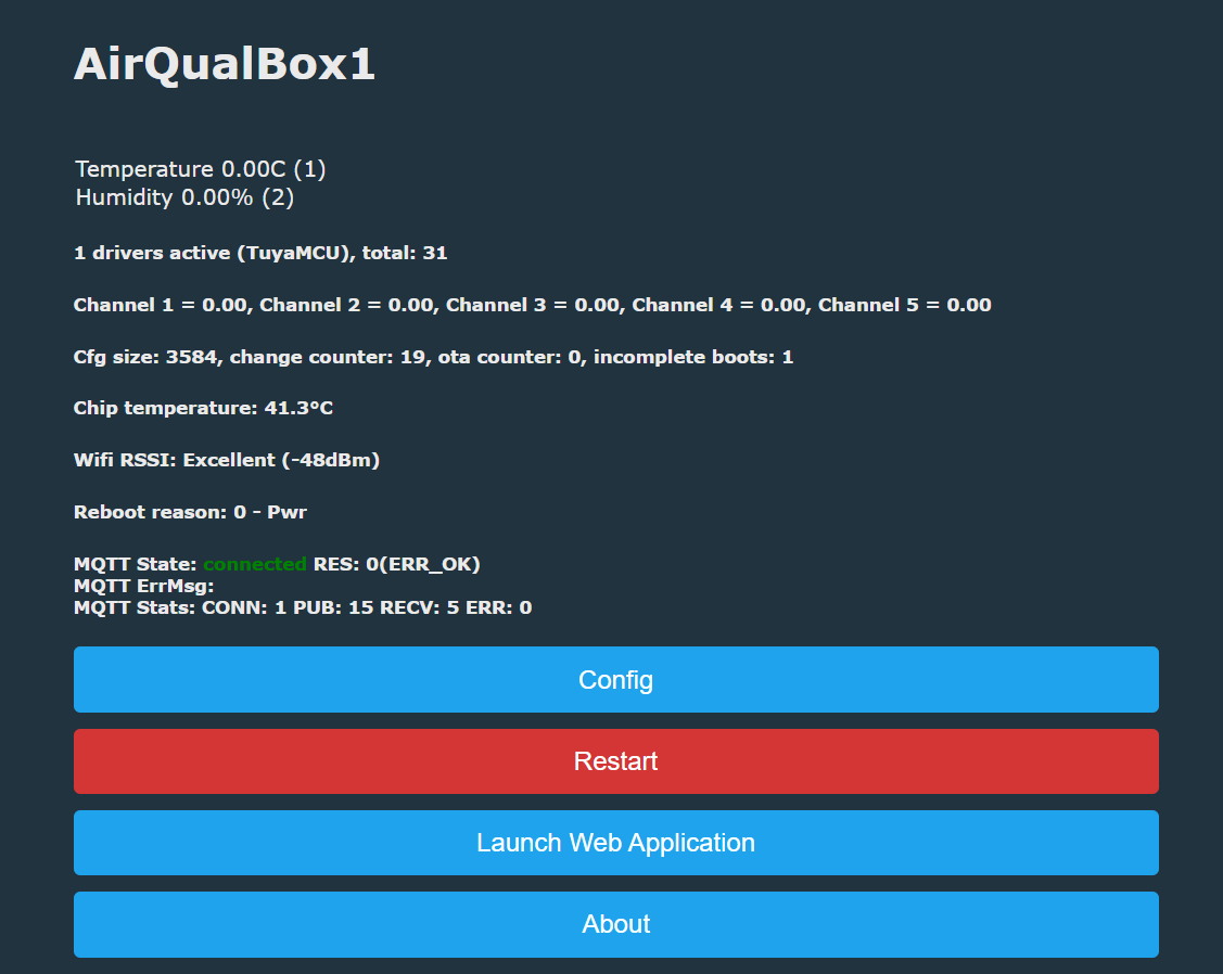

  • #42 21655612
    ppikart
    Just because it's the only online discussion I can find about this sensor:
    Does anyone know how it dares to report a CO2-Value? Is it just the output of the VOC-sensor that is calculated into a CO2, VOC and formaldehyde-value?
  • #43 21655666
    ngocnguyenme
    Level 4  
    Posts: 7
    >>21655497 that already done, but I still get this after physically rebooting the device
    AirQualBox1 device interface screen with technical data and control buttons.
  • #44 21655679
    Posts: 14622
    Help: 655
    Rate: 12638
    How your autoexec.bat looks like?
    Maybe you need to add a state query after startup, but probably not, that's tmSensor device.
    Simple work-around could also work - use low channels number for variables and then in configure startup set them to -1, to the value is kept between reboots.
  • #45 21656298
    ngocnguyenme
    Level 4  
    Posts: 7
    >>21655679 I just copied from >>21169869, nothing changed. I really don't know how to start with "low channels number"? Could you explain it further please!

Use a transistor-switched buzzer on P8 and control it from a linked OpenBeken channel. 1. Assign P8 to channel 8 and set its role to Relay, Rel_n, LED, or LED_n. 2. Add alias ALARM_ON setChannel 8 1 and alias ALARM_OFF setChannel 8 0. 3. Run a loop such as if $CH1>580||$CH6>890||$CH3>50||$CH4>200||$CH5>1200 then ALARM_ON else ALARM_OFF. Do not drive a 35 mA buzzer directly from the CB3S pin. [#21595628]
Why doesn’t a multiline if/else script work in OpenBeken autoexec.bat, and what is the correct single-line syntax for alarm logic?
It fails because OpenBeken does not support multiline if/else syntax in autoexec.bat. The maintainer stated that directly, and the fix was a single-line command such as if $CH1>580||$CH2>890||$CH3>50||$CH4>200||$CH5>1200 then ALARM_ON else ALARM_OFF. Once rewritten to one line, the alarm logic worked. [#21595612]
How do I configure a CB3S GPIO pin to follow an OpenBeken channel, such as setting P8 to Relay or LED on channel 8?
You must assign both a role and a channel to the pin. setChannel 8 1 changes channel 8 only; it does not drive P8 until P8 is configured as Relay, Rel_n, LED, or similar and linked to channel 8. The maintainer noted that the channel number can be any value, but the pin-role mapping is mandatory. [#21595031]
What causes this Air Box to boot with zero or stale values until a restart, and how can I keep readings valid across reboots with setStartValue or state queries?
The device can boot without refreshing TuyaMCU datapoints, so channels stay at 0 or retain stale values until a restart or query. Two mitigations appeared in the thread: add tuyaMcu_sendQueryState at startup, and use low channel numbers with setStartValue <channel> -1 so the last values persist across reboots. A later example used channels 1, 3, 4, 5, 6 with setStartValue on each. [#21816233]
How can I schedule an automatic daily reboot in OpenBeken using NTP and addClockEvent to recover from stuck sensor values after power outages?
Start the NTP driver, set a time source, and schedule a clock event. The working example was: startDriver ntp, ntp_setup 0.pool.ntp.org, ntp_start, ntp_timeZoneOfs 1, and addClockEvent 13:30:00 0x7F 1 reboot. The user first tried a long delay alias, but daily reboot worked after switching to NTP-based scheduling. [#21816233]
What sensors are inside the Tuya Smart Air Box, and how were the DHT20 and HMNST HGS1000 identified in the thread?
The thread identified a DHT20 for temperature and humidity and an HMNST HGS1000 gas sensor module. The DHT20 was confirmed by a board photo on July 30, 2024, and the HGS1000 name later came from HMNST contact confirmation shared on July 31, 2024. OpenBeken support was described as straightforward for DHT20, while HGS1000 protocol support was not available. [#21174757]
OpenBeken vs ESPHome on the Tuya BK7231N Air Box: which is better if I want to use spare pins for alarms or IR control?
OpenBeken is sufficient if you want alarms or spare GPIO control, while ESPHome was chosen by one user for broader repurposing. This same Air Box already drove a buzzer from a spare pin under OpenBeken, and an OpenBeken maintainer also noted that OBK has an IR driver. ESPHome still worked fine for one user who switched to use free pins for other functions. [#21694989]
How does this Air Box derive its reported CO2 reading, and is it a true CO2 measurement or an estimate based on the VOC/formaldehyde sensor?
The thread does not prove that the CO2 value is a true dedicated CO2 measurement. Users confirmed a DHT20 plus an HMNST HGS1000 gas sensor, and one later question explicitly asked whether CO2 was calculated from the VOC sensor, but no definitive protocol or sensing method was posted. Treat the displayed CO2 as unverified within this thread, even though breathing on the unit changed the reading. [#21744651]
