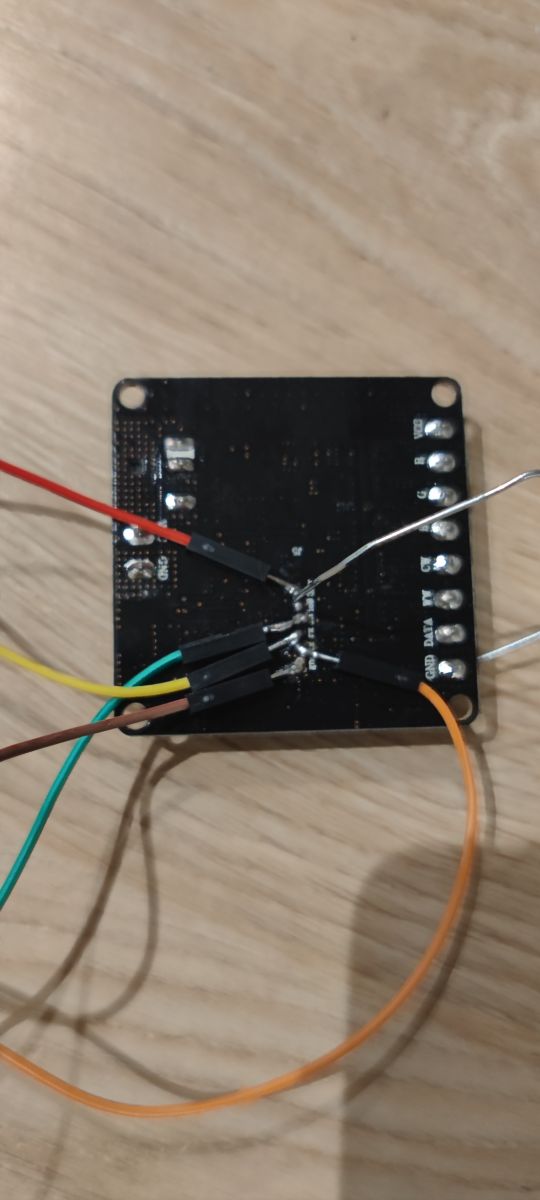

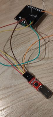

  • #34 21654381
    StephSDW
    Actually like that
    USB to TTL converter connected to a black electronic board with jumper wires
    Black electronic board with soldered wires on wooden surface
    I will try abrogate power so external power removing the 3.3 volt from USB TTL
    Thanks for your help, I'm totally novice in that kind of things

    I don't know this USB to UART converter, but does it provide enough current?
    The wires are a bit long....
    I am also not sure about solder joints - do you use flux?
    Maybe you can watch our channel to see how I flash devices: https://www.youtube.com/@elektrodacom
    |Try with this video:
    It's similar for ESP but you also ground BOOT pin as far as I remember, and use esptool, ofc.
