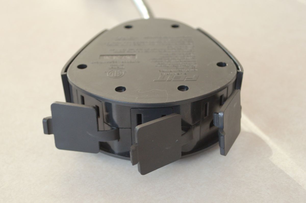

    First post here, sorry if I am doing something wrong. This is a teardown of the "Triple Outlet Outdoor Smart Plugs" from Feit Electric. This is an outdoor smart plug with one relay that controls three US outlets. This smart outlet came in a two pack for roughly $10 USD and I purchased these outlets from Costco.
    Packaging images:
    Packaging of Triple Outlet Outdoor Smart Plugs by Feit Electric. Packaging of Feit Electric outdoor smart plugs with three outlets.

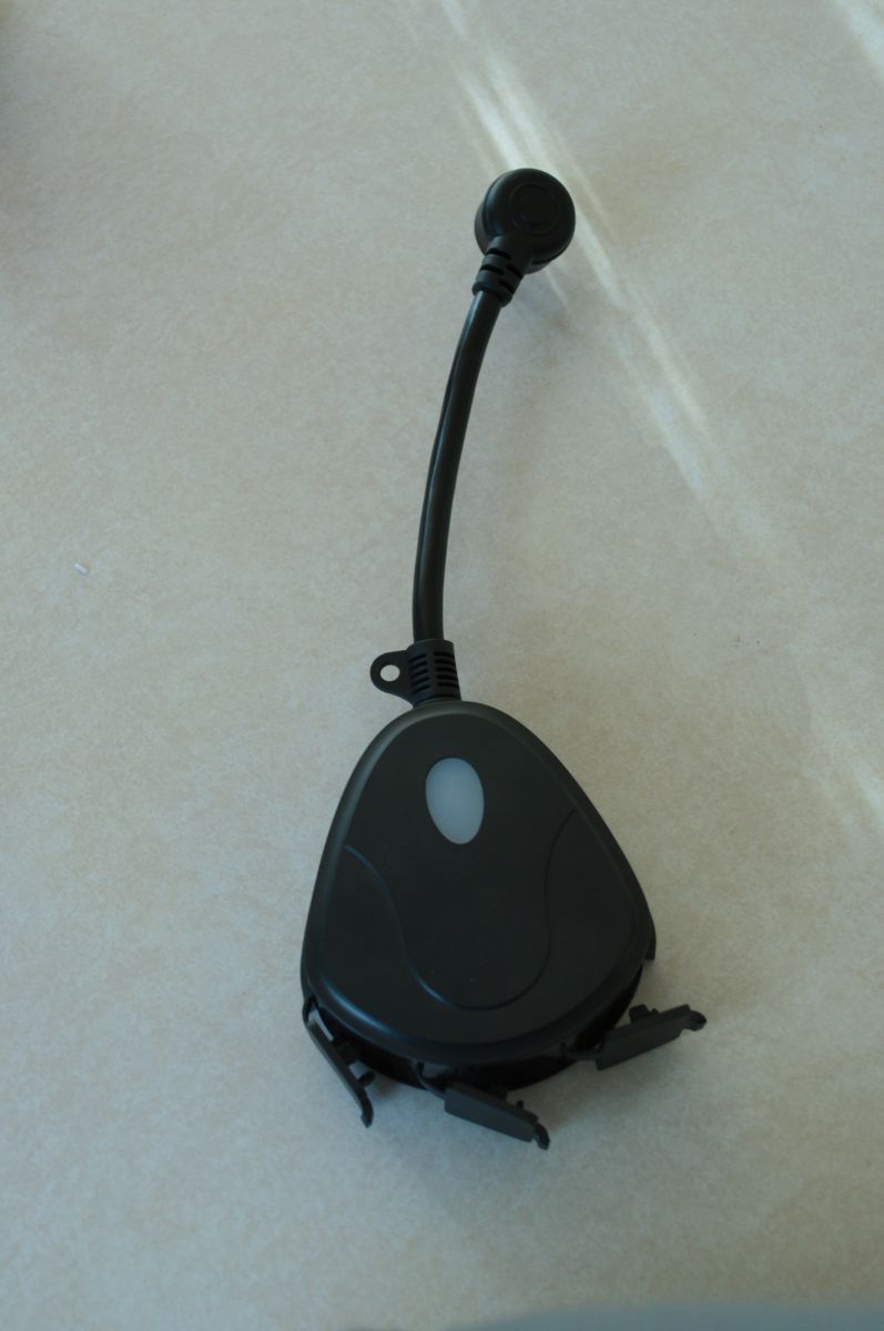

    Device appearance (there is one button and a blue LED which is lit when the outlets receive power. The LED can be disabled within the Tuya/SmartLife app):
    Black outdoor smart plug with three outlets and one cord. Bottom part of the Feit Electric outdoor smart plug with three outlets, showing mounting screws.
    The device can be disassembled by removing the 6 screws on the underside of the outlet(s). These are small, Phillips head screws. There is (what I presume to be) some hot glue by where the plug meets the main body of the outlet.

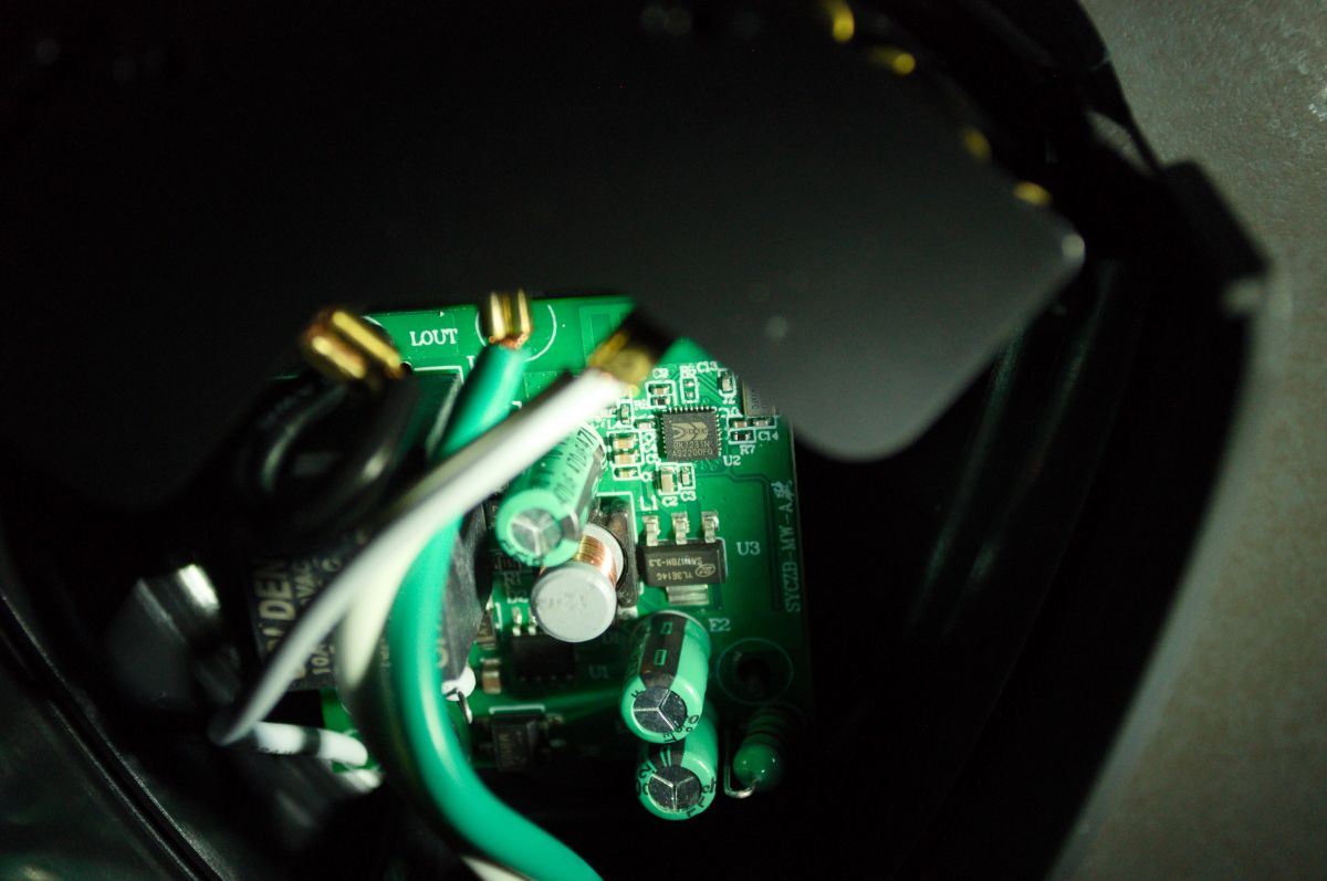

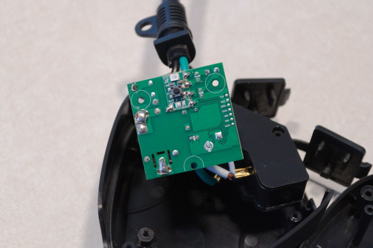

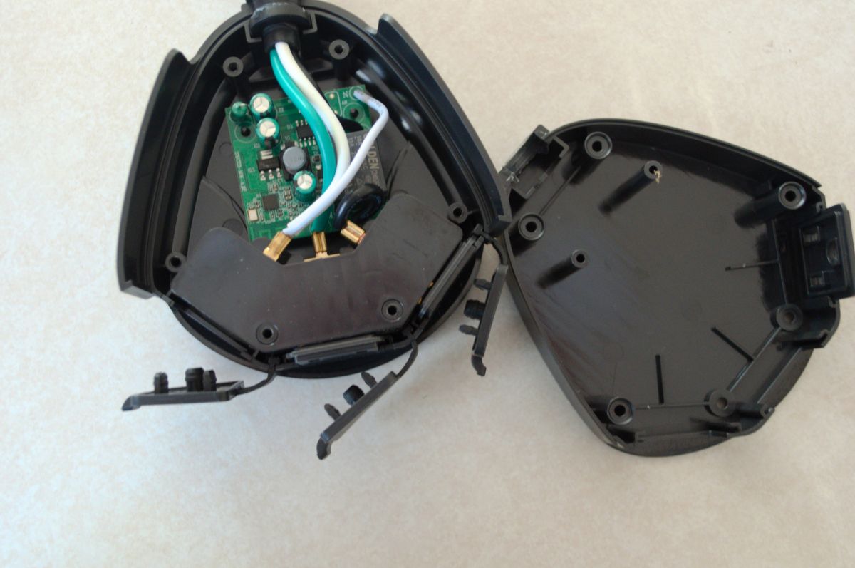

    This outlet uses a BEKEN BK7231N chip. I was unable to flash this device using tuya-cloudcutter. The "Main Module" version within the Tuya/SmartLife app is V1.1.17, which may be patched? Let me know if there's a way to flash this device without soldering. Here are some images of the innards of the device:
    Image of the open interior of a Feit Electric outdoor smart plug showing wires and a circuit board.Interior of a disassembled device showing electronic components and wiring.
    Disassembled PCB of Feit Electric outdoor smart plug.
    I apologize in advance if some of the photos are a bit blurry. I did not end up flashing this device as I don't have a USB to serial adapter, so I'm not sure what each GPIO pin corresponds with.
    I hope this helps!

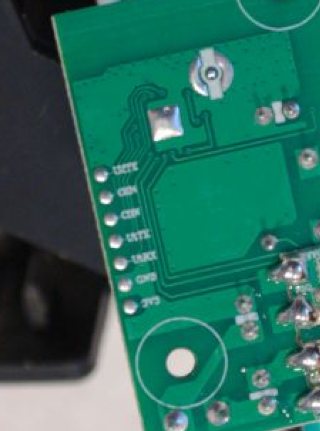

    interesting. The 2-plug version looks like it comes with (or did) a CB2S module, whereas this has the BK7231N soldered onto the PCB. Do you plan on freeing it from the cloud? Will you get a USB-TTL adaptor? Those test points on the underside of the PCB look like it'd be nice and easy.
    Close-up of a circuit board with visible test points.
    from top to bottom in my pic
    UXTX?
    CEN
    CSN?
    1ATX?
    1ARX?
    GND
    3V3
    please confirm

    The letters are pretty smudged and hard to read. Here's my best guess of the labelling:
    UXTX
    CEN
    CSN
    UITX
    U???
    GND
    3V3
    No idea if I want to try flashing this one. I'm planning on using this one for Christmas lights, and I'm not sure if I'll need both outlets working quite just yet. I'm also not too confident in my soldering abilities...

    Well. There'd definitely be a TX/RX pair. Anyway, it'd only matter if you decide to flash it.

    I was able to do a teardown and confirmed functionality of the following:
    U2TX - sends some debug messages at 115200 baud by default
    CEN - reset by grounding
    U1TX - uart loading (receive from here)
    U1RX - uart loading (transmit into here)
    GND
    3V3
    Successfully downloaded and flashed to OpenBeken via uartprogram of hid_download_py. CRC on download always fails.
    Config:
    P15 Rel
    P17 LED_n
    P26 Btn
    Failed to write via BK7231 Easy UART Flasher although it does download (and do a good crc for the BK7231N) and erase (reading back has lots of 0xFF where there was data)
    Traces are fairly fragile. Broke a U1TX trace clean off with the soldered wire before I got to freeing it from the cloud. I guess I should have just built myself a set of .08 in spaced contacts to clamp on and contact the pads.
