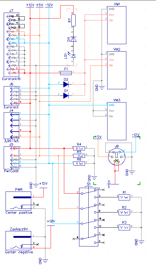

    The tester was developed to be able to monitor all supply voltages on the power rail simultaneously, both at idle and under some load on the power supply. Three standard digital voltmeter modules were used, which provide sufficient measurement accuracy for the issue at hand. With the exception that the voltmeter for 5V is three-wire, where the power was routed from the +12V rail, due to the brightness of the displays being too low at the 5V supply voltage.
    An Isostat-type bistable switch (I once salvaged a whole box of such switches from a telecoms lab dump) switches the load on all three lines of the power supply, in the form of 5W ceramic resistors. Their values have been chosen so as to achieve a current of about 250mA and not exceed the nominal power of the resistors. In addition, each voltage has one 1W resistor permanently switched on, which forces a current flow of about 20mA (which can be important for switching power supplies that sometimes don't like no-load operation). The panel voltmeter draws a maximum of 18mA with all segments lit, which may not have been enough, hence the added resistor. As you can see, the power supply under test does not make it to 5V when loaded.
    Power supply tester with three digital voltmeters and various connectors on a circuit board. Power supply tester with three digital voltmeters and various connection sockets. .
    To increase the versatility of the tester, in addition to the two Eurorack sockets, I added other sockets I use in my designs, namely PWL5, a single row goldpin 6 socket with a key in position 2 (the standard marked DotCom in the illustration above), and a mini-DIN 6 socket which, because of the The mass availability of PS2 mouse and keyboard cables and KVM cables is sufficient to carry the three power supply voltages and ground. A typical 5.5/2.1 power supply socket is also available for the +12V voltage.
    The schematic is simple and I only include it for the sake of completeness of the article.

    gilban wrote:
    I still don't know what such a modular eurorack system is for.
    I have edited the entry and emphasised in bold that it is about a modular synthesiser. A device that is used to create music, including autogenerated music, without the use of a computer or MIDI protocol (although the use of neither precludes either, the point being that it is a standalone system and does not need external control).
    Eurorack is one of the size standards for synthesiser modules.
    gulson wrote:
    All in all, I guess the tester could be useful for testing other power supplies? Probably a connector issue.
    Yes, of course, single-voltage power supplies (yes max up to 18V*) can also be tested. A 5.5/2.1 socket is provided for this.
    * Why up to 18V? Because when I connected such a ready-made voltmeter module between the +12 and -12V rails, the voltage of 24V whisked it away, smoke flew from the chip, even though the auction description says 3-30V. Up to 16.5V I checked, it survived.

    Piottr242 wrote:
    There was a need to develop something that would comprehensively show the parameters of the voltages being obtained simultaneously. A multimeter can only measure one voltage at a time, and besides, by manipulating the terminals of the multimeter with the device running, one can inadvertently short-circuit oneself.
    In my opinion, this type of tester should primarily be equipped with a good/bad indicator in the form of, for example, two LEDs, green and red. As it stands, it is up to the user of this device to determine that the power supply is working correctly, because he or she has to determine that the relevant indicators show the correct voltages.
    However, what if by accident someone mixes up the power supplies on the cable? The voltage indicators will show the correct set of voltages -12, 5 and 12 V, but will the user realise that the assignment is wrong? A 'bad' LED would clearly indicate that the power supply is failing the test.

    acctr wrote:
    In my opinion, this type of tester should primarily be equipped with a good/bad indicator in the form of, for example, two LEDs, green and red. As it stands now, it is up to the user of this device to determine the correct operation of the power supply, because he has to determine that the corresponding indicators show the correct voltages.
    Two LEDs would be far too few. For while it is easy to define a "power good" state on the basis that all voltages are present and none is higher or lower than +/-0.5V, "bad" states can be very different. Maybe one of the voltages is not present (burnt fuse), maybe one of the voltages is too high (shorted stabiliser). One diode will not tell which one is out of order. Three separate voltmeters will give a clear idea of what is happening before, and after, the power supply is loaded. Of course, this solution is much simpler than three separate window comparators, which also have to be powered somehow, and only from the test voltages. How then do you get the reference voltage if the supply voltage is lower than the required 12V?
    acctr wrote:
    But what if by accident someone mixes up the power supply on the cable?
    With IDC crimped cables this is unlikely to happen. However, for a plug-in cable, the polarity may be reversed. Thank you for bringing this to my attention, a diode should be added in parallel and a polymer fuse in series. I will take this into account in my next attempt, if any modular builders are willing and the board goes 'to the people'.
    The
    acctr wrote:
    voltage indicators will show the correct set of voltages -12, 5 and 12 volts
    They will not show. In the worst case scenario, i.e. polarity, we will be informed of a wrong connection by a magic balloon from the corresponding voltmeter.

    Is the tester protected against connecting another one, but with similar plugs, for higher voltages? That is, instead of +12V there will be +24 or more.
  • #8 21289845
    Piottr242
    Posts: 780
    Help: 36
    Rate: 300
    There is an attached diagram that answers your question.
    Similarly - there are no power supplies in the operating environment of my tester that you are asking about.
    The issue of protection is in principle only valid for a plug-in power supply, here protection against polarity and over-voltage should occur.

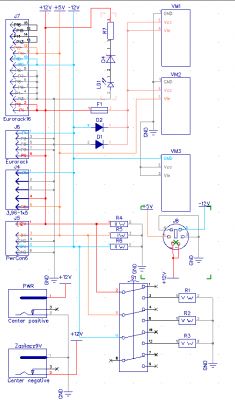

    Schematic, after taking into account the comments of Colleagues. Fuse protection, as a polymer fuse would introduce resistance and cheat the voltage measurement.
    I have also added a socket for a guitar effects power supply, where the positive pole is on the sleeve of the 5.1/2.5 plug.
