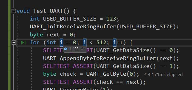

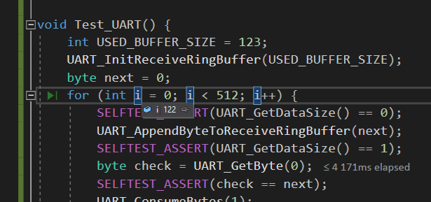

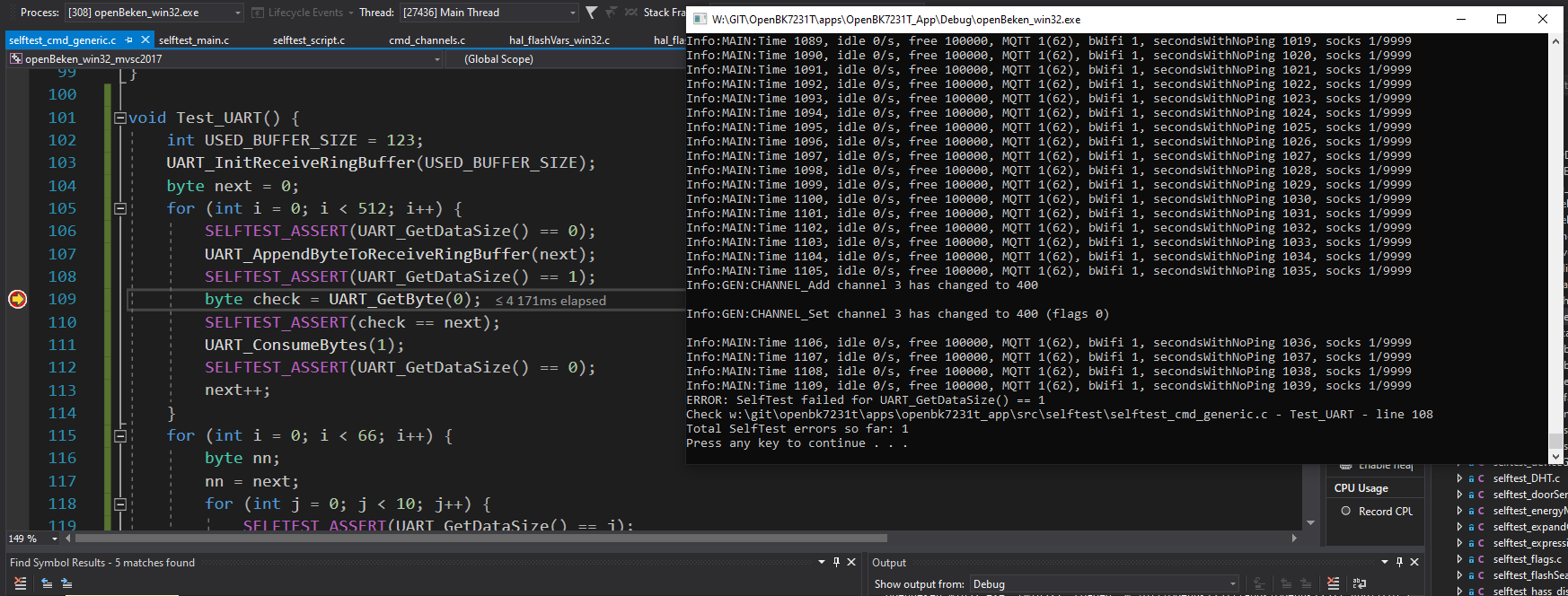

    Whoa, @XJ_ , very good job on checking UART code! There was indeed a bug:
    Screenshot of Visual Studio IDE with UART test code and output console showing test failure results.
    Screenshot of C language program code showing the Test_UART() function.
    I've added a self-test:
    https://github.com/openshwprojects/OpenBK7231...mmit/a2f3b020686633c643ab8790875e00173bb9d354
    and merged your PR:
    https://github.com/openshwprojects/OpenBK7231T_App/pull/1436
    The test should now pass correctly.
    That was indeed a very good job, keep it on, we need more fixes like that.

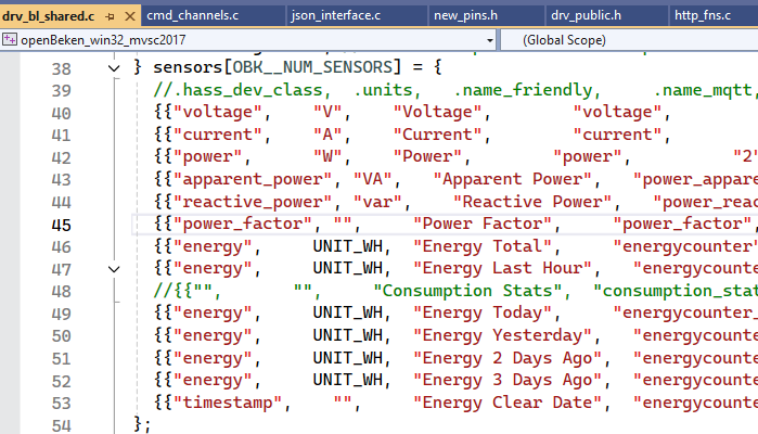

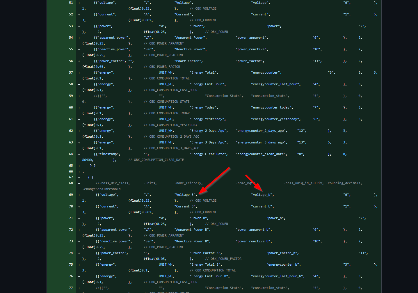

    but now, how does HA Discovery work? What is the MQTT name of first and second BL0942 readout values?
    @Src/driver/drv_bl_shared.c
    typedef struct energysensor energysensor_t;
    typedef struct {
      energysensor_t sensors[OBK__NUM_SENSORS];
    } energysensdataset_t;
    energysensdataset_t datasetlist[BL_SENSDATASETS_COUNT] = {
      { {      //.hass_dev_class,    .units,      .name_friendly,         .name_mqtt,       .hass_uniq_id_suffix, .rounding_decimals, .changeSendThreshold
          {{"voltage",      "V",      "Voltage",            "voltage",               "0",      },  1,         (float)0.25,      },   // OBK_VOLTAGE
          {{"current",      "A",      "Current",            "current",               "1",      },
           {{"voltage",      "V",      "Voltage B",            "voltage_b",               "0",      },  1,         (float)0.25,      },   // OBK_VOLTAGE
           {{"current",      "A",      "Current B",            "current_b",               "1",      },   3,
    Fragment of C code defining structures related to energy sensors.

    If the "voltage" MQTT name has changed to "voltage_b", then it will break compatibility with existing HASS configurations.
    Most likely the preferred (but a bit dirty) solution is to introduce voltages as "voltage" (no name change) and "voltage2", I guess?
  • MQTT naming for dual BL0942 readouts

    "voltage_a" instead of "voltage", it will break HA connectivity.
    Maybe I wrote it wrong, I don't want to use the suffix _a in any case. On the contrary, for the TuyaMCU driver (I have also one cube meter with TuyaMCU), I delete it (suffix _a) in HASS so that it works properly in HASS.
    Added after 9 [minutes]:
    So, here are my two current concerns:
    1. Does the current solution maintain compatibility with older HASS configurations (either via Discovery or configuration.yaml)
    2. Did you also include your changes in the HASS Discovery code, so Home Assistant "can see" both measuring chips?
    - ad 1 Yes - but only channel 0 as before
    - ad 2 Not yet, it only sends MQTT messages, which is enough for my needs at the moment. Once I have verified that it is ok this way, I will add discovery.
    That is why I have not made a PR for this modification yet.

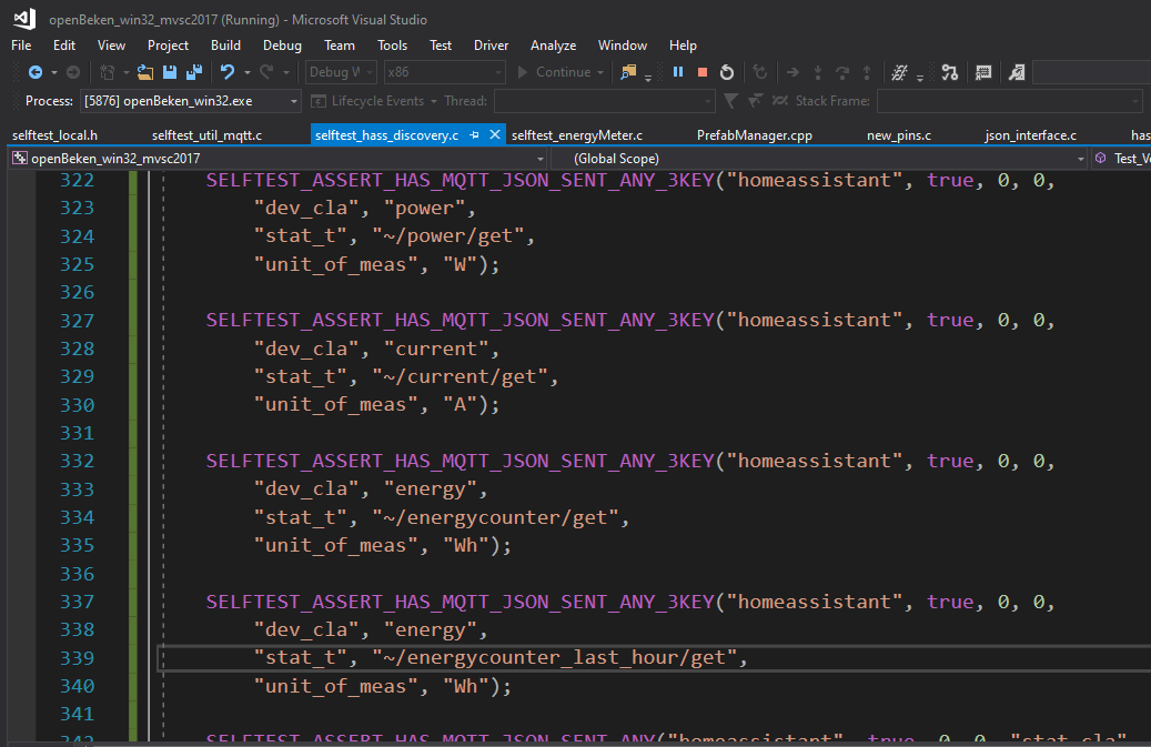

    I've double checked and it seems that selftest_energyMeter.c already checks for:
    Code: C / C++
    We also have Test_HassDiscovery_BL0942 in selftest_hass_discover.c:
    Code: C / C++
    The main drawback of current approach is that the tests don't check for keyword presence in given publish, but they check all publishes, but I will try to improve it as well. Still, they should detect missing MQTT topics well.
    Added after 8 [minutes]:
    Ok I am improving it:
    Code: C / C++
    Added after 12 [minutes]:
    Much better? Almost..
    Test code in Visual Studio editor regarding MQTT tests.

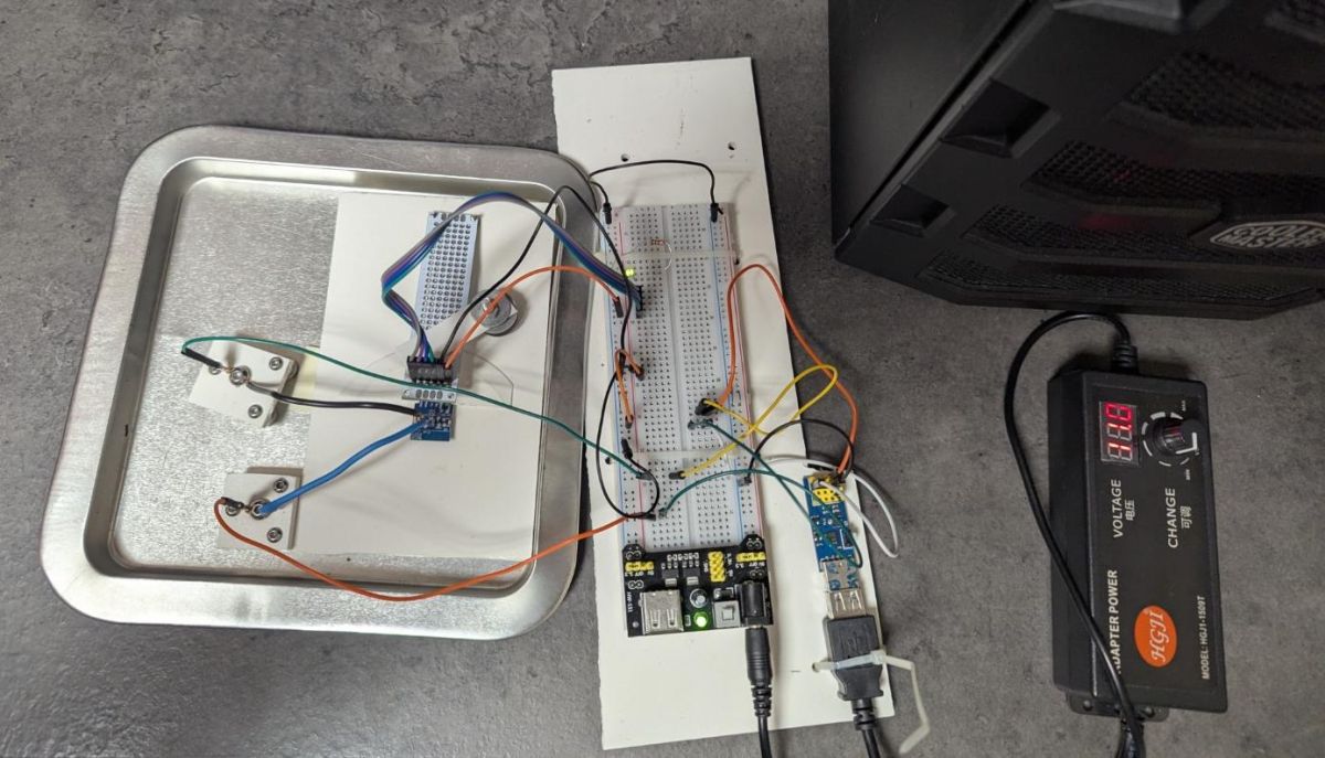

  • UART2 patch confirmed working on BK7231T and twin BL0942
    #45 21324450
    XJ_
    Posts: 141
    Help: 13
    Rate: 39
    >>21321593
    I got some WB2S today. I compiled it using PR https://github.com/openshwprojects/OpenBK7231T/pull/20 and the stock app using:
        git clone https://github.com/xjikka/OpenBK7231T -b uart2 ./bk7231t
        git clone https://github.com/openshwprojects/OpenBK7231T_App ./bk7231t/apps/OpenBK7231T_App
        cd bk7231t
        ./build_app.sh apps/OpenBK7231T_App OpenBK7231T_App 1.17.777-uart2sdk
    And BL0942 on UART2 works without any problems with this autoexec.bat:
       logtype none
       setflag 26 1
       startDriver BL0942
    Also, when I send some dummy bytes to UART2, I get as expected:
       Warn:EnergyMeter:Consumed 30 unwanted non-header byte in BL0942 buffer
    So I can confirm that this UART2 patch is also ok for the BK7231T chip and it is mergeable from my side.
    As a bonus I checked the twinbl0942mod branch and both channels on both UARTs working with this PR.
    And as an added bonus, here's my test build. Just so you know how not to do it ;-)

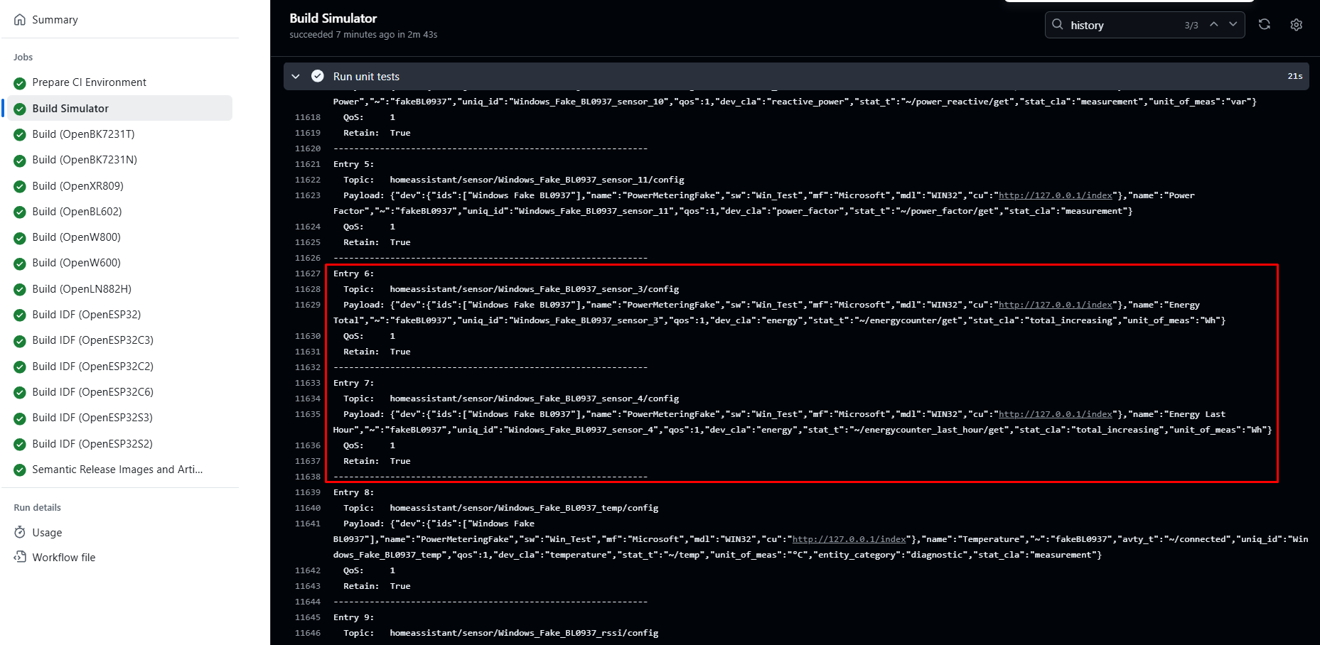

  • Self test now fails only on GitHub build
    #46 21324542
    Posts: 14756
    Rate: 12883
    Nice, I see you're using the same variable power supply that I did once a teardown of:
    https://www.elektroda.pl/rtvforum/topic3919579.html
    As for the protoboard power supply, well, I have my own version:
    https://www.elektroda.pl/rtvforum/topic3752773.html
    Today I extended the self test a bit:
    https://github.com/openshwprojects/OpenBK7231...mmit/a6dcddb6a533901c38a0d1b03939e4cf449babc2
    ... but for some reasons now, self test fails on Github but not on my PC? I need to investigate... maybe it times out on the cloud build. I can't see anything wrong in Github logs.
    I've merged the BK7231T PR.
    The red wire is there to make it hot and spicy, right? |;)
    Breadboard with a red wire connected to a blue electronic board.

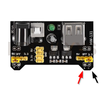

    The version from Ali is really weak (current) and the stabilizers get hot even at low load. However, it is enough for me for testing.

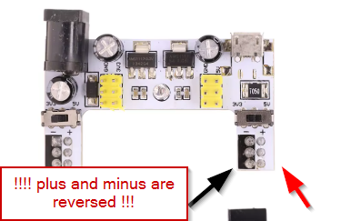

    Power module with USB output and power connector, polarity marked with arrows.
    I have also another version, and it almost blew up my processor.
    !!! plus and minus are reversed !!!
    Electronic module with highlighted reversed power supply polarity.
    Fortunately, I noticed it in time!

    For now, I am investigating myself, it seems that two of self tests fail on Github but not on my machine:
    ERROR: SelfTest failed for SIM_HasMQTTHistoryStringWithJSONPayload("homeassistant", 1, 0, 0, "dev_cla", "energy", "stat_t", "~/energycounter/get", "unit_of_meas", "Wh", "stat_cla", "measurement")
    Check D:\a\OpenBK7231T_App\OpenBK7231T_App\src\selftest\selftest_hass_discovery.c - Test_VerifyForCommonPowerMeteringStuff - line 339
    Total SelfTest errors so far: 3
    ERROR: SelfTest failed for SIM_HasMQTTHistoryStringWithJSONPayload("homeassistant", 1, 0, 0, "dev_cla", "energy", "stat_t", "~/energycounter_last_hour/get", "unit_of_meas", "Wh", "stat_cla", "measurement")
    Check D:\a\OpenBK7231T_App\OpenBK7231T_App\src\selftest\selftest_hass_discovery.c - Test_VerifyForCommonPowerMeteringStuff - line 345
    Total SelfTest errors so far: 4
    Info:MAIN:Drv BL0937 stopped.
    I've added SIM_DumpMQTTHistory and if it does not lead to the solution I will investigate in the separate branch (to avoid spamming main releases).
    So seller is so greedy that he actually tries to sell the product with obvious flaw instead of scrapping it? Well, maybe it's not that bad, assuming that he sells it under special discount price..

    EDIT - regarding my issue:
    Screenshot of a build simulator with several entries related to Home Assistant sensor configurations.
    ahhh it has stat_cla total_increasing and not measurement. But it does not explain why it didn't fail on my machine! Did Visual Studio again failed on full rebuild?!
    Added after 6 [minutes]:
    Wait, it fails after rebuild... and by fail, I mean it works correctly... so it was the "rebuild" problem, after all, Visual Studio did not refresh all .o files.
  • Visual Studio rebuild issue caused wrong entity type
