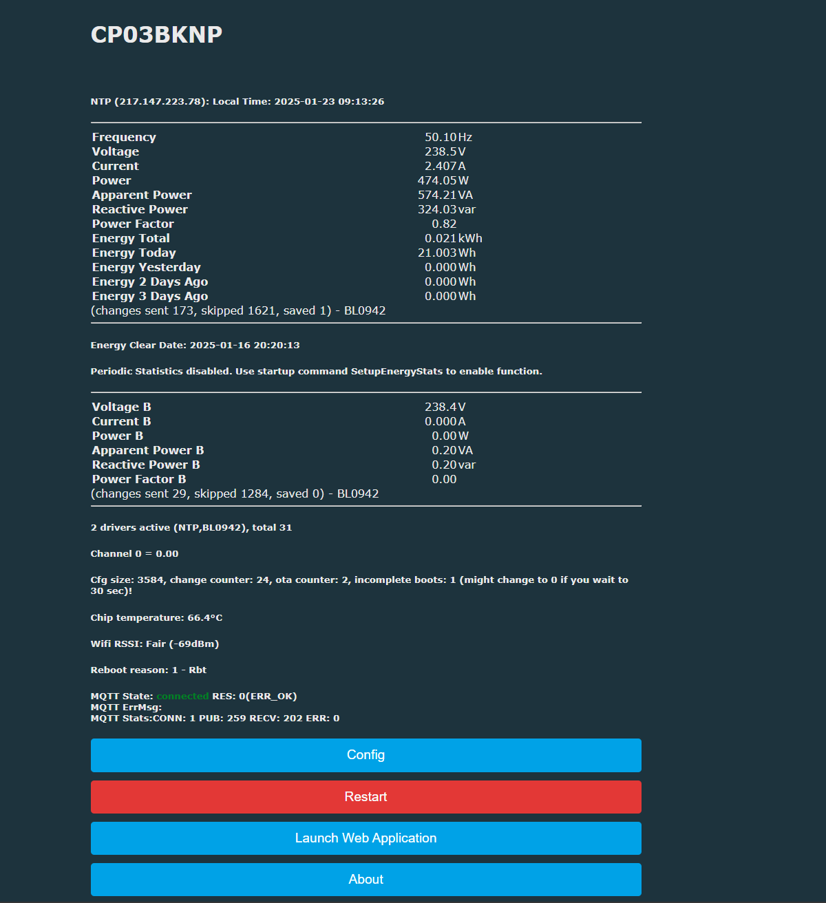

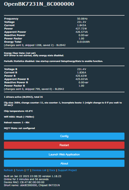

    And screens from test device and HASS using this FW :
    Screenshot of CP03BKNP device interface displaying electrical energy data.
    User interface panel of software for BK7231N device with power measurement data and diagnostic information.

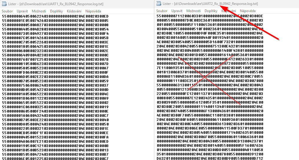

  • Flags and autoexec settings restored BL0942 data

    And now I've got data :D

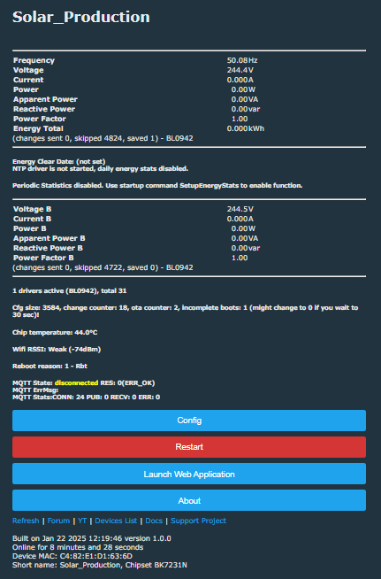

    Solar_Production user interface showing frequency, voltage, and power data.
    I was about to ask if some of those settings were persistent. Sounds like the answer is yes

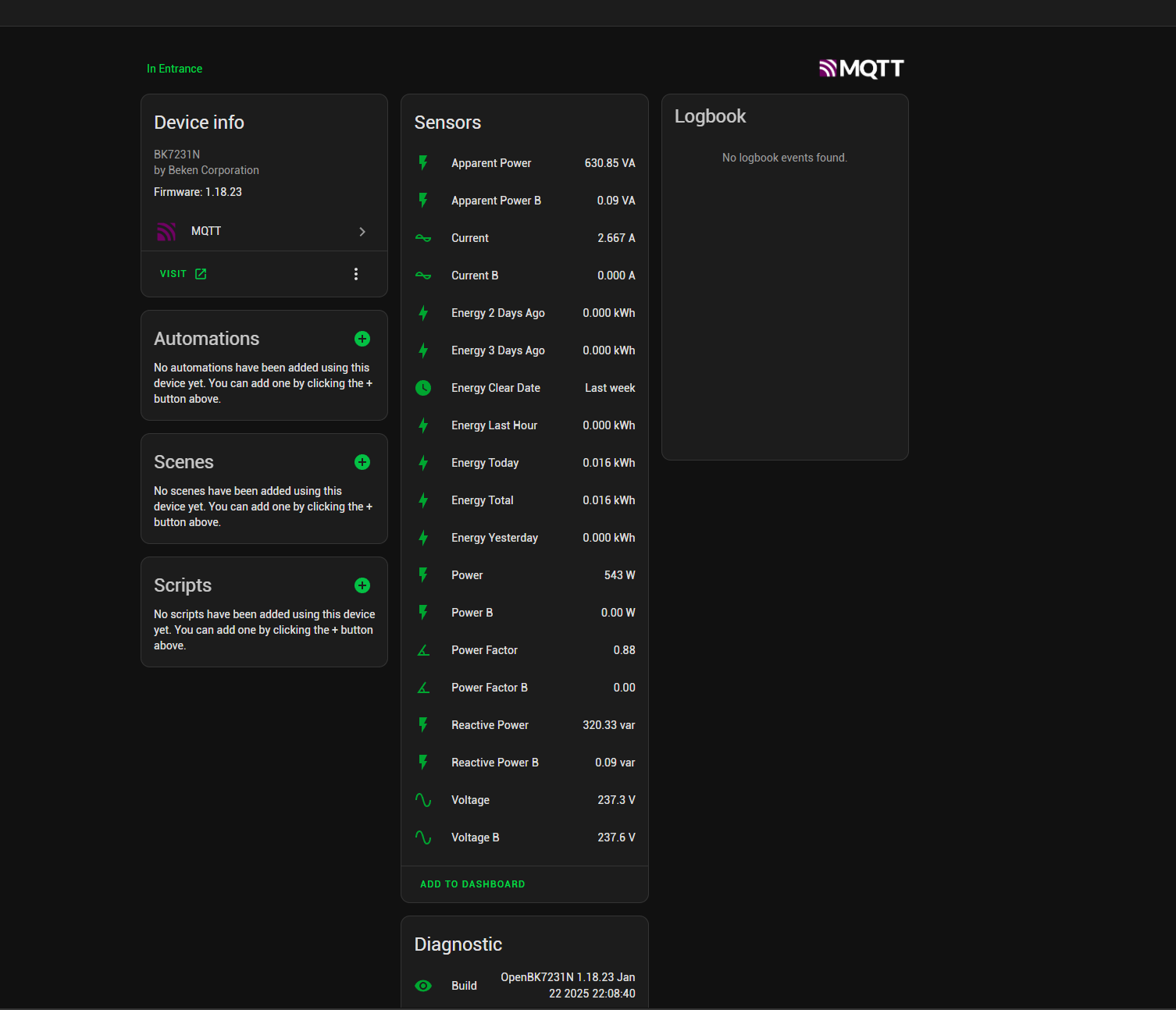

    Screenshot of the BK7231N device info panel in Home Assistant.

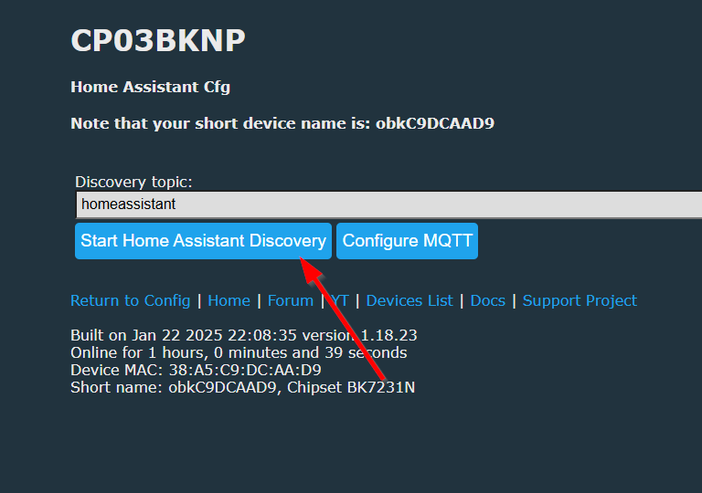

    If it fails, is there a way to configure MQTT/homeassistant manually?
    HASS discovery must work even in normal firmware (Channel A).
    I just added channel B (base, without power) to HASS discovery.
    To maintain backward compatibility, channel A is the main one, and energy is calculated from it (A only). Channel B is therefore not included in the energy and only show voltage, current and power.
    To start HASS discovery, you must use the button on the website in the config
    Device configuration interface with buttons to start Home Assistant discovery and configure MQTT.

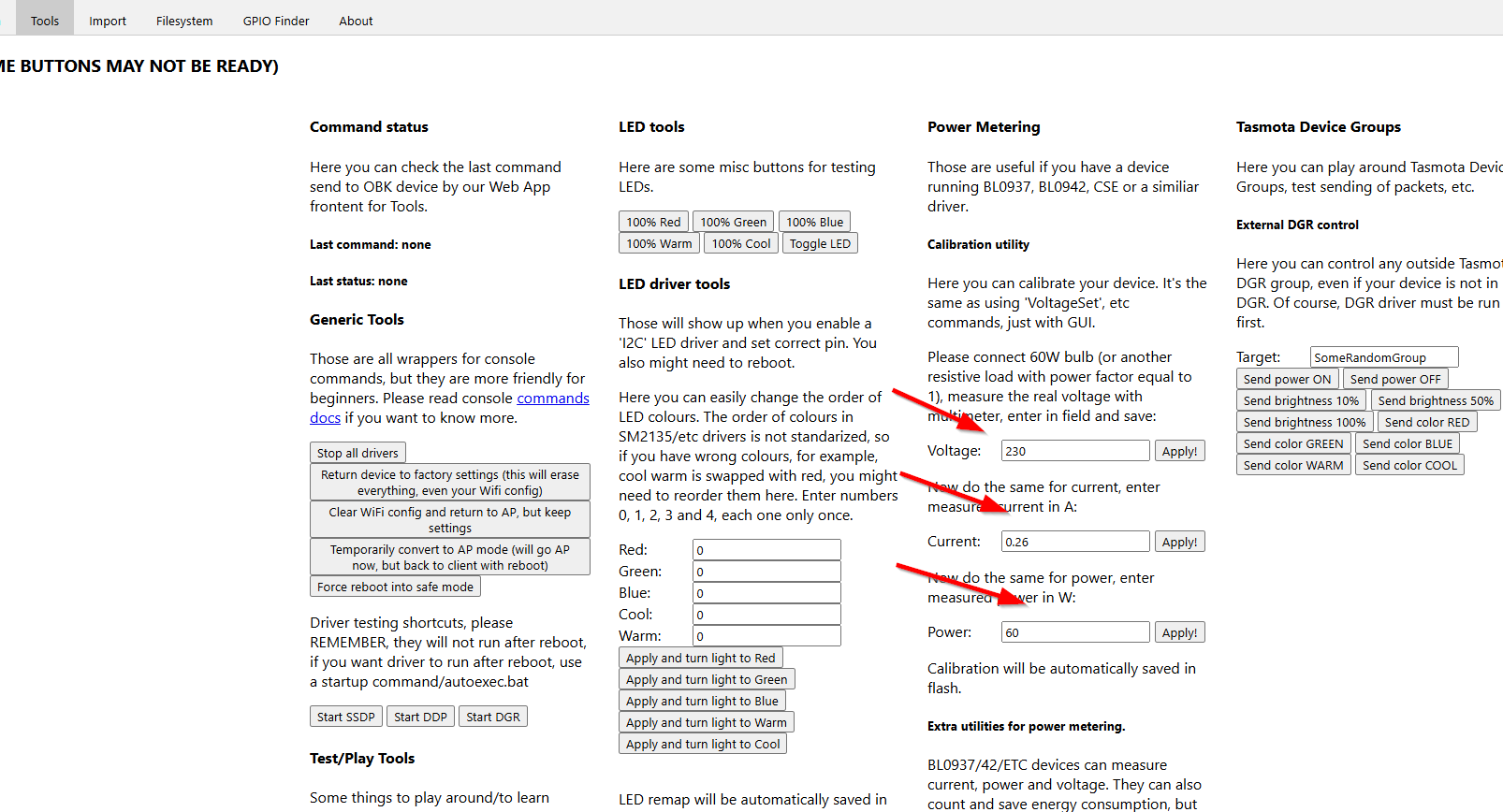

    Added after 4 [minutes]:
    randomalias324 wrote:
    We're now about to find out how calibrating goes
    Screenshot of a device configuration panel with tabs and tools for LED drivers and power metering.

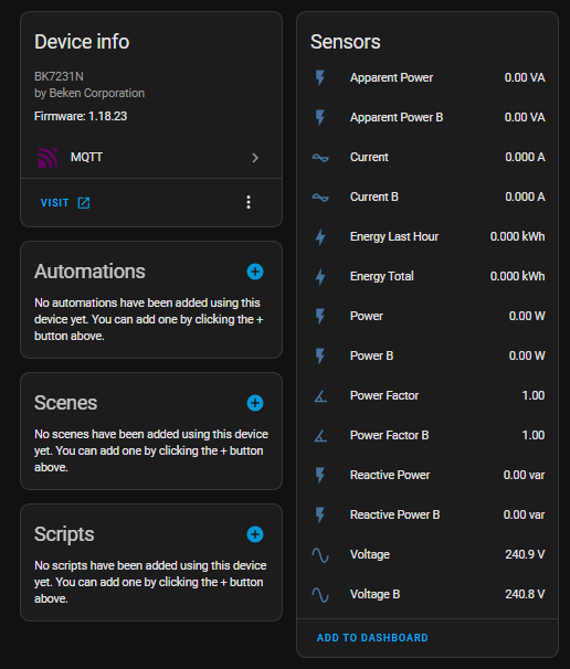

  • Current and power stuck at zero on both channels
    #70 21405999
    randomalias324
    Posts: 46

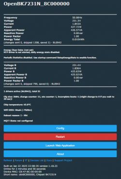

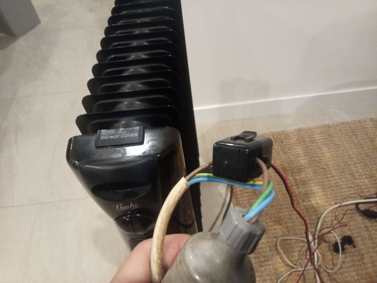

    Something is wrong.
    Voltage and frequency are showing plausible values, but current and power remain at 0.00 on both channels.
    I have the loops set up on a heater.
    Electric heater with visible wires and a connector.
    On previous software versions we were getting only one channel, and wildly incorrect values, but at least it showed something.
    Trying a few configs to try and find the cause
    I have the loops setup on a heater.
    First, I would recommend you try a simple classic light bulb (NOT LED)
  • Erasing chip and reflashing fixed BL0942 readings
    #72 21406045
    randomalias324
    Posts: 46
    >>21406040
    It's not reading anything. With anything plugged into it
    Added after 1 [hours] 29 [minutes]:

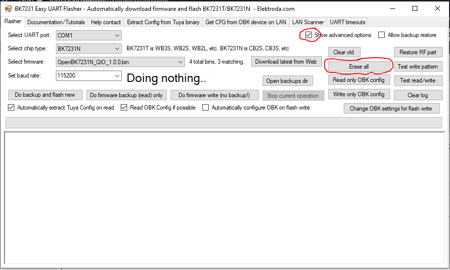

    OK fixed it.
    Soldered on the FTDI UART board again and erased the whole chip with the flashing tool
    Screenshot of the BK7231 Easy UART Flasher tool for firmware flashing.
    Then I flashed official OpenBK. Setup WiFi, resoldered the UART track and booted with the normal BL0942 driver.
    Calibrated the unit on one channel using the heater, a halogen flood light and a couple of calibrated power meters. Because its using those clamps, it was quite off.
    Flashed the modified firmware, added BL0942opts 3 to autoexec.bat and its now running.
    Screenshot of OpenBK7231N user interface displaying energy measurement data and configuration buttons.
    I think repeatedly flashing and setting flags did something

  • clearIO in autoexec restores both sensors on reset
    #74 21407161
    randomalias324
    Posts: 46

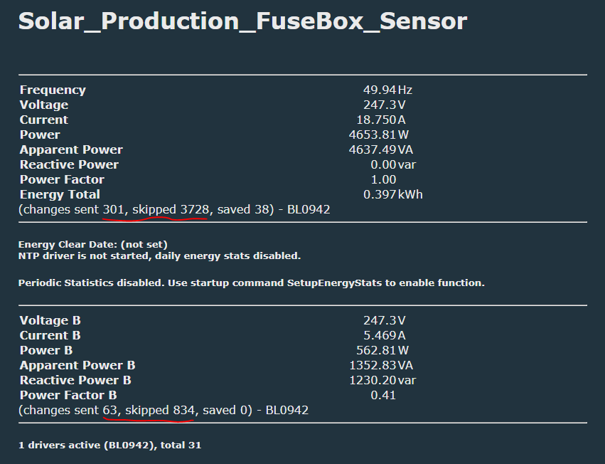

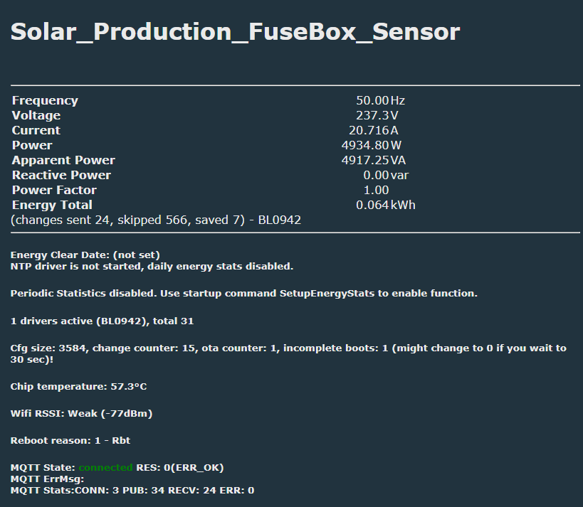

    OK. The sensor seems to frequently stop logging, and upon restart often does not find both sensors.
    Screenshot of Solar_Production_FuseBox_Sensor data showing voltage, current, power, apparent power, and other technical statistics.
    User interface displaying Solar_Production_FuseBox sensor data.
    Added after 25 [minutes]:
    Editing autoexec.bat file with configuration commands.
    Adding clearIO to autoexec might have fixed it? It was a fairly random thing to try, but it got both sensors back on reset
    Logging often stops on ch2. I think logging spam is still being output on UART2, as shown in my UART logs. Some of it must be hardcoded
    Added after 17 [minutes]:
    Yep, can't achieve consistent logging on Ch B.
    Screenshot showing data from the Solar_Production_FuseBox_Sensor, displaying various electrical values.
    With this autoexec
    Screenshot of the edited autoexec.bat file with configuration code.
    Setting logport to an invalid UART port doesn't seem to change anything

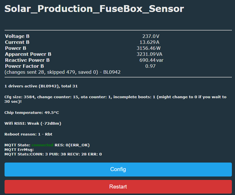

    Oh, I meant reading values from the BL0942. I can't get consistent 'logging', by that I meant reading of values, of the ChB BL0942 chip; Data from the BL0942 doesn't seem like its being read properly.
    When sniffing the UART lines I can see the regular polling coming out of the beken chip and the response of the BL0942. But on the OBK web page ChB doesn't seem to be updating regularly. I can see the Ch A values changing and the sent/skipped counters incrementing. But Ch B signals update sporadically and often stop. The sent/skipped counters start lagging, maybe averaging 1/3rd of the 'normal' channels
    After a while, Ch A started dropping out completely. Only ChB was being displayed on the OBK web page, and nothing for ChA was being sent over MQTT. Following another couple of restarts, ChB dropped out as well. ClearIO was in the autoexec, so clearly (no pun) it isn't fixing the issue

    there is some problem with your bl0942 on uart2, here are the logs of what you sent divided into packets /BL0942 has a packet length of 23 bytes)
    UART1 is OK, UART2 is crap
    Two UART logs showing transmission issues with BL0942.
    • bl0942logsplitted.zip (3.46 KB) You must be logged in to download this attachment.

    >>21407663
    Good find! I wonder what is causing that. Seems like it gets 2 more bytes per message on average. Noise maybe? Could that cause a byte of zeros to be read? My particular device could be junk
    Funny thing is, more often than not UART 2 was the one actually reading 🤷‍♂️
  • Possible hardware issue causing extra bytes
    Normally it should work even with the zeros. But that's why it shows "Consumed %i unwanted..." in the log
    The question is whether there really is a problem with the HW. I probably can't help you with that anymore, sorry.

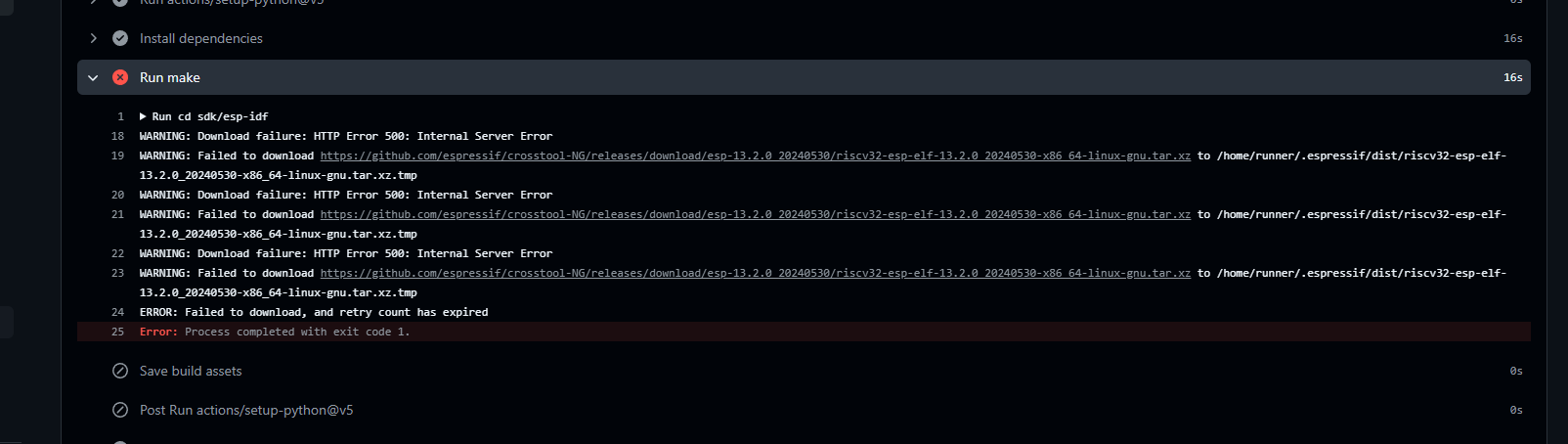

  • #90 21422204
    XJ_
    Posts: 141
    Help: 13
    Rate: 39
    >>21411897
    @p.kaczmarek2 uartbuf mod still ok with the 1.18.33
    some checks failed due to download errorr
    Screenshot of a build process with download errors and process completion with exit code 1.
    I've triggered rerun checks and now it's fine
