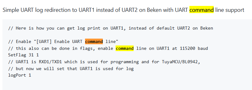

    Ok I just hope it won't break anything as I didn't manage to do full checks, especially:
    Code snippet showing UART log redirection to UART1 instead of UART2 on Beken with UART command line support.

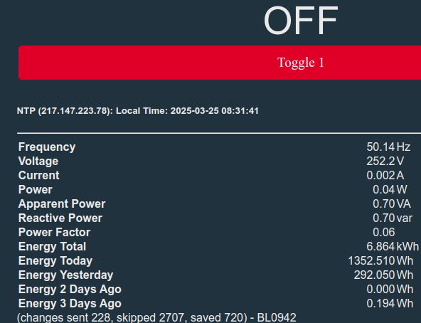

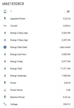

    Posts: 5213
    Help: 446
    Rate: 914

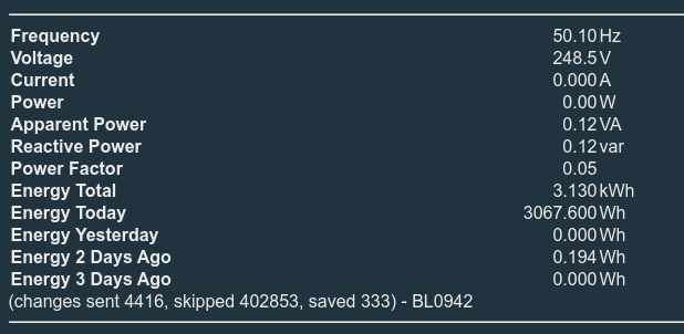

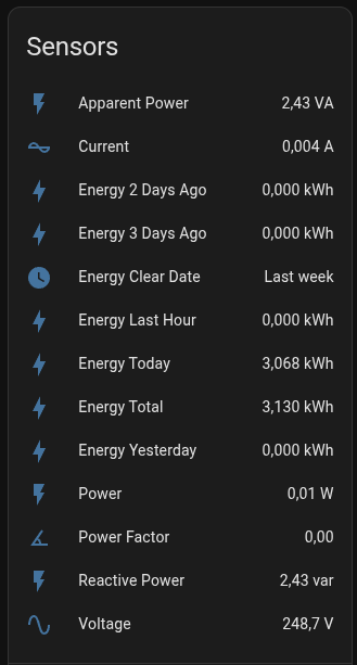

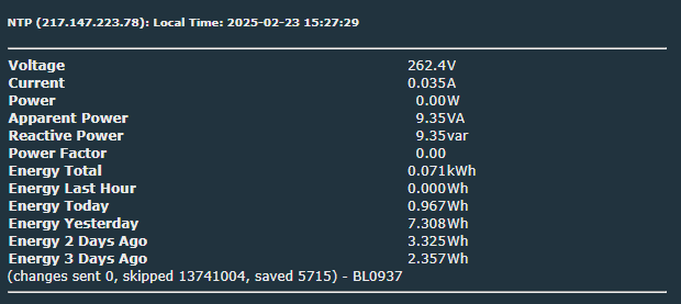

    @divadiow do you have BL0942 device or BL0937 device to double-check if OBK behaviour is still the same after this PR?
    on the face of it, seems OK for BL0937..
    1.18.23
    Screenshot of electrical parameter measurements.
    1531_merge_964b96547bd1
    Screenshot of electrical energy consumption data.
    Screenshot showing data on electrical energy consumption and electrical parameters.
    HA OK before and after
    Added after 15 [minutes]:
    do these code changes only affect BK7231N? I have this for T/BL0942... https://www.elektroda.com/rtvforum/topic4101872.html

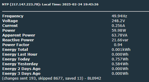

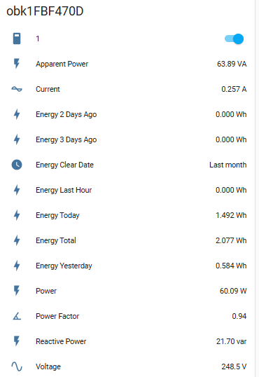

    Posts: 5213
    Help: 446
    Rate: 914

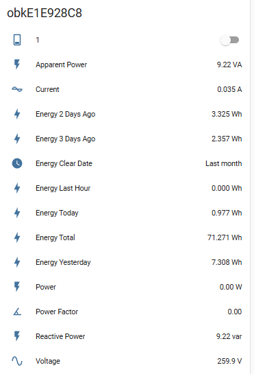

    BK7231T / BL0942
    1.18.45
    Screenshot displaying electrical parameters such as frequency, voltage, and energy consumption. Screenshot showing energy data of a device.
    merge_a25ae12c60c3
    Screenshot displaying electrical parameters such as frequency, voltage, and energy consumption. Screenshot showing electrical energy consumption data.

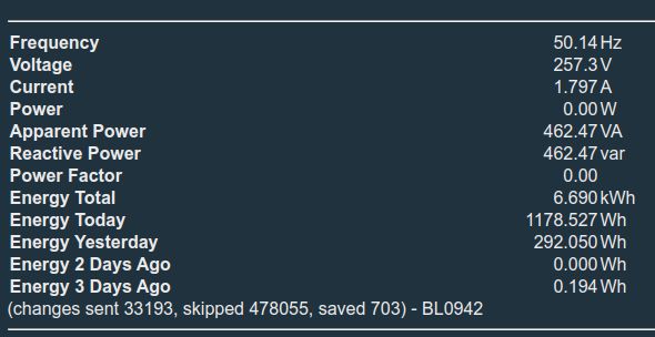

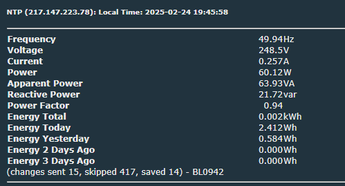

    maxim2002
    Posts: 46
    Rate: 12
    Thanks for great driver guys!

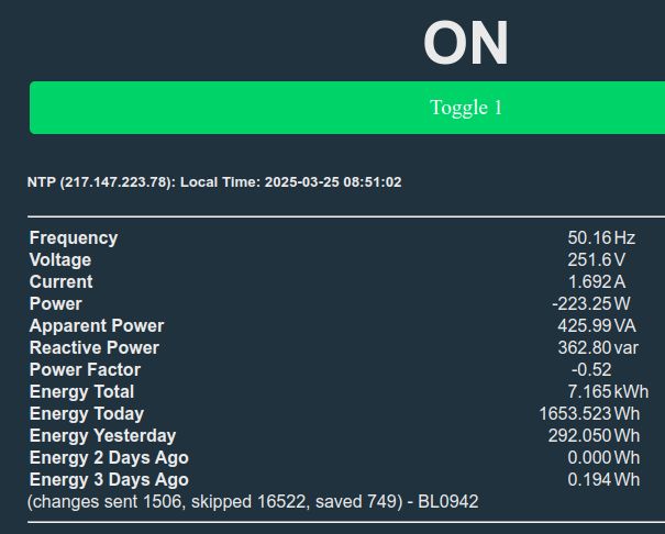

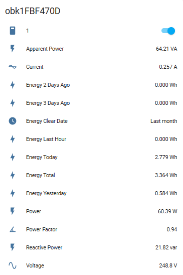

    Got it working on "Built on Mar 6 2025 20:10:04 version 1.18.56" with TONGOU TO-Q-SY1-JWT.
    Setup was super easy.
    Everything worked out of the box.
    Just a feature request: Can we also have frequency published to mqtt.
    Screenshot with data on electricity consumption.
    Screenshot of energy sensor data.
    Many thanks.

    #118 21494249
    maxim2002
    Posts: 46
    Rate: 12
    Did some testing. Any clues why I'm getting 0 at power even if others are not indicating that?
    I'm on version twinblenergy_1b511cda2cfb. Didn't calibrate it yet.
    Screenshot of electrical energy data.
    Added after 16 [minutes]:
    Oddly but if toggled Off it shows some residual Power.
    It's same on official release "Built on Mar 23 2025 08:26:16 version 1.18.65".
    Did I mess around something with cables?
    Screen displaying electric energy consumption data with numerical values for frequency, voltage, current, and energy.
    Added after 22 [minutes]:
    Enabling "Flag 25 - [POWER] Allow negative current/power for power measurement (all chips, BL0937, BL0942, etc)" resolves issue, but power is negative.
    Pretty sure I've connected it as indicated on case. Shunt molex is other way around inside the case ?
    Screen displaying electrical energy consumption data with various values.
    "Flag 48 - [PWR] Invert AC dir" has no effect.
  • #119 21500108
    XJ_
    Posts: 141
    Help: 13
    Rate: 39
    >>21494249
    Try to change the polarity of the clamp
    Added after 9 [minutes]:
    Change the polarity of clamp red<>black, calibrate it and try again.
    Added after 6 [minutes]:
    @p.kaczmarek2
    I didn't find any place in the code where this flag (OBK_FLAG_POWER_INVERT_AC) is used.
