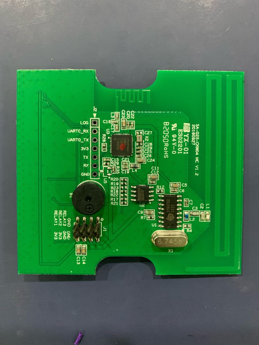

    Openbeken for CKW04 chip?
    I’ve recently replaced the pcb with esp for this switch
    https://www.reddit.com/r/esp8266/comments/gzh...ying_light_switches_from_aliexpress_ckw04_to/
    But I was wondering if there was any work done to add openbeken support if possible?
    Woolley Smart Touch Switch WiFi Push Button Light Switch No Neutral Wire Required RF Remote Control Smart Home Automation Module
    https://a.aliexpress.com/_mOjBhGi
    https://github.com/CoolKit-Technologies/DevDo...%BA%94%E7%94%A8%E6%8C%87%E5%AF%BC%E4%B9%A6.md
    PCB with ESP chipset and pin labels. CKW04 circuit board with electronic components.

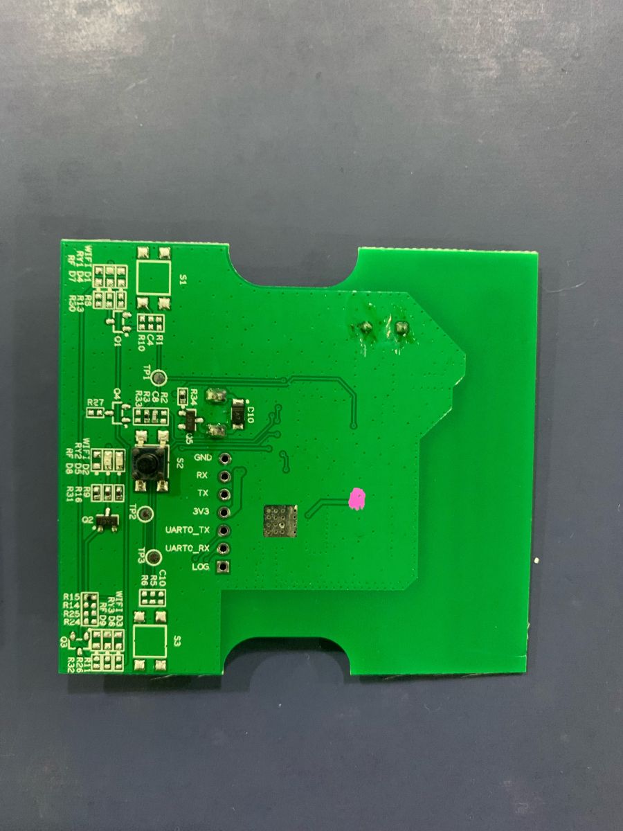

    I tried getting the logs from rx/tx/uart0_tx/uart0_rx pins but nothing with 115200 baudrate.
    Maybe different baudrate?
    There's a LOG pad there but I'm not sure how to connect it to the uart
  • #4 21301206
    Posts: 5106
    Help: 441
    Rate: 902
    I think I'd start by trying both of these to see which gives any output then try different bauds depending on how legible any of it is.
    Close-up of a circuit board with labeled UART pins and connectors.
    Added after 5 [minutes]:
    unless of course it's like some other devices where the RXs are to where they're to go TO not where they're FROM, in which case I'd try all 4 UARTs

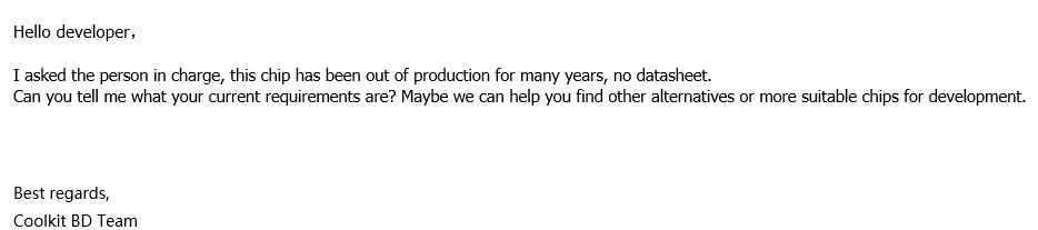

  • #9 21302706
    Posts: 5106
    Help: 441
    Rate: 902
    Screenshot of an email message regarding an obsolete chip.
  • #10 21302831
    Posts: 14664
    Help: 656
    Rate: 12679
    That's not good news, but still, a bootlog could give us some more basic information. Maybe this chip is like T34 and is compatible with some "other" platform?

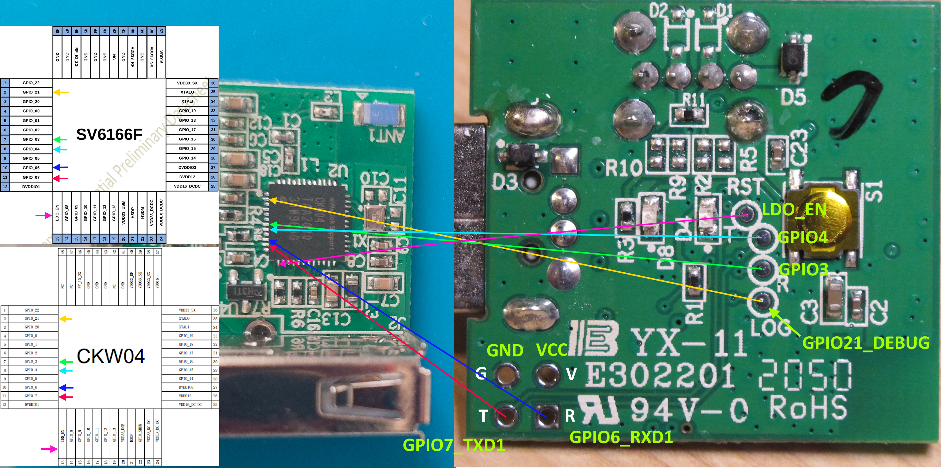

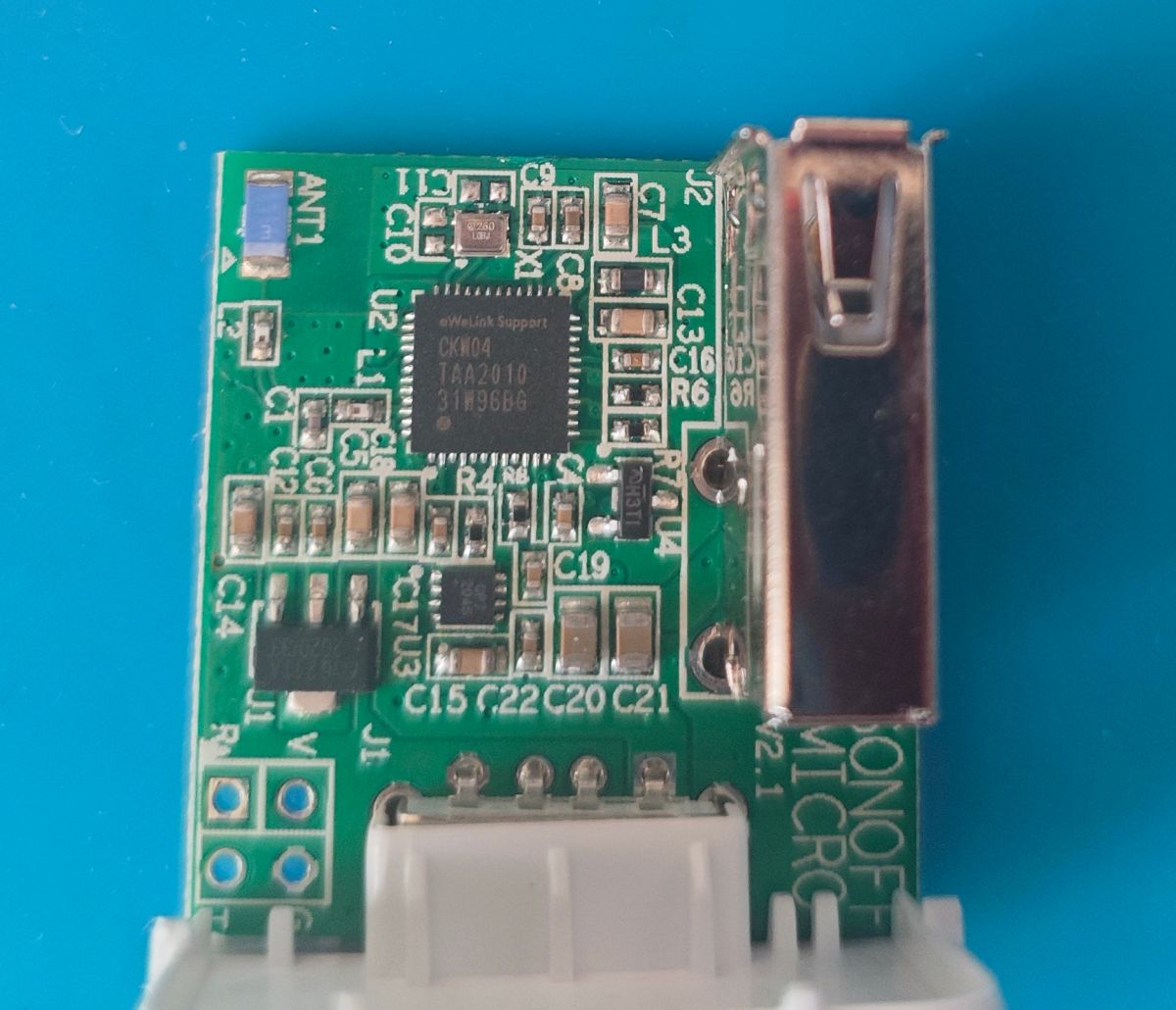

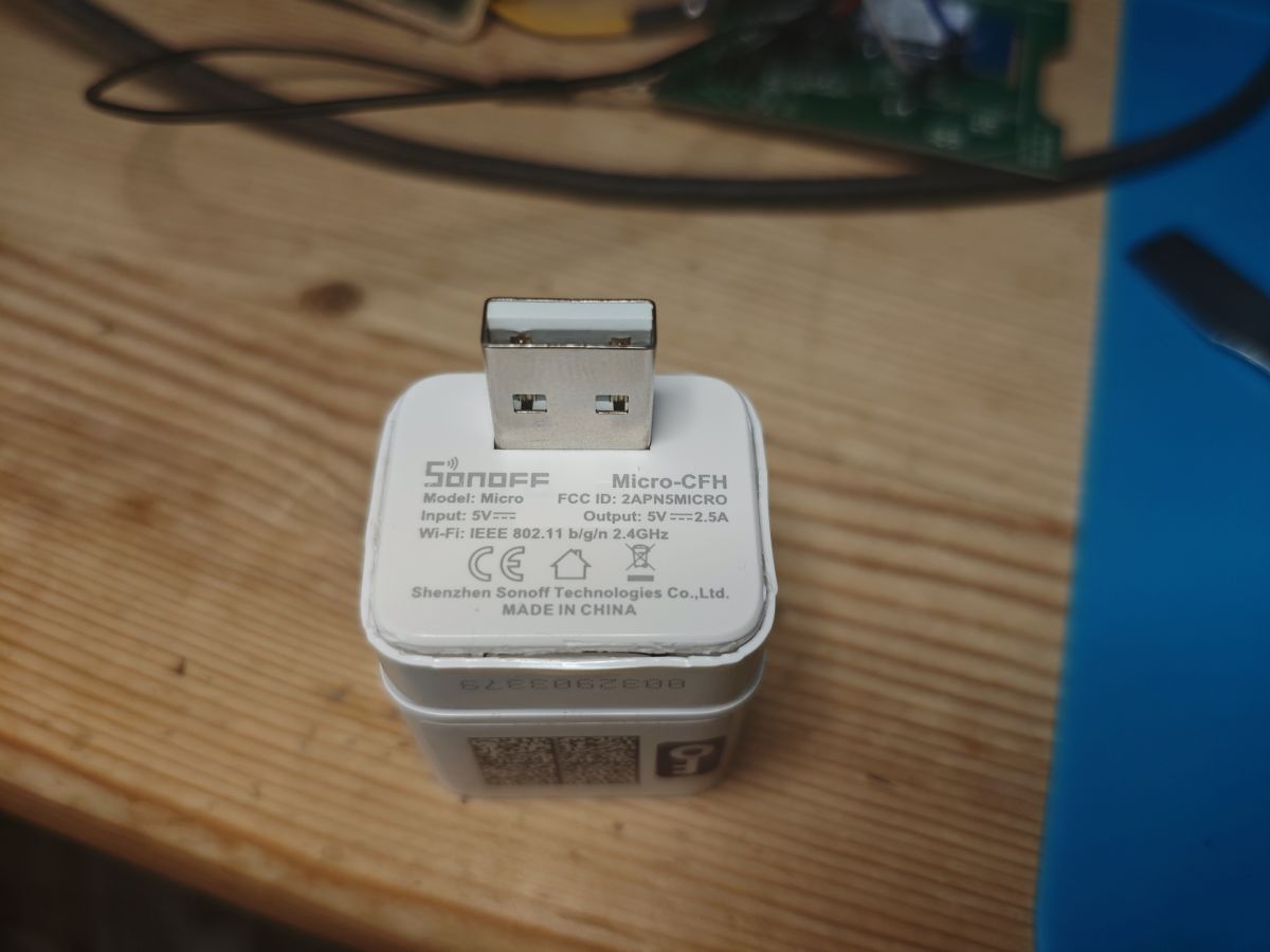

    I've found nothing else, but for the hell of it I ordered a Sonoff Micro-CFH and they do still come with a CKW04 chip
    Sonoff Micro-CFH USB adapter Close-up of a circuit board featuring a chip labeled CKW04.
    LOG:
    Added after 16 [minutes]:
    quite a few of those "ffs..." strings get results in Github. eg:
    https://github.com/search?q=ffsInitializeConfigurationMapEntryStream&type=code
    https://github.com/search?q=ffsInitializeUserContext&type=code
    Maybe it's a MicrochipTech chip at heart.
    Added after 31 [minutes]:
    divadiow wrote:
    Icomm-Semi use start_sniffer_mode
    oh maybe it is Icomm Semi - https://www.cnx-software.com/2019/12/12/icomm...-andes-risc-soc-for-iot-and-embedded-systems/

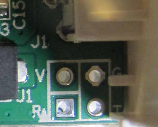

    Added after 1 [hours] 45 [minutes]:

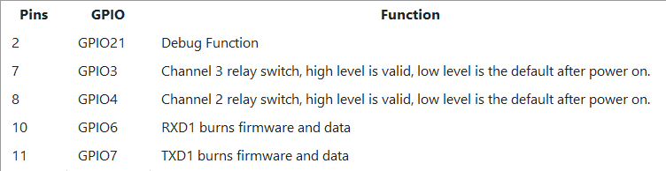

    Assuming it's an Icomm Semi SV6166F, here's where the pads on the Sonoff trace to. CKW04 and SV6166F and the function of pads appear to line up.
    Diagram of SV6166F chip and comparison with Sonoff board.
    and from the CKW info pages for those traced:
    Table showing GPIO pins and their functions.
    These 4 test holes are clearly for programming
    Close-up of a circuit board with four test holes labeled as V, R, C, and T.
    The only thing I'm not sure about is why GPIOs 3 and 4 need test pads.

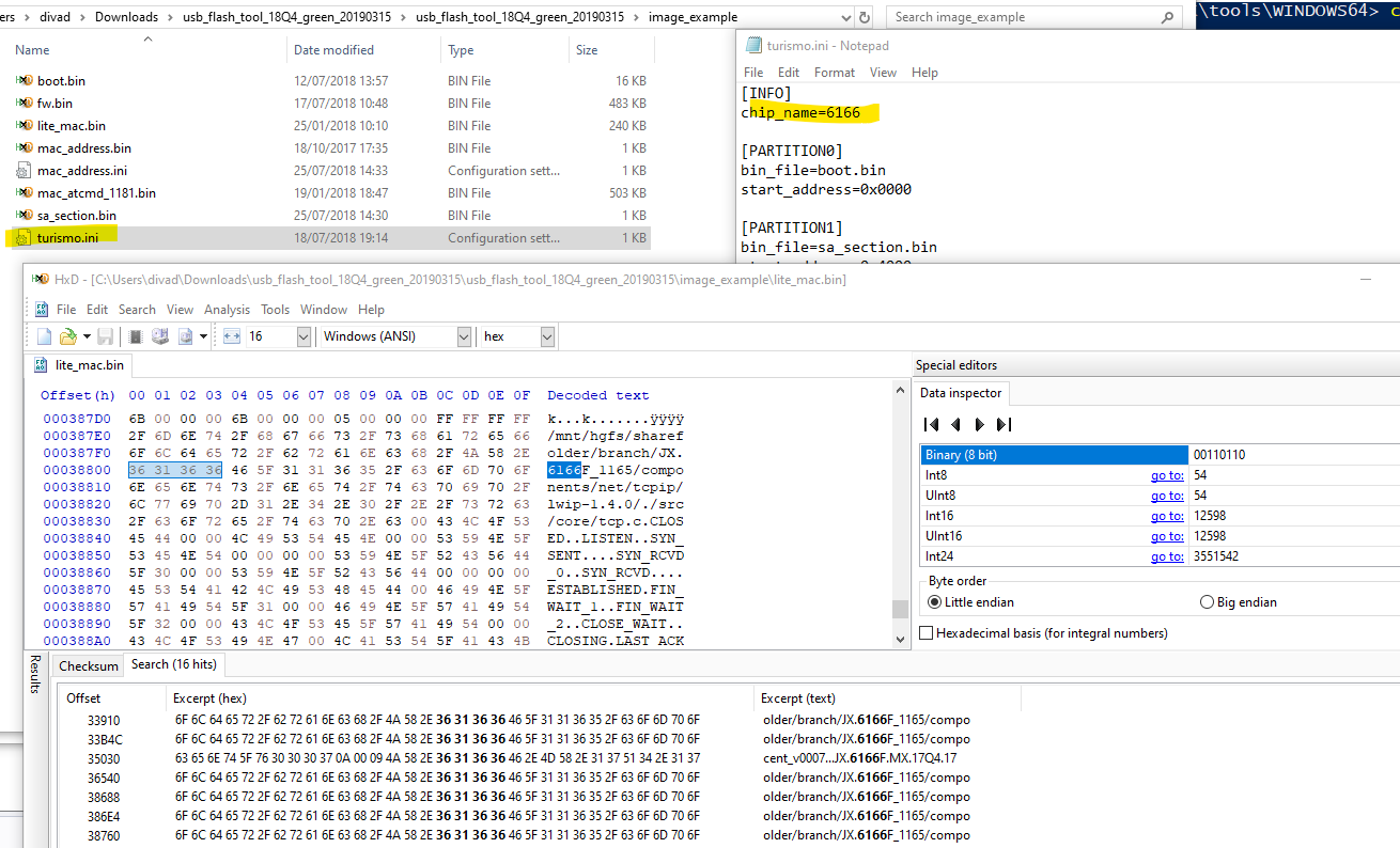

  • #18 21478212
    insmod
    Posts: 1409
    Help: 164
    Rate: 443

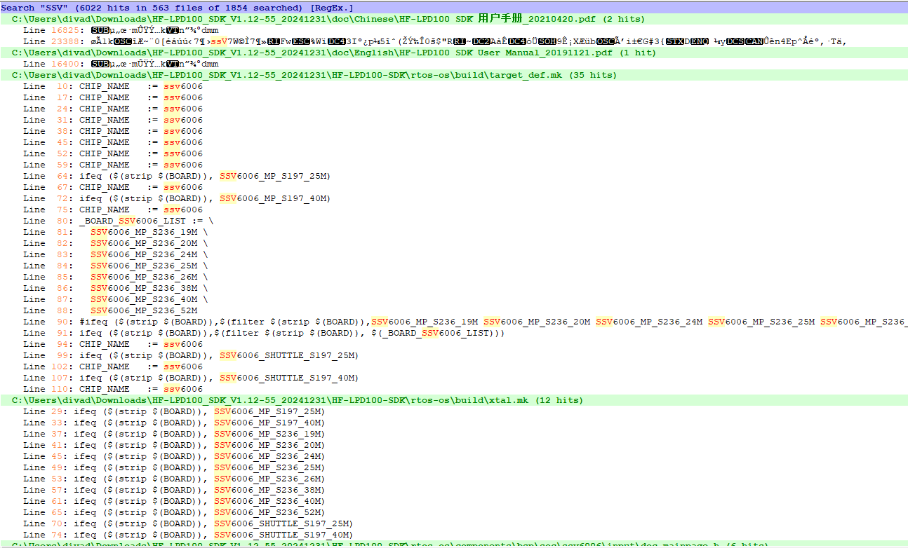

    >>21312234 A partial sdk can be found for ssv6006 target on hi-flying ftp you posted earlier.
    Download LPD100 and look inside, perhaps it contains something for 6166.
    target_def.mk mentions ANDES_N10 arch, same as in 6166.
  • #19 21478292
    Posts: 5106
    Help: 441
    Rate: 902

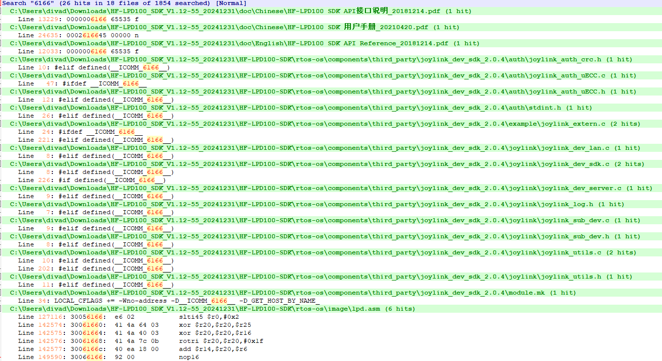

    plenty of 6006, like you say
    Screenshot showing search results of text in files with highlighted found fragments.
    and actually some 6166 and ICOMM, presumably the ICOMM Semi mentioned months ago
    Screenshot of code search results in SDK files.
    interesting

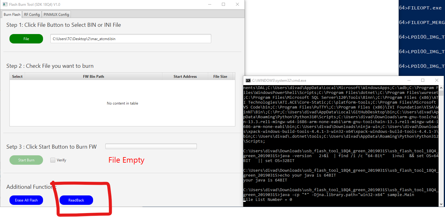

    Screenshot showing the Flash Burn Tool with a BIN file open.

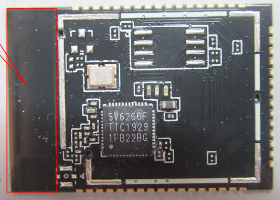

    HF-LPD100 = SV6266F
    Electronic module with visible SV6266F chip

    >>21478292 From what i understood the only difference between them is that 6266 supports 5ghz wifi.
    Did you try to take a backup yet?
    #21 21478393
    Posts: 5106
    Help: 441
    Rate: 902
    not yet. will try shortly.
    Added after 52 [minutes]:

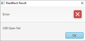

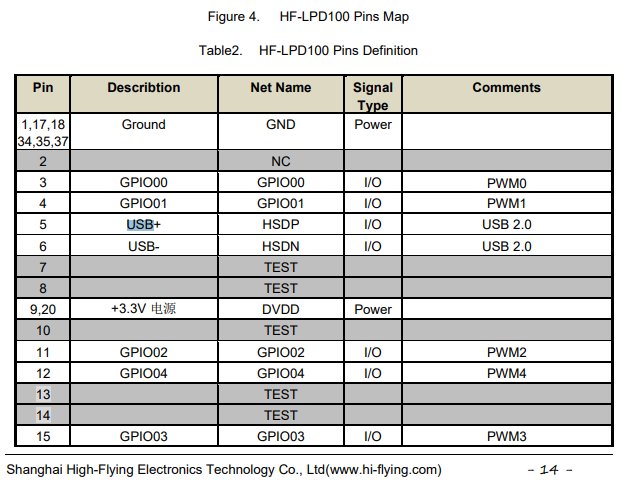

    hmm. I think this tool might be actual USB programming? there's no mention of UART and:
    Dialog window with error message USB Open Fail.
    and there is USB interface
    Table showing HF-LPD100 pin definition with various signals and comments.

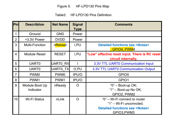

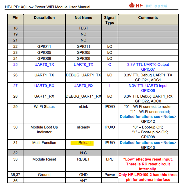

    seems GPIO13 - nReset - needs to be low on reset for download mode
    Pin table of HF-LPD1X0 WiFi module with signal descriptions.
    or maybe GPIO4?
    Table of HF-LPD130 pin definitions with descriptions and comments.
    3 and 4 seems exposed on Sonoff, not 13. pulling 3 and 4 low doesn't seem to do anything but boot device normally

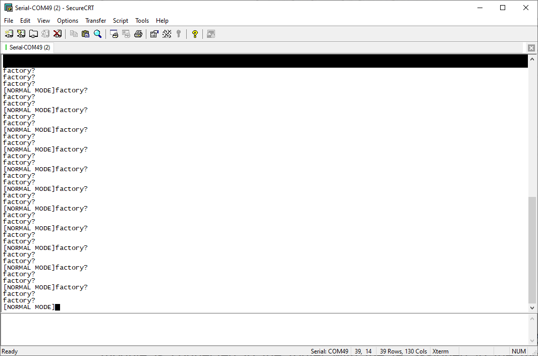

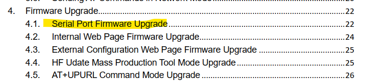

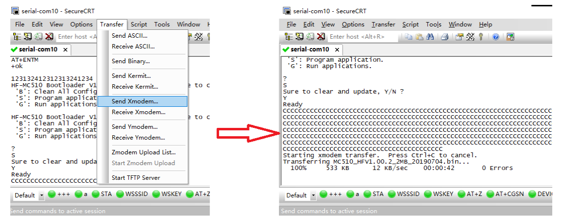

    this is the serial port method for HF-LPD1x0
    Fragment of a document's table of contents related to firmware upgrades, with the serial port upgrade option highlighted. Screenshots of SecureCRT showing file transfer using the Xmodem protocol.
    requiring the use of SecureCRT to do xmodem stuff. Don't know if the method to achieve this relies on HF-specific bootloader abilities, in which case it'd be no good for the CKW04 I guess.
    • High Flying Wi-Fi Module Operation Guide_20200814.zip (8.43 MB) You must be logged in to download this attachment.
  • #24 21479961
    Posts: 5106
    Help: 441
    Rate: 902
    Screenshot of SecureCRT program showing serial console output.
    on every boot from TXD1/GPIO7 @9600 baud

    I've actually seen HSDP and HSDM, which suggests D+ and D- in a related topic:
    https://www.elektroda.com/rtvforum/topic4117636.html#21520720
    So it's an USB, after all?
    USB Type A connector with labeled pins: Ground, Data+, Data-, Power (5VDC).

How does CKW04 compare with Icomm-Semi SV6166F or SV6266F when checking OpenBeken compatibility?
CKW04 looked closer to the SV6166F or SV6266F family than to ESP parts. One participant matched Sonoff Micro-CFH test pads to CKW04 documentation and said CKW04 and suspected SV6166F pad functions lined up. Later posts also connected HF-LPD100 to SV6266F and noted both families in the same SDK and tooling trail. [#21478292]
What is XMODEM, and how is it used with bootloaders like the one seen on CKW04 or HF-LPD100 modules?
XMODEM is a serial file-transfer method used by some bootloaders for recovery uploads. "XMODEM" is a packet-based serial transfer protocol that sends firmware in small blocks with acknowledgments, making it useful for bootloader recovery when normal OTA images are missing or corrupted. In the thread, CKW04 asked to use XMODEM, and HF-LPD1x0 documentation referenced SecureCRT for that workflow. [#21479080]

How do I identify which test pads on a Sonoff Micro-CFH or CKW04 board are for programming, reset, TX, RX, or GPIO boot mode selection?
Trace each pad to known chip pins and compare them with published pad-function pages. In the thread, four Sonoff Micro-CFH test holes were called “clearly for programming,” and the mapped CKW04/SV6166F functions appeared to align. The uncertainty remained around why GPIO3 and GPIO4 also had test pads, so tracing alone may not reveal the exact boot strap. [#21311332]
