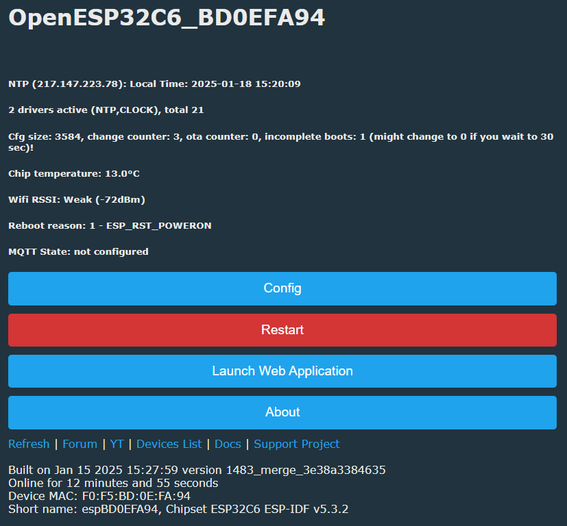

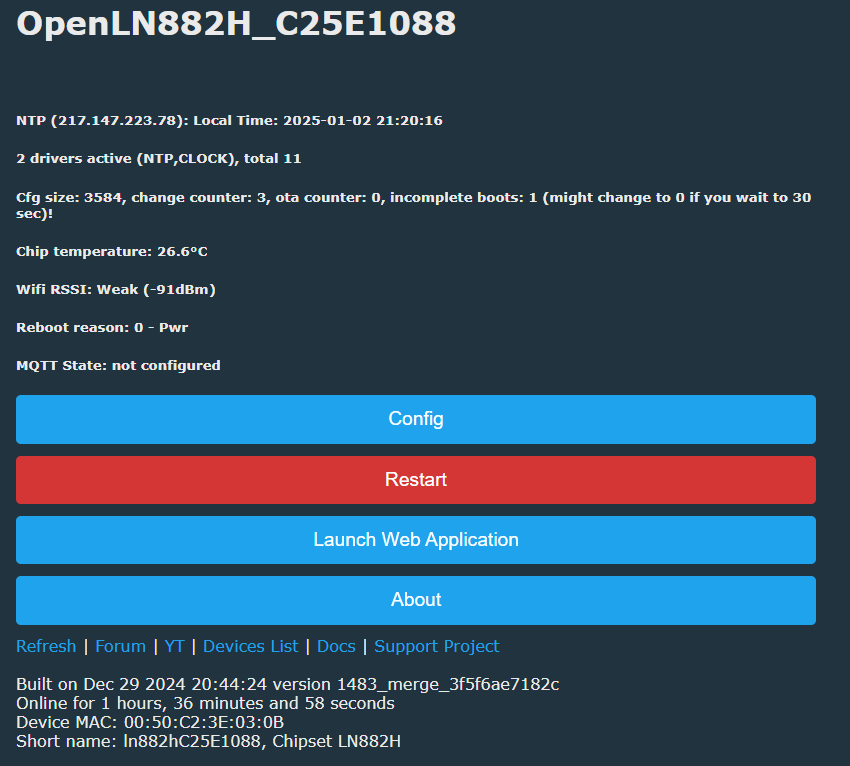

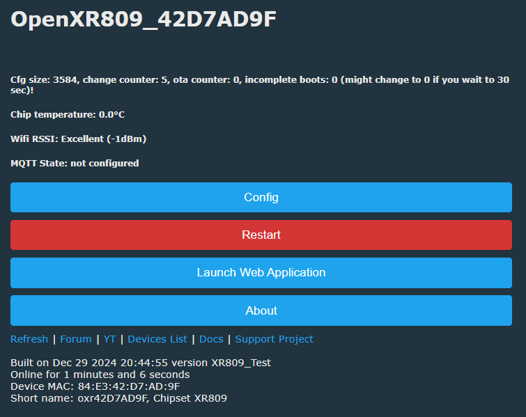

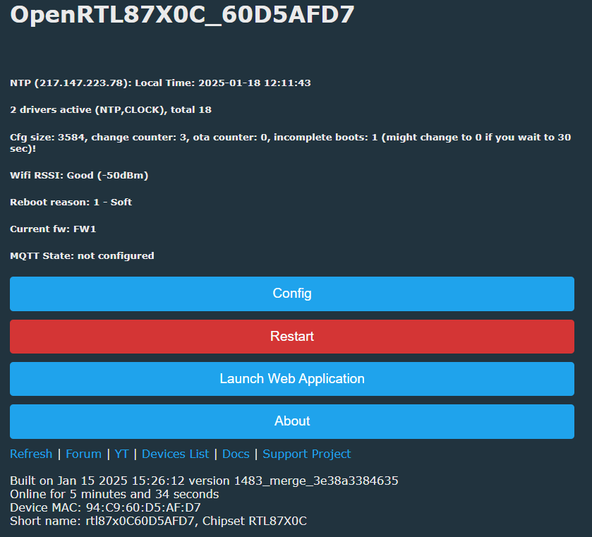

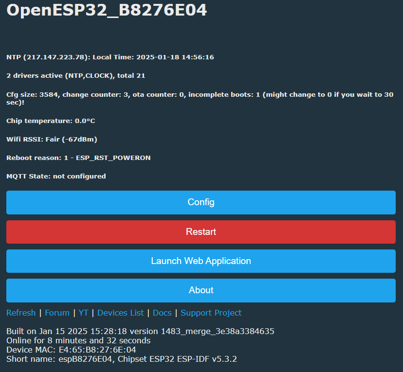

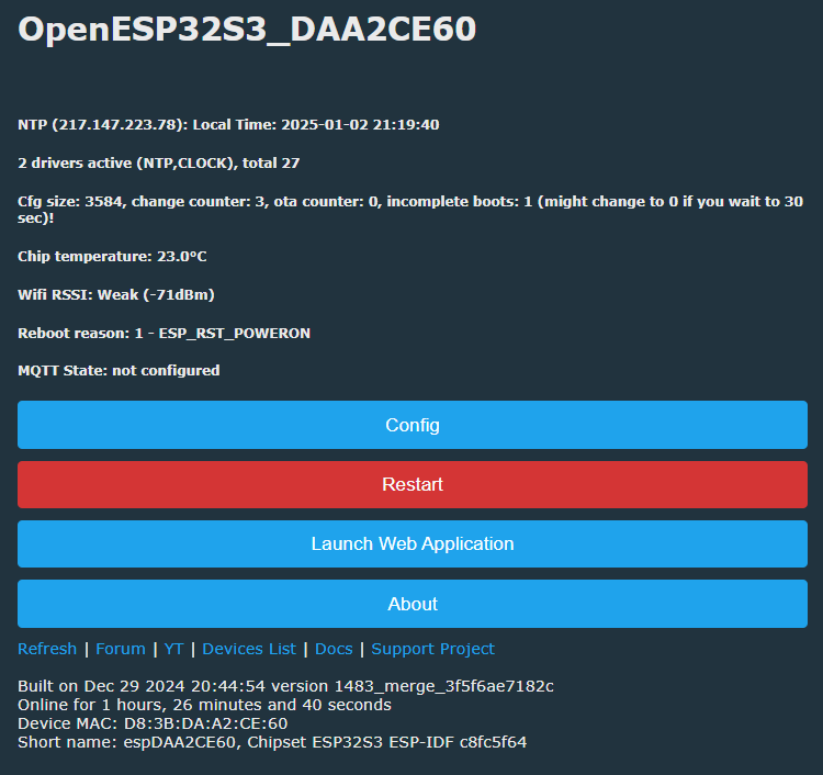

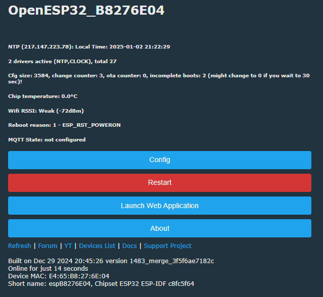

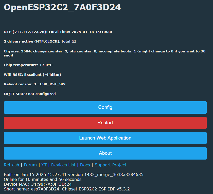

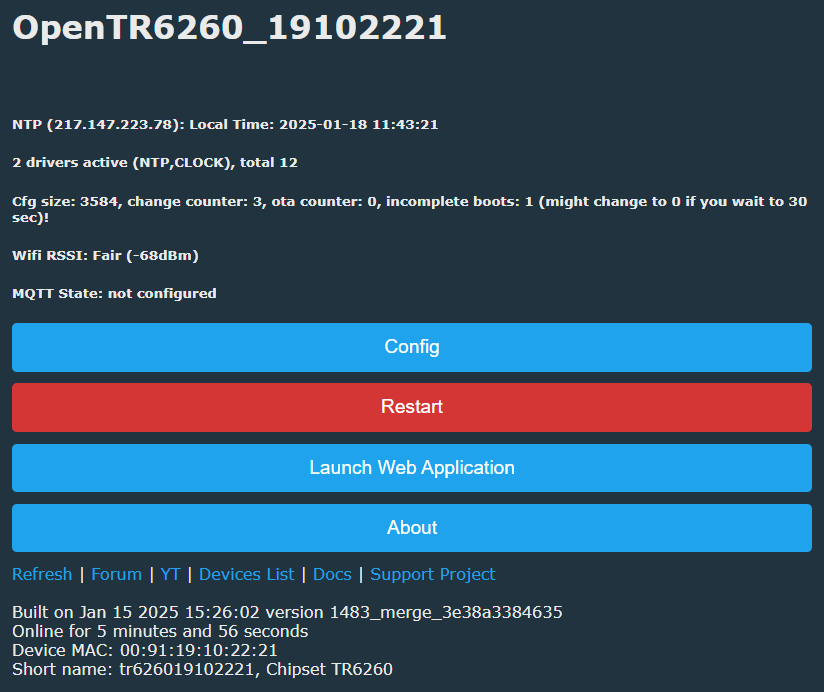

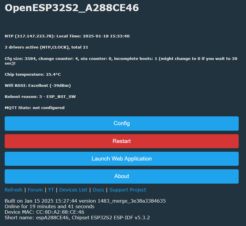

    Uptime counter updates only when page is foreground

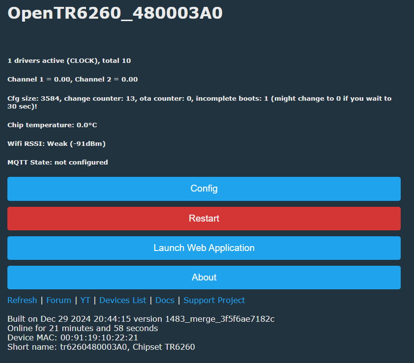

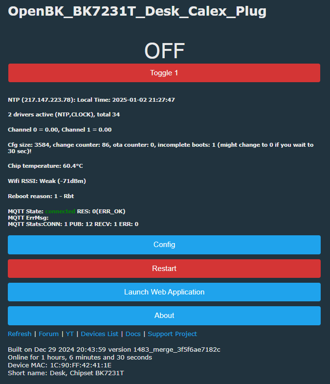

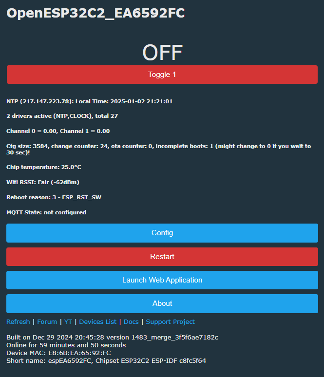

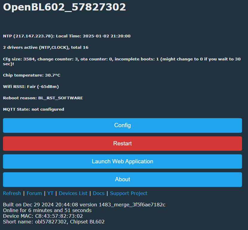

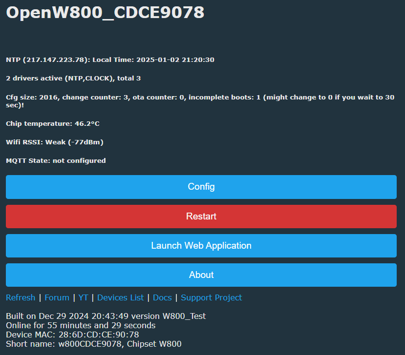

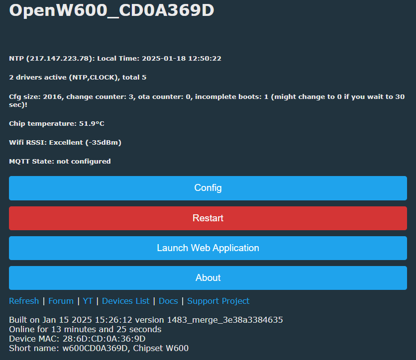

    #40 21374202
    Posts: 5212
    Help: 446
    Rate: 914

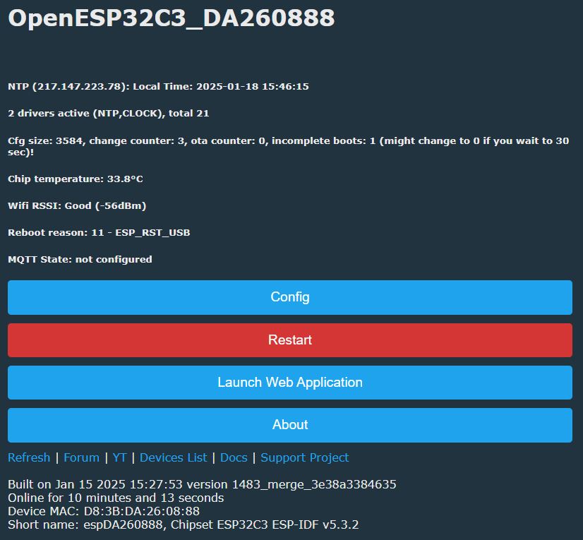

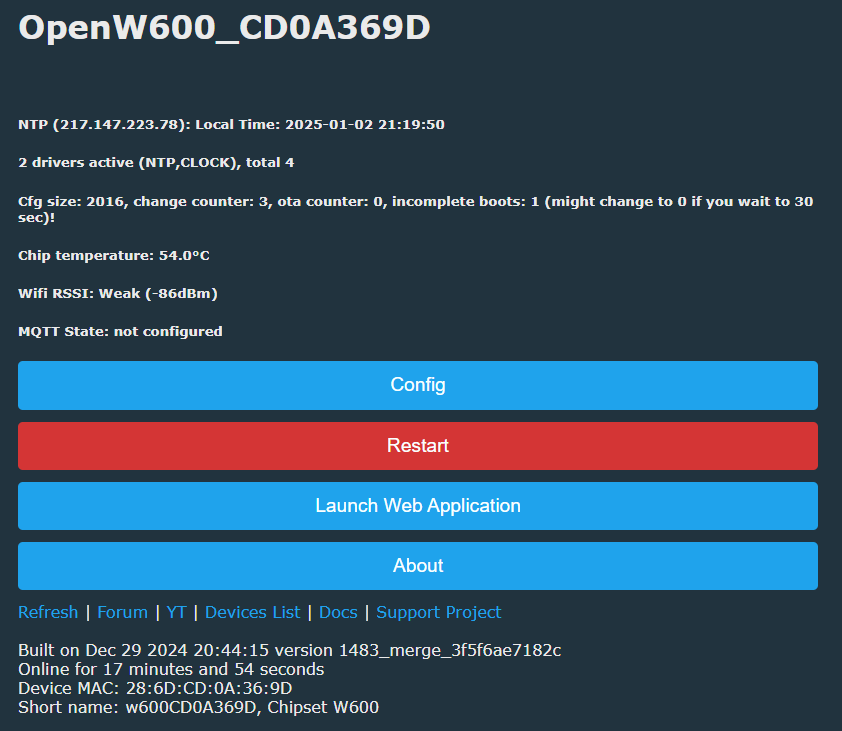

    OpenESP32S3 interface with system information. Screenshot of the OpenW600_CD0A369D device interface with system details. Device interface for OpenBL602 with status and configuration information. User interface of OpenLN882H_C25E1088 device showing system status information. Screenshot of the OpenW800 user interface showing connection and configuration details. Screenshot of the OpenBK7231N Fridge Tuya Plug user interface showing online status. Web interface screen of the OpenESP32C2 module. OpenTR6260 device control panel with configuration buttons and diagnostic information. User interface of OpenESP32 device showing system information and configuration options. XR809 device user interface with system information and configuration options.Screenshot of the OpenBK_BK7231T_Desk_Calex_Plug interface showing the OFF state and system details.
    so i guess it's a start. ntp starts on all but XR809 and TR6260 for which the driver doesn't seem to be enabled. clock not a thing for XR809
    I did notice in my refreshing though that some of them (I wasn't watching/noting methodically at the time) would jump up from xx minutes online to xx minutes online, quite the difference - quite the noticeable jump in some cases. I should restart each one and then see which are losing track.
    Added after 27 [minutes]:
    having said that, a subsequent refresh after a few minutes online has made them all jump up several minutes, but roughly the same amount each. I can't recall - is that a browser count thing and the refresh only gets the device current online time upon refresh?
    Added after 1 [hours] 1 [minutes]:
    oh. I think it's fine. I guess the up-time timer is only active when the page is foreground. The page refresh gets the up-time the device is reporting, which is what matters?

    Thanks for the tests, great!
    The uptime shown on the web page is counted by the browser and only updated to the devices uptime only on refresh of the page.
    I would expect this on the release versions, too.
    Good to hear it's working

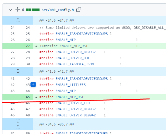

  • Timed events as an NTP-free workaround
    #43 21374542
    max4elektroda
    Posts: 758
    Help: 49
    Rate: 189
    There are two possible causes for this, maybe both are coming together here:
    1: The browsers timing is not too precise, so the numbers diverge over the time
    2: There is the fact, that the uptime is only a rough estimation. Maybe you recall my first tries with an internal clock which lead to the observation, that "g_secondsElapsed" was running out of sync about 2 minutes a day.
    https://www.elektroda.com/rtvforum/topic4046620.html
    So one of my goals is still to implement the idea from there, hence also improving the uptime measurement (the implementation used there came down to 1 - 2 seconds per day).

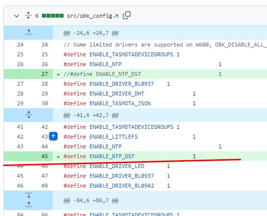

    Back to your question: If you really can afford some time, you could try some "timed events", especially "tricky" ones like do something every day at sunset
    I updated obk_config.h to allow these on all platforms (except TR, I maybe will try in the next commit, don't know about the memory etc there. And, most important, it doesn't use NTP at all)
    It's strange: PR doesn't rebuild the firmwares after this change?!?
    So please use them from here: https://github.com/MaxineMuster/OpenBK7231T_App/actions/runs/12595088390/job/35103694426

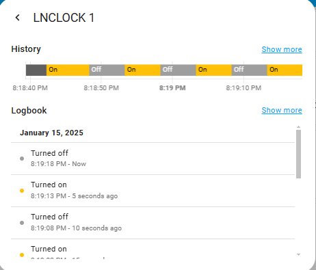

    I think I'm overthinking it. Of course HA can just track events!
    Screenshot of history and event log for device LNCLOCK 1, showing on and off cycles.

    Sorry for that, I think I used an old obk_config.h there.
    Code was updated in the meantime, should be present now in the latest code:
    https://github.com/openshwprojects/OpenBK7231...a9ba824b60270bbb1192b3fdd5ae/src/obk_config.h
    So if you could move to the latest firmwares, they are now built again also in the PR:
    https://github.com/openshwprojects/OpenBK7231T_App/actions/runs/12791520421
    Thanks for your support and sorry for the hassle

    NTP driver confirmed on TR6260, RTL87X0C, W600, ESP32 variants
    #57 21398354
    Posts: 5212
    Help: 446
    Rate: 914
    TR6260 ✅ - NTP driver now present
    scheduled echo event for +20s and +7 minutes into future happened as expected
    Screenshot of TR6260 device control panel showing NTP details and system statistics.

    RTL87X0C ✅
    same. fixed time in near future then one in 10 or 15 mins
    Device control panel displaying NTP connection and configuration information.

    XR809 ❌
    no Clock or NTP
    Screenshot of the OpenXR809_42D7AD9F user interface with control buttons.
    Added after 23 [minutes]:
    W600 ✅
    User interface for the OpenW600 device, displaying network time configuration details and other system parameters.
    will do more ESPs shortly
    Added after 2 [hours] 53 [minutes]:
    ESP32 ✅
    Control panel of the OpenESP32 device with connection and status information.
    ESP32C2 ✅
    Screenshot of device control panel OpenESP32C2_7A0F3D24 with info on local time, chip temperature, and Wi-Fi status.
    ESP32C6 ✅
    Screenshot of the user interface for the OpenESP32C6_BD0EFA94 device displaying system status information and configuration options.
    ESP32S2 ✅
    User interface of the OpenESP32S2 platform displaying system status information.
    ESP32C3 ✅
    OpenESP32C3 user interface displaying system information.
