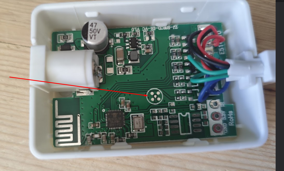

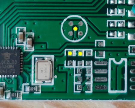

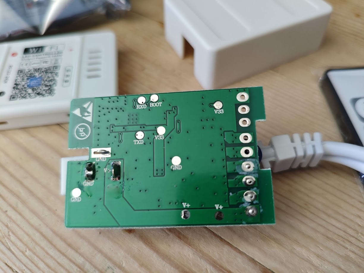

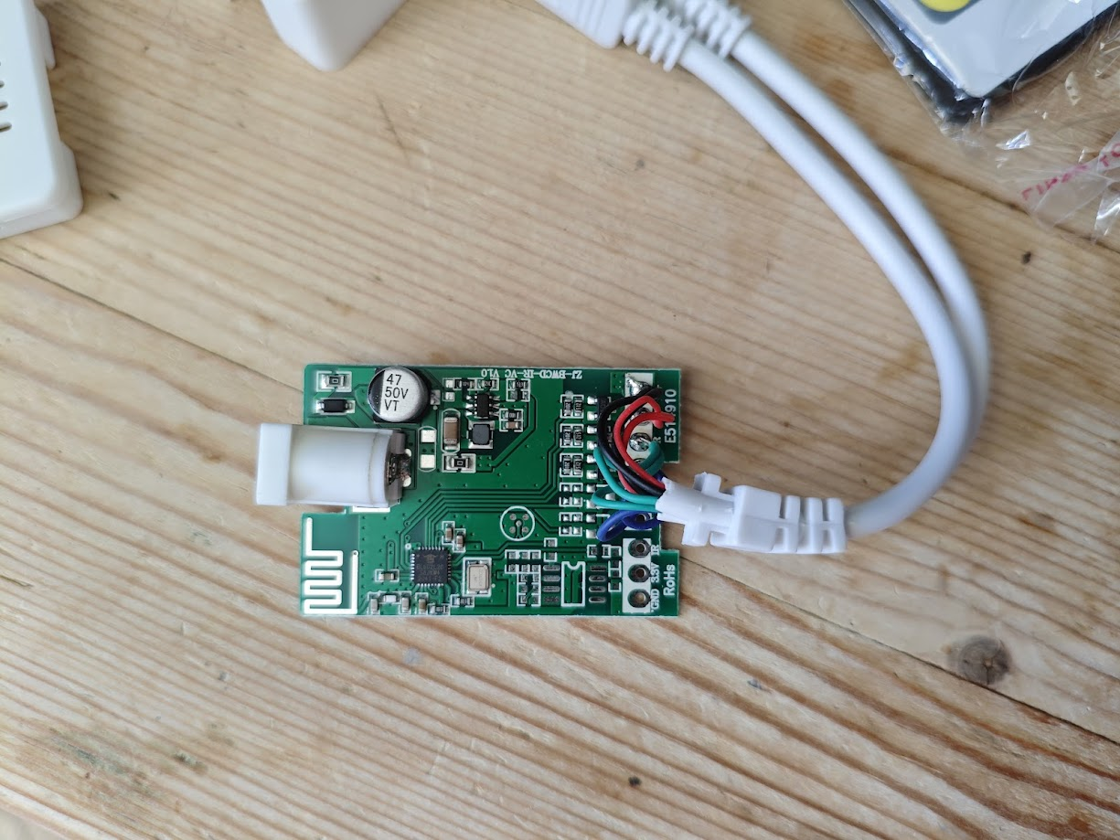

  • A Magic Home RGBW 12-24v 5-pin LED strip controller with an LF686 chip flashed as a BL602 is being configured for OpenBeken.
  • Flashing succeeded only after soldering all pads, powering BOOT from the external 3.3v rail directly, and using BLDevCube 1.4.8 instead of 1.8.8.
  • The working hookup used Ext 3.3v to V33, Ext 3.3v through a 10k resistor to BOOT, GND to GND, and TTL RX/TX crossed to the TX/RX pads.
  • Wi‑Fi appeared only with the external DC jack connected, and GPIO Finder showed pin 20 toggling, but the RGBW pinout and OBK template remain uncertain.
  • BL602 Wi-Fi join failure with zero MAC address

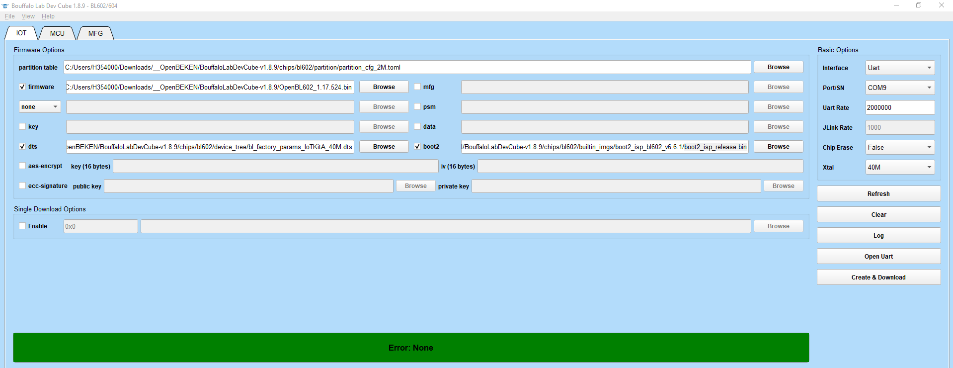

    I just tried reflashing it, no luck.
    Can you please check my parameters? I struggled with boot2.
    Bouffalo Lab Dev Cube interface with various firmware options.
    I couldn't find the boot2 stated in the screenshots of the post.
    I'm not sure if I can miss "flash wpa2 support" :D

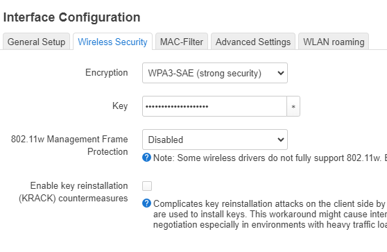

    #43 21030549
    Posts: 5212
    Help: 446
    Rate: 914
    and with WPA3 as the only option
    Wireless security configuration with WPA3-SAE
    Added after 20 [minutes]:

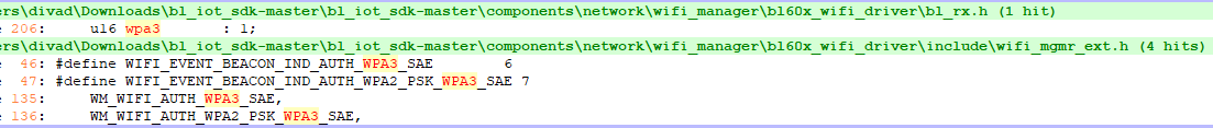

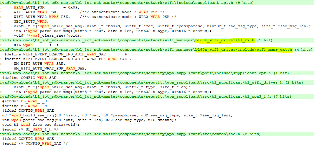

    I don't think the driver in the OBK SDK supports WPA3.
    these are keyword searches in the latest SDK
    Screenshot of source code highlighting WPA3 configuration.
    SDK code snippets with functions related to WPA3.
    Screenshot of source code showing excerpts related to WPA3 in header files.
    there's no mention of WPA3 here https://github.com/openshwprojects/OpenBL602/...ponents/bl602/bl602_wifidrv/bl60x_wifi_driver
    the copyright dates old vs new are two years apart
    Added after 3 [minutes]:
    I wonder if I can just plonk updated files into a PR and if it will build. I won't have time til this eve so here's the SDK I have if anyone wants to.
    https://github.com/bouffalolab/bl_iot_sdk/

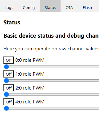

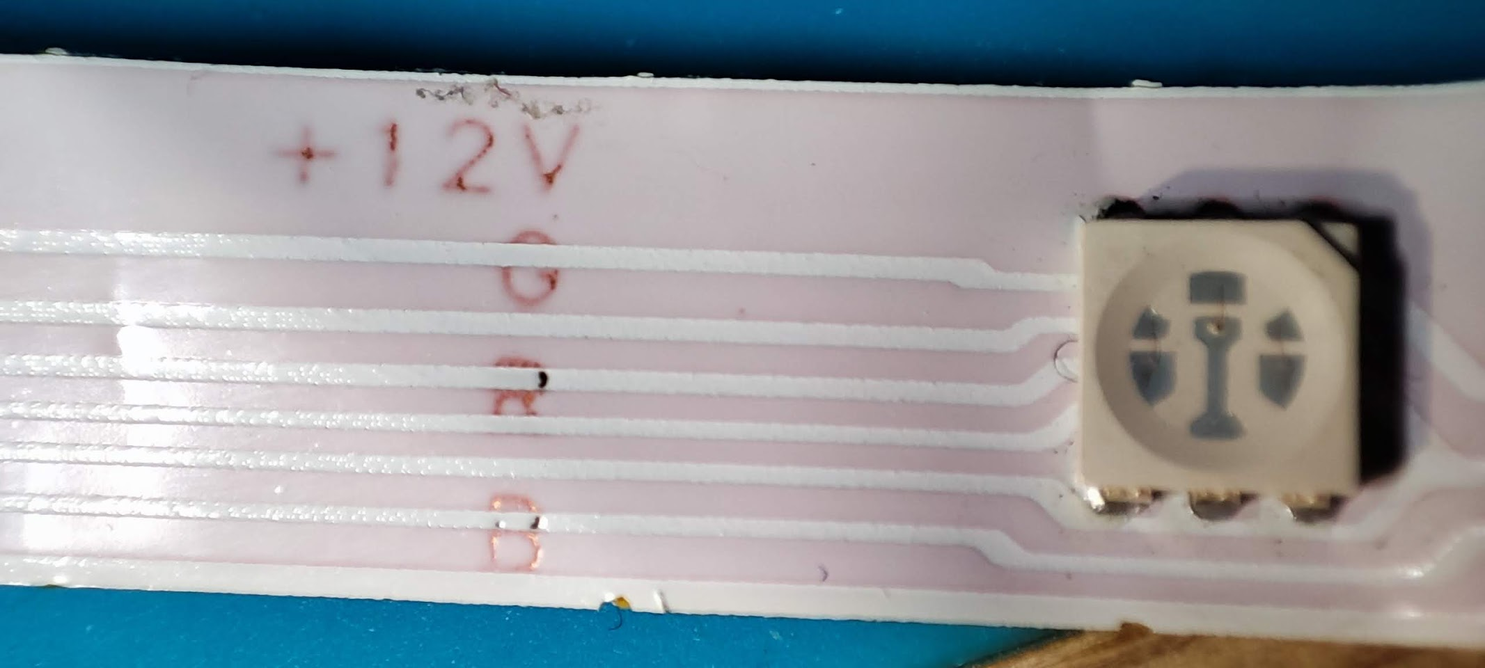

    did anyone figure out pwn pins ? My colors are wrong atm. Red color is green, green color is red and led temperature switch adjust brightness.
    I have same board as shown in first post of this thread.
    "pins": {
    "3": "PWM;1",
    "4": "PWM;0",
    "20": "PWM;4",
    "21": "PWM;2"
    EDIT:
    Swapped PWN 1 and 0 and colors are now ok.

    I've not looked at it since but could probably do better now.

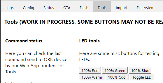

    Have a play with the tools in the web app until you get the right config
    Screenshot of a web application tool interface with PWM channel settings.
    View of the web app tool interface with buttons for testing LEDs.

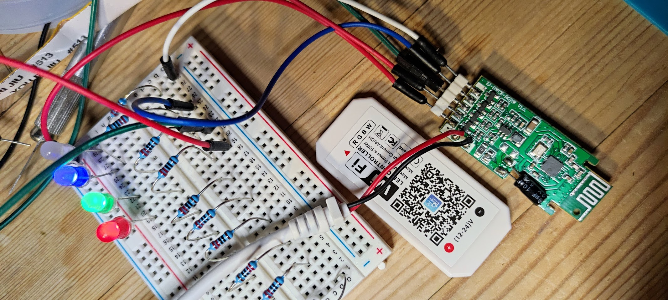

    OK, so my LED strip is GRB order = 4 pins inc. V+. I still don't have a 5 pin strip. This is why the original template in earlier posts is wrong.
    Close-up of an LED strip with +12V and G, R, B markings on a white background.
    using a little test setup, the correct template for the RGBW controller itself, is this:
    Test setup with LEDs on a breadboard connected to an LED controller.
    includes flag 24 set
    Selecting Flag 24 option in the LED device interface to emulate white light using RGB.
    with this, 100% warm = my white LED lights and 100% cool = red, green and blue only light.

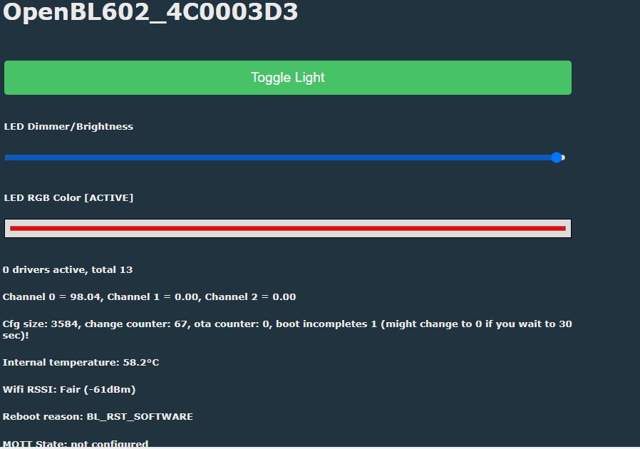

    Hello everybody.
    I was also able to flash with external power. Everything is ok until I configure the pins, the green color is swapped with the blue and I don't know how to invert it, but that's not really important. What doesn't work is the IR control. How did you do it?
      "vendor": "Tuya",
      "bDetailed": "0",
      "chip": "BL602",
      "board": "TODO",
      "flags": "1024",
      "keywords": [
        "TODO",
        "TODO",
        "TODO"
      "pins": {
        "3": "PWM;1",
        "4": "PWM;0",
        "12": "IRRecv;1",
        "21": "PWM;2"
      "command": "",
    Screenshot of the OpenBL602 device user interface showing LED settings and system stats.
    Thanks
  • #52 21084261
    Posts: 14755
    Rate: 12881
    You need to swap channel indexes of PWM pins:
    JSON code fragment defined in the pins section highlighted with a red marker.
    0 is red, 1 is green and 2 is blue. So, in your case, you need to swap 1 and 2.

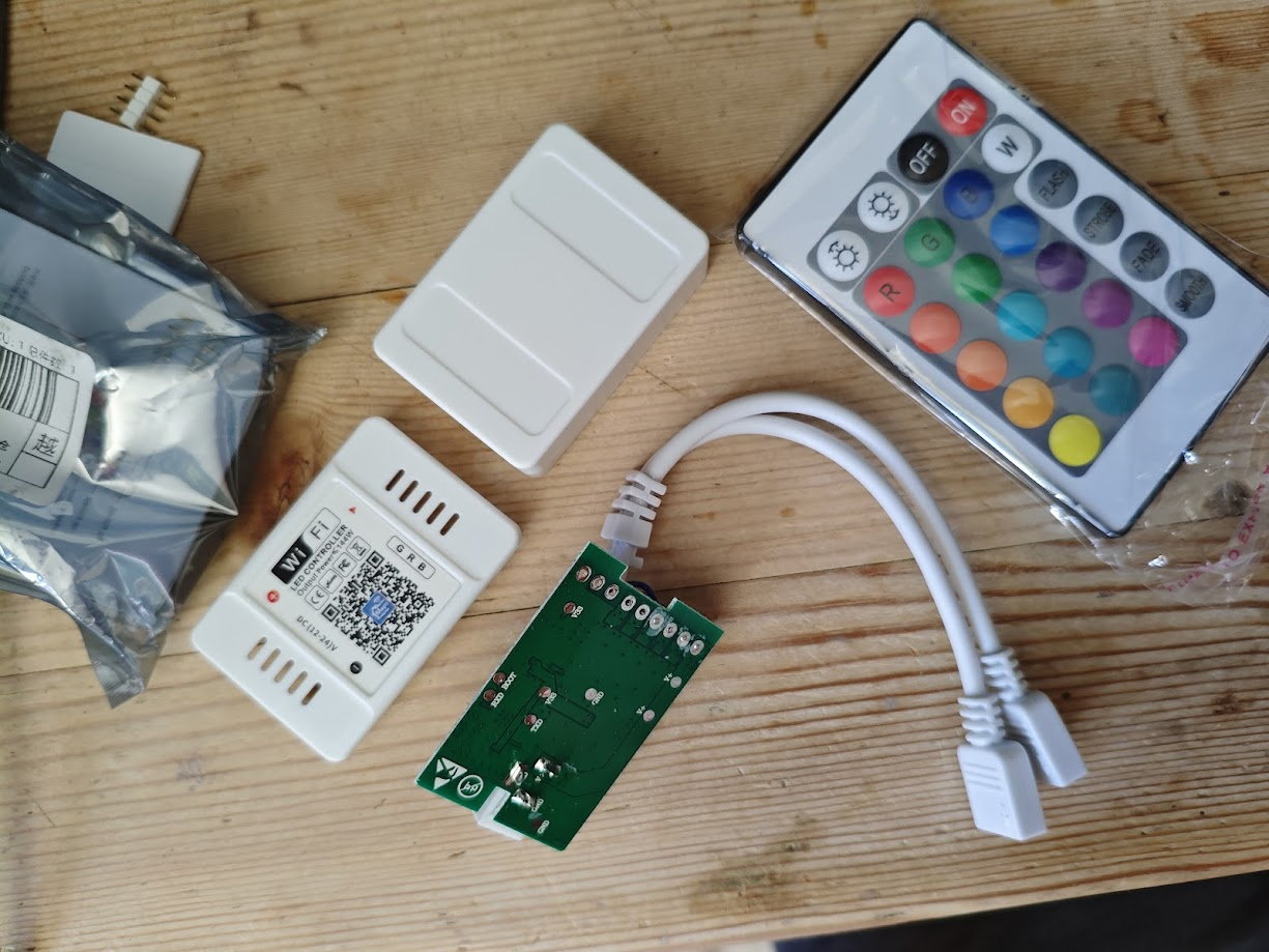

    another Magic Home BL602 variant. On-PCB chip is not labelled LF686 this time.
    Magic Home BL602 controller components, infrared remote, and PCB. Close-up of a PCB inside a Magic Home BL602 housing with wires and electronic components. PCB with Magic Home BL602 chip without LF686 marking. Green PCB with visible chips and electronics, connected to a cable.
    https://www.aliexpress.com/item/1005006678836577.html
    RGB LED controller with remote on AliExpress.
    It came supplied with IR remote but no IR receiver is present.
    I'll dump factory then try OTA hack and post back findings.

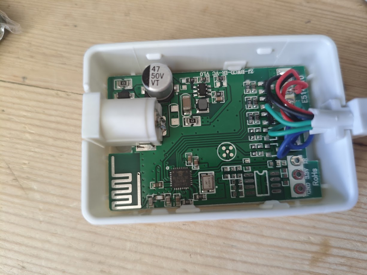

  • #56 21109643
    Posts: 14755
    Rate: 12881
    What is this space for?
    Close-up of the inside of an electronic device with a printed circuit board and a capacitor.
    It's also interesting to see that they skipped placing one capacitor in the power section.
  • #57 21109664
    Posts: 5212
    Help: 446
    Rate: 914
    i can't think what that might be. A mic would make most sense as a missing component in this device, but surely they're all 2-pin. The 4 outside pads are ground and the centre traces to the two pads below.
    Photo of a printed circuit board with visible tracks and electronic components.
  • #58 21109684
    Posts: 14755
    Rate: 12881
    So most likely mic, those controllers also come in "musical" version
  • #59 21109691
    Posts: 5212
    Help: 446
    Rate: 914
    Sure. I guess so. And the other missing components are the pre-mic network seen on other devices between IoT chip and mic one assumes. I couldn't find any 5-pin 4-ground mic components Googling, but who knows.
    Yeh. Must be. Like the series of resistors and things you see on the Outsmart SPI devices in the mic area
