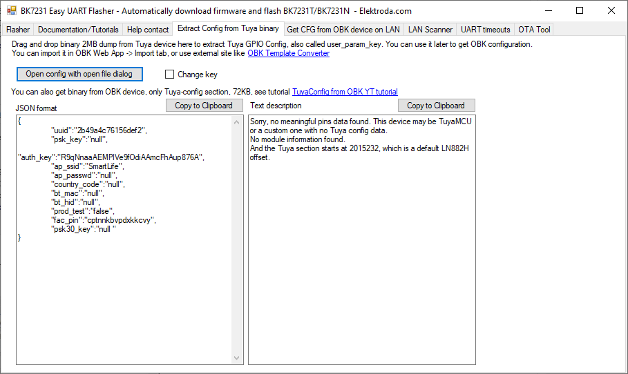

    Bootloader overwrite and config extraction fixes for BK7238/T1
    #333 21701945
    insmod
    Posts: 1408
    Help: 164
    Rate: 443

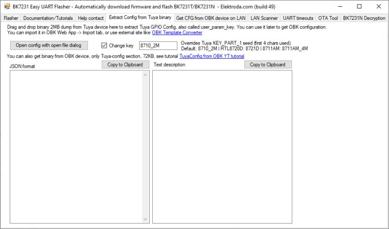

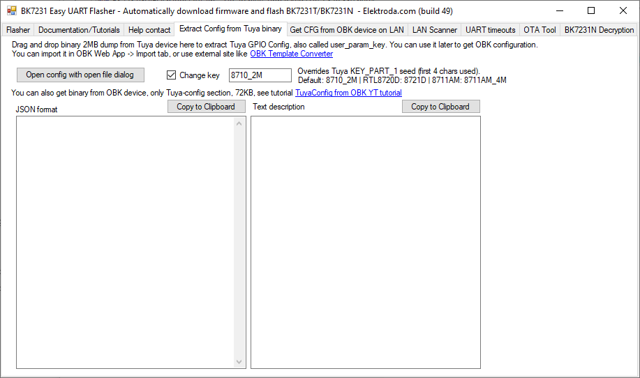

    https://github.com/openshwprojects/BK7231GUIFlashTool/pull/65
    Always overwrite bootloader for BK7238/T1, since we can't ota with default T1 bootloader. And overwrite 7252N, 7236 and 7258 for the future.
    Can now override default 8710_2M key. 8711AM_4M decrypts WRG1 config successfully, and 8721D decrypts 8720DN configs.
    There is some strangeness to WBR1D and T5 configs. Tuya magic is after data, so nothing gets extracted. If manually moved magic before data - extraction is successful.
    Will now extract at least something if no pin/baud data is in the config.
       "uuid":"22527ceacb5223f3",
       "psk_key":"null",
       "auth_key":"pX5PvwBmZ5ATsFbu3oDk8O6LZqKbXwA9",
       "ap_ssid":"SmartLife",
       "ap_passwd":"null",
       "country_code":"null",
       "bt_mac":"null",
       "bt_hid":"null",
       "prod_test":"false",
       "fac_pin":"w57tepkyqlsegcov",
       "psk30_key":"null "
    Sorry, no meaningful pins data found. This device may be TuyaMCU or a custom one with no Tuya config data.

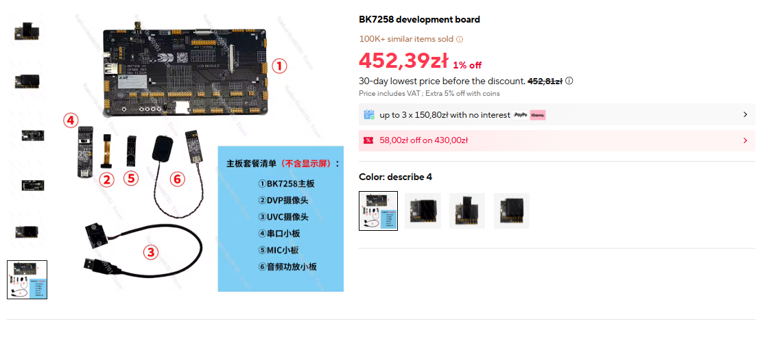

    Search results page for WB5E development boards on AliExpress
    ESP32 development board with two loose pin headers beside it
  • #342 21750930
    Posts: 14654
    Help: 655
    Rate: 12661
    Wow so BK7258 has reached Aliexpress?

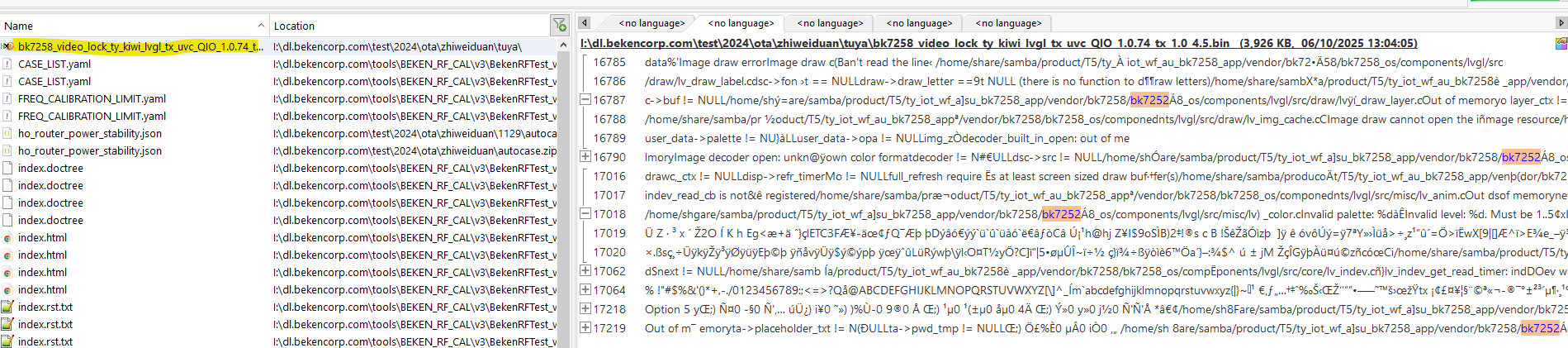

  • Bootloader version differences between RTT and FreeRTOS SDKs
    #358 21832723
    Posts: 5092
    Help: 441
    Rate: 900
    3.0.78 but different https://dl.bekencorp.com/SDK/bk_7252n/
    BK7251 default target, libs scattered about, RTT, older toolchain, newer/different bootloaders
    Added after 58 [minutes]:
    up_boot_rtt_bootloader_34be6bf.rar - RTT bootloader source? but still some precompiled libs in there
