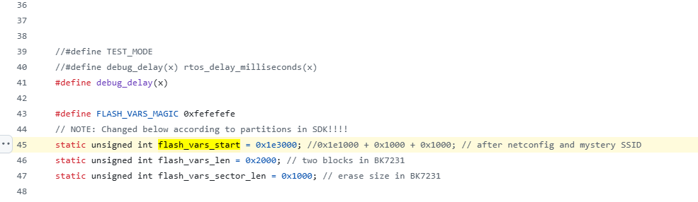

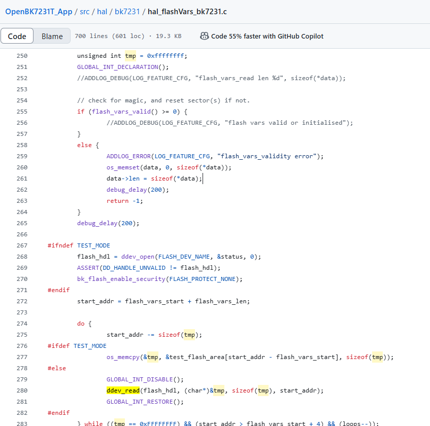

    I believe i found the cause of why flashvars aren't working. In flash_vars_read, before ddev_read(flash_hdl, (char*)data, len - 1, start_addr), len is calculated. But, somehow it is zero. So, when ddev_read tries to read with length -1, it freezes.
    A small problem is also with log. While OBK and bootloader log is redirected towards UART2, everything else goes to UART1. And it logs too much, especially if something like pwm is configured.
  • #33 21332379
    Posts: 14649
    Help: 655
    Rate: 12661
    First check:
    	start_addr = flash_vars_start + flash_vars_len;
    Screenshot of source code in C language in a text editor.
    are they per page aligned?
    Added after 48 [seconds]:
    Screenshot of source code defining flash variables.
    Or are they the same ?
    Added after 43 [seconds]:
    here they are changed:
    Code: C / C++
    flash_vars_init calls bk_flash_get_info(BK_PARTITION_NET_PARAM); which may return something unexpected on your SDK?

    Also, do you get:
    Code: C / C++
  • #36 21332386
    insmod
    Posts: 1407
    Help: 164
    Rate: 443
    flash_vars_start and flash_vars_len should be the same, in BkDriverFlash.c partition_start_addr and partition_length are the same, as in T sdk.
    >>21332381 No, i don't
    tmp is 0
    Took a backup, and i can see, that basic flash_vars length is written correctly (0x50 at 0x1E304F and 0x1E30EF), but when reading in a loop it is zero (probably because additional 4 bytes is written after last flash var (something with alignment?))
    Added after 2 [hours] 28 [minutes]:
    Well, it is alignment failure. As soon as i added packed attribute to FLASH_VARS_STRUCTURE, it works ok. GCC/cflags problem? Default struct size for me is 80 bytes, while looking through OBK backup with hex - size is 64 bytes. Even though it works with packed attribute, size is still not 64 (71 now).
    Added after 8 [minutes]:
    Maybe time_t is 4 bytes in old gcc, while in current (i use 10.3) it is 8 bytes?
    Added after 55 [minutes]:
    Well, i changed time_t to unsigned int and now it works as expected. In the future it will probably be better to migrate to easyflash (already in sdk, no porting needed).

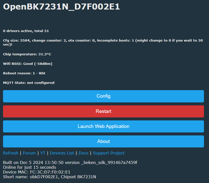

    Well, i managed to boot it on BK7231N. Had some bumps with encryption, but managed to resolve it.
    Need to do something about rerouting logging to UART2, and to do something about binary size. Currently it is ~873kb, and this is with some features disabled.

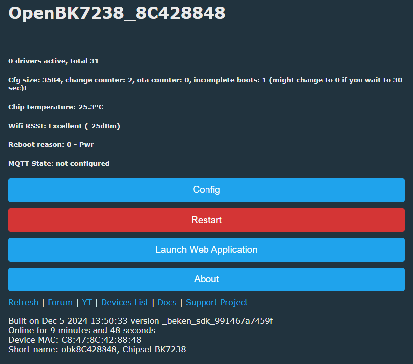

  • #45 21334326
    Posts: 5091
    Help: 441
    Rate: 900
    cool. BK7238 boot is nice to see - SDK info and stuff
    .bin from 0x0
    OpenBK7238 user interface displaying system information

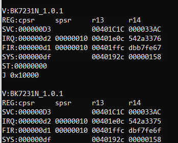

    Rate: 900
    had to OTA to BK-New. QIO wouldn't boot
    Screenshot of the OpenBK7231N interface displaying device status information.
    Screenshot of the boot log for a BK7231N device, version 1.0.1, displaying processor register information.
    N boot log

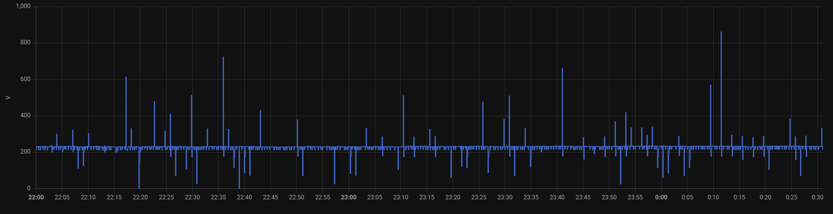

    Several minutes after boot http ceases to work properly, i assume it is some problem with lwip, because some http requests manage to get a proper response. But most of the time it is either ERR_CONNECTION_RESET, ERR_EMPTY_RESPONSE, or 200 with 0 bytes response after 1s. But for those that succeeded, log entry that connection is established is shown. For those that failed, even those with HTTP 200 and 0 bytes, nothing logged.
    Added after 10 [minutes]:
    Also something is wrong with either interrupts or timings, this is what now my voltage history on bl0937 plug looks like.
    Graph of voltage on the BL0937 plug showing numerous fluctuations over time.
    I don't have RF powersave implemented yet, but it looks the same with or without mcu ps.
    On standard version, even with powersave on, it looked normal, without those spikes
  • #56 21337929
    Posts: 14649
    Help: 655
    Rate: 12661
    Regarding BL0937 - poweresave breaks it, but if it's not powersave, then can you look here?
    https://github.com/openshwprojects/OpenBK7231T_App/pull/1280
    @insmod this PR is stuck because I wasn't been able to verify it, but maybe you can check this out?
    I will check futher changes (server) in the morning at earliest, but I remember that I've tried to do a single-threaded server on Beken but for some strange reason it was working very poorly, slow and sluggish.
  • #57 21338428
    insmod
    Posts: 1407
    Help: 164
    Rate: 443
    >>21337929 BL0937 fix didn't solve the problem for me, still spiky. The biggest spike i got is 60kV. So the problem is somewhere else.
