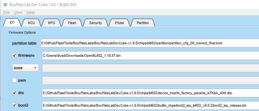

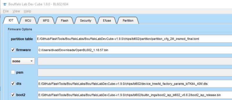

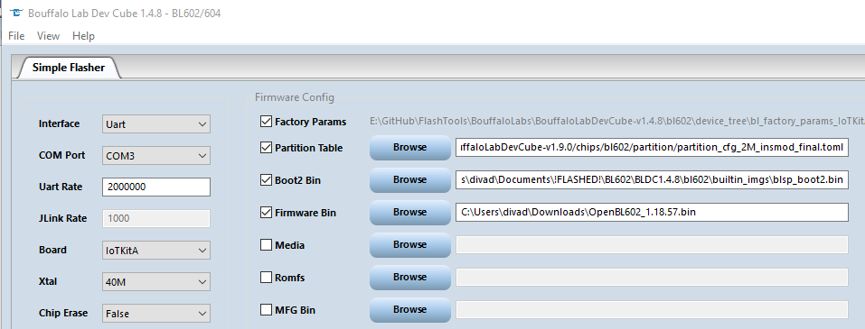

    if you start with new BLDC -> empty flash -> write OpenBL602 as below ->
    Screenshot of Bouffalo Lab Dev Cube showing firmware configuration paths for BL602
    BLDC 2mb read dump -> erase flash -> SharpBL602Tool 2mb dump write
    OTA 1.18.57 -> 1.18.95 - wifi is OK ✅ -> OTA to 1.18.163 - wifi is OK ✅
    was original full_binary_with_app_OpenBL602_1.18.57.bin made with BLDC 1.4.8?
    Must be newer boot and dts and other image blobs that are compatible with newer SDK in recent BLDC?
    • full_binary_with_app_1.9.0_OpenBL602_1.18.57.bin (2 MB) You must be logged in to download this attachment.

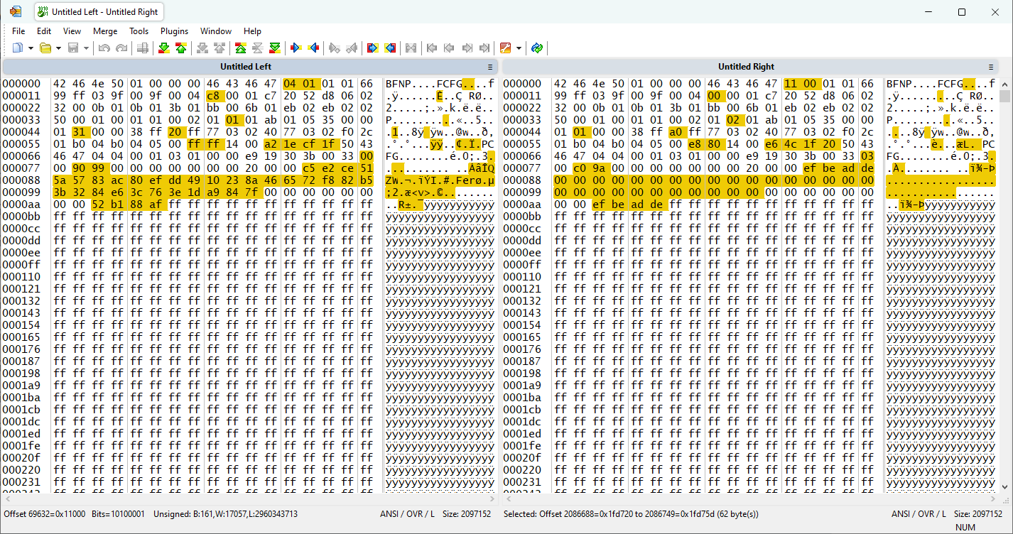

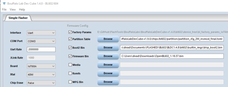

    for comparison purposes. same procedure to make 2mb dump. BUT using 1.4.8 program, dts, blsp_boot2.bin - same toml as 1.9.0
    Screenshot showing Bouffalo Lab Dev Cube 1.4.8 configuration for flashing firmware to BL602/604 chip.
    there are difference in the BL from 0, from 0x2000 and then a few other places. app partition from 0x11000 is the same I think
    Comparison of two binary files in hexadecimal format using WinMerge, with differences highlighted.
    https://github.com/WinMerge/winmerge/releases/tag/v2.16.50.2
    • full_binary_with_app_1.4.8_OpenBL602_1.18.57.bin (2 MB) You must be logged in to download this attachment.

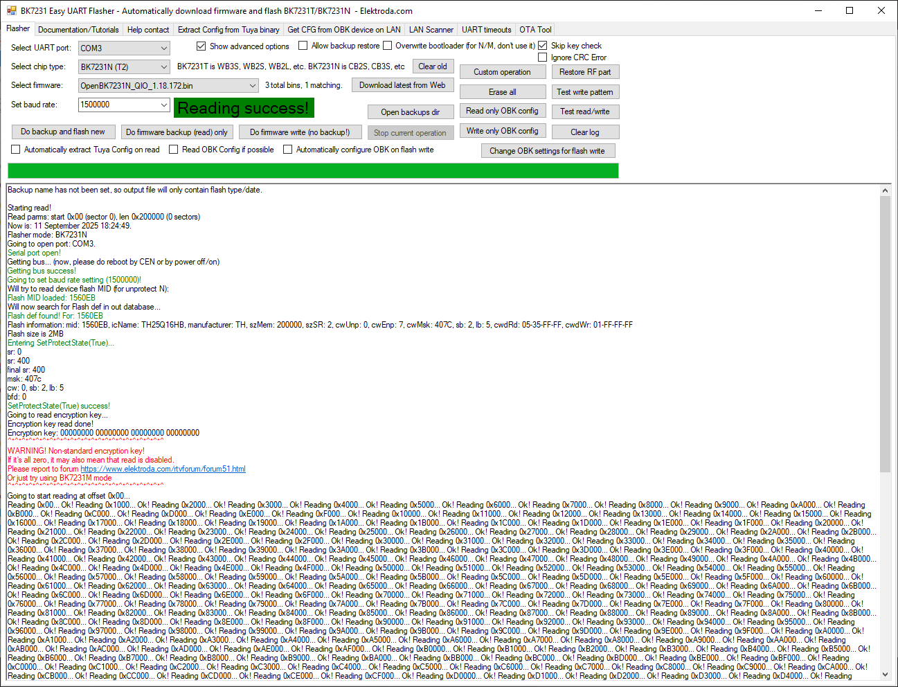

    I soldered my T3-3S module to nicemcu board, and tried to take a backup via EF.
    It worked... somewhat. I did it in BK7231N mode, had to skip key check and ignore crc error.
    I tried to do flash read via custom operation, because T3 has 4mb flash.
    And well, it first dumped last 2mb into file, then first 2mb. If i fixed it manually, then file content matches the dump made in BKFIL.
    Attached both files, fixed and default.

    If doing standard firmware backup, it reads only last 2mb of flash.
    @p.kaczmarek2
    What do you think about my earlier idea regarding flash size on BK72xx in EF?
    Currently it always dump 2mb, but do you think it's prudent to make it autodetect flash size like with RTL8720D?
    • readResult_BK7231N_QIO_7236_2025-02-9-13-25-17.zip (2.21 MB) You must be logged in to download this attachment.

    you spoil us. very nice
    Added after 13 [minutes]:

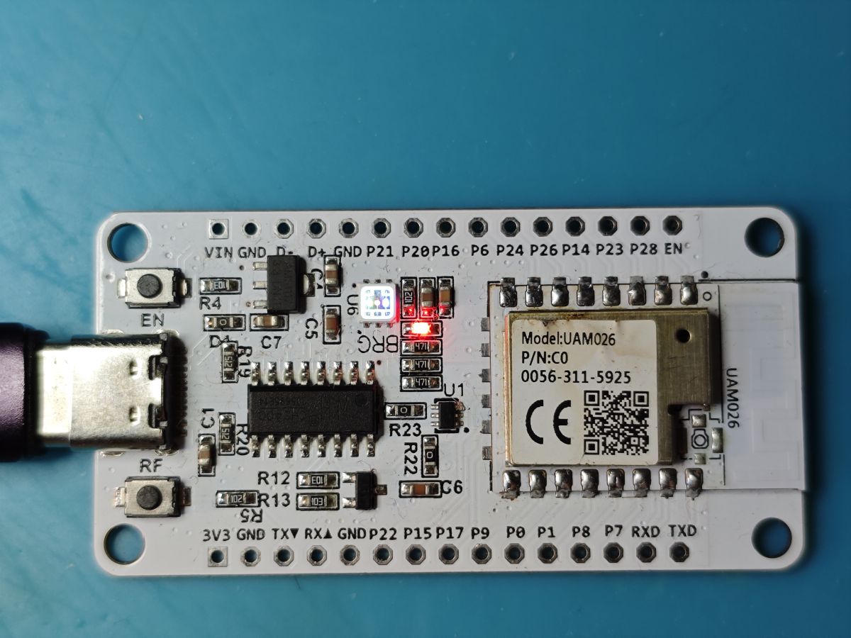

    OK at 1500000 with UAM026 (Uascent key BK7231N) on NiceMCU.
    (higher stops at beginning)
    BK7231 Easy UART Flasher interface with “Reading success!” message
    Development board with UAM026 module connected via USB-C

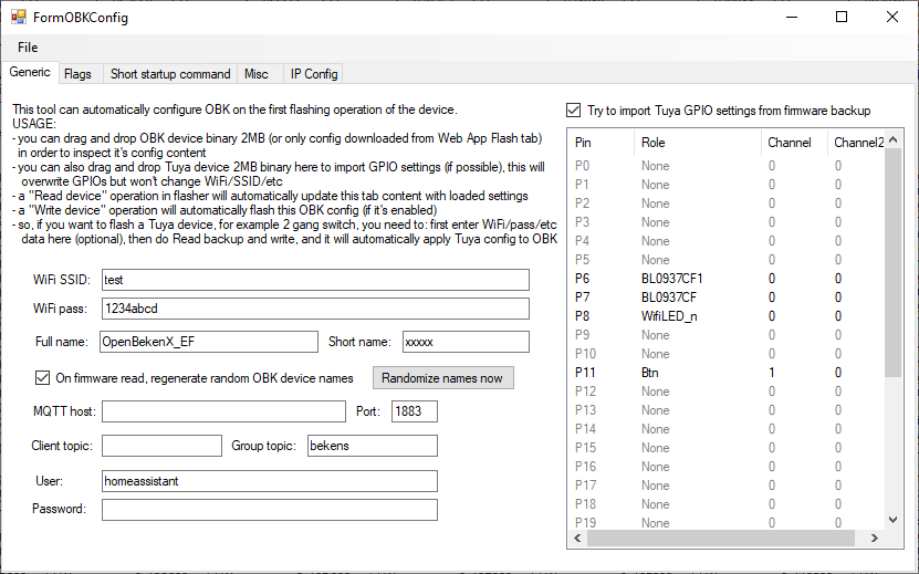

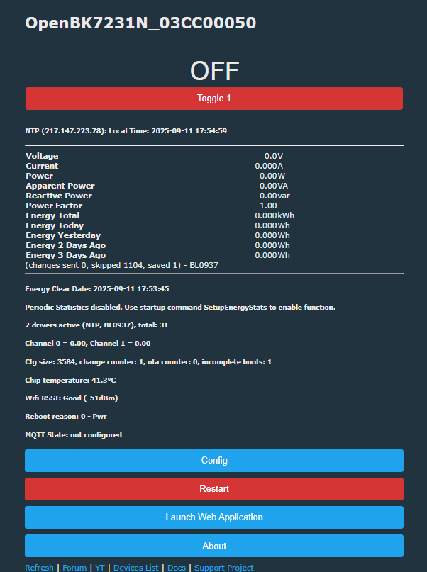

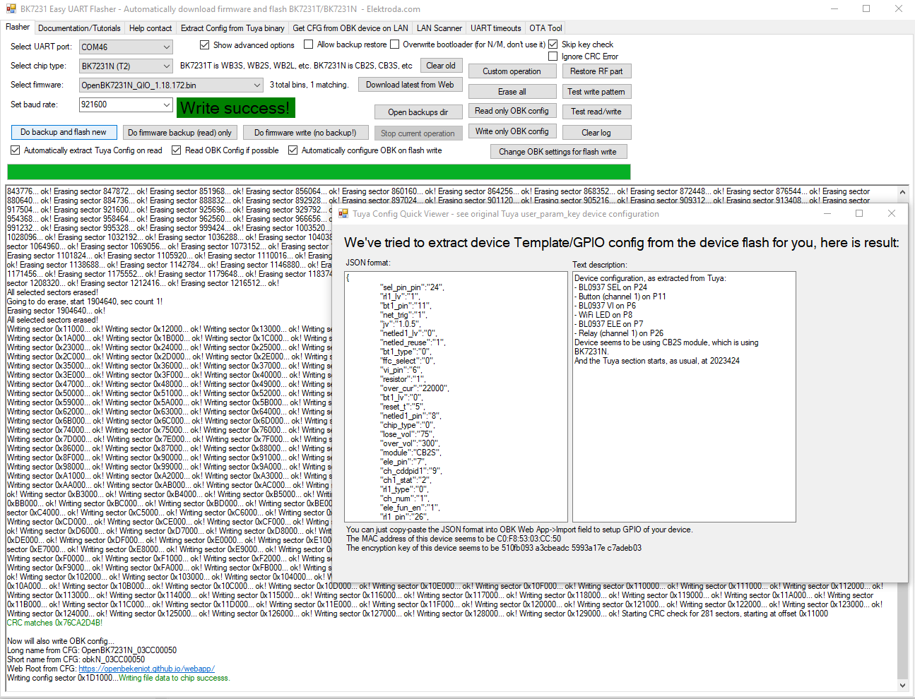

    simulate real device conversion.
    basic generic plug Tuya_Plug_AU_(schemaID-000004b708)_keyjup78v54myhan_j20xh6tbtz8rn2sr_CB2S_1.1.23.bin
    Screenshot of BK7231N Easy UART Flasher showing successful Write success operation
    FormOBKConfig window with Wi-Fi settings and GPIO mappings for a Tuya device
    device joins AP in OBKConfig form, flag set, startup command set. Extracted config OK too
    OpenBK7231N interface with device turned off and detailed energy stats

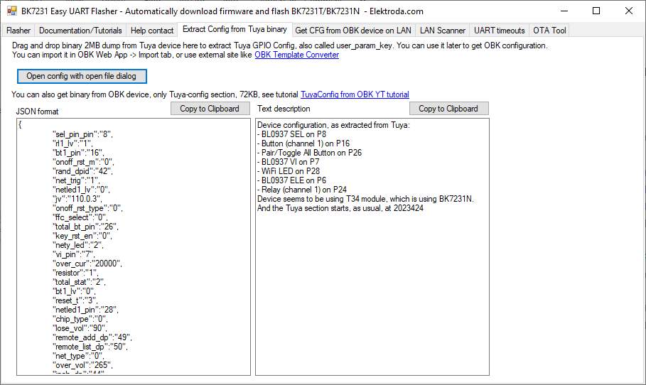

    Tuya config extraction slightly updated (had to use several hacks, but it worked stable for every dump).
    Can now parse T1, RTL87X0C and RTL8710B configs.
    Pins are wrong on RTL8710B dumps though. Can't map them to OBK.
    Checked 8721D key - worked on all RTL_D/RTL_CSM except WBR1D dump. Nothing valuable to extract though.

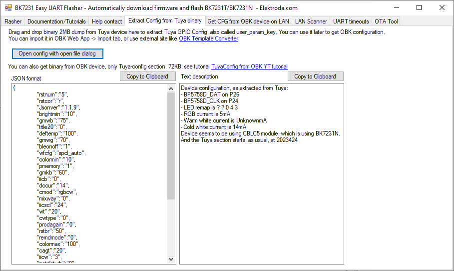

    Screenshot of BK7231 Easy UART Flasher showing JSON config and text output
  • #321 21694334
    insmod
    Posts: 1395
    Help: 164
    Rate: 436
    Did some minor fixes, added vertical scrollbar to tuya json and some tuya keys (old button, wifi led and bl0937 roles).
    Plus it now prints what current for i2c leds the original firmware used.
    I successfully fixed RF on HLK-B30 with new method.
