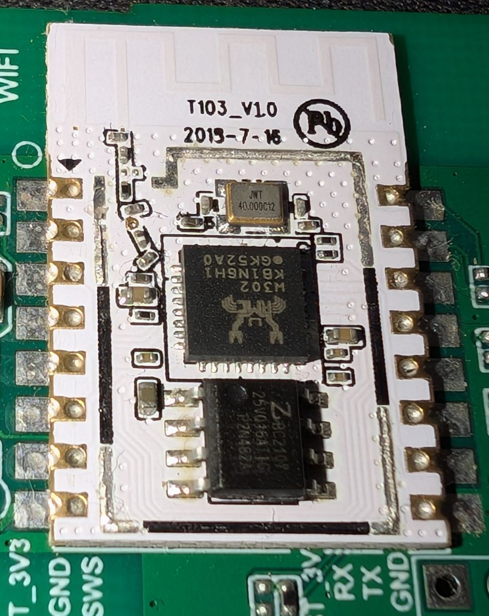

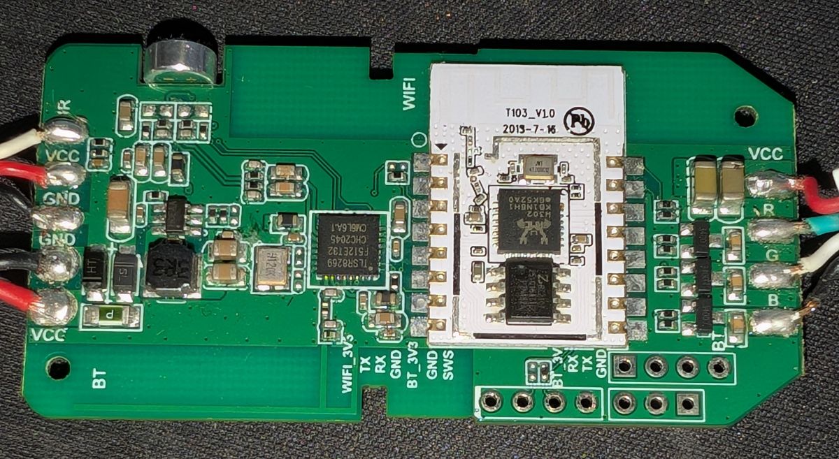

    I have this controller for Govee H61541A1 LED Strip Lights. The chip inside is T103_V1.0, this has W302 chipset, CPU is Realtek RTL8710BN. This chip & CPU is supported by LibreTiny.
    Close-up of an electronic module labeled T103_V1.0 with visible components on a PCB. Controller for Govee H61541A1 LED Strip Lights with visible T103_V1.0 board and Realtek RTL8710BN chip.

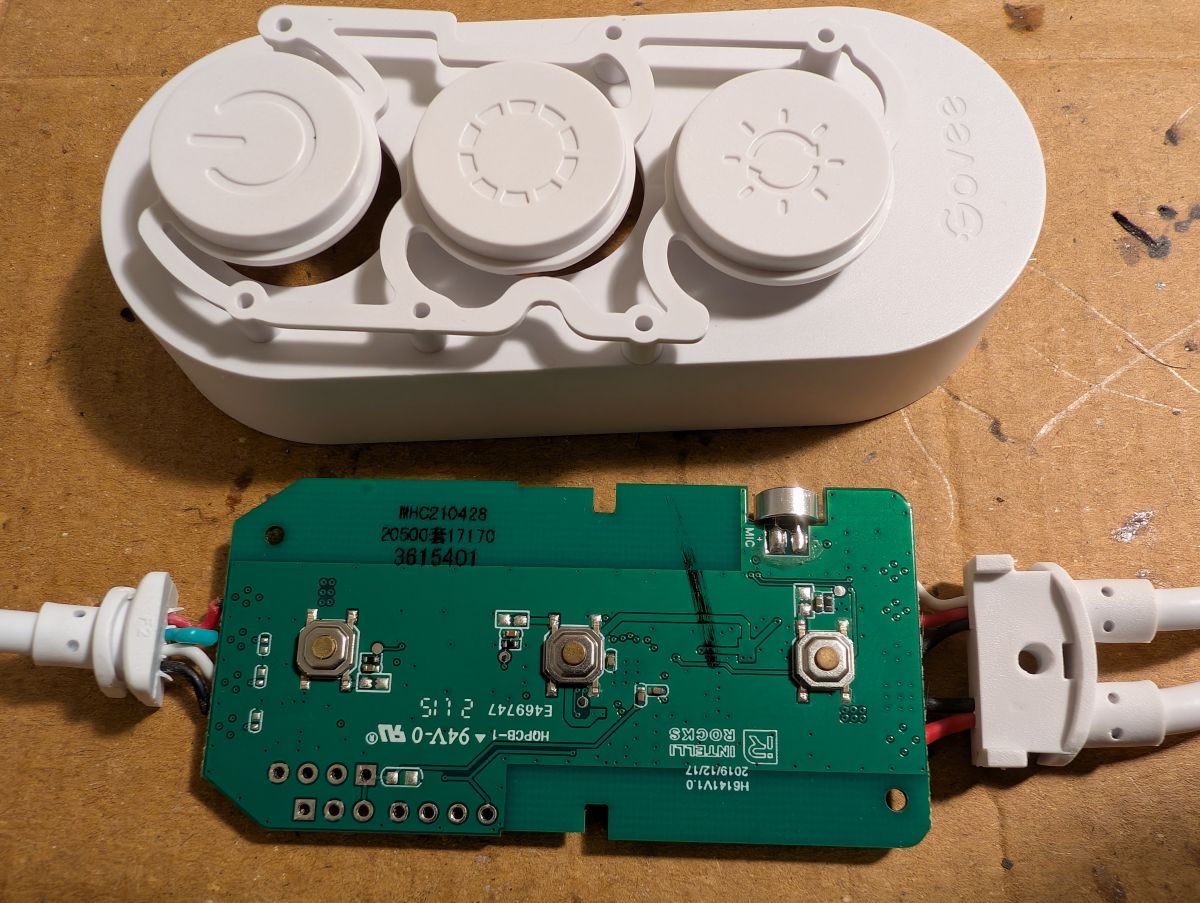

    I was wondering if anyone has flashed this chip with OpenBK7231T or ESPHome? I see a bunch of GPIO pads, so I am assuming flashing in-place should be possible, if not, de-soldering the chip should be easy enough. Any suggestion or input is valuable. There are only a handful mentions of this module online, one of them is from www.elektroda.pl
    Additionally there's a Bluetooth chip, Mic & IR Receiver on the controller. I see no use for Bluetooth, however can Mic & IR be utilized in openbk7231t.

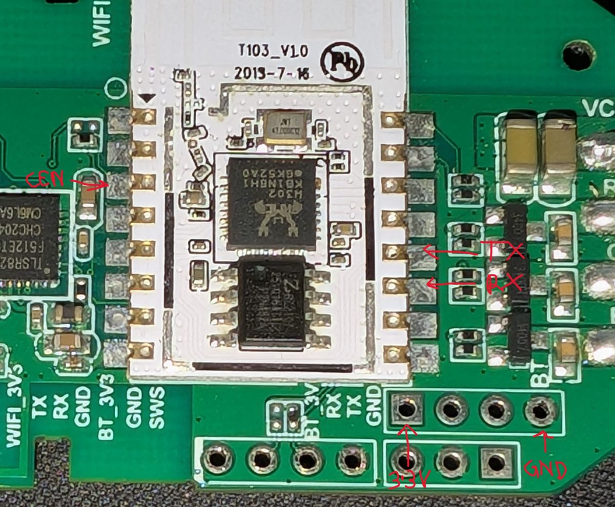

    Good News! I was able to read flash using Itchiptool. Attached.
    I had to use the TX2/RX2 & CEN pins from the module directly. The PCB pins were only good for VCC & GND, see image. Then follow the following instructions to get the chip into download mode:
    - connect CEN to GND
    - connect TX2 to GND
    - release CEN from GND
    - release TX2 from GND
    Close-up of a PCB with clearly marked pins: CEN, TX, RX, and GND areas.
    But while analyzing the dump (attached), I get error: "File doesn't contain known storage area". Maybe I needed to do something else, not sure. I am new to this.
    I then flashed esphome-kickstart (kickstart-rtl8710bn-2023-12-15.uf2). However, it doesn't get past input Wi-Fi screen. It accepts the Wi-Fi credentials, connects to router, but the UI never shows up. The kickstart uses following esphome config:

    I don't even know, what controls what there. Perhaps everything is controlled by tlsr, and wifi only acts as a relay between cloud and device itself. And if so, then i highly doubt the protocol is a TuyaMCU one.
    And looking at the module i see that TX and RX (not log ones) are wired to something.

    You may be right about tlsr too. On the rear side PCB has 3 buttons (see image) to physically control the LEDs, they still work (although I can't confirm if they work as they did with the original firmware), which suggests to me that LED output is not dependent on or controlled through firmware.
    Disassembled LED controller housing with visible PCB and buttons.
    At this point, I think, it would make more sense to replace this with one of the generic LED RGB controllers from AliExpress. :(
