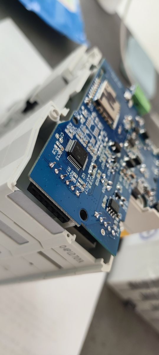

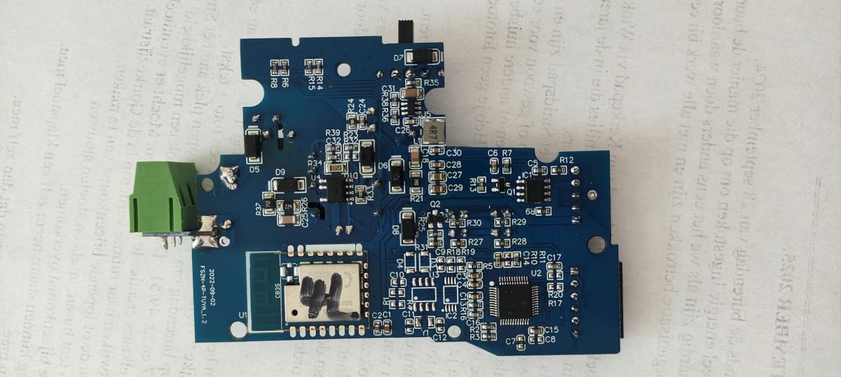

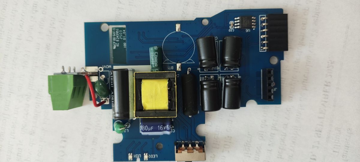

    thomasbrasser
    Posts: 7
    Finally got my 3rd one and took it apart:
    - seems Tuya MCU!
    - may be flashable via pins on the side without disassembly?
    Close-up of CB3S module with visible RX, TX, GND, and 3V3 pins on a blue PCB
    PCB with transformer, capacitors, and connector pins visible on board
    PCB with CB3S module, labeled pins, and various surface-mounted components
    EDIT:
    - CB3S Module
    - TX&RX connected
    - obviously GND & 3V3 connected
    - CEN & P14 connected
    Also this entire part seems to be connected via modbus to the circuit breaker (A B N 12V (but may be not really 12V will check)
    So that's also interesting!
    Going to read up on TuyaMCU ;)

    mcu: v1.0.0 also indicates that it is most likely TuyaMCU device. Start by taking original flash 2MB backup.

  • Disassemble only the Wi-Fi module to avoid gear damage
    #9 21643110
    thomasbrasser
    Posts: 7
    Just a big disclaimer on this device: ONLY disassemble the wifi 'module', leave the next one (with the pairing button etc) alone & securely attached to the rest (the breaker).
    If you do open it the gears fly out / come dislodged & there's a very high chance it doesn't go back together in the correct way, making the whole thing useless/dangerous.
    I found out the hard way, but now that flashing with obk was successful I'm immediately ordering a new one!
  • #10 21643116
    thomasbrasser
    Posts: 7
    No OTA flashing, but very easy to flash once opened up. There's 3 small rivets you need to drill out, then the entire Tuya part can slide out. Connecting 3.3V/GND/TX1/RX1/RX2 is enough, no external PSU needed (for flashing at least) and no traces need to be cut. CB3S inside.
