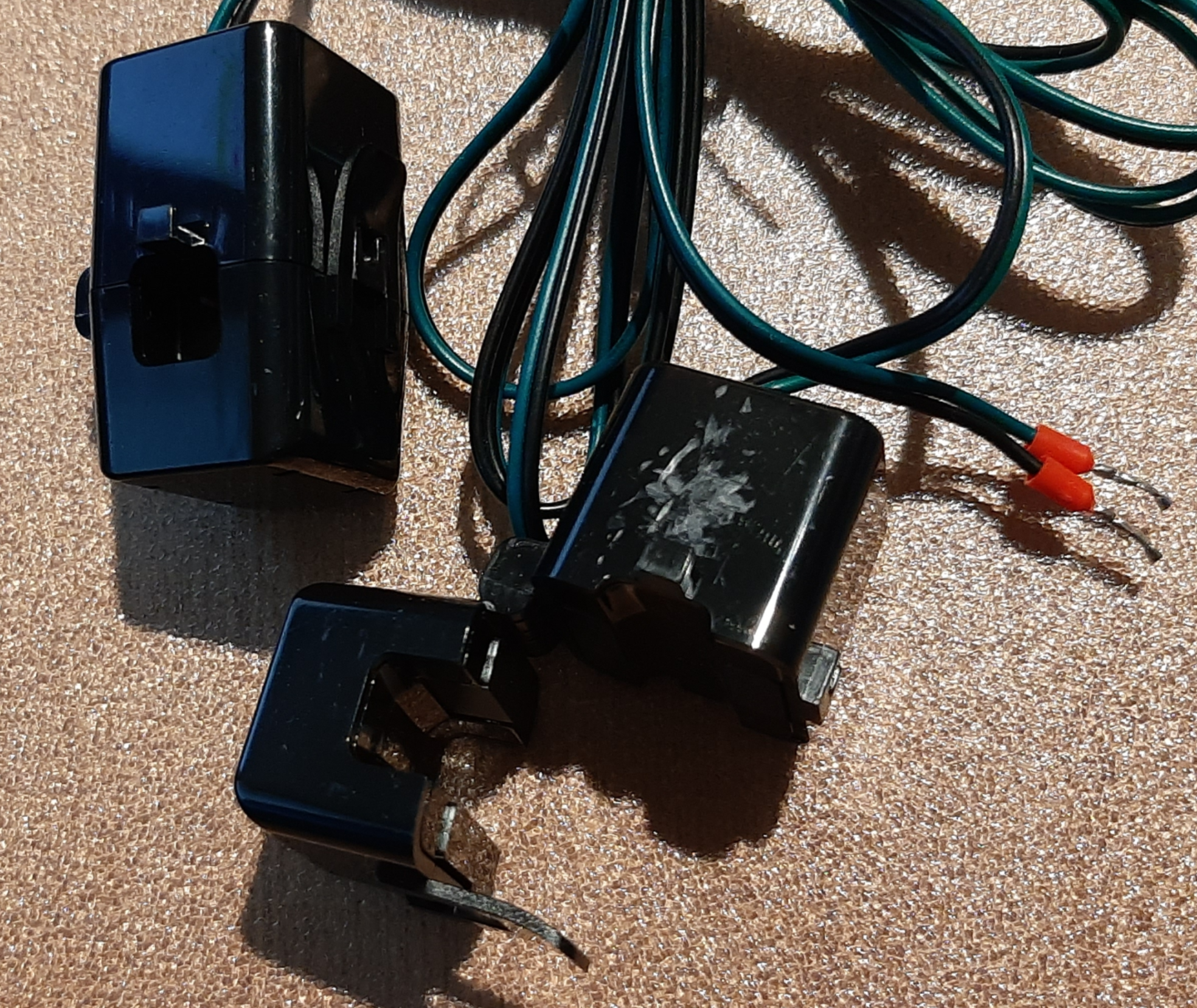

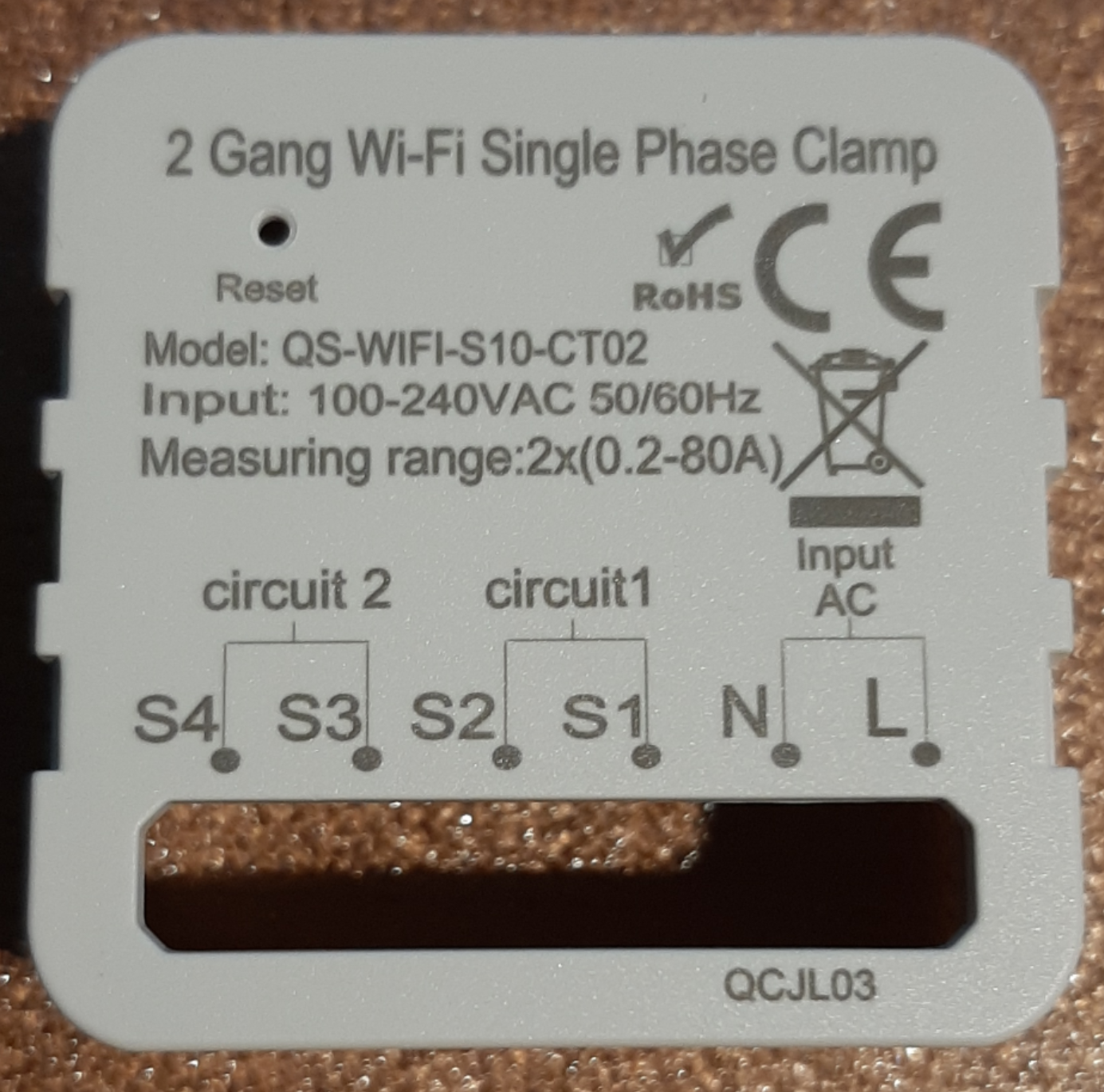

    I have recently bought a "2 gang wifi single phase clamp".
    model QS-wifi-S10-CT02
    It is based on a CB2S and used for monitoring power without disconnecting (via clamp)
    I was wondering if there is a flash instruction for new firmware that disconnects from internet?

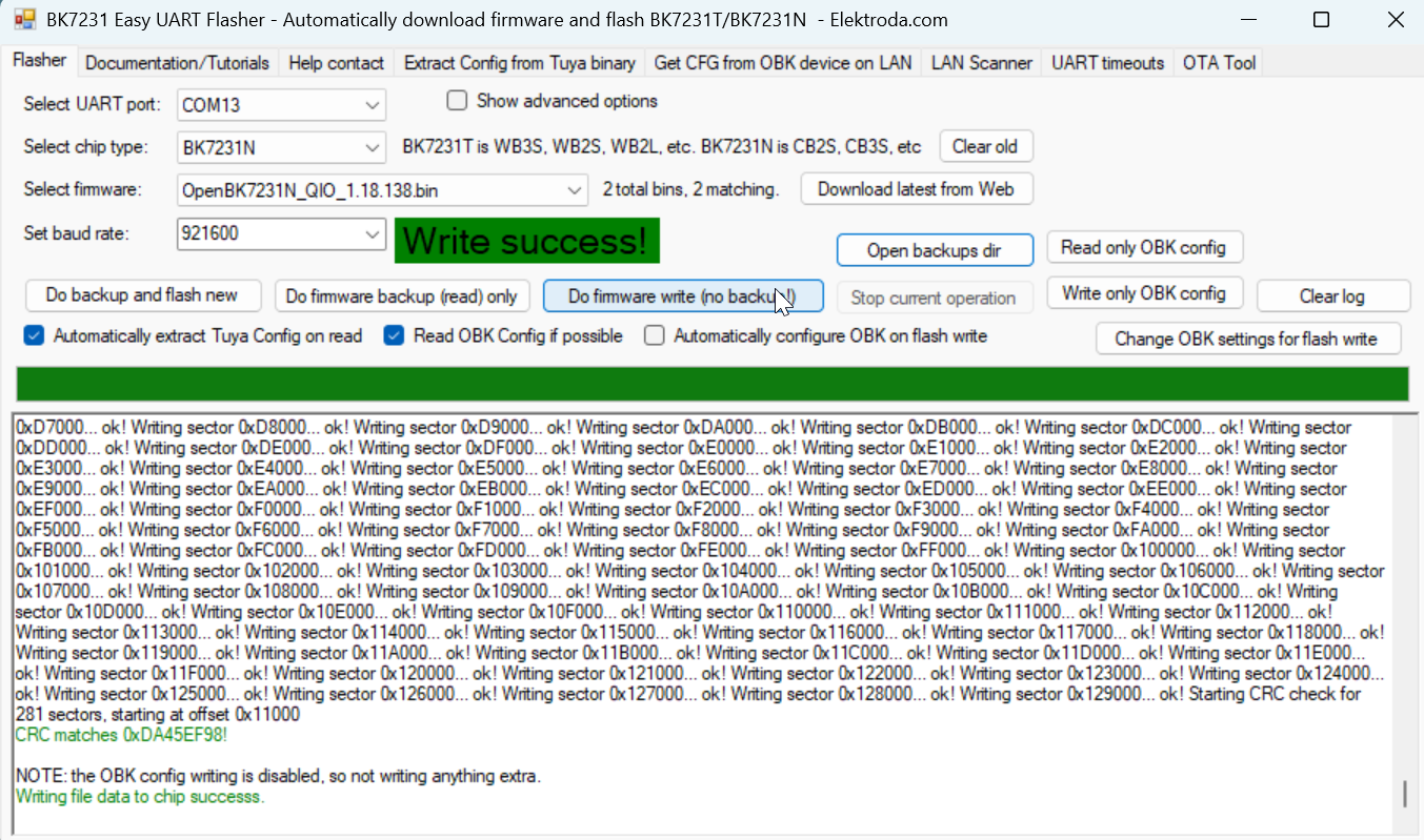

    used the flasher from your link.
    all looks fine. I can't access device via 192.168.4.1, I cannot find the AP
    What did I do wrong?
    QS-wifi-S10-CT02 (CB2S) Flashing Guide for Offline Firmware Installation
  • #5 21612049
    Posts: 14771
    Rate: 12914
    BL0942 is communicating with WiFi module via UART, so it does not matter that there is a current transformer on BL0942 side.
    Did you do full power off and on cycle?

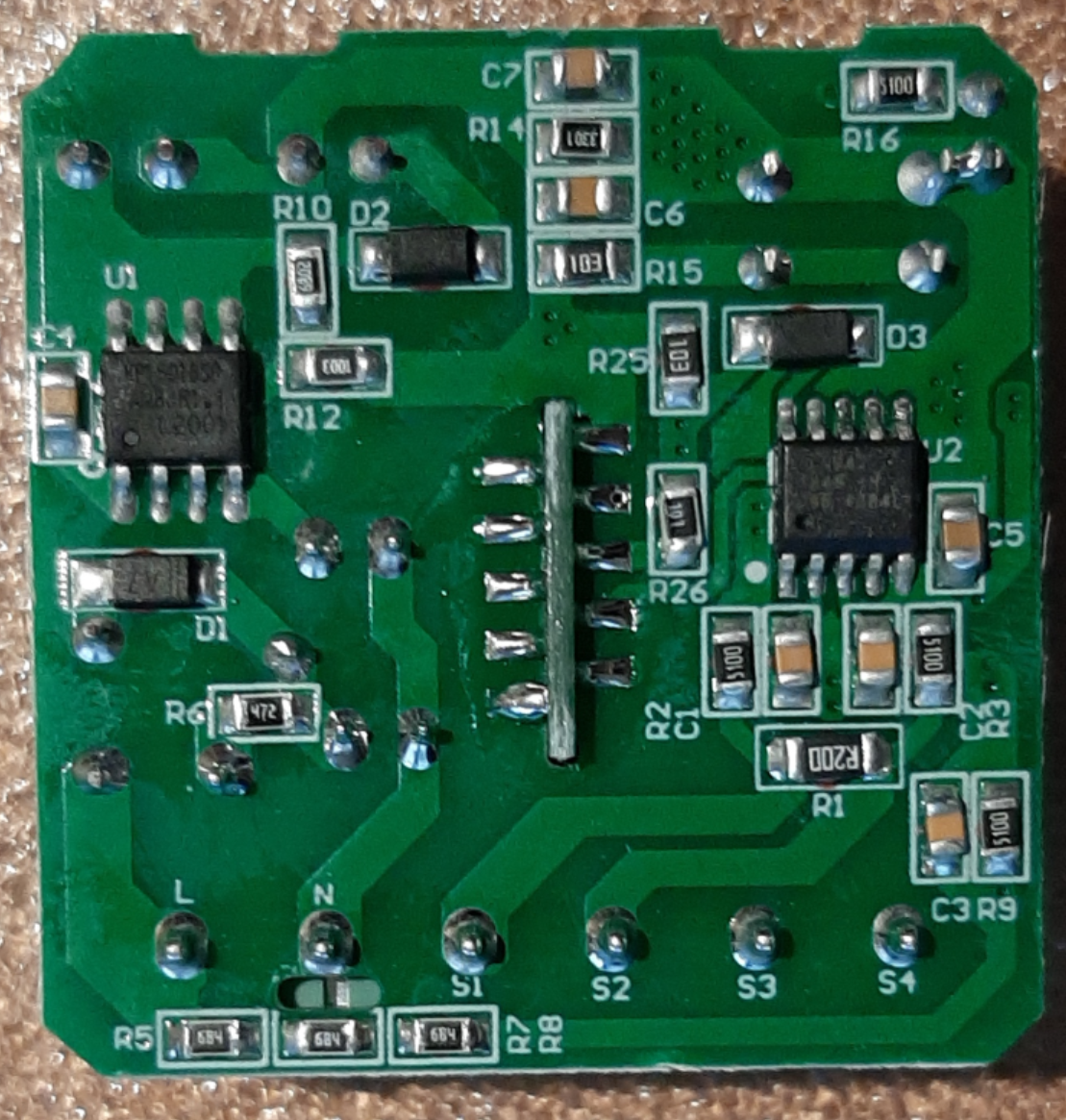

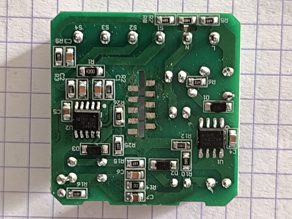

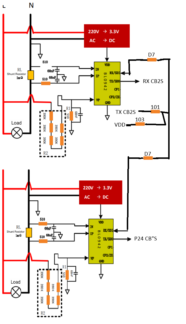

    #7 21762729
    josemr
    Posts: 10
    Good morning.

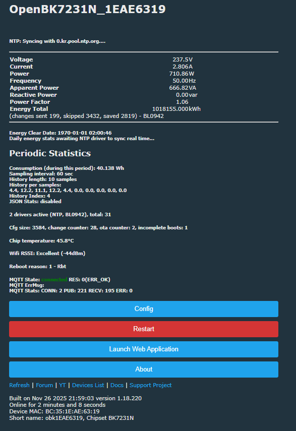

    I have this meter and I installed the OpenBK7231N_UG_1.18.47 firmware, but it only shows one meter reading.
    I also installed the OpenBK7231N_1.18.217 firmware, and the same thing happens: only one meter appears.
    I traced the circuits to both BL0942 transistors, and both have their TX and RX pins connected to the TX and RX pins of the CB2S.
    How can I get readings from both clamps?
    logtype none
    BL0942opts 3
    startDriver BL0942
    startDriver NTP
    ntp_timeZoneOfs 2:00
    SetupEnergyStats 1 60 5
    ntp_setServer 0.kr.pool.ntp.org
    Thank you

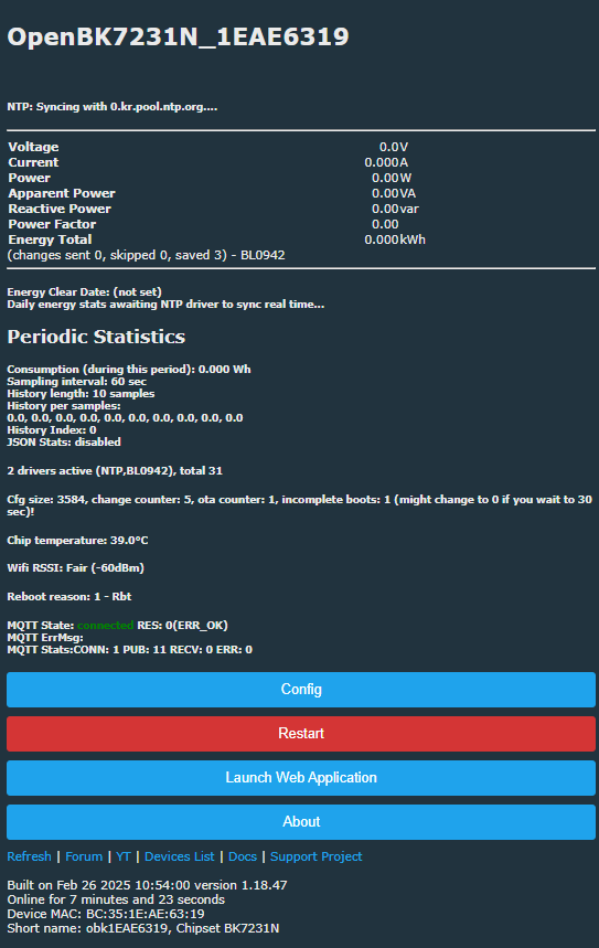

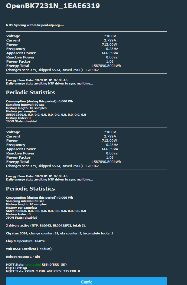

    #10 21763803
    josemr
    Posts: 10
    Good morning.
    I've run several tests.
    The first was with startDriver BL0942. I calibrated the BL0942, and it only gave me the result for one clamp (read the result of clamp number 2).
    Diagnostic panel of OpenBK with BL0942 data, showing power parameters and periodic stats.
    The second was with startDriver BL0942SPI. I calibrated the BL0942, and it gave me the result for both clamps, but it's not calculating the parameters correctly.
    Screenshot of OpenBK7231N interface showing BL0942 sensor data
    I don't know where to go from here. Any help would be appreciated.
    Added after 2 [hours] 15 [minutes]:
    Hello again.
    I've tried compiling a binary with ENABLE_BL_TWIN must be enabled.
    I'm unable to do so.
    I need a binary compiled with ENABLE_BL_TWIN must be enabled.
    How can I achieve this?
    Thanks

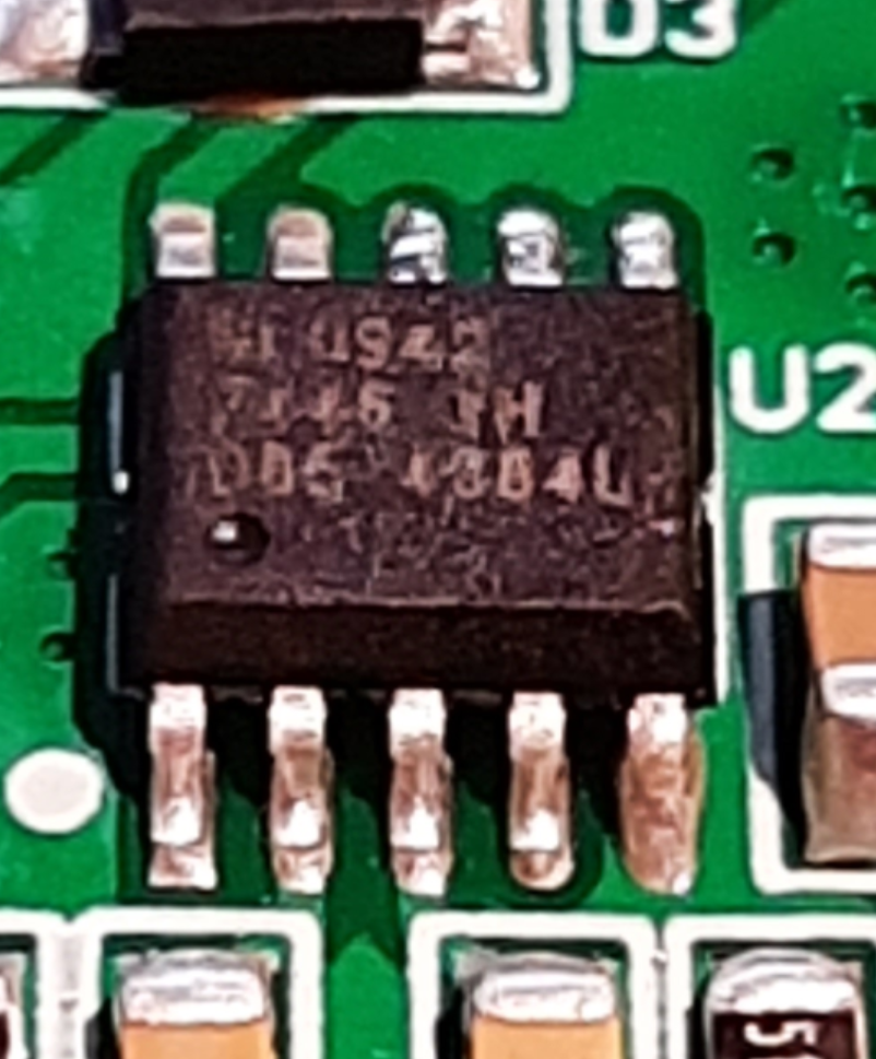

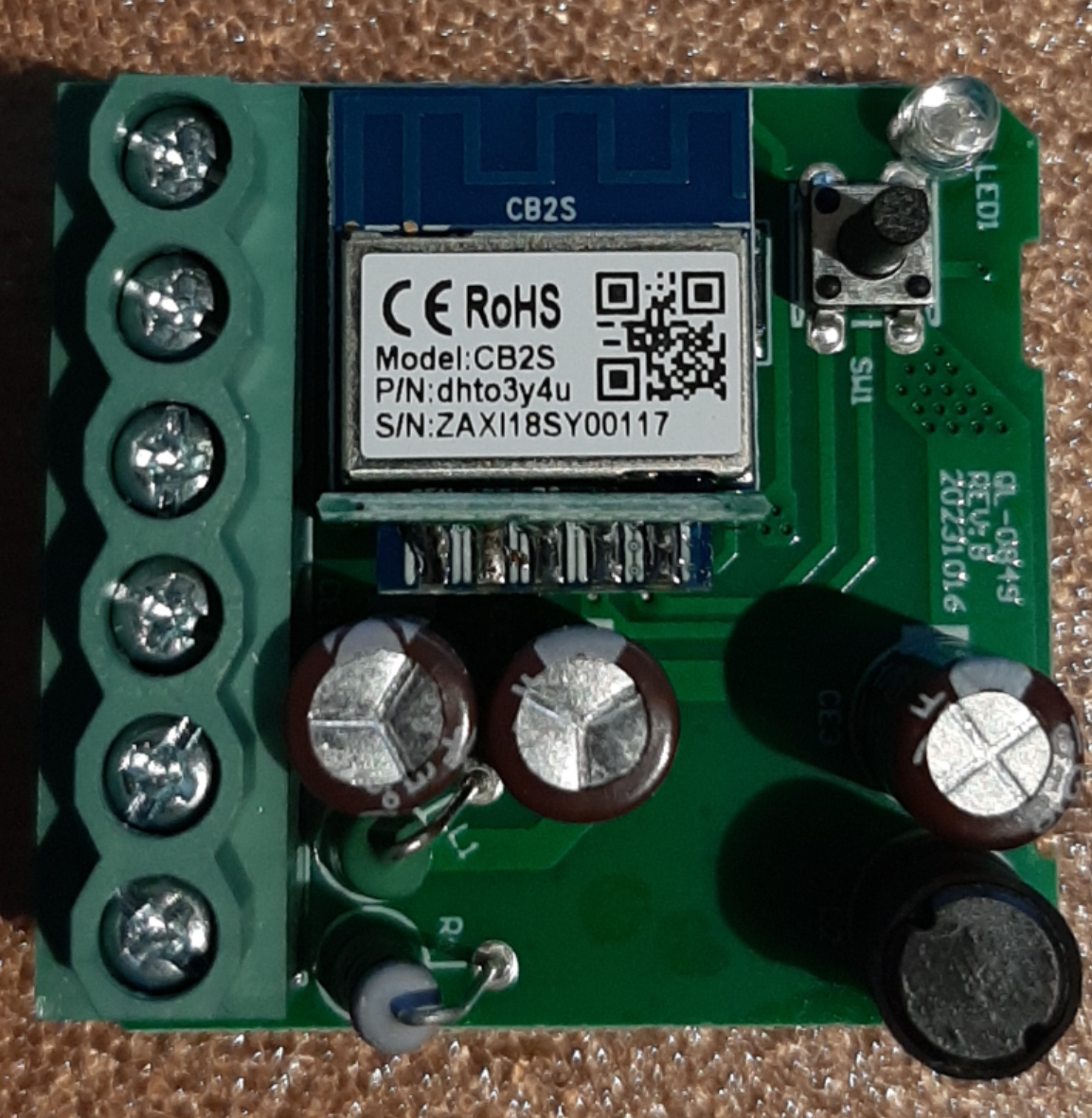

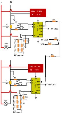

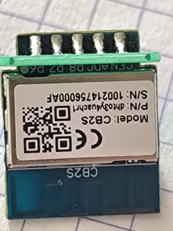

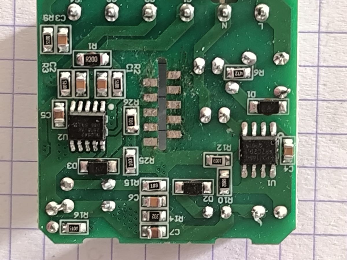

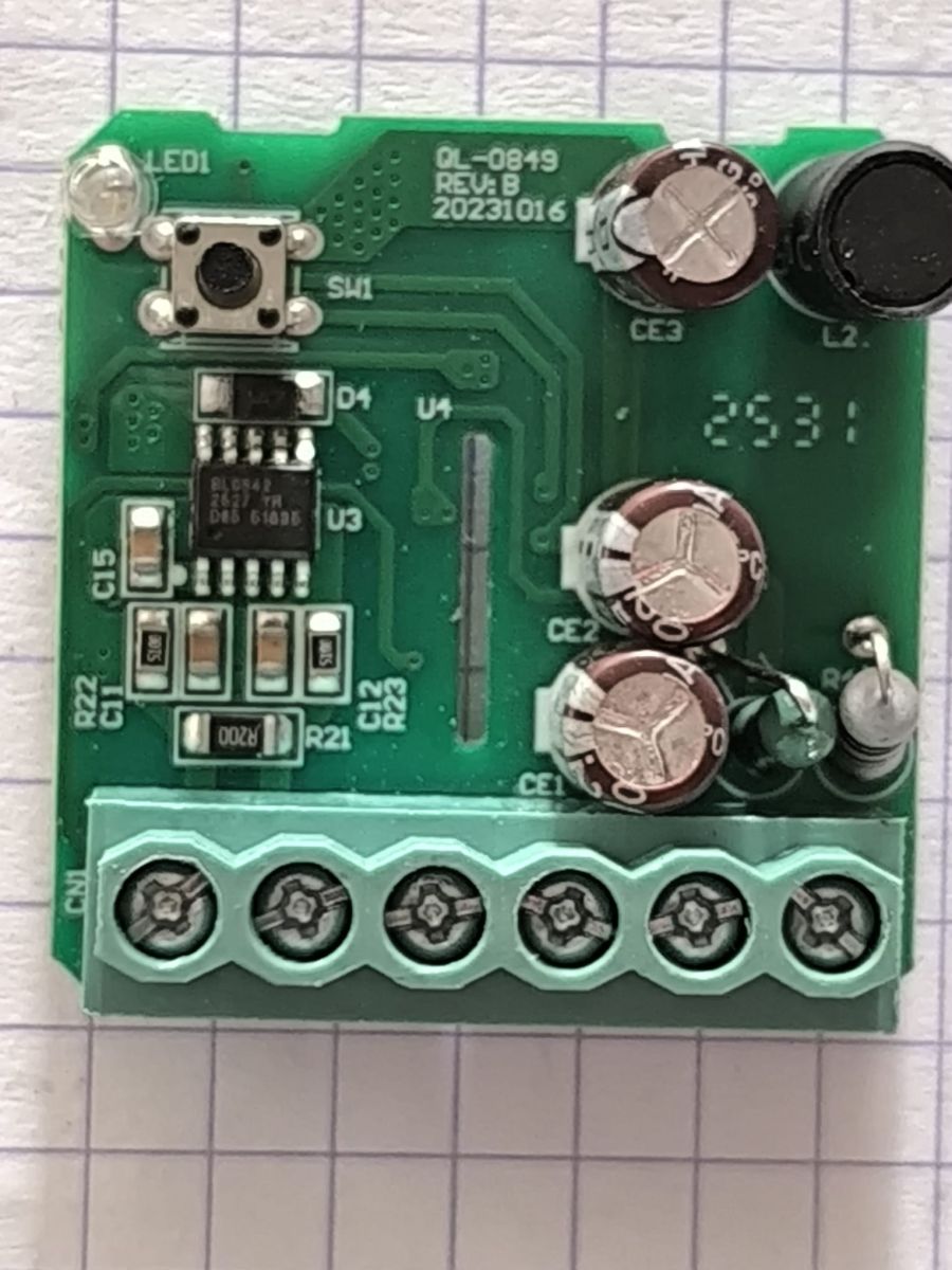

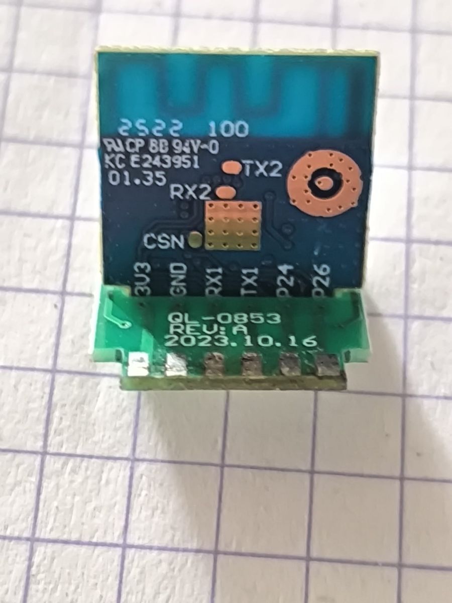

    #12 21764305
    josemr
    Posts: 10
    >>21764249 Hello, toufou54
    Thank you for your detailed response.

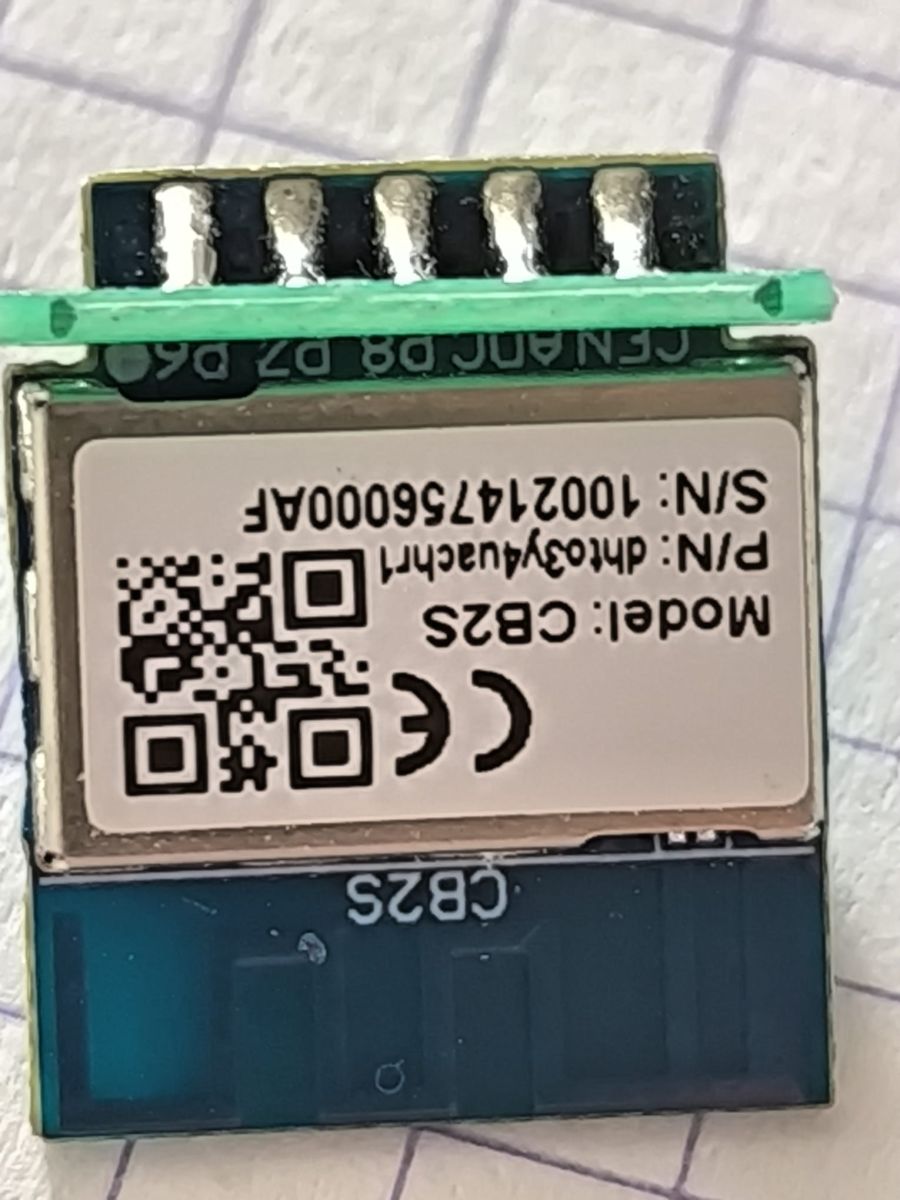

    The TX pins of the BL0942 are shared with the RX pins of the CB2S. One RX pin of the BL0942 connects to the TX pin of the CB2S, and the second RX pin of the BL0942 connects to pin P24 of the CB2S.
    Button P6 and led P7 the CB2S.
    Diagram of two BL0942 chips sharing UART with CB2S module
    Close-up of a PCB with BL0942 chip, capacitors, and screw terminal block
    CB2S module with visible pins labeled TX2, RX2, TX1, RX1, and P24
    Close-up of a PCB with two ICs and various surface-mounted components
    PCB with two IC chips, visible traces, resistors, and labeled components on grid background.
    CB2S module with visible pins and model marking on the label
    Could you explain how to send feature requests to firmware projects for dual BL0942 compatibility on a shared UART? Sorry for the English; it's a Google translation.
    Thank you.

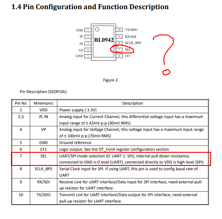

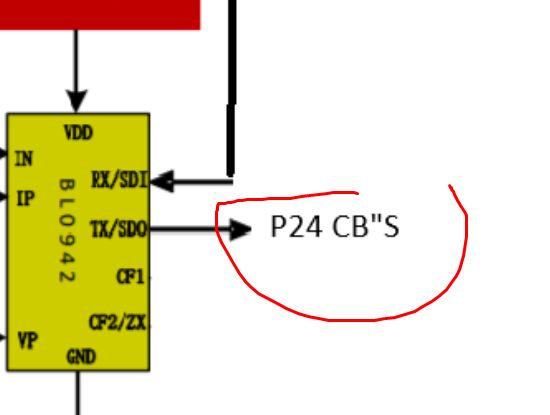

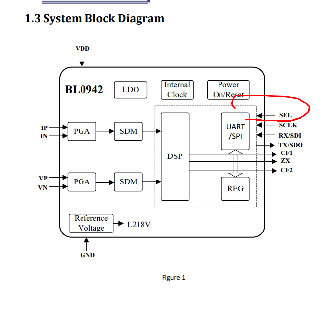

    Posts: 14771
    Rate: 12914
    i see, so that's new to me. I haven't seen that kind of connection yet.
    Your best chance is probably to use this modification and just alter code to work fon your pins:
    https://github.com/search?q=repo%3Aopenshwpro...penBK7231T_App%20ENABLE_BL_TWIN&type=code
    But I am suprised. Are you sure about P24?

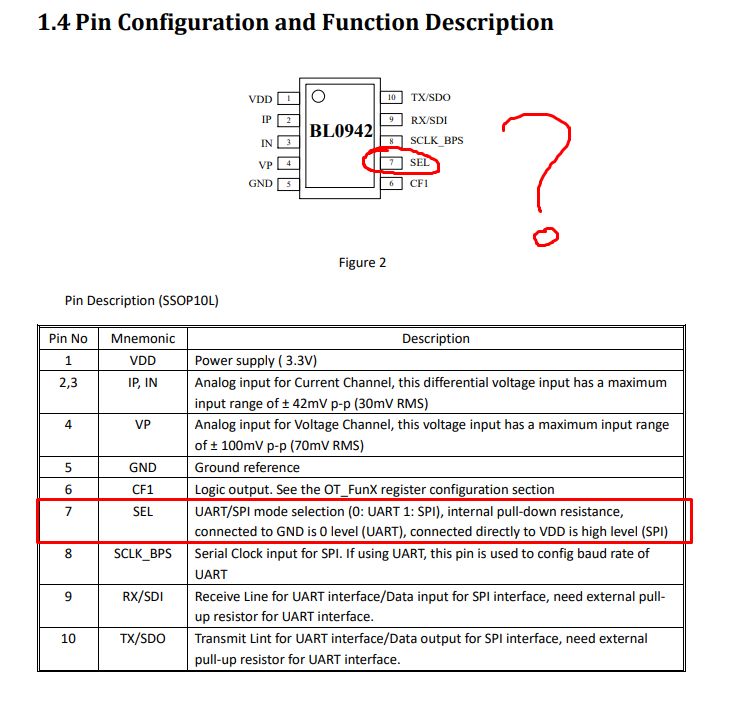

    Part of an electronic schematic showing a BL0942 chip and label “P24 CBS”
    These are UART pins:
    6	P10/UART1_RXD
    27	P11/UART1_TXD
    28	P1/UART2_RXD/I2C2_SDA
    29	P0/UART2_TXD/I2C2_SCL
    P24 is not UART at all. So.... is this even UART? Or maybe SPI? Software SPI?
    How is SEL connected?
    Block diagram of BL0942 chip with UART/SPI interface and labeled output pins
    Diagram of BL0942 with pin 7 SEL highlighted and function table explaining its use
  • #15 21766332
    josemr
    Posts: 10
    >>21766295
    SEL ---------------not connected
    CF1--------------not connected
    SCLK_BPS-------not connected
    TX----------------P24 CB2S
    RX----------------TX CB2S
    TX----------------RX CB2S
    The provided link is unavailable.
    Thank you
  • #16 21766368
    Posts: 14771
    Rate: 12914
    So we would need a software UART? Very strange. @insmod any insights?

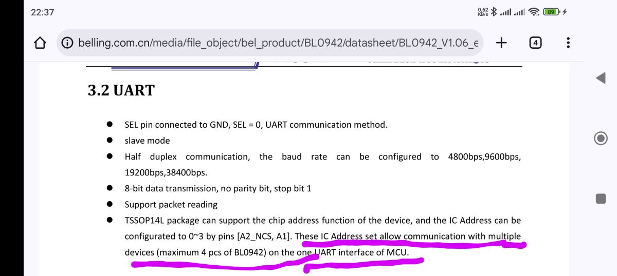

  • #17 21766371
    josemr
    Posts: 10
    >>21766368
    Screenshot of UART documentation with highlighted text about IC address settings
    Is it possible two BL0942 in one UART?
    I have the original backup and another device with the firmware unchanged, in case that's helpful.
  • #18 21766444
    Posts: 14771
    Rate: 12914
    Are your BL0942 in TSSOP14L package (14 pins)?
  • #19 21766510
    josemr
    Posts: 10
    Good morning.
    Please excuse my ignorance.
    BL0942 is a TSSOP-10 (10 pins).
    I looked up the datasheet and thought of that solution, but I see now that it's for a TSSOP-14L.
    If you're interested in this project, I'd be happy to help.
    My electronics and programming skills are very basic.
    I can't even manage to change the ENABLE_BL_TWIN setting and compile to run tests.
    Thank you for your help.

    This energy meter has two BL0942 chips, but they are not connected to the two UARTs of the CB2S. The TX pins of the BL0942 chips are shared with the RX pin of the CB2S. One RX pin of the BL0942 chip is connected to the TX pin of the CB2S, and the other RX pin of the second BL0942 chip is connected to pin P24 of the CB2S.
    The firmware with ENABLE_BL_TWIN enabled does not work on this meter.
    I'll try bridging UART2 to BL0942 and testing the firmware with ENABLE_BL_TWIN enabled.
    However, this solution wouldn't be feasible for those without soldering skills.
  • #22 21780930
    XJ_
    Posts: 141
    Help: 13
    Rate: 39
    >>21780804
    Maybe you can try changing BL0942_UART_ADDR from 0 to 1..3 to test if on the same UART the second BL0942 will respond instead of the first.
    I only noticed this now. So changing BL0942_UART_ADDR won't do anything, I think. It's only for the 14-pin version.
