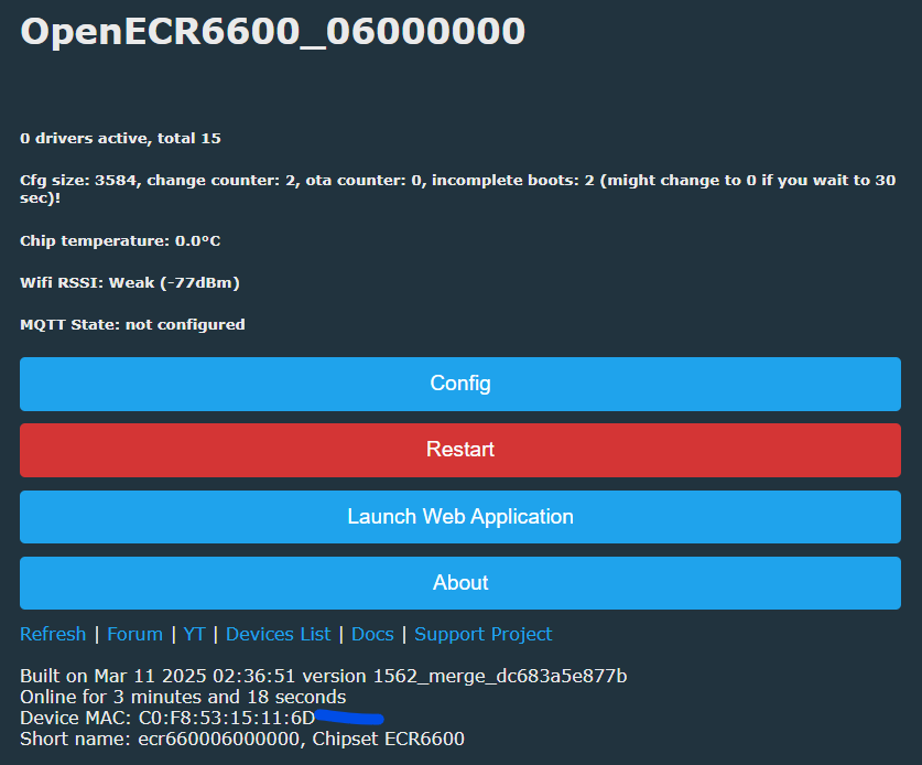

    insmod wrote:
    Do you plan on changing MAC address? Since it is stored on flash in nv_amt partition, it can be easily changed.
    no plans, but could do I suppose. I have changed it within OBK and it worked.

  • #32 21471943
    insmod
    Posts: 1407
    Help: 164
    Rate: 443
    >>21471135
    Since you've changed it within OBK, then it is changed in nv_amt.
    Your module performance seems to be worse than mine, because i can get it to connect and load gui through 2 walls and ~7m to AP, though only if i'm holding it perpendicular to it. My AP is AX3600 with 23dBm tx power, ch13 20mhz with 25-30 neighbouring aps.

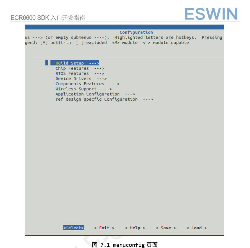

    It seems i just undefined CONFIG_ECR6600_DBGTRIM like in skylab, and that increased the size.
    After i redefined it, size dropped to 696kb.
    But even with it, there is a lot of free space, since updates are not A/B, but compressed ones.

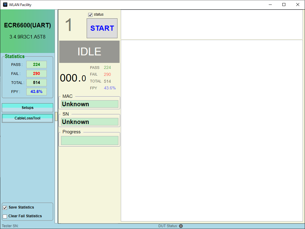

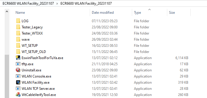

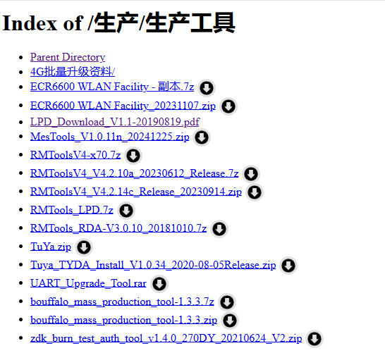

    went on a hunt last night for ECR6600 treasure. Not sure I've found anything but there are a ton of resources here http://ftp.hi-flying.com:9000/
    including some ECR6600 stuff which is where I started http://ftp.hi-flying.com:9000/%E7%94%9F%E4%BA%A7/%E7%94%9F%E4%BA%A7%E5%B7%A5%E5%85%B7/
    Directory index with Chinese file names for download.
    eg ECR6600 WLAN Facility executables
    Screenshot of a folder with a list of files and folders in Windows.
    other resources in there for BL602, RDA5981. looks old though
    don't really know what to do with a lot of the stuff
    Screenshot of WLAN Facility software displaying test statistics and device status.

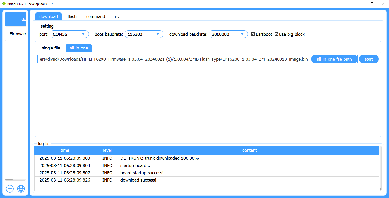

    They supply some firmware for that module which was build using that SDK ver
    http://www.hi-flying.com/download-item-hf-lpt62x0-firmware
    OTAd from OpenECR6600 to LPT6200_1.03.04_UPGRADE_4M_20240813.bin and then it just outputs this on boot. Not sure what this fw does.
    I had already made contact with HF asking for full SDK access.

    >>21474737 You ota'd to 4mb firmware. We only have 2mb.
    Try attached one.

    ha. of course. had they were 4mb in my head. same result for that file

    Perhaps log outputs to different port? It should boot at least, even if it shouldn't work normally because of some missing partitions.
  • #45 21474750
    Posts: 5089
    Help: 441
    Rate: 900
    did try other TXs. well, IO6, IO22, IO13, IO0 and IO2 @115200
    also tried this as AIO to same result
    Screenshot of RDTool V1.0.21 showing firmware downloading and flashing process.
    I'm hunting for my spare ipex connector aerials - not seeing anything broadcast from it with the HF firmware I don't think. Though you'd expect their calib to be OK anyway surely?

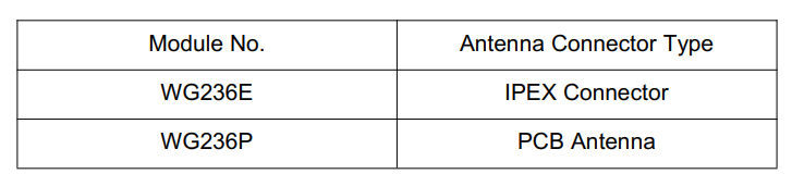

    I wonder if our PCB antennas are connected. It looks it's all there - I think. Could try tracing I guess. The datasheet seems to suggest it's one or the other though
    Table showing module numbers and antenna connector types.

    >>21474786 I soldered an ipex to one module, and i did have to remove resistor and connecting ipex side with a blob before it worked.

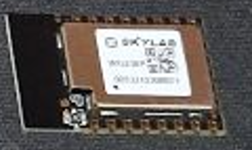

    >>21474786

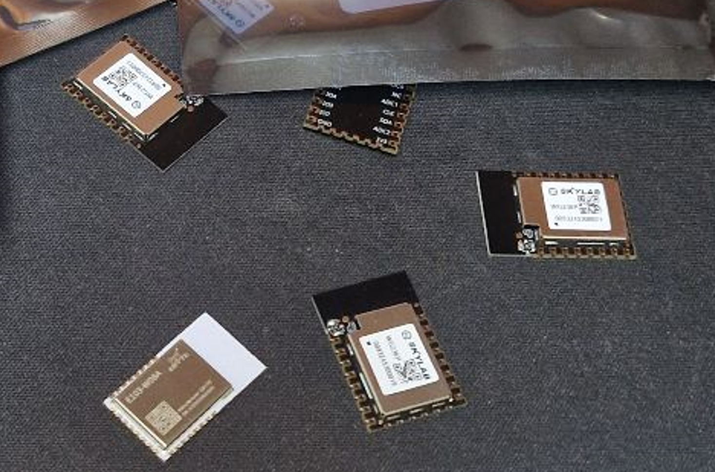

    but then the label on my modules say WG236A.
    I have this pic from @DeDaMrAz which I think are his ECR6600s. They don't look to have ipex connectors, so I wonder if his experiences with wifi signal are the same
    Skylab electronic modules with printed QR codes on a dark background.
    and this looks like a "P"
    Electronic module with Skylab branding and markings.
    maybe I could trouble him for a better hi-res pic

    >>21474808 I didn't either, i soldered IPEX instead of intended MHF4. So i had to solder only one side, and when i removed the antenna, all of it except central part ripped off as well.

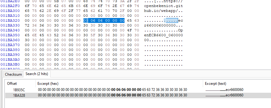

    Added after 8 [hours] 43 [minutes]:
    Playing. some notes:
    erase flash
    flash OpenECR6600 AIO to 0x0
    boot
    readback to 2mb file
    generic mac seen at:
    Screenshot showing a section of hex memory analysis with a selected address.
    set mac manually in OBK. mac then seen at 1FE308
    Table snippet with entries 0x001F E000 and NV AMT (8KB) and RF values.
    copy Tuya ECR6600 dump from 1FE000-1FFFFF and transplant into 2mb OBK dump.
    picked up Tuya mac but wifi no better

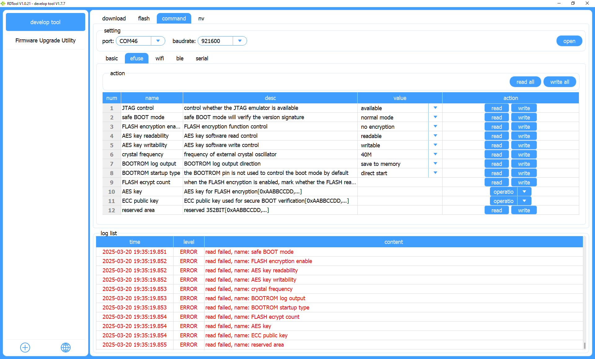

    also. have you ever got the efuse read to work? I've tried with and without stubs of various versions
    Interface of a firmware upgrade tool with a list of settings and errors.

    >>21488355
    You need AT to read those
    Checked menuconfig, but found nothing worthwhile.
