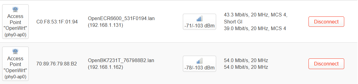

Nie, dziękuję Przekieruj mnie tamMaximilian0017 wrote:and the wifi was really bad

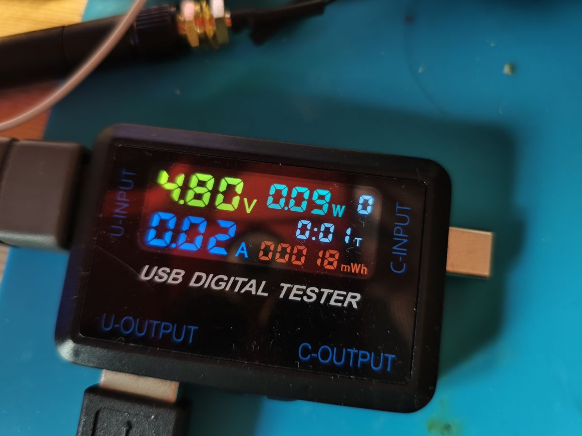

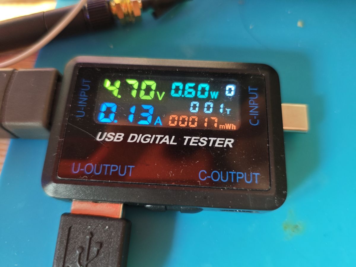

Added ECR6600 and BL602 deepsleep (ECR6600 - unknown if it works with new sdk, it didn't in the old one).
BL602 pindeepsleep (GPIO7/8 only)
ESP-IDF sdk from v5.5-beta1 to v5.5
Powersave for ECR6600
ESP deepsleep argument from ms to s

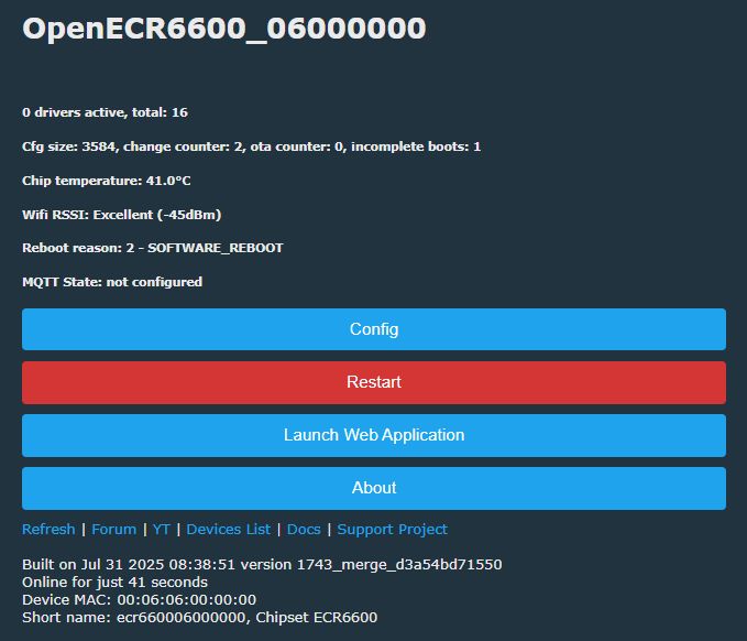

ECR6600 reset reason
divadiow wrote:powersave 1 doesn't crash but don't know if it's effective
insmod wrote:So it can connect after deep sleep?
divadiow wrote:I can check later today..

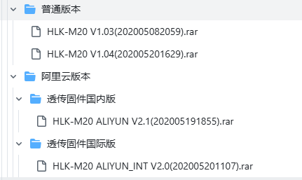

insmod wrote:I tried 3 different bootloaders (they differ a little, HLK-M20, ELM327 and standard nocrc), but none succeeded.

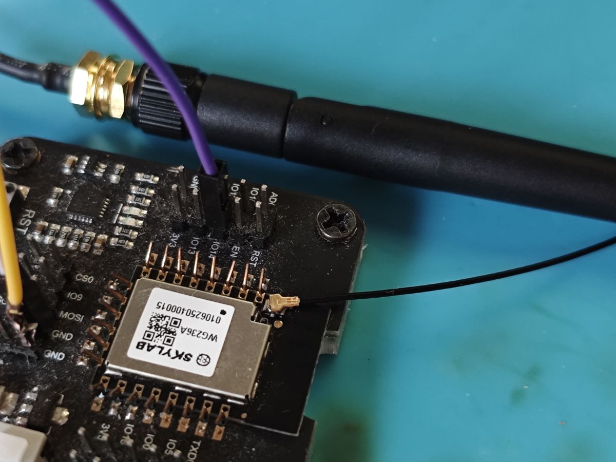

| WG236A test modules | Good for bench testing and SDK work | Reported weak receive performance on some units | Mixed results |
