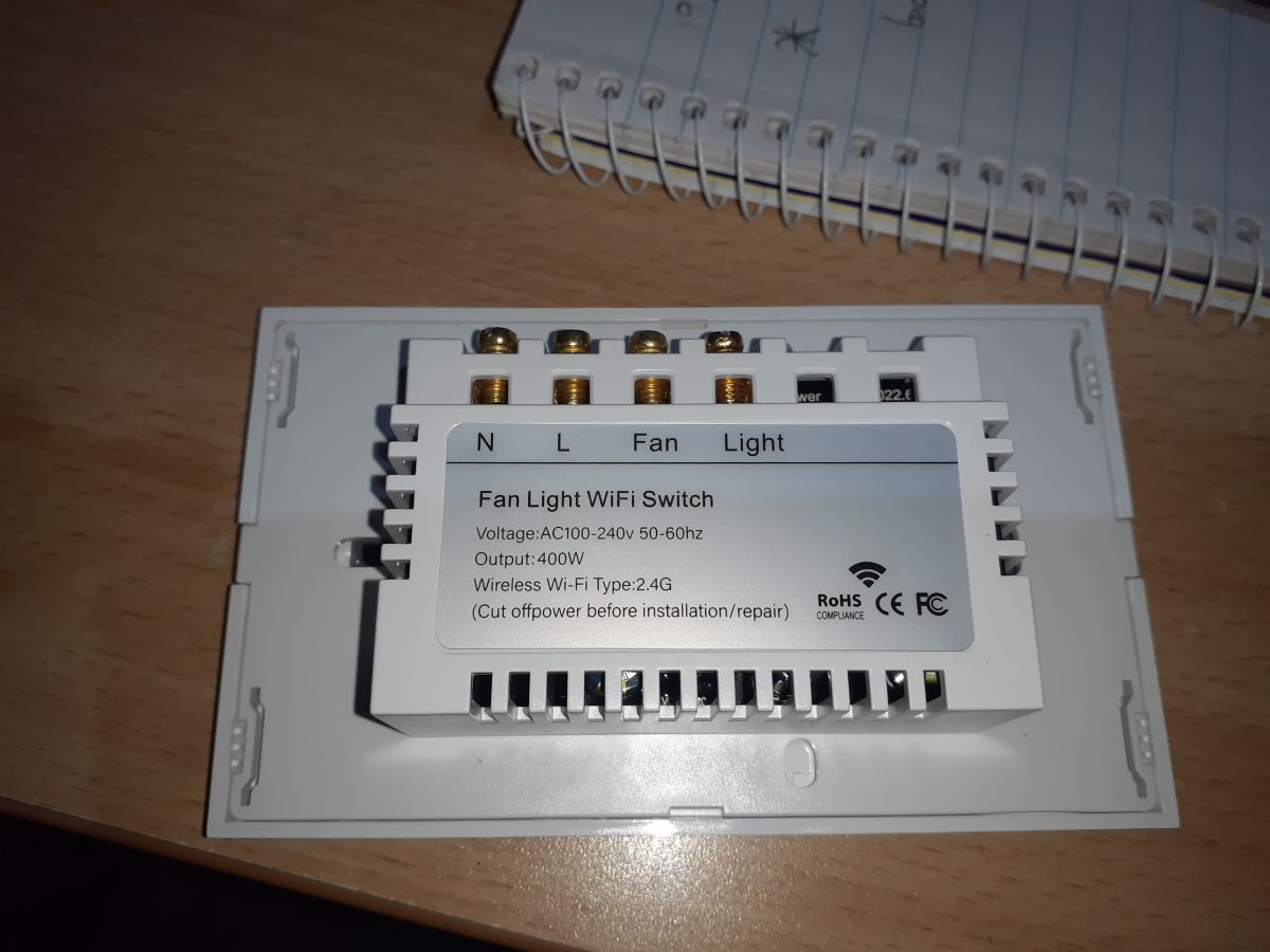

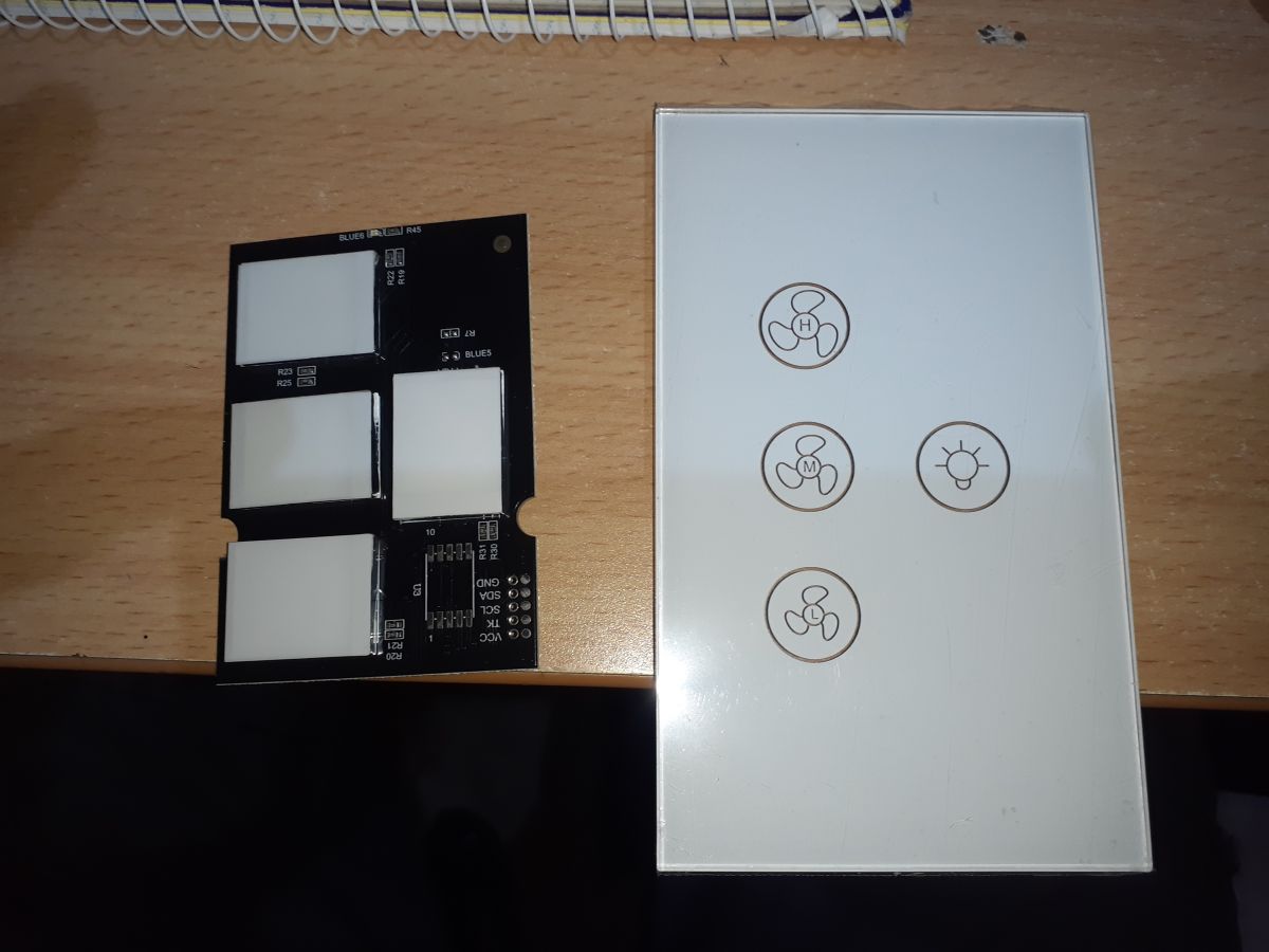

    Latest purchase, wanted a light/fan switch for a ceiling fan but alas the fan controller is PWM and the ceiling fan is noisy.
    I'm going to try it on a bathroom extractor fan instead.
    Smart touch switch packaging with text and a label.
    Fan control panel and PCB board.
    WiFi switch for light and fan with labels N, L, Fan, Light against a notebook background.

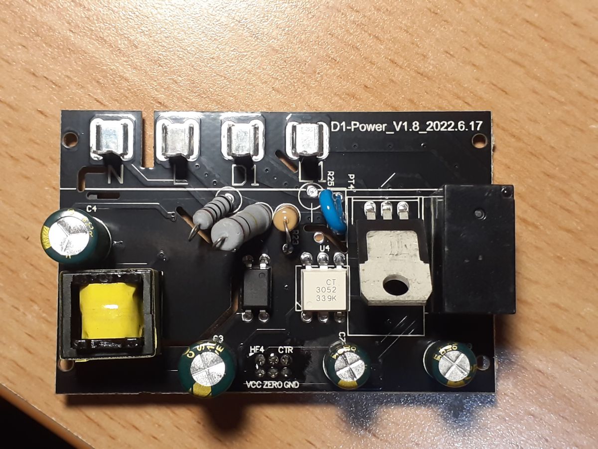

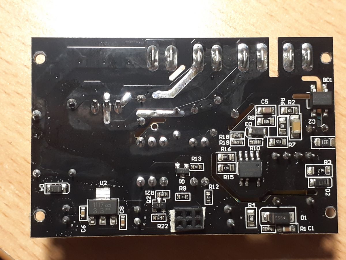

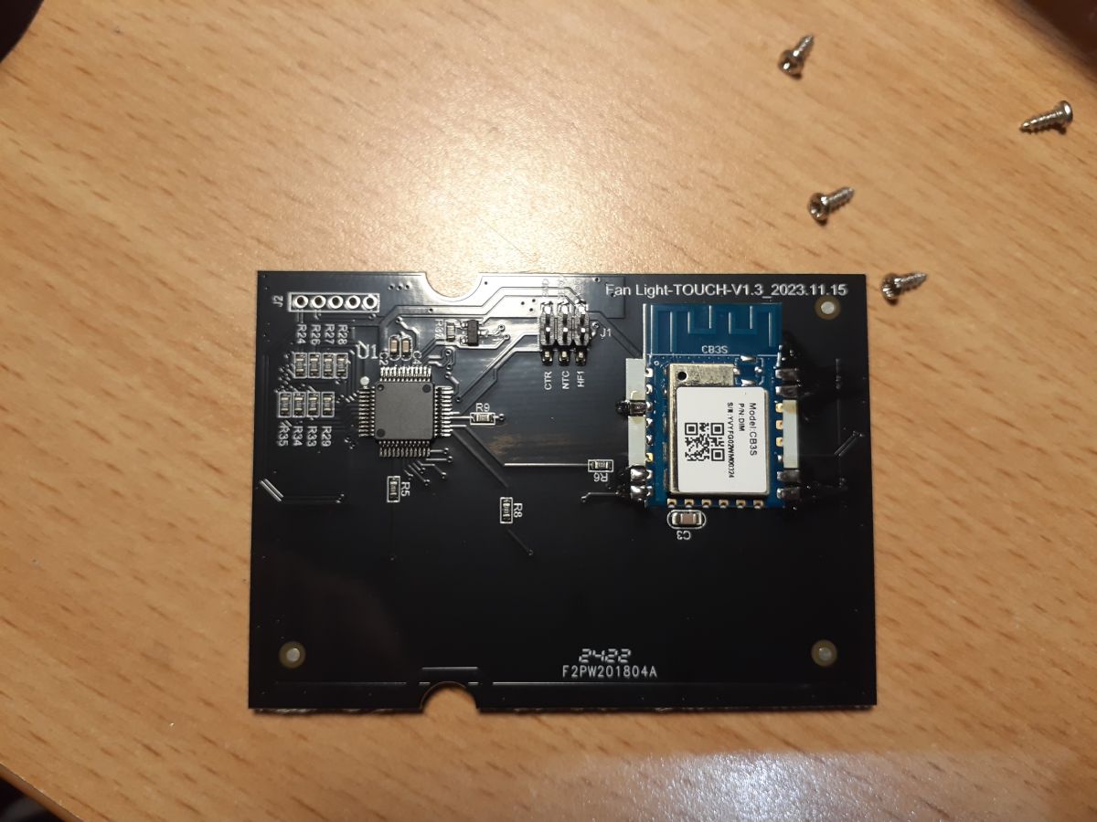

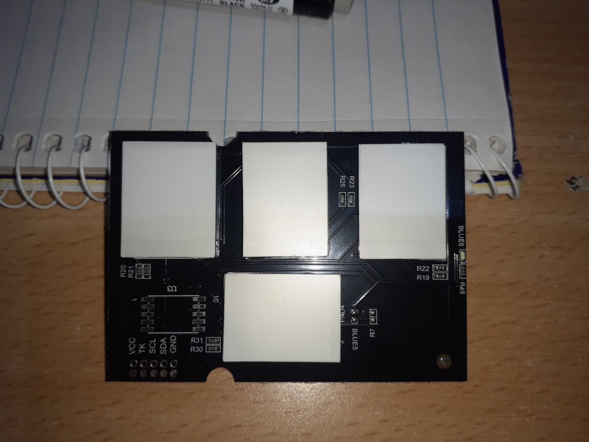

    Photo's of the board
    Close-up of a circuit board with a mounted integrated circuit.
    PCB with CB3S module and TuyaMCU chip on a wooden surface.
    Close-up of a circuit board with several white insulated areas.
    Photo of the back of an electronic circuit board with various components.
    Printed circuit board with electronic components.
    Features a CB3S with TuyaMCU chip that appears to have the ID scrapped off.
    Does require removing the CB3S for flashing.

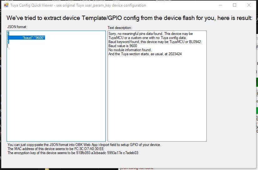

    Stock firmware attached.
    Template only reports baud rate of "9600"
    A window with software for extracting Tuya device configuration, showing baud rate 9600.

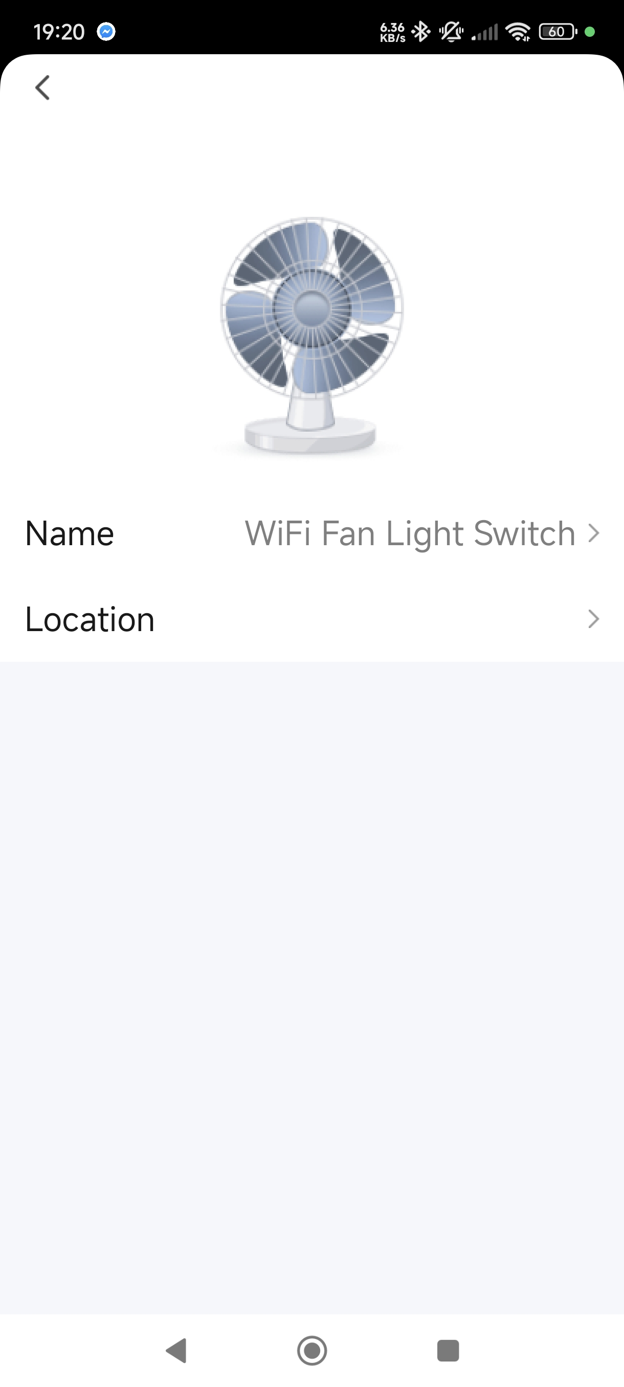

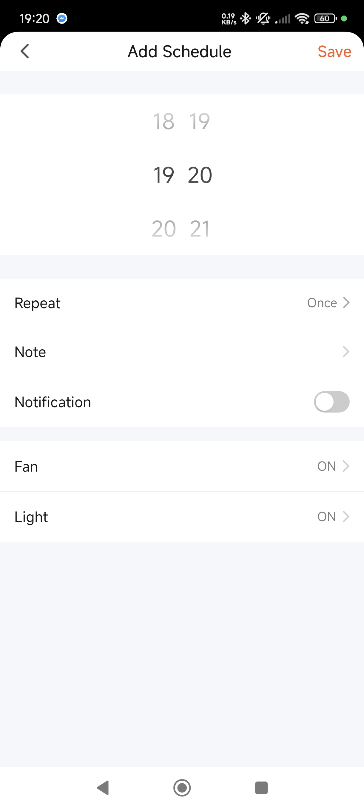

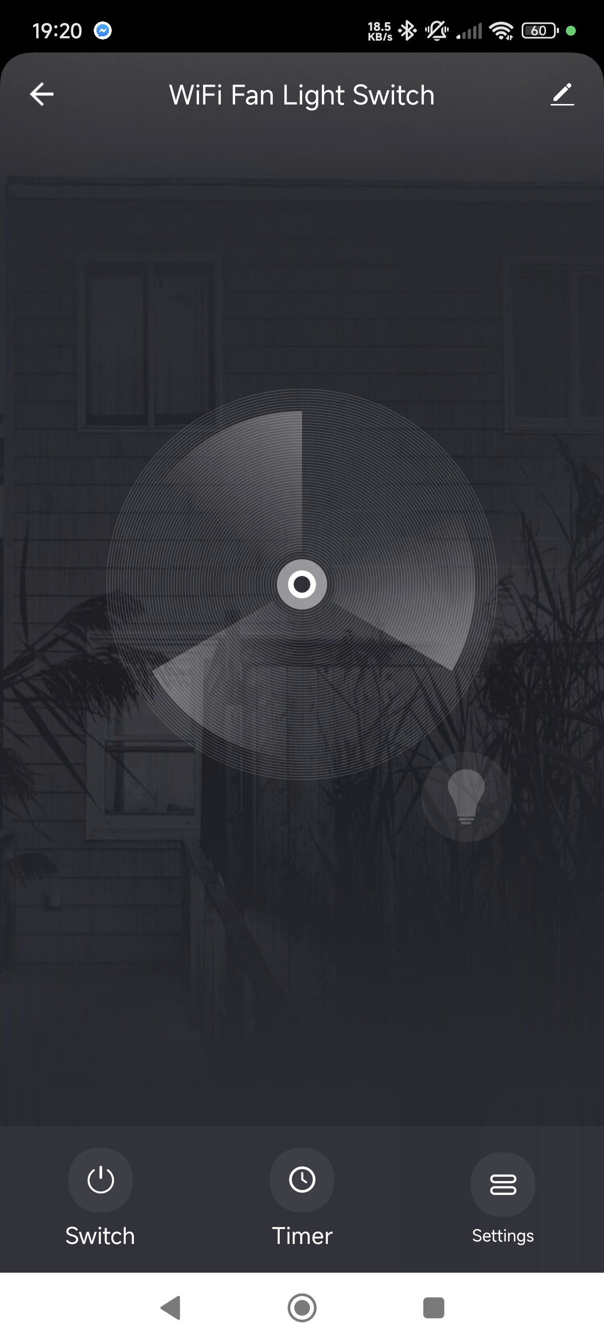

    is there anything existing in the autoexec examples that would suit?

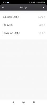

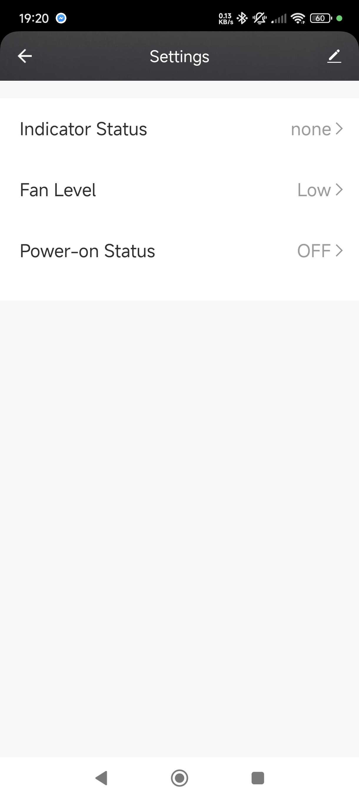

    I have flashed your firmware and paired it. The dpID info are this according to Tuya
    additionally, for the records, here is an unpaired device boot log
    Firmware version 2.1.17 so not cloudcutter exploitable.
    Paired Tuya app pics
    Screenshot of the Tuya app displaying the WiFi Fan Light Switch device. An app interface featuring a switch for controlling a WiFi fan and light.App schedule setting screen with time selection and options to turn on fan and light. Tuya app screen showing settings for indicator status, fan level, and power-on status.
  • Fan and light toggles work, variable fields do not

    //power save function
    PowerSave 1
    // Start TuyaMCu driver
    startDriver TuyaMCU
    // set TuyaMCU baud rate
    tuyaMcu_setBaudRate 9600
    // set TuyaMCU default wifi state 0x04, which means "paired",
    // because some TuyaMCU MCUs will not report all data
    // unless they think they are connected to cloud
    tuyaMcu_defWiFiState 4
    // Fan on/off
    setChannelLabel 1 "fan"
    setChannelType 1 Toggle
    linkTuyaMCUOutputToChannel 1 1 1
    // Light on/off
    setChannelLabel 2 "Light"
    setChannelType 2 Toggle
    linkTuyaMCUOutputToChannel 15 1 2
    // Indicator Light Mode
    setChannelLabel 3 "Light Mode"
    setChannelType 3 OffDimBright
    linkTuyaMCUOutputToChannel 101 4 3
    // Fan speed Level
    setChannelLabel 4 "speed"
    setChannelType 4 LowMidHigh
    linkTuyaMCUOutputToChannel 102 4 4
    // Power on state
    setChannelLabel 5 "Power-On State"
    setChannelType 5 OffOnRemember
    linkTuyaMCUOutputToChannel 103 4 5
    Cheers for the help :)

  • #8 21419342
    tonyb62
    Posts: 37
    >>21418084 Jumped the gun, only fan and light switches show up in Home Assistant after using OpenBK discovery.
    The fan speed, switch lumination and power on toggles are not shown.
    https://www.elektroda.com/rtvforum/topic3895301.html - Does have a possible example to use to add these to Home Assistant.
  • #9 21431543
    tonyb62
    Posts: 37
    Is there a reason why in openBK for this device now it is set up and working it doesn't fully display all controls to Home Assistant when using discovery?
Discussion revolves around the integration and configuration of a touch smart switch compatible with the Smart Life app, specifically for controlling a ceiling fan and a bathroom extractor fan. The user encountered issues with PWM control causing noise in the ceiling fan and is exploring alternative uses. The switch features a TuyaMCU chip, and users are sharing experiences with firmware flashing, autoexec.bat configurations, and the challenges of getting all controls to display in Home Assistant. Key functionalities discussed include fan speed control, light toggling, and power-on state settings, with users providing code snippets and troubleshooting tips for successful integration.
