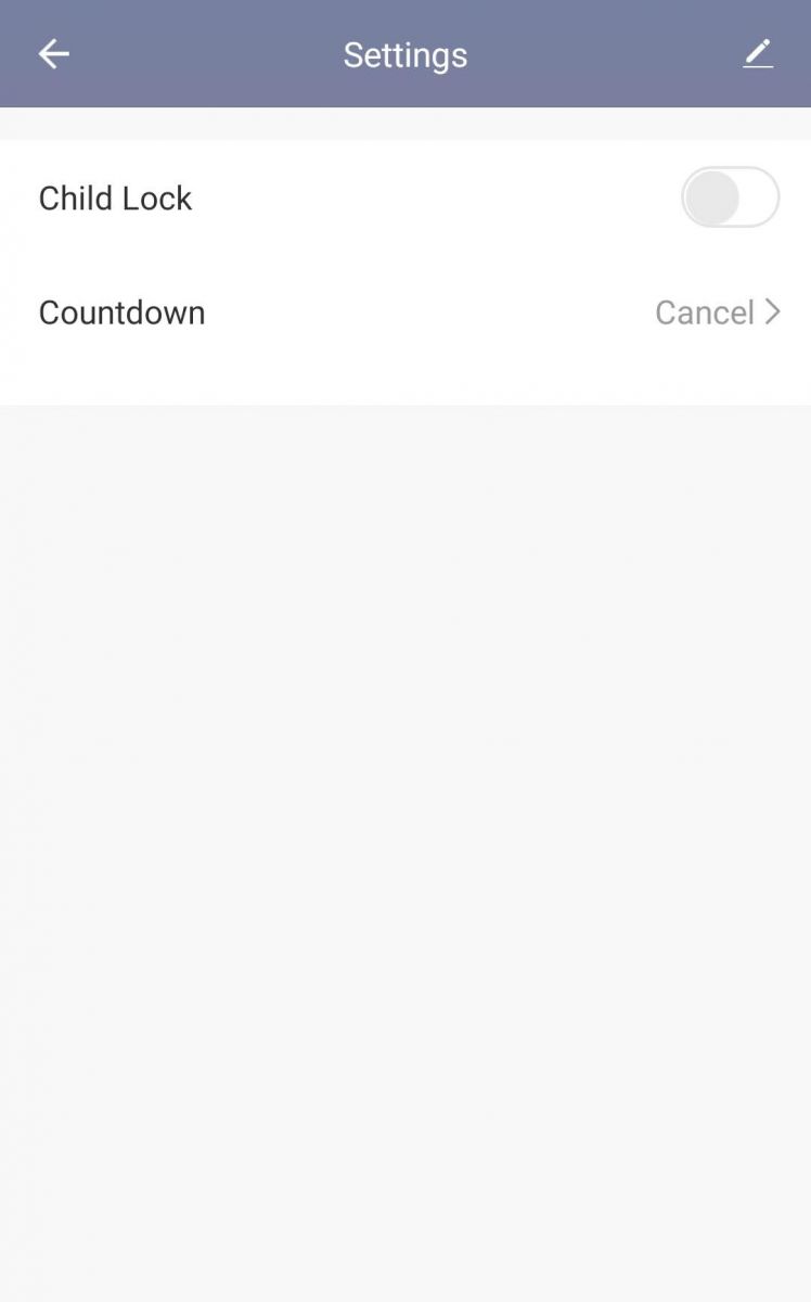

    Smart Life App Images
    Tuya 5 Speed Fan Controller by TEQOOZ - Home Assistant Tuya 5 Speed Fan Controller by TEQOOZ - Home Assistant Tuya 5 Speed Fan Controller by TEQOOZ - Home Assistant

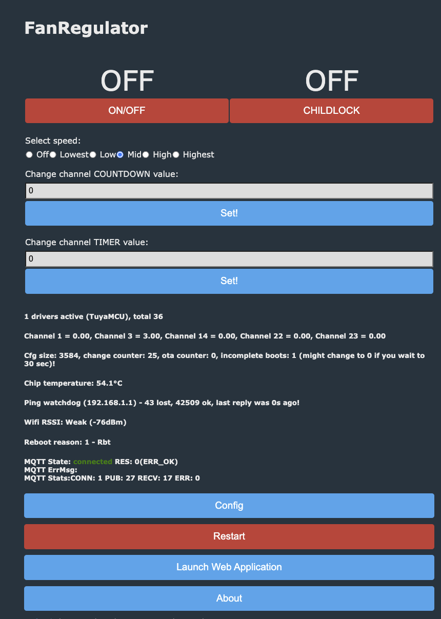

    Controller MCU: WB3S
    TuyaMCU: Unknown
    Darlington Transistor Array: ULN2003A

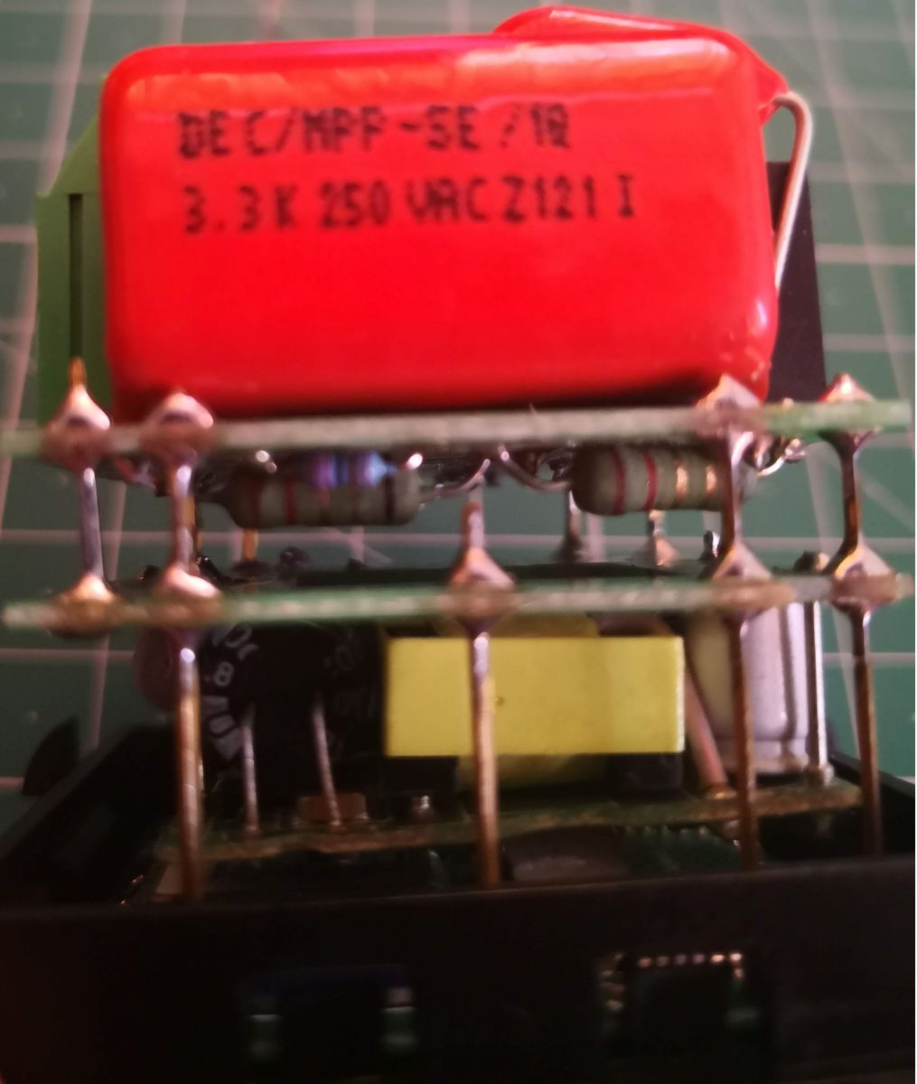

    Teardown Images
    Tuya 5 Speed Fan Controller by TEQOOZ - Home Assistant Tuya 5 Speed Fan Controller by TEQOOZ - Home Assistant Tuya 5 Speed Fan Controller by TEQOOZ - Home Assistant Tuya 5 Speed Fan Controller by TEQOOZ - Home Assistant Tuya 5 Speed Fan Controller by TEQOOZ - Home Assistant Tuya 5 Speed Fan Controller by TEQOOZ - Home Assistant Tuya 5 Speed Fan Controller by TEQOOZ - Home Assistant Tuya 5 Speed Fan Controller by TEQOOZ - Home Assistant Tuya 5 Speed Fan Controller by TEQOOZ - Home Assistant Tuya 5 Speed Fan Controller by TEQOOZ - Home Assistant Tuya 5 Speed Fan Controller by TEQOOZ - Home Assistant Tuya 5 Speed Fan Controller by TEQOOZ - Home Assistant Tuya 5 Speed Fan Controller by TEQOOZ - Home Assistant Tuya 5 Speed Fan Controller by TEQOOZ - Home Assistant [img-14] Tuya 5 Speed Fan Controller by TEQOOZ - Home Assistant

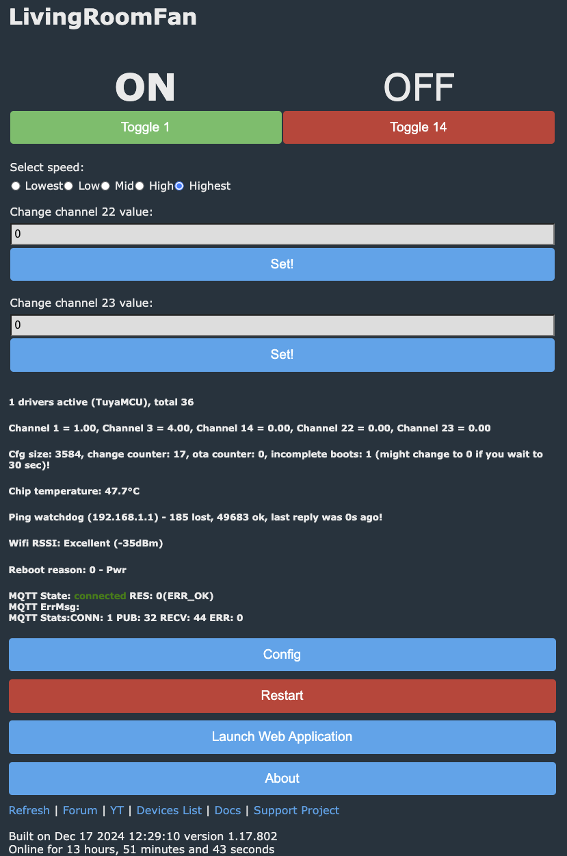

    Preparing to Flash
    Download the firmware bin file from here https://github.com/openshwprojects/OpenBK7231T_App, min version 1.11.1
    WB3S TX and RX is connected to the TuyaMCU which interfaces during the upload process so need to isolate it. I cut the 3.3v power trace of WB3S and soldered a wire directly to the 3.3V pin of WB3S, Please check the below image

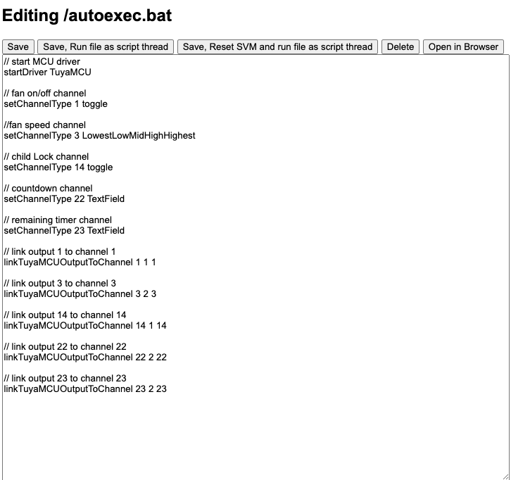

    Create a file call autoexec.bat with below content
    // start MCU driver
    startDriver TuyaMCU
    // fan on/off channel
    setChannelType 1 toggle
    //fan speed channel
    setChannelType 3 OffLowestLowMidHighHighest
    // child Lock channel
    setChannelType 14 toggle
    // countdown channel
    setChannelType 22 TextField
    // remaining timer channel
    setChannelType 23 TextField
    // link output 1 to channel 1
    linkTuyaMCUOutputToChannel 1 1 1
    // link output 3 to channel 3
    linkTuyaMCUOutputToChannel 3 2 3
    // link output 14 to channel 14
    linkTuyaMCUOutputToChannel 14 1 14
    // link output 22 to channel 22
    linkTuyaMCUOutputToChannel 22 2 22
    // link output 23 to channel 23
    linkTuyaMCUOutputToChannel 23 2 23

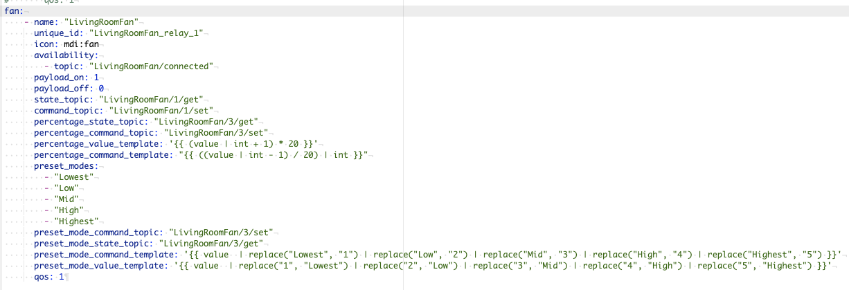

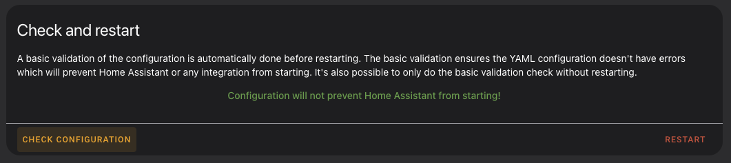

    Home Assistant Configuration
    mqtt:
      fan:
        - name: "obk-livingroom-2 Ceiling Fan"
          unique_id: "1216C29E_1"
          icon: mdi:ceiling-fan
          availability:
            - topic: "obk-livingroom-2/connected"
          state_topic: "obk-livingroom-2/1/get"
          command_topic: "obk-livingroom-2/1/set"
          payload_on: 1
          payload_off: 0
          percentage_state_topic: "obk-livingroom-2/3/get"
          percentage_value_template: >-
            {% if value == '0' %}
            0
            {% elif value == '1' %}
            10
            {% elif value == '2' %}
            30
            {% elif value == '3' %}
            50
            {% elif value == '4' %}
            70
            {% else %}
            100
            {% endif %}
          percentage_command_topic: "obk-livingroom-2/3/set"
          percentage_command_template: >-
            {% if value <= 1 %}
            0
            {% elif value > 1 and value < 20 %}
            1
            {% elif value >= 20 and value < 40 %}
            2
            {% elif value >= 40 and value < 60 %}
            3
            {% elif value >= 60 and value < 80 %}
            4
            {% else %}
            5
            {% endif %}
          qos: 1
          retain: true

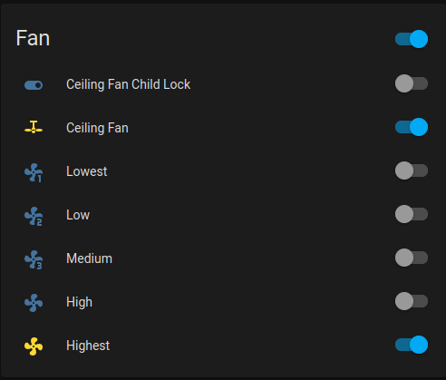

    Home Assistant Automation
    alias: 'Living Room : Capture Ceiling Fan Speed'
    description: ''
    trigger:
      - platform: mqtt
        topic: obk-livingroom-2/3/get
    condition:
      - condition: template
        value_template: '{{ trigger.payload | int > -1 }}'
    action:
      - service: input_number.set_value
        data:
          value: '{{ trigger.payload | int }}'
        target:
          entity_id: input_number.living_room_ceiling_fan_speed
    mode: restart

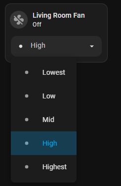

    Home Assistant Dashboard

    Hello @deepakbluru , for this device you need to create autoexec.bat, do you know how?

    The procedure of autoexec.bat file scripting for TuyaMCU devices is described in detail here:

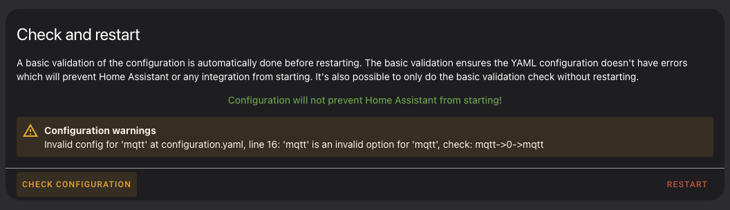

    gavashkarraju
    >>20114003 Home Assistant Error
    Configuration warnings
    Invalid config for 'mqtt' at configuration.yaml, line 14: 'mqtt' is an invalid option for 'mqtt', check: mqtt->0->mqtt
  • #14 21336878
    Posts: 14466
    Help: 650
    Rate: 12480
    Didn't they change YAML syntax a bit since the first post was made?
  • #15 21341152
    gavashkarraju
    >>21336878 i am alter many time still same error Screenshot showing a configuration warning in Home Assistant related to a YAML file error.
    >>21336878 This is my config OpenBeken Firmware working very well but HA Mqtt yaml error User interface for FanRegulator with OpenBeken Firmware settings.

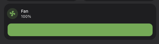

  • #16 21357864
    gavashkarraju
    am mqtt code simply way and working very well . Home Assistant Mushroom Fan card use 100%. no error for mqtt yaml check my all screen shots. Once again thankyou for all Openbeken Firmware Team, elektroda, Home Assistant and Mqtt etc....
    Script editor for autoexec.bat with configuration code for TuyaMCU devices. Fan control interface with options to turn on and off and set speed. Image showing a Home Assistant Mushroom Fan card set to 100%. Snippet of MQTT configuration code for a fan in Home Assistant. Screenshot with Check and restart message in Home Assistant.
  • #17 21796111
    ahzamali
    I was able get this working with only the following configuration in the AutoExec.bat
    // start MCU driver
    startDriver TuyaMCU
    linkTuyaMCUOutputToChannel 3 enum 3
    And the configuration in home assistant that worked are
      fan:
        - name: "Living Room Fan"
          unique_id: "living_room_fan_01"
          # --- POWER SECTION ---
          state_topic: "livingRoomFan/1/get"
          command_topic: "livingRoomFan/1/set"
          payload_on: "1"
          payload_off: "0"
          # --- SPEED SECTION ---
          speed_range_min: 1
          speed_range_max: 5
          percentage_state_topic: "livingRoomFan/3/get"
          percentage_command_topic: "livingRoomFan/3/set"
          # Pass raw 1-5 from MQTT to HA
          percentage_value_template: '{{ (value | int + 1) * 20 }}'
          percentage_command_template: "{{ ((value | int - 1)/20) | int}}"
          preset_modes:
            - "Lowest"
            - "Low"
            - "Mid"
            - "High"
            - "Highest"
          preset_mode_command_topic: "livingRoomFan/3/set"
          preset_mode_state_topic: "livingRoomFan/3/get"
          preset_mode_command_template: '{{ value | replace("Lowest", "1") | replace("Low", "2") | replace("Mid","3") | replace("High","4") | replace("Highest", "5") }}'
          preset_mode_value_template: '{{value | replace("1", "Lowest") | replace("2","Low") | replace("3", "Mid") | replace("4", "High") | replace("5", "Highest") }}'
          qos: 1
    The speed slider still does not work, I am using fan present modes to select speed on the dashboard.
    Fan speed selection menu with High option highlighted
