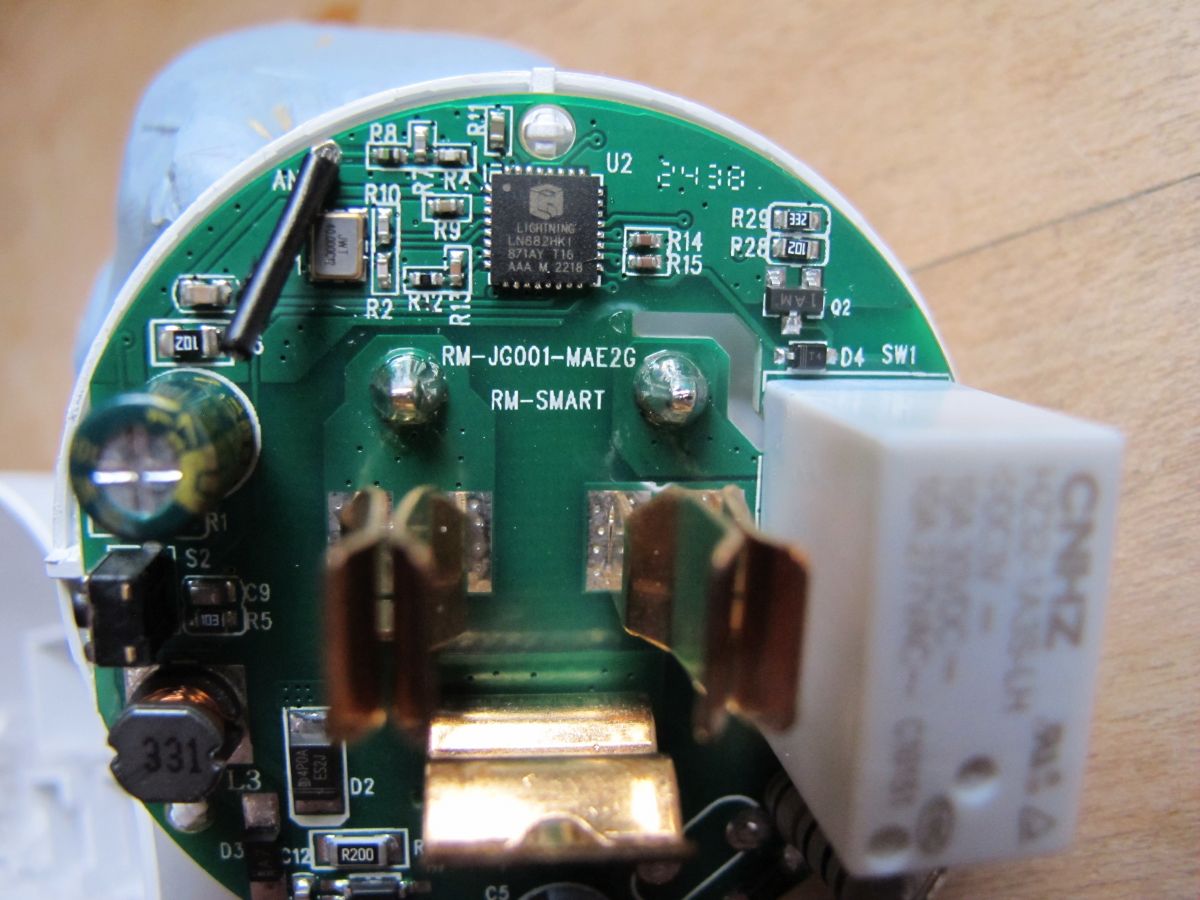

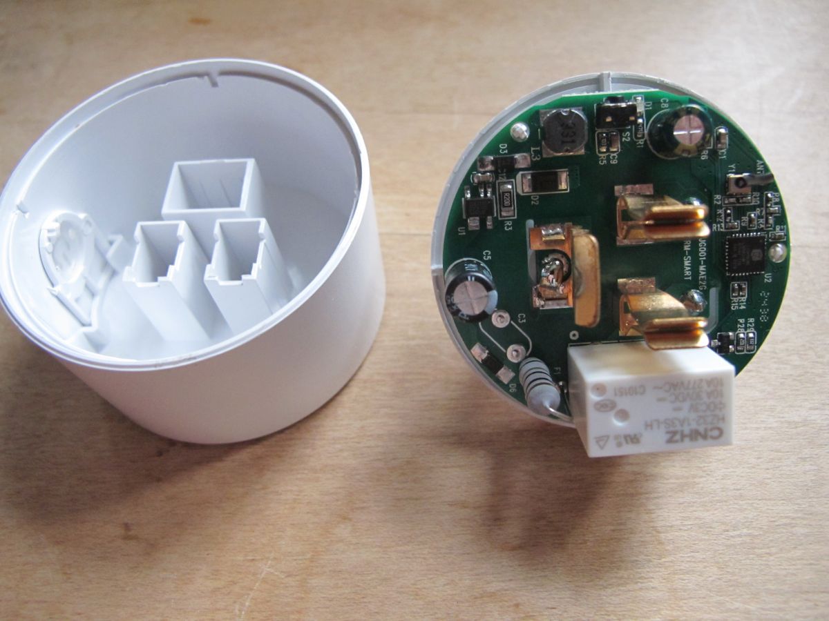

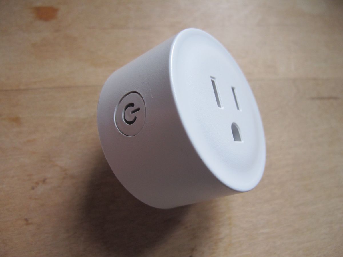

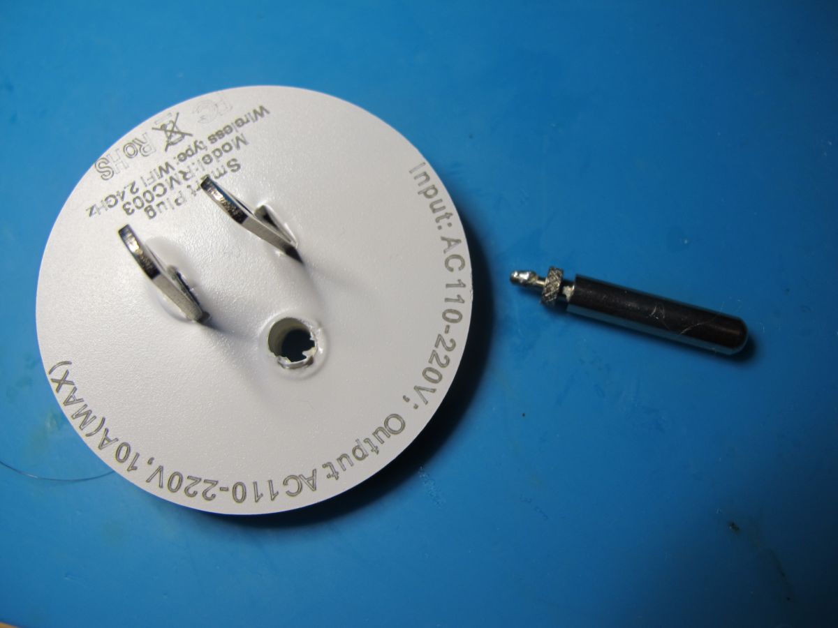

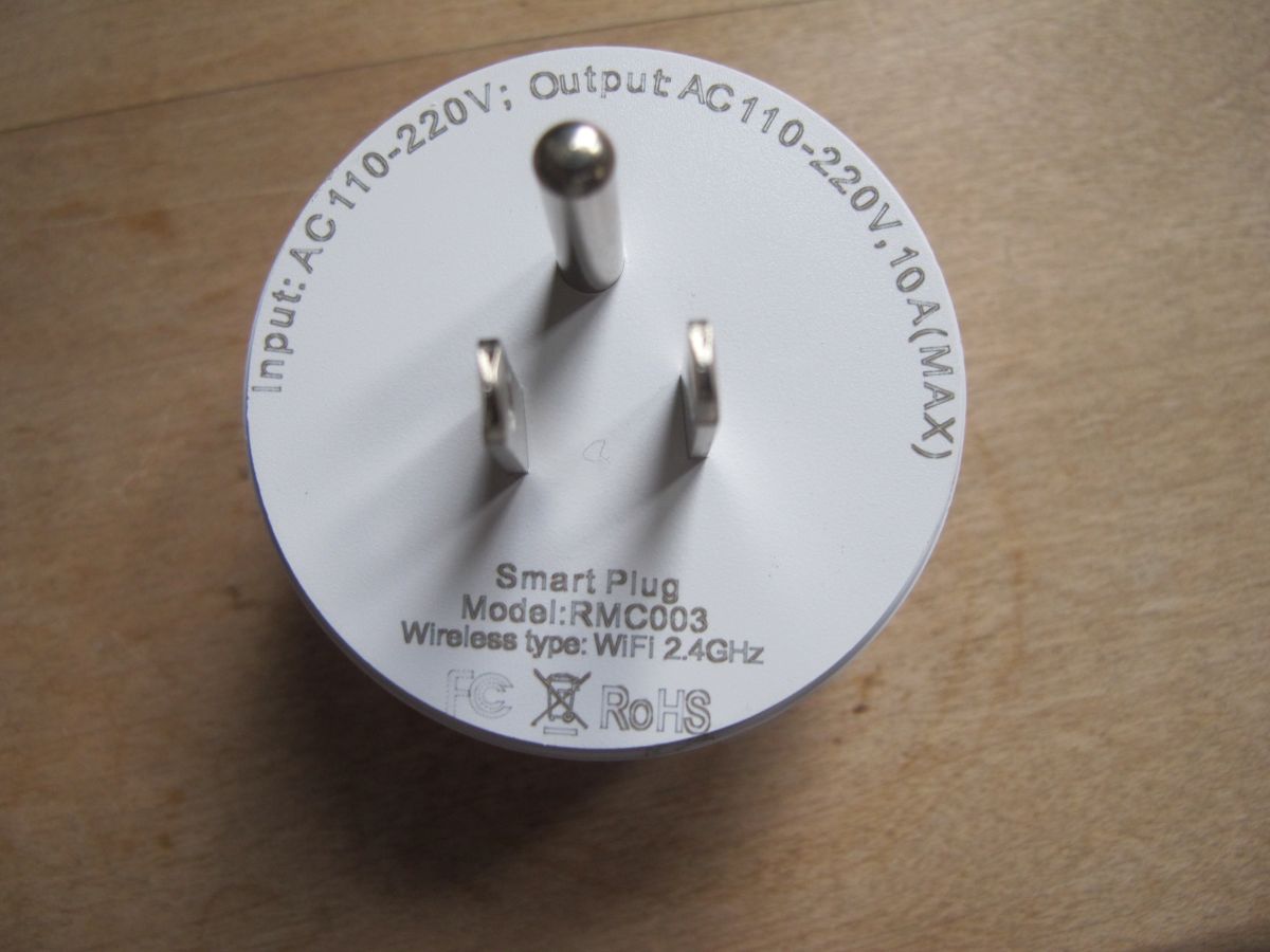

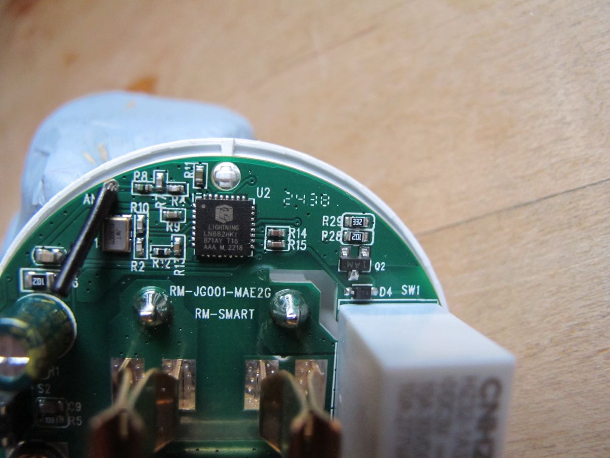

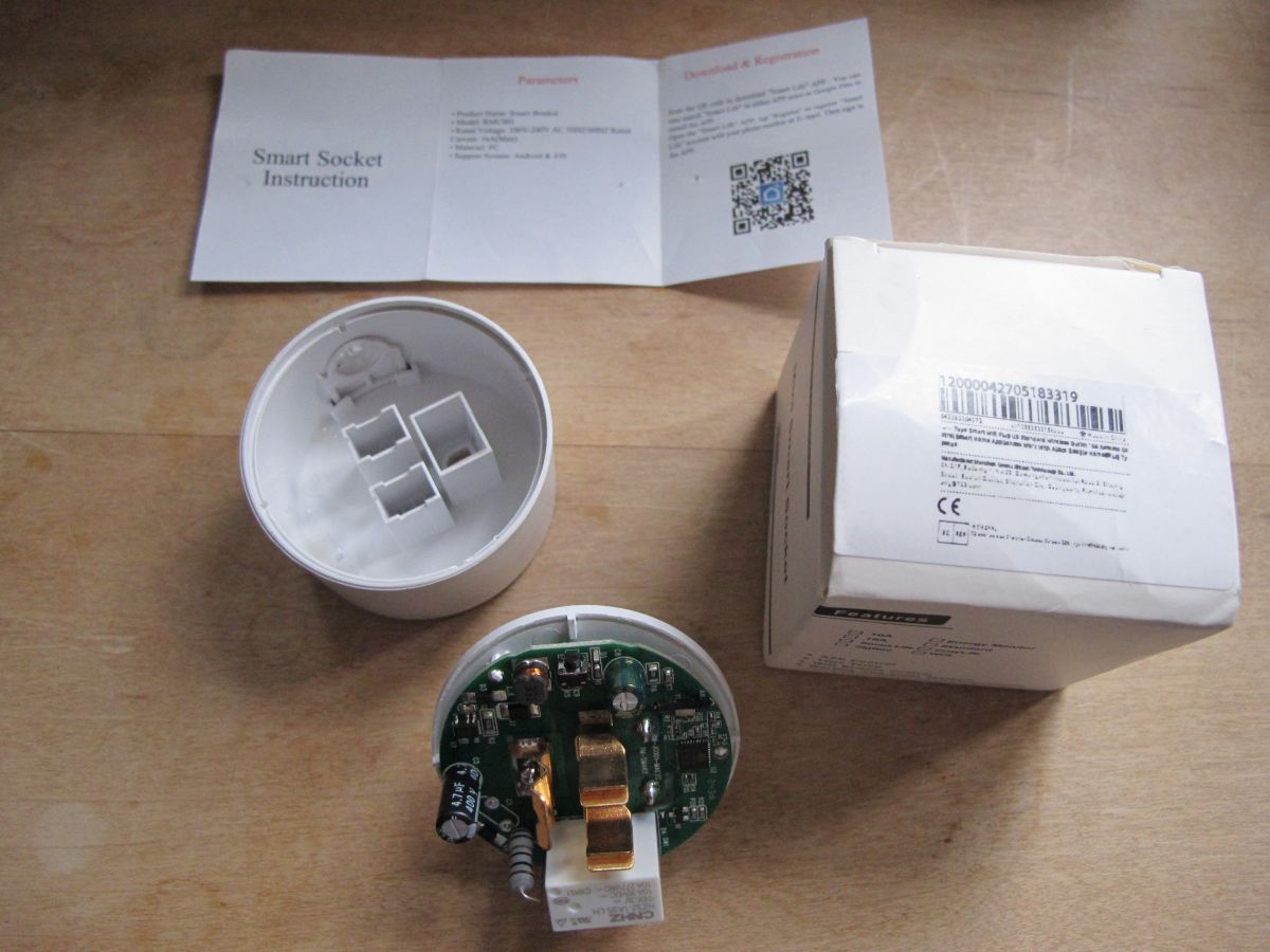

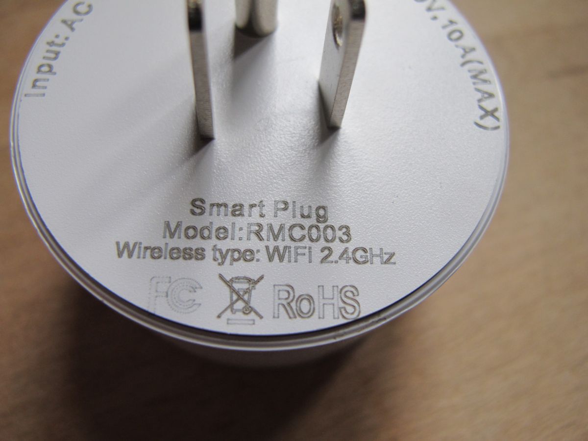

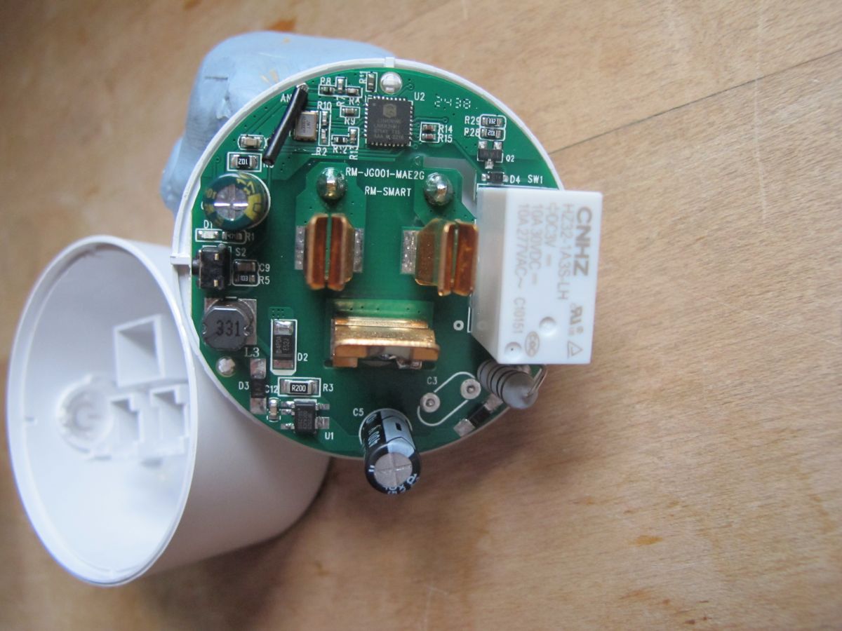

    Basic RMC003 US 110-220V smart plug with 10A CNHZ HZ32-1A3S-LH relay, no power monitoring, 1 blue LED and 1 button.
    Access was relatively easy - crushed the outer casing in a rubber-lined vice, just below the join rim, until there's cracking of the glue and gaps form for a spudger to then be inserted to complete the job.

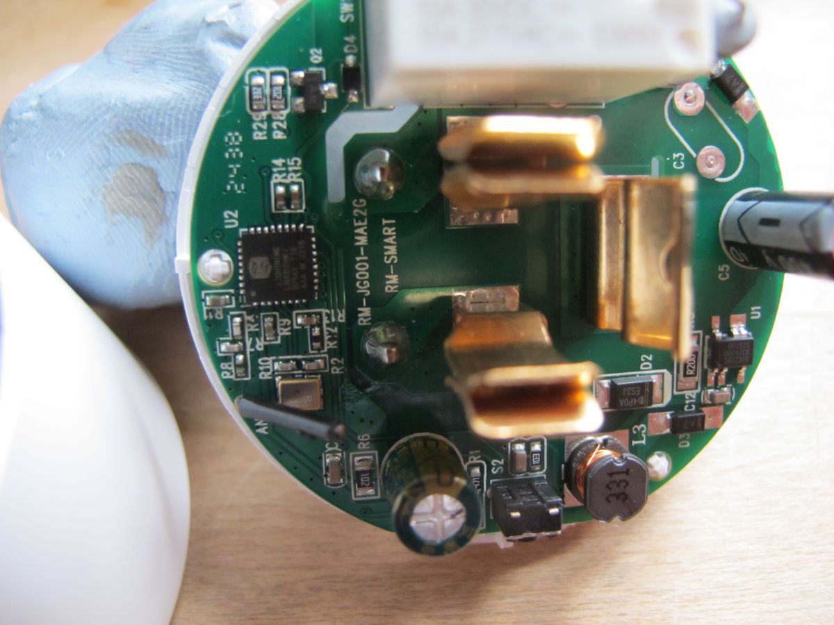

    PCB print:
    RM-JG001-MAE2G
    RM-SMART

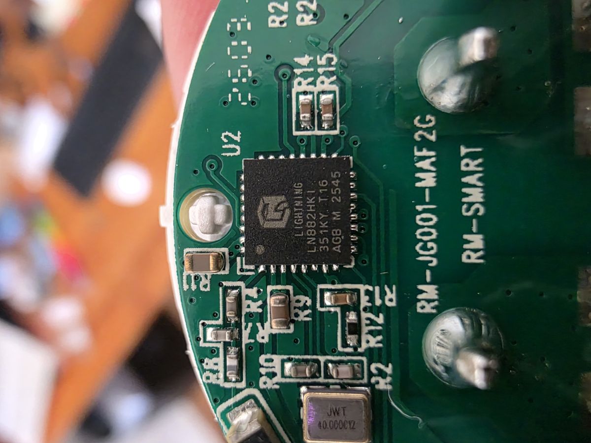

    The main MCU is a Lightning Semi LN882HKI -
    https://www.elektroda.com/rtvforum/topic4027545.html
    https://www.elektroda.com/rtvforum/topic4028087.html
    https://www.elektroda.com/rtvforum/topic4032240.html
    https://www.elektroda.com/rtvforum/topic4045532.html

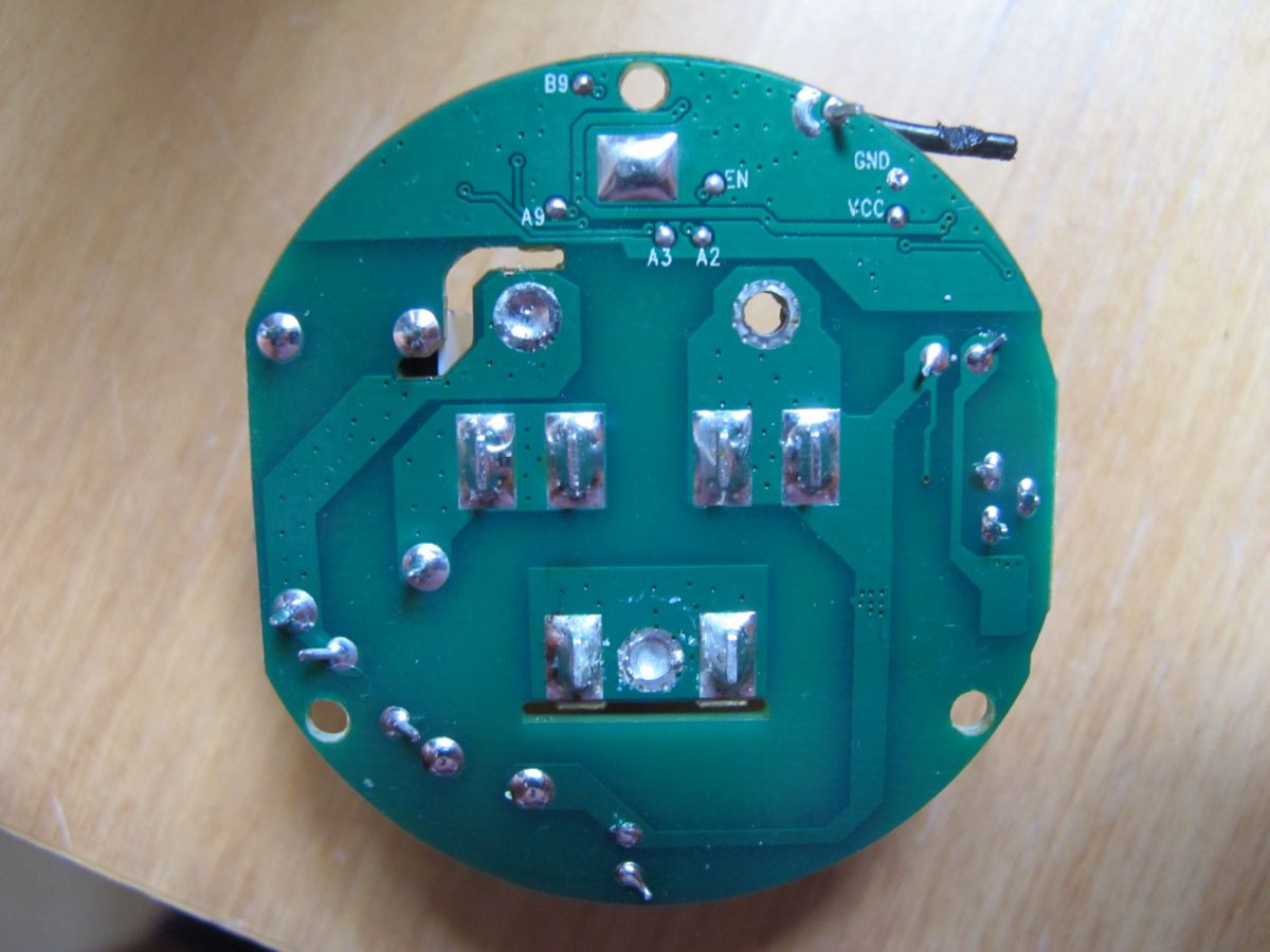

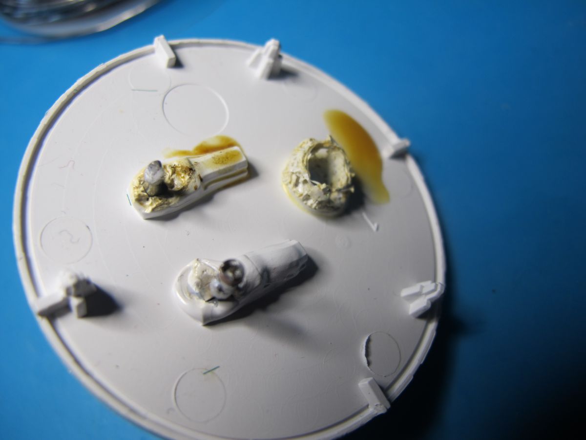

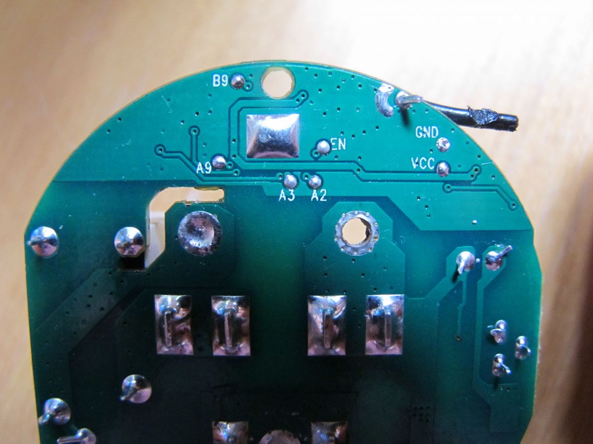

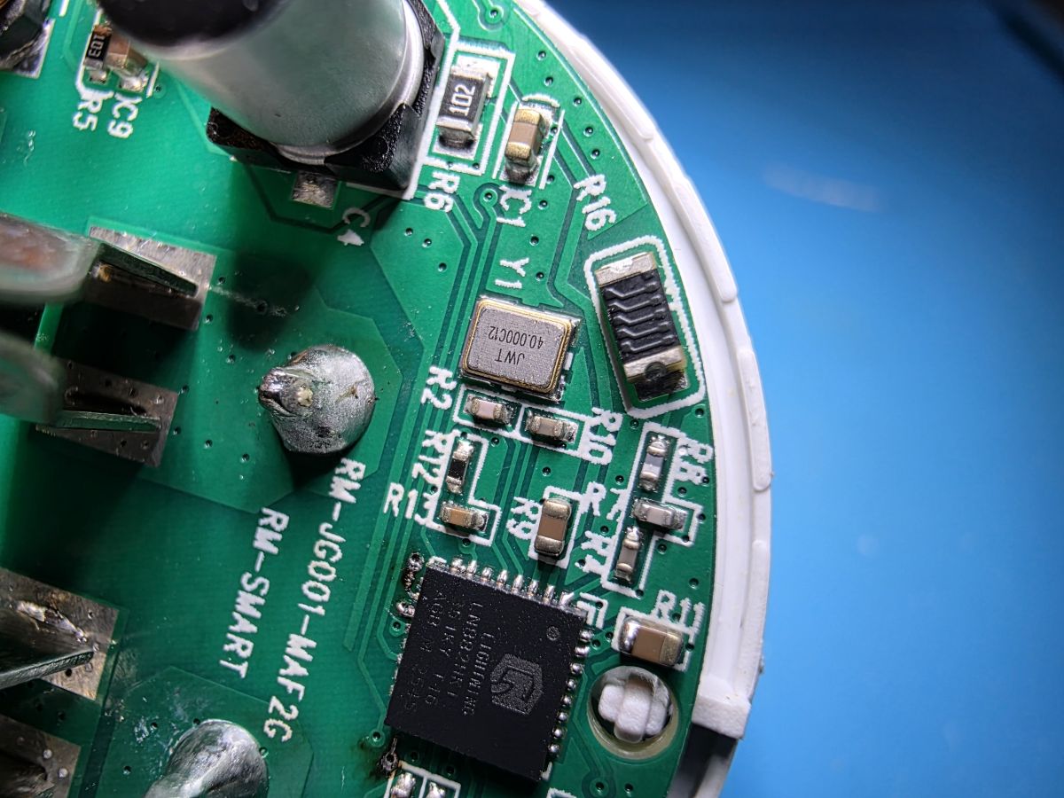

    Unfortunately the pads to capture UART boot log (B9), get into flash mode (A9 grounded) and then flash/dump (A2, A3) are inaccessible until the main PCB is de-soldered from the power pins. For me this was quite destructive, melting the plastic surrounding the pins. It had to get too hot before the solder would melt. I did mix some 63/37 pb solder in first but I guess not enough.

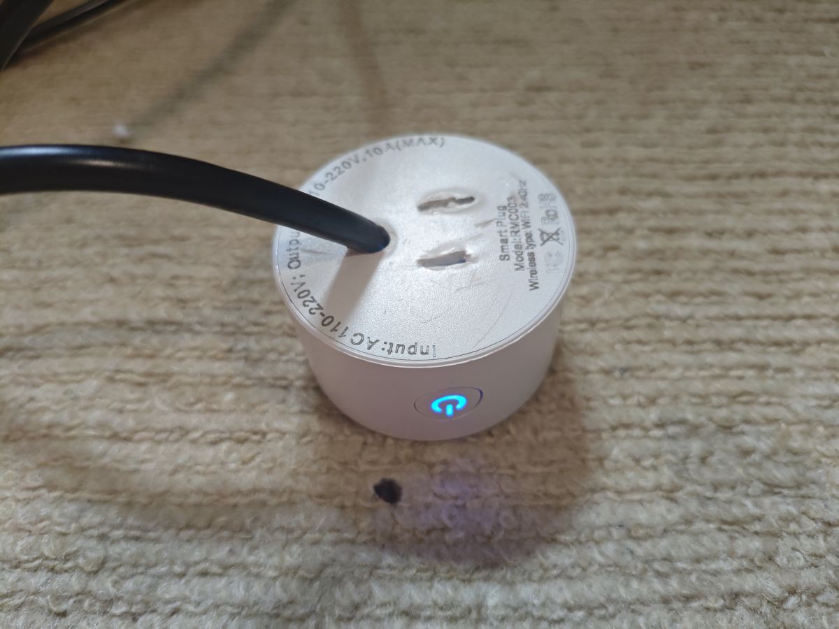

    I wrote off the power pins and made this so device could be tested on mains
    Smart plug RMC003 with blue LED on a carpet.

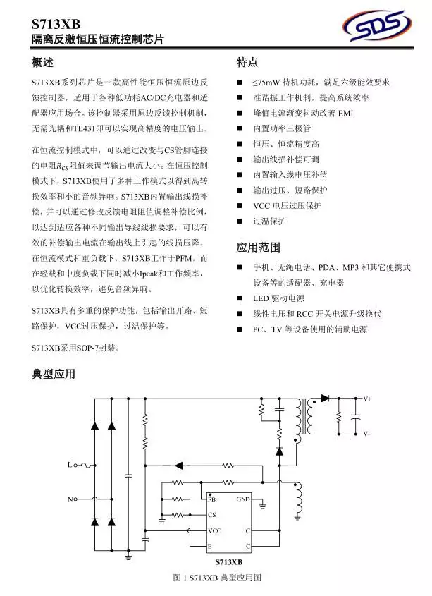

    #4 21419913
    Posts: 14760
    Rate: 12886

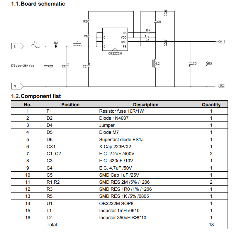

    This is non-isolated power supply, a step down converter:
    OB2222M power supply schematic with component list.
    For example, this one is done with OB2222MCP chip.
    On this schematic, you can see there is a continous line from mains N (or L, if you swap plug...) to the one of power supply output terminals. So, with this setup, you can sometimes get live potential on, let's say DHT11 ground. And then if you touch DHT11 ground with one hand, and, let's say, PC case with second hand, you'll get a serious shock.
    Sample device where it's used: https://www.elektroda.com/rtvforum/topic3828223.html
    And this is an isolated power supply, it's a flyback converter as usual. Very common topology, also used for 5V "chargers", etc:
    Flyback converter schematic with S713XB chip and text in Chinese.
    As you can see, there is no continous connection between mains (L or N) and the power supply output - it's isolated by transformer. So, unless a fault occurs, it's more safe than a non-isolated converter, but still caution is recommended.
    Sample device where it's used: https://www.elektroda.pl/rtvforum/topic4098965.html

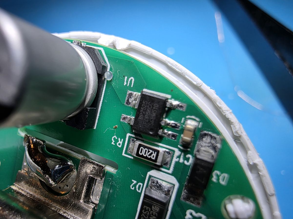

    noticed earlier that the plug is marked as 110-220V. Our mains is typically 230-240v (going on the Atorch device reading when used - 241v today). I wonder if the 220 tolerance covers 230-240 or, if used in production, this device can be expected to fail after a short while
    Added after 3 [minutes]:
    relay does say 277vAC, black cap 400v and green cap 10v
  • #6 21419989
    Posts: 14760
    Rate: 12886
    You should check U1 for that. This is the most crucial element and it most likely tolerates higher voltages than 220V AC.
    Assuming that you still have it open, and if not, don't worry, it will be certainly ok.

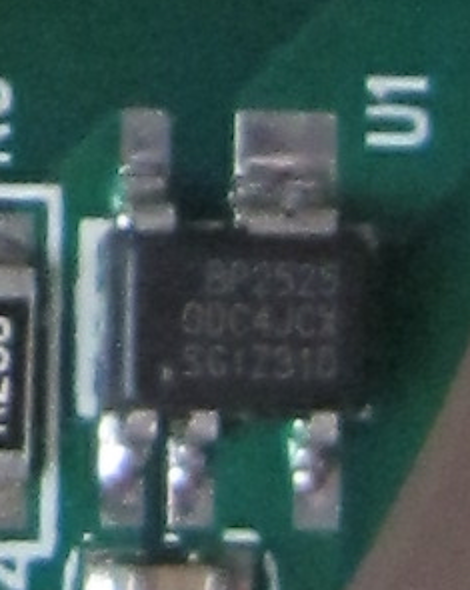

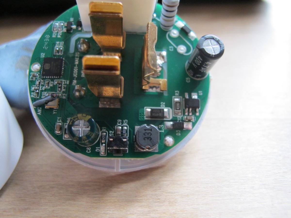

    \Wait, I seem to be able to read the marking on one of the photos - BP2525? https://www.elektroda.com/rtvforum/find.php?q=BP2525
  • #7 21420003
    Posts: 5214
    Help: 448
    Rate: 917
    yes, BP2525
    Image of BP2525 integrated circuit on a printed circuit board.

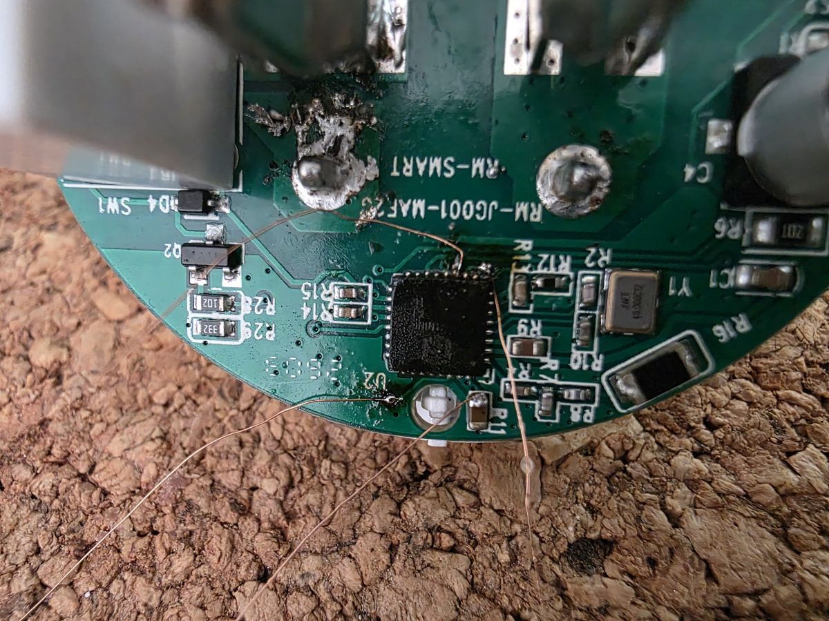

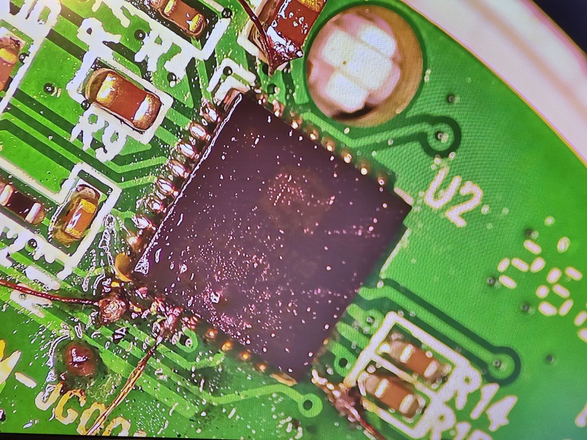

    What I was unhappy about: the fact that the pads aren't accessible on the front and desoldering would have likely melted/destroyed the plug as the editor of this post already experienced. Well, with a bit of patience and a calm hand, it is still possible to access the pins (A2/A3/A9) with thin wires on the front, by carefully scraping the solder mask and tinning the bare traces. Also, one of my plugs arrived damaged with the mains capacitor ripped off and dangling in the case, which I really don't understand how it can happen.. but alas, it's fixed and all works now.

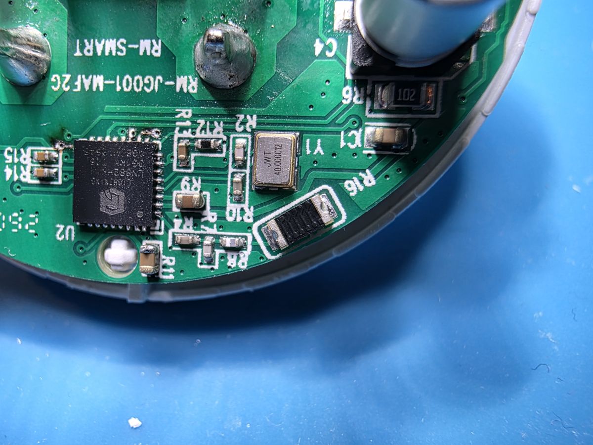

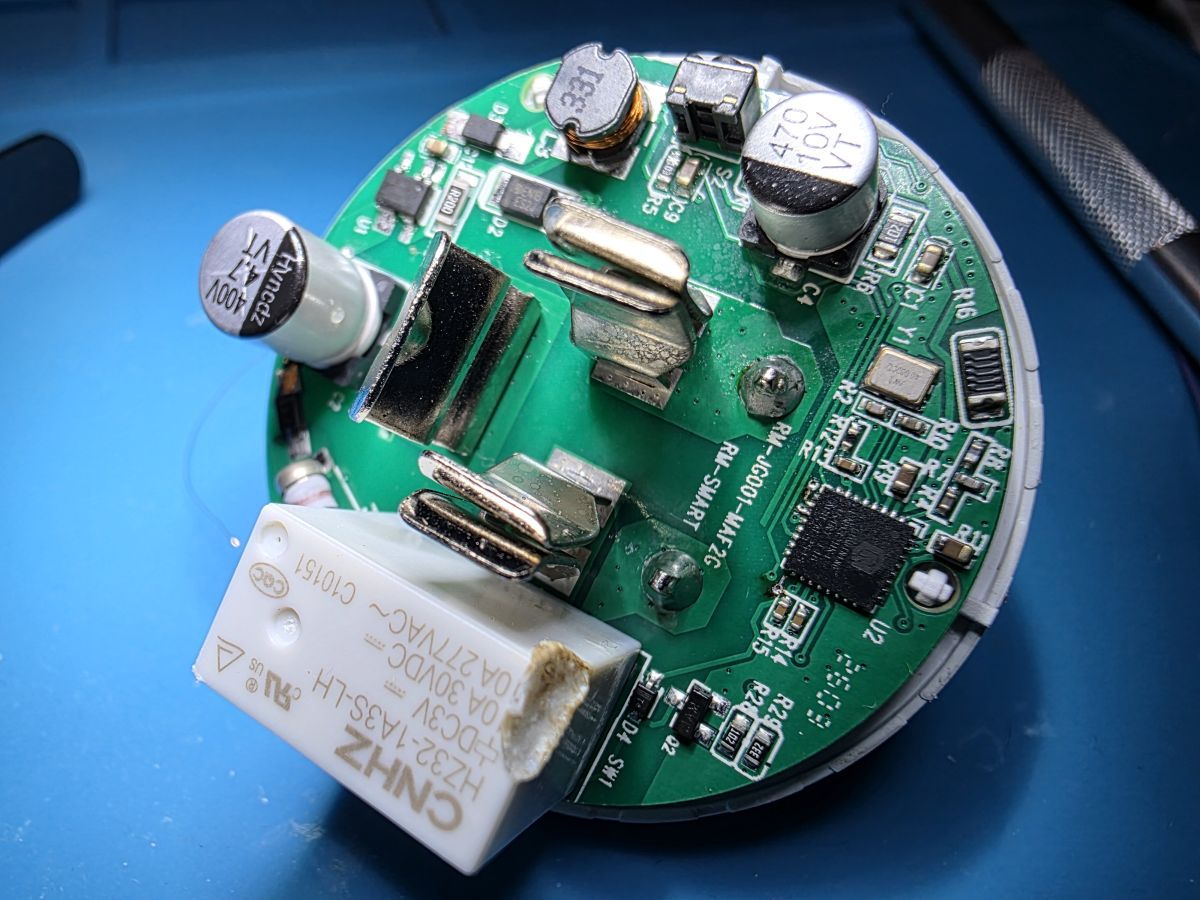

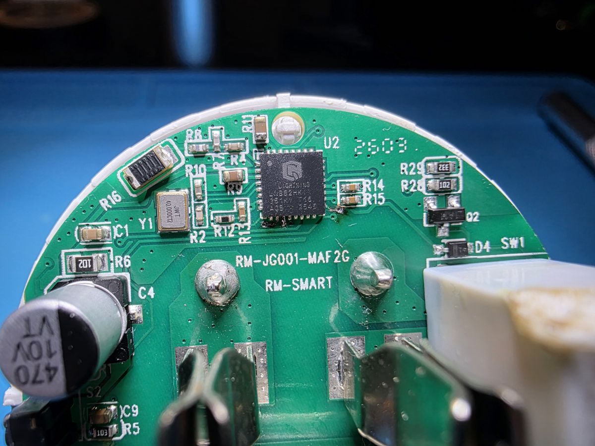

    1) There seems to be a slightly updated version which I received as of March 2026, with all the components, including the big caps, the inductor and the antenna being SMD. A slight upgrade but the board layout wasn't changed and also the BP2525 transformer, all the same:
    Round PCB with capacitors, a coil, and metal contacts on a blue background Close-up of a green PCB with an IC chip, SMD resistors, and a capacitor. Close-up of a green PCB with an IC, SMD components, and “RM‑SMART” markings. Close-up of a green PCB with an IC, SMD components, and “RM‑SMART” printed on the board. Close-up of a PCB section with SMD components, an IC chip, and a resistor labeled R200

    Close-up of a PCB with LN882HK IC and color pin labels: 3V3, TX, RX, BOOT, GND Close-up of a green PCB with an IC and SMD parts; “RM‑SMART” text visible.
    Close-up of a PCB with SMD parts, thin wires, and burn marks around solder joints <-- in this photo, I wrongly soldered a wire to B9 which isn't necessary and won't work, please see next photo for correct BOOT pin A9
    Macro photo of a green PCB with a black integrated circuit and markings U2 and R14

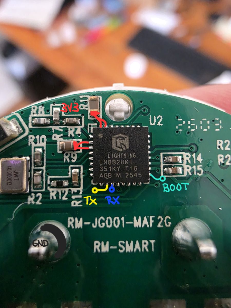

    To flash, connect to your UART device:
    3V3 (choose one of the nearby R9 or R11) --> 3V3
    GND (the large mains pin is convenient), --> GND
    TX (A2) --> RX,
    RX (A3) --> TX
    Before powering the device, connect BOOT (A9) to GND to enable the flash mode. After power is on and the BK flash tool entered the chip, BOOT pin can be disconnected from GND.
    Then create backup and write OpenBK firmware build for LN882H, just as usual with the BK flasher tool for windows. Baud rate 921600 worked for me. Very convenient, love it!!!
