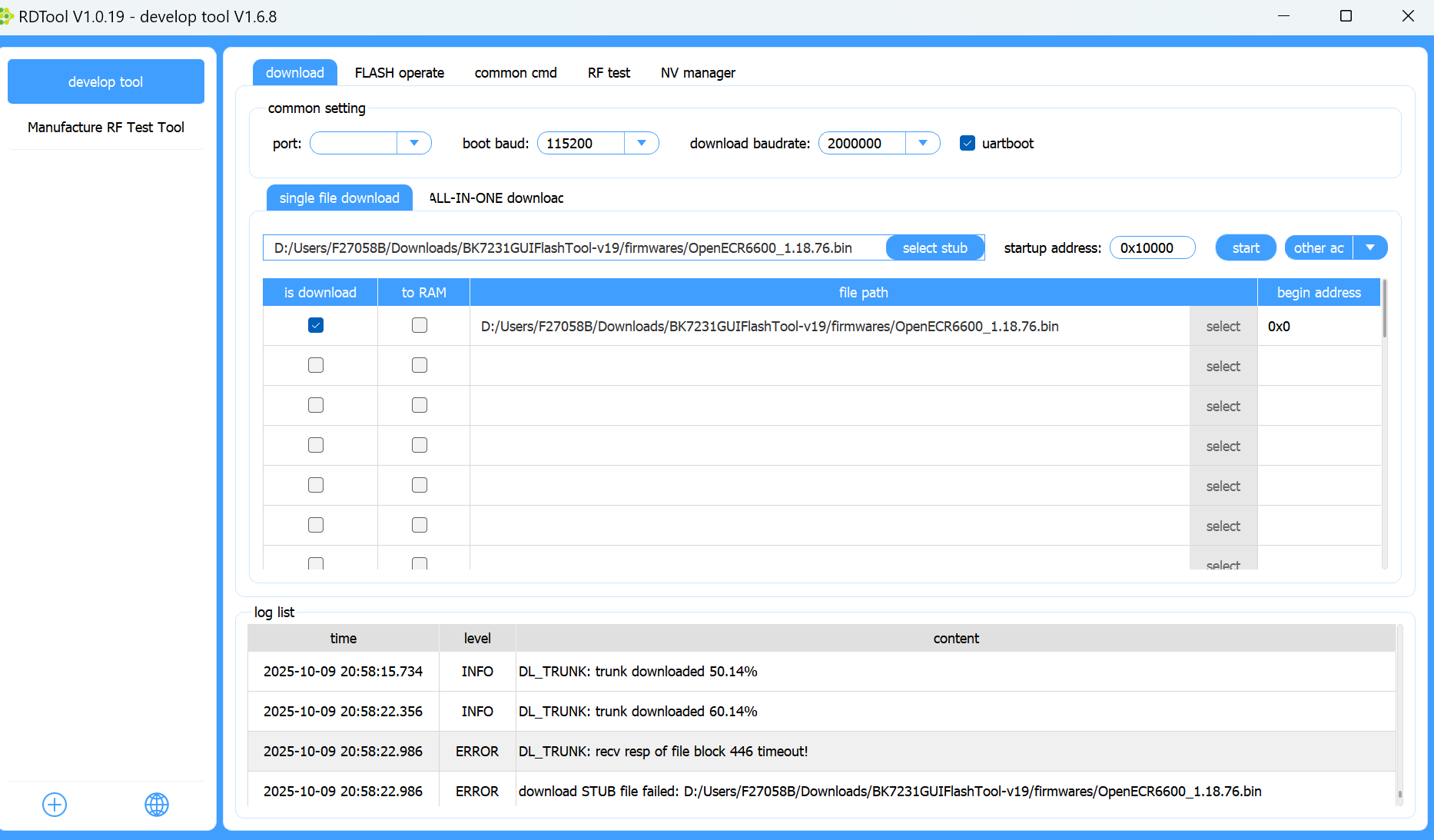

  • #34 21715699
    jtauscher87
    Posts: 13
    >>21521544
    Hi I'm not sure how to fix this error? Just try again and again until it completes? It always stops at the same percentage. Thanks dude!
    RDTool interface showing firmware file download error and progress log.

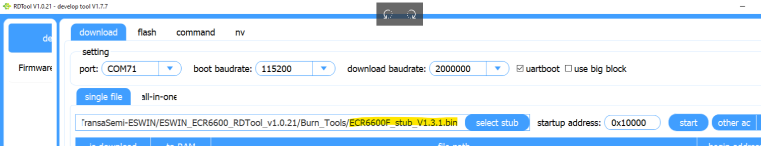

    #35 21715703
    Posts: 5033
    Help: 438
    Rate: 891
    the stub you've selected is not a stub, it's the OpenECR6600 binary.
    Added after 10 [minutes]:
    RDTool interface with ECR6600F_stub_V1.3.1.bin binary file selected
  • #37 21716613
    jtauscher87
    Posts: 13
    Thank you very much, I downloaded some random RDTool without the necessary stub file. Also I needed to lower the baud rate to make it work.
    Now I got it working except downloading the stock bin but not that important ;)
