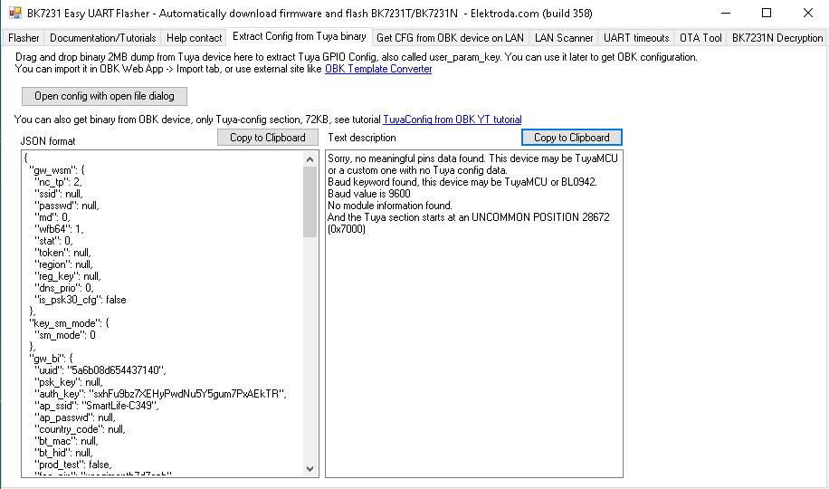

  • Tuya device config dump with SmartLife pairing PIN
    #31 21935489
    clasik
    Level 4  
    Posts: 14
    >>21935487
      "gw_wsm": {
        "nc_tp": 2,
        "ssid": null,
        "passwd": null,
        "md": 0,
        "wfb64": 1,

    Sorry, no meaningful pins data found. This device may be TuyaMCU or a custom one with no Tuya config data.
    Baud keyword found, this device may be TuyaMCU or BL0942. Baud value is 9600
    No module information found.
    And the Tuya section starts at an UNCOMMON POSITION 28672 (0x7000)
    Screenshot of BK7231 Easy UART Flasher showing a JSON panel and a text description panel.

  • TuyaMCU reports 0.00°C and 0% humidity
    #33 21935712
    clasik
    Level 4  
    Posts: 14
    >>21935504
    It doesn't work.
    Temperature 0.00C (Temperature)
    Humidity 0.0% (Humidity)
    Channel Battery = Low
    Channel 10 = 0
    Temperature 0.00C (27)
    Humidity 0.0% (46)
    1 drivers active (TuyaMCU), total: 34
    Channel 1 = 0.00, Channel 2 = 0.00, Channel 3 = 0.00, Channel 10 = 0.00, Channel 27 = 0.00, Channel 46 = 0.00
    Cfg size: 3584, change counter: 26, ota counter: 2, incomplete boots: 1
    Chip temperature: 32.6°C
    Wifi RSSI: Fair (-63dBm)
    Reboot reason: 1 - Rbt
    MQTT State: connected RES: 0(ERR_OK)
    MQTT ErrMsg:
    MQTT Stats: CONN: 1 PUB: 17 RECV: 6 ERR: 0
