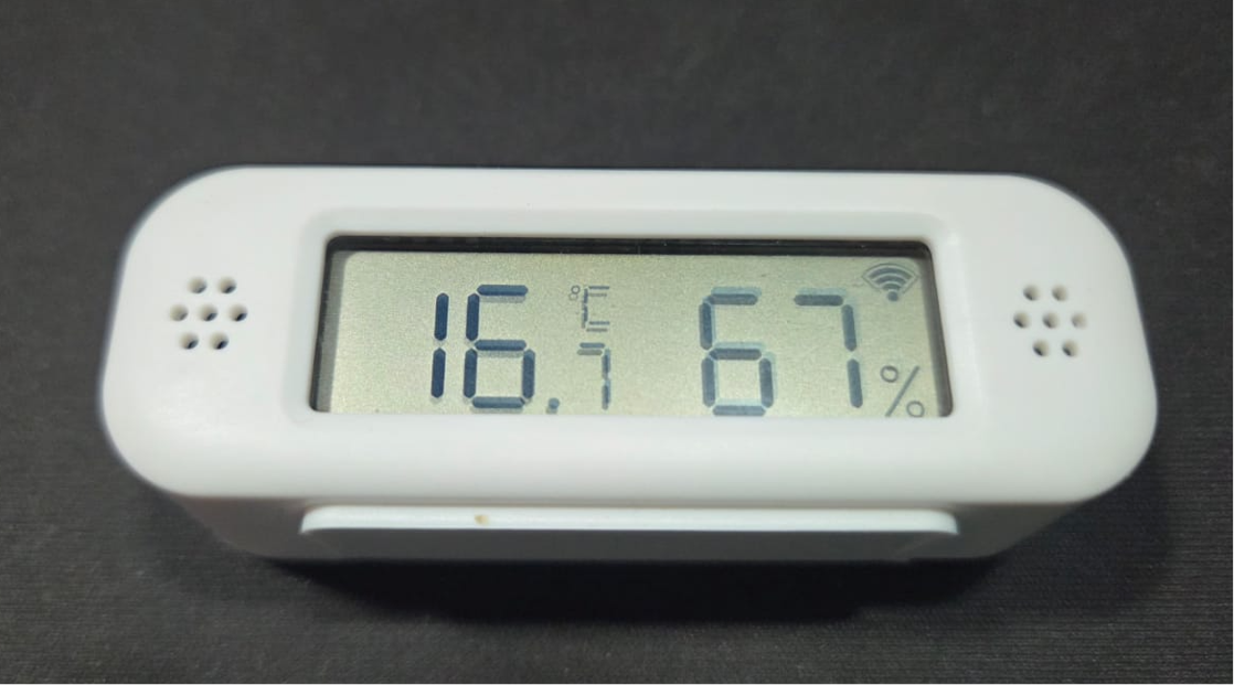

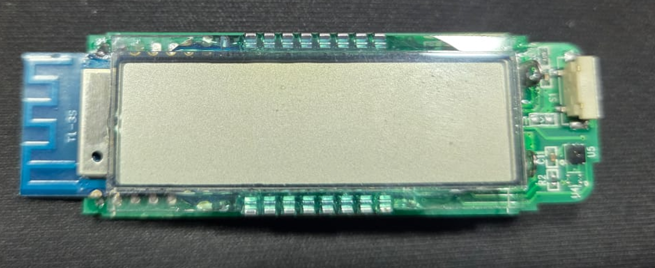

Yes — the TH03 Pro is a TuyaMCU device with a CB3S Wi‑Fi module, so it can be used with OpenBeken after flashing the BK7231N side and mapping the MCU data points [#21834514][#21836406] For flashing, one user had to disconnect MCU pin 10 from the CB3S RX line (lifting the IC leg worked), then connect to the MCU_RX and MCU_TX pads, and power the board from the battery pads with 3 V on V+ and GND on V- [#21836406] After first boot, you only have a short window to open the OBK web UI before the MCU puts Wi‑Fi back to sleep, so you may need to pull and reinsert a battery a few times while configuring [#21836406] The working OBK setup is `startDriver TuyaMCU` plus `startDriver tmSensor`, with `linkTuyaMCUOutputToChannel 27 val 1` for temperature, `46 val 2` for humidity, and `101 enum 3` for battery state; suggested channel types are `Temperature_div10`, `Humidity`, and `ReadOnlyLowMidHigh` [#21836420][#21836447] For battery behavior, one user reported using flags 37 and 51, with reconnect times of 6–13 seconds, and the device still running fine after two months [#21837785]

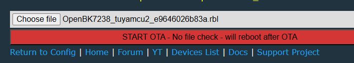

    I don't know if it will solve the problems, but worth a go?
    OpenBK7238_tuyamcu2_e9646026b83a.rbl
    http://<deviceip>/ota
    Screenshot of a web page with file selection and a red “START OTA” bar.

  • #75 21907012
    leonardojc
    Posts: 9
    Hi, I'm having the same problem; the values are still zero. (Using the latest divadiow firmware.)
    I've attached photos of my device.
    Underneath the LCD screen are two integrated circuits: one is the LCD controller and the other is the TuyaMCU.
    TH03 Pro Temperature Humidity Sensor Compatibility with OpenBeken Integration (possibly)

    Active time is indeed only a few seconds, as indicated by leonardojc.
    Sadly, readings are still all zero.
