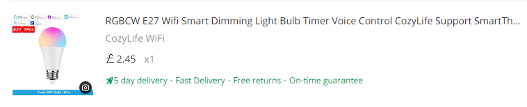

    One of these bulbs was one of my first purchases back in November 2023, but I destroyed the DT-BL200 module accidentally. I've since bought another from Ali. The product page is already gone https://vi.aliexpress.com/item/1005005730079037.html
    Screenshot of a product showing an RGB-CW WiFi E27 bulb with voice control and dimming features.

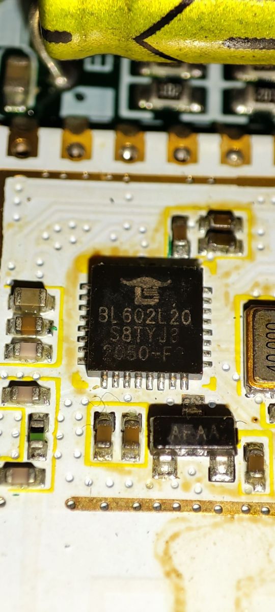

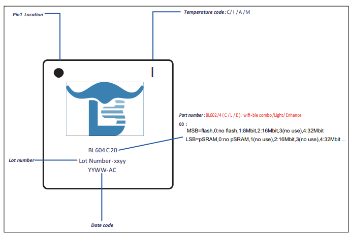

    The DT-BL200 is a Bouffalo Labs BL602L20 (L=Light, 2=16mbit/2mb flash) and is rarely mentioned on the forums.
    Technical diagram of Bouffalo Labs BL602 module

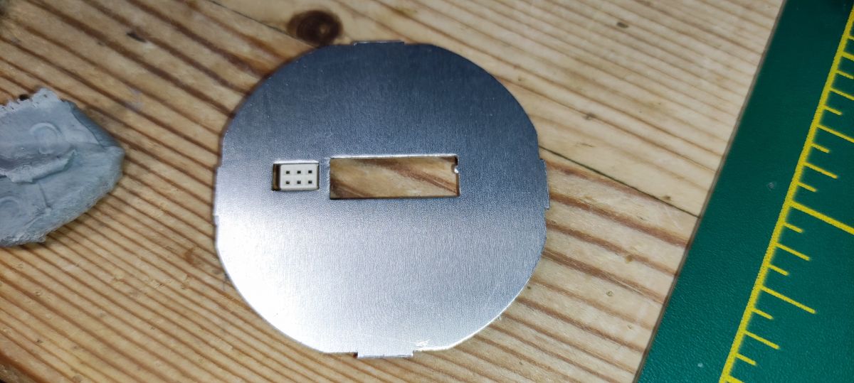

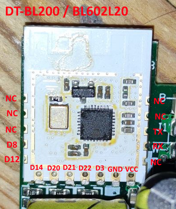

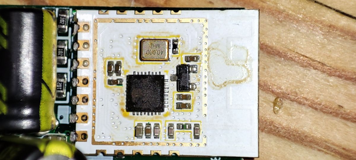

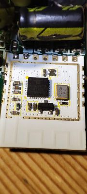

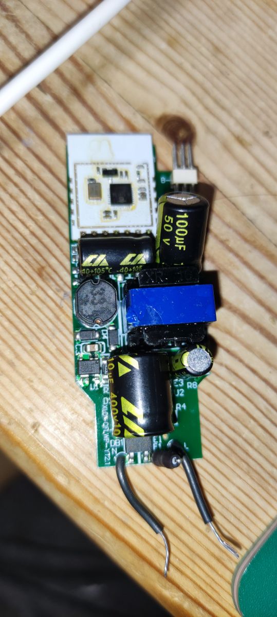

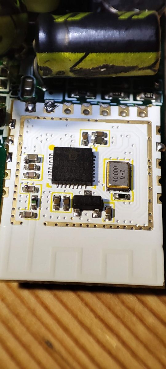

    Inside is the DT-BL200 without RF shield in this instance. Using my own photo and other images around, I made this to help orient me from the top looking down. I did not desolder the module.
    Close-up of DT-BL200 module with labeled pins and chip area.
    D8 = GPIO8 = pull high using 10k resistor/3.3v to enter flash download mode on power-up

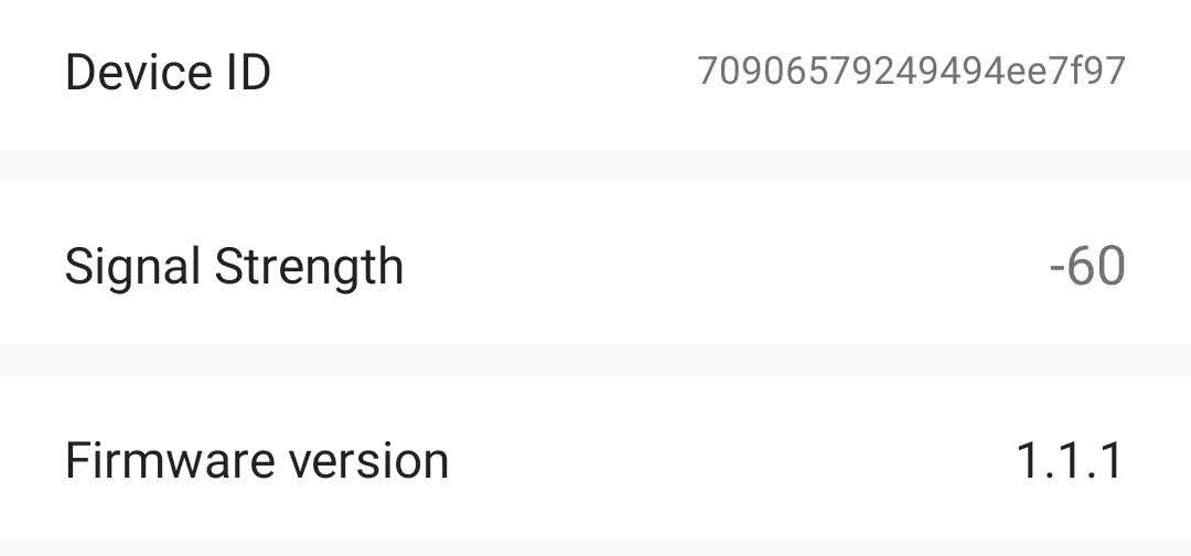

    device id:
    [20:24:25.321] - 1609473600 [L] [     lib_log] udplog_init on: 0, 192.168.2.2:7789

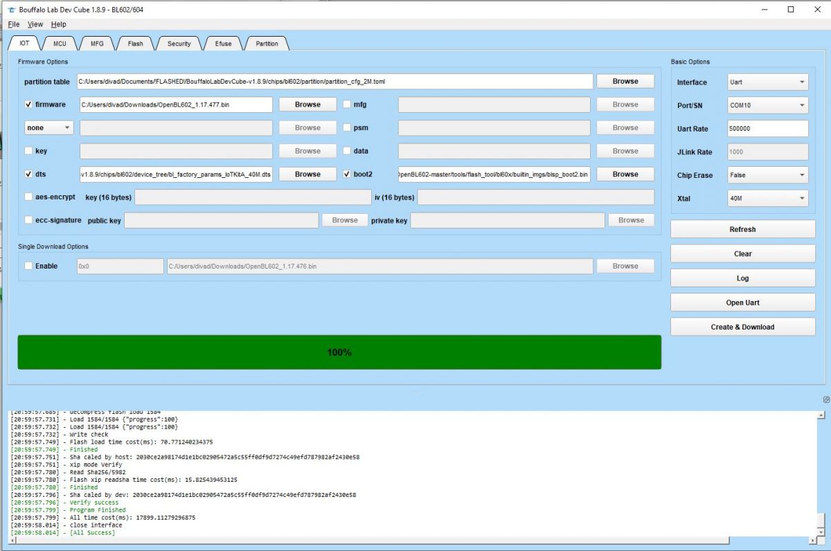

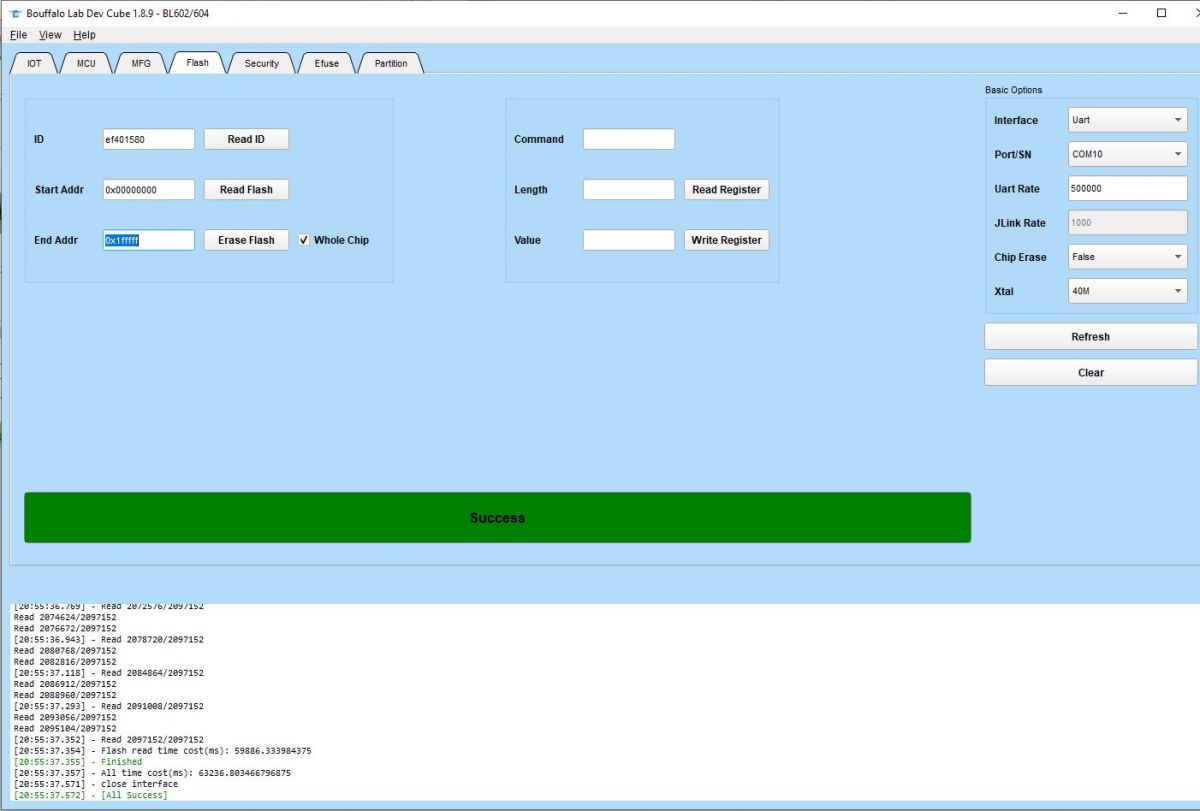

    then the flash ID using BLDevCube 1.8.9
    [20:45:33.401] - 8160/38592
    [20:45:33.497] - 12240/38592
    [20:45:33.593] - 16320/38592
    [20:45:33.689] - 20400/38592
    [20:45:33.784] - 24480/38592
    [20:45:33.880] - 28560/38592
    [20:45:33.976] - 32640/38592
    [20:45:34.072] - 36720/38592
    [20:45:34.120] - 38592/38592

    I also took a 2mb backup of the flash, attached. The whole chip tick is for the erase function only. Read chip requires address input.
    Bouffalo Lab Dev Cube interface with chip configuration.

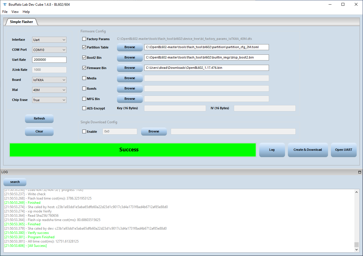

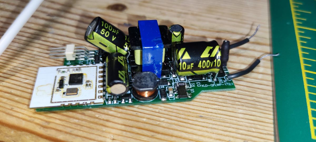

    Now, despite having soldered each pin to a dupont cable, keeping my wires short and using an external <5A 3.3v PSU, I had great difficulty getting the device to boot after flashing OBK. DevCube 1.8.9 would flash successfully, using old (from the Elektroda 1.4.8 pack) and new boot2, partition files, but it would never boot to AP or even give any UART boot output. I tried several versions of OpenBL602 going back to April 2022.
    Using 1.4.8 DevCube however (it seemed happy with the flashID for once) was successful, but the boot would either loop or the AP would show briefly and disappear or show but nothing could connect to it. Suspect boot log errors would change between flash attempts. I've seen unknown gpio like here https://www.elektroda.com/rtvforum/topic3889041-120.html#20135575 and romfs magic now correct, like here https://www.elektroda.com/rtvforum/topic3889041-390.html#20973684
    Flashing gpio app booted OK https://github.com/lupyuen/lupyuen.github.io/blob/master/src/led.md
    Powering from the mains as if a normal finished device made no difference to times when it was boot looping on 3.3v. I was at a loss, but after quite a number of attempts I think my final working one was using blflash! Maybe just a fluke. I think I'll get a BL602 dev board to see if I can find a pattern to what works and what doesn't. I also tried CH340 and FTDI USB-TTL adaptors.
    After finally getting into OBK console (browsing to 192.168.169.1) I could use the GPIO doctor to find all 5 PWM pins. Those were
    P14 - RED - PWM1
    P20 - GREEN - PWM2
    P21 - BLUE - PWM3
    P22 - COLD WHITE - PWM4
    P3 - WARM WHITE - PWM5
    which makes the OBK template

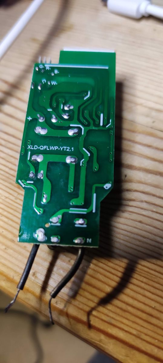

    PCB text: XLD-QFLWP-YT2.1

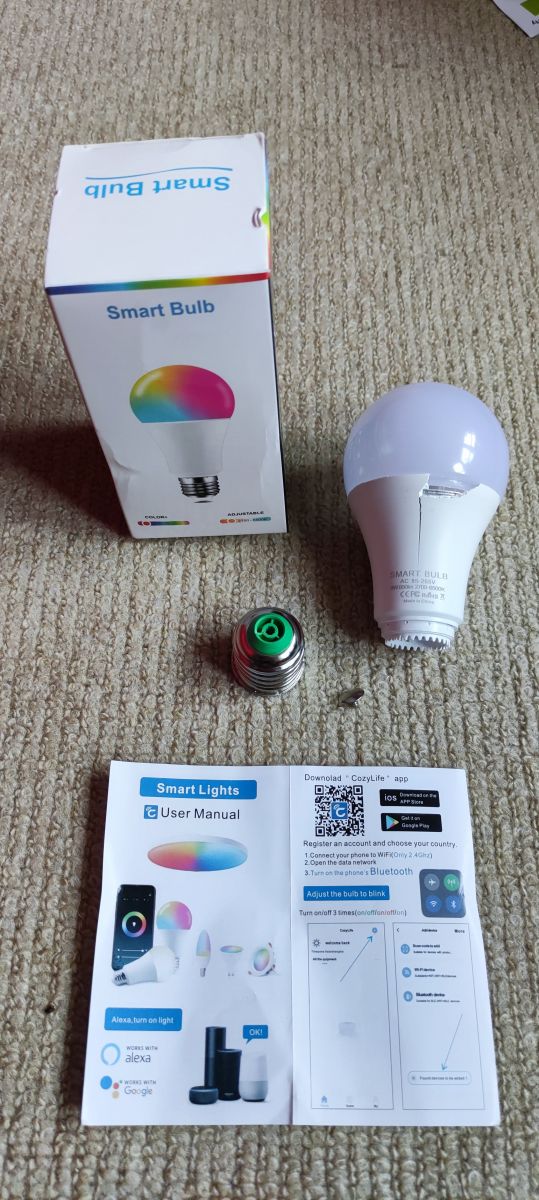

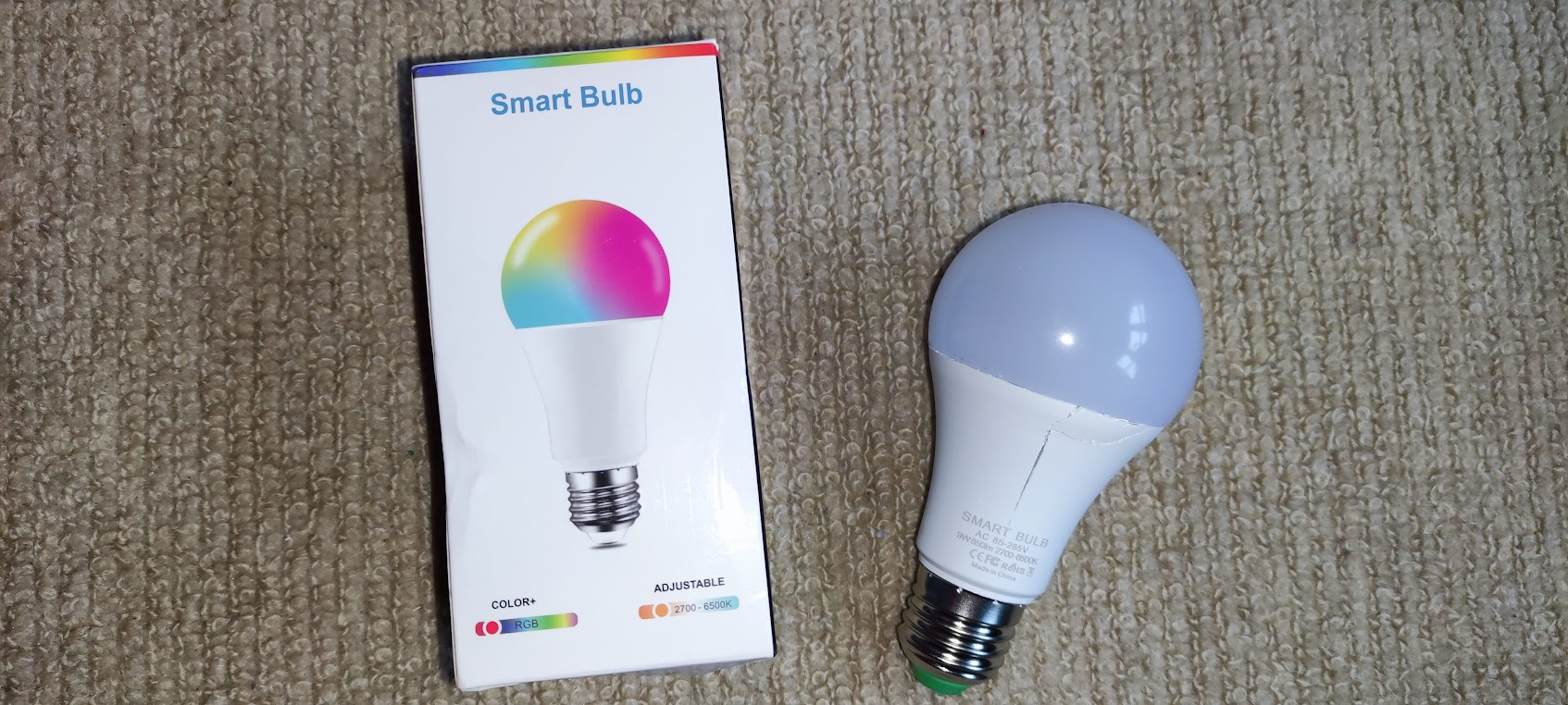

    Various pics:
    Screenshot of Bouffalo Lab Dev Cube showing successful flashing configuration. Bouffalo Lab Dev Cube screen with flashed configuration. View of a PCB labeled XLD-QFLWP-YT2.1 with various conductive traces, set against a wooden surface. Electronic module without RF shield on a wooden table. Electronic module of a bulb with visible capacitors and transistors. Electronic module with a microchip and components on a circuit board. Close-up of BL602L20 chip on a circuit board Circuit board with electronic components and attached wires on a wooden surface. Close-up of an electronic module on a circuit board with a visible integrated circuit and components. Metal cover for DT-BL200 module with cutout and connector. LED Smart Bulb with user manual and packaging. Cracked smart bulb on a carpet Back of RGB smart bulb packaging. View of a device interface showing the device ID, signal strength, and firmware version.

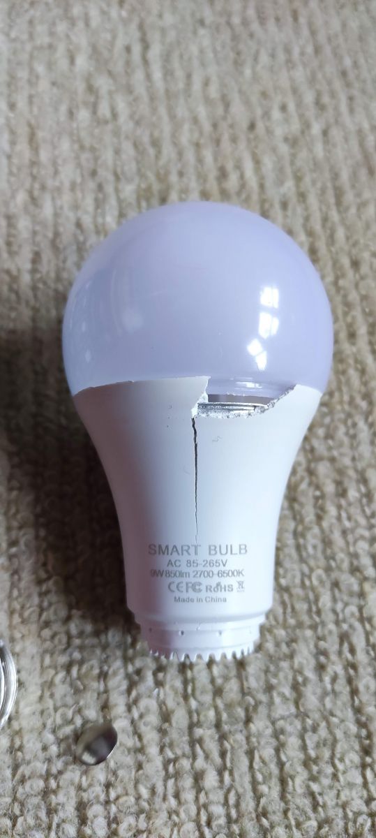

    Smart Bulb and its packaging on a carpet.

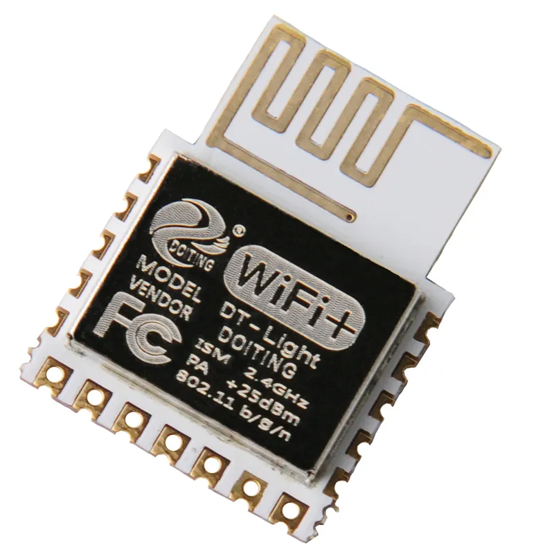

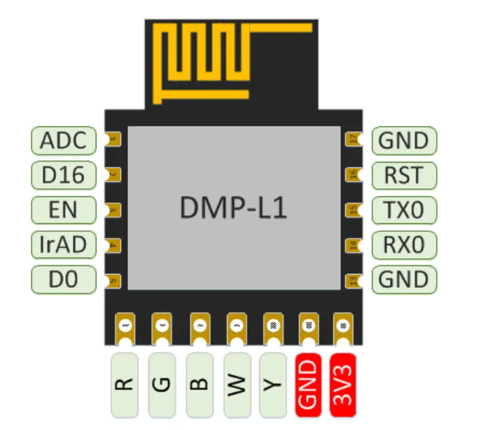

    Out of curiosity, do you know a matching ESP or Beken module? With the same pinout as DT-BL200?
    EDIT: I've found answer to my own question:
    This module can replace modules such as: BW2L, CB2L, DT-BL200, TYWE2L, WB2L, WBR2L, WR2L
    This module is designed for bulbs so the pinout labeling shows colors.
    Module is almost pin compatible with BW2L,CB2L,DT-BL200,TYWE2L,WB2L,WBR2L,WR2L
    It can still be used for any application, just like any other module. It has almost all of the GPIOs broken out (excluding GPIO2) and that includes the A0 analog GPIO.
    Pin diagram of the DMP-L1 module with pin labels shown on the sides.
    ESP WiFi module DT-Light powered by DOITING.
    that's from @BlackAdder page, interesting

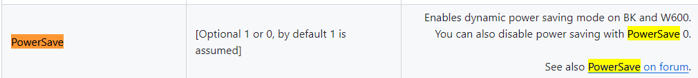

  • PowerSave command enables dynamic power saving
    #9 21177100
    Posts: 14797
    Rate: 12954
    Sure, if you want, add info to docs here:
    https://github.com/openshwprojects/OpenBK7231...d8cf361c354742aa4a5/src/cmnds/cmd_main.c#L689
    and I will merge it and update docs.
    Spoiler:
