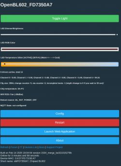

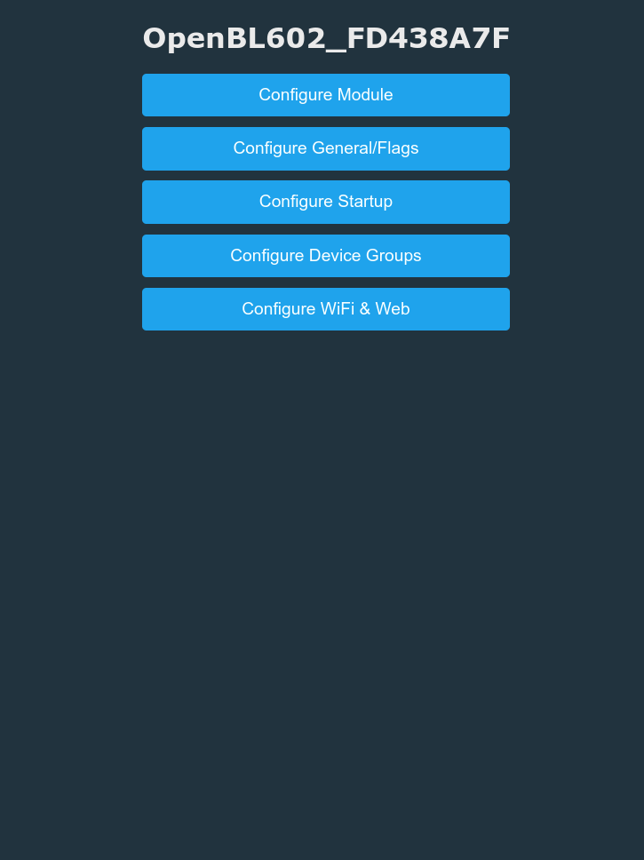

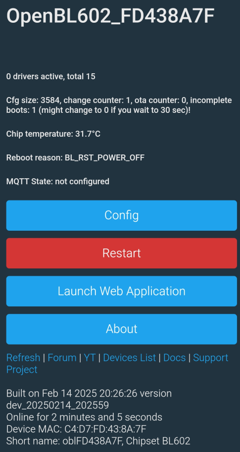

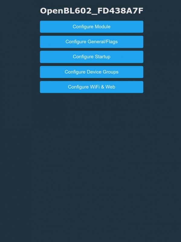

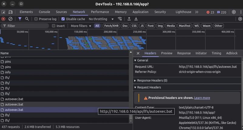

    >>21439639 looking good
    Firmware options for OpenBL602 with various configuration file paths and settings.
    Startup
    Also app seems fine.

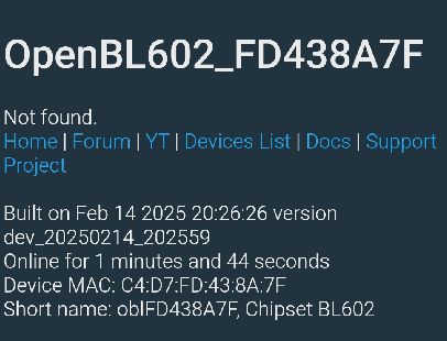

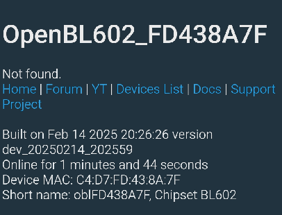

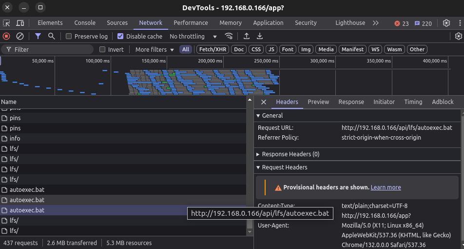

    OpenBL602 device screen with Not found message
    Screenshot of the OpenBL602 device user interface with status information.

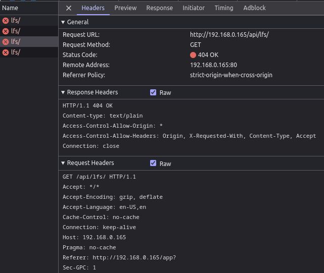

    That basic one is fine, "Launch Web Appliction" link is blank page.
    Not much time today, my missis demans attention ;)
  • #66 21439890
    Posts: 14667
    Help: 656
    Rate: 12683

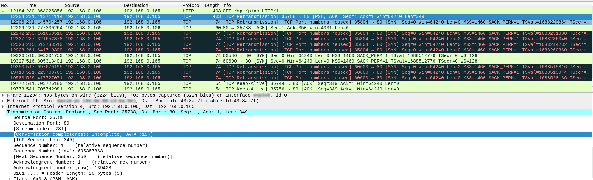

    Thank you for testing!
    Don't worry about blank page - Web App is a Javascript addon fetched from Github, it's open source obviously, but it won't fetch if you don't have Internet connection.

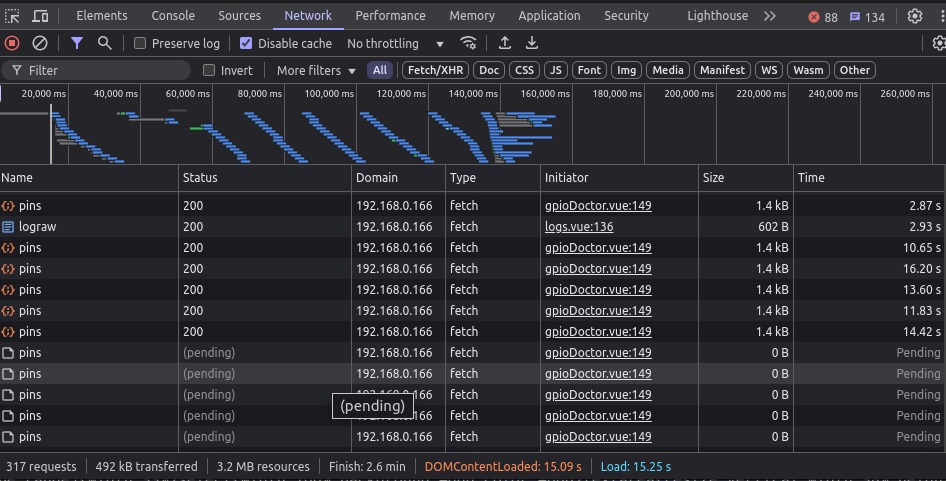

    Yah, bell rang just couple of minutes after I've wrote that. Missus sleeps, gonna test some drivers.
    Added after 48 [minutes]:

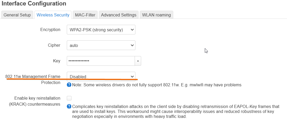

    We might be doing rw's in incorrect region. When configured with AP credentials, it throws this warning
    [ 7285][WARN : bl_mtd.c: 205] addr@0x230a28cc is xip flash, size 8
    Have a look:
    After that, it basically cycles with this:
    Tested those creds with my mob, they fine.

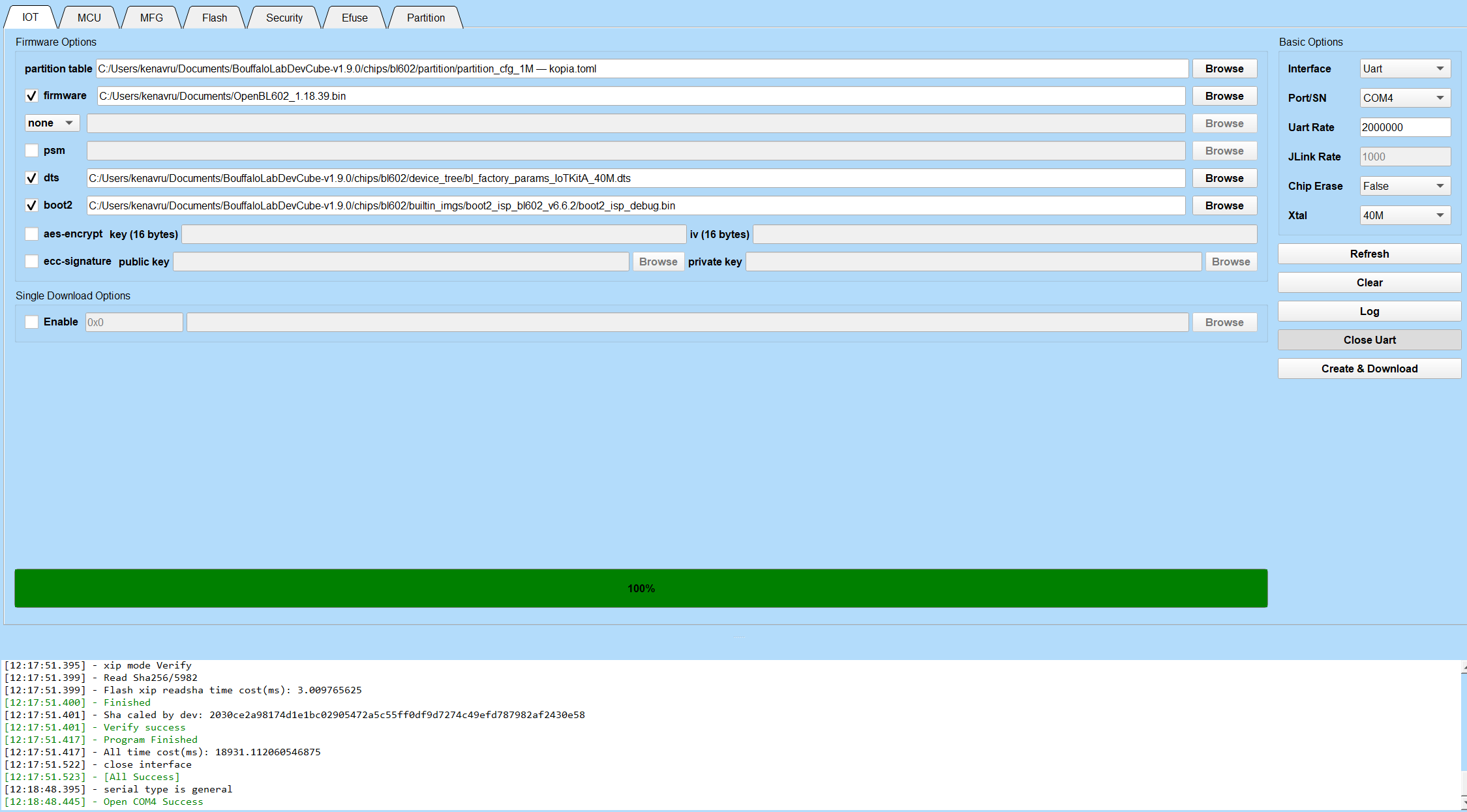

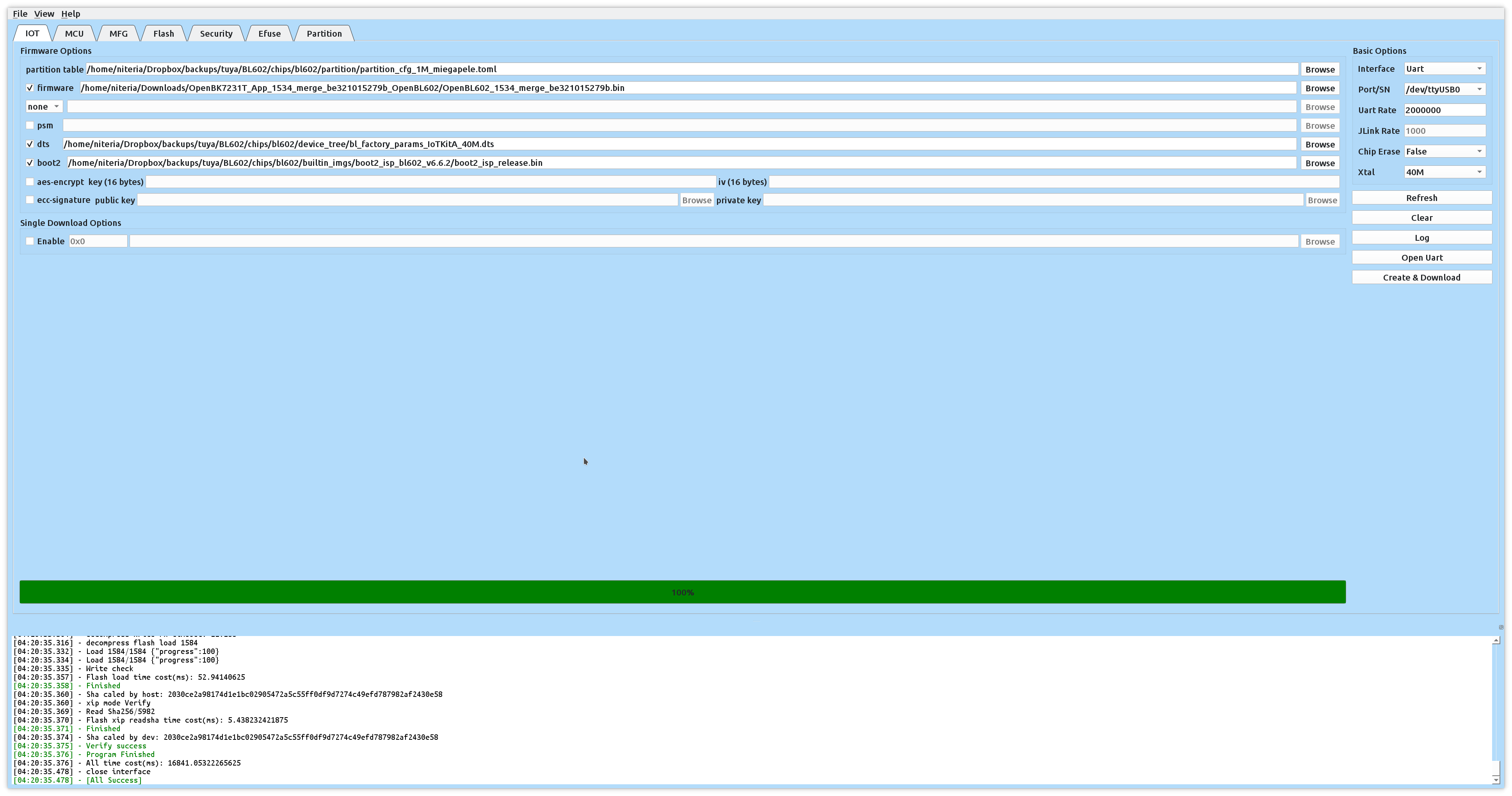

    cant find toml you guys using ;)
    wrote it with default one, but no response
    [00:36:58.248] - Erase flash from 0xe000 to 0xe0a3
    [00:36:58.268] - erase pending
    [00:36:58.378] - Erase time cost(ms): 130.1845703125
    [00:36:58.397] - Load 164/164 {"progress":100}
    [00:36:58.397] - Write check
    [00:36:58.415] - Flash load time cost(ms): 19.885498046875
    [00:36:58.416] - Finished
    [00:36:58.417] - Sha caled by host: c88b2a83541a724172d14a153d613705803436a54b93e75d55325bb8659df0da
    [00:36:58.417] - xip mode Verify
    [00:36:58.418] - Read Sha256/164
    [00:36:58.419] - Flash xip readsha time cost(ms): 1.999755859375
    [00:36:58.420] - Finished
    [00:36:58.420] - Sha caled by dev: c88b2a83541a724172d14a153d613705803436a54b93e75d55325bb8659df0da
    [00:36:58.421] - Verify success

    plus - mine looks like have Boot mode all the time, i shorted io8 to 3v3 just once, since then any power-off-on is still in boot mode - fw doesnt load.
    also no logs
    [00:44:21.262] - Flash load shake hand
    [00:44:21.303] - default set DTR high
    [00:44:21.406] - clean buf
    [00:44:21.440] - send sync
    [00:44:21.654] - ack is 4f4b
    [00:44:25.732] - Not ack OK
    [00:44:25.732] - FL
    [00:44:25.734] - Read log
    [00:44:25.735] - Read Fail

    >>21439908
    I would try different wifi device, different protection settings, different MPF settings, also try simple password with only letters, somebody had issues with some symbols somewhere.
    >>21439979
    Toml file is posted in post #20 in this thread. Not sure if it's really required.
    But it it boots to bootloader I would look for short with multimeter first.

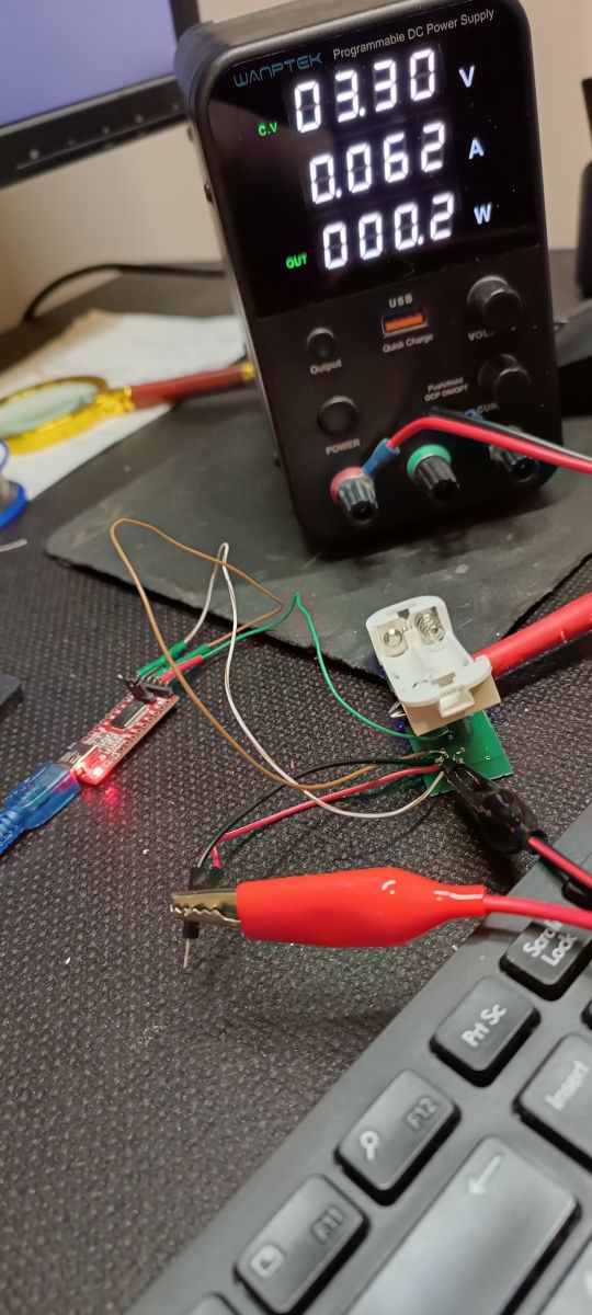

  • #70 21440257
    chemik_16
    Posts: 1000
    Help: 75
    Rate: 128
    >>21440030
    got 133ohm to the ground from that pin. Had 8k earlier if i remember correctly. maybe connecting 3v3 directly burned pullup.
  • #71 21440260
    Posts: 5108
    Help: 441
    Rate: 902
    10k resistor should be between 3.3v and IO8 for uart download mode
    #72 21440301

  • #74 21440354
    chemik_16
    Posts: 1000
    Help: 75
    Rate: 128
    >>21440260
    then mine is bricked, got 3.1V there when powered on, when off as said 133om to ground.
    just shortened it to the ground for test, now i got 540ohm and no longer im in download mode (0.001V now), now i have to pull 3v3 to flash it.
    Anyway, cant see it booting, is there any log on serial ? what boundrate ? its silent for me.
    just opening com, powercycle, nothing.

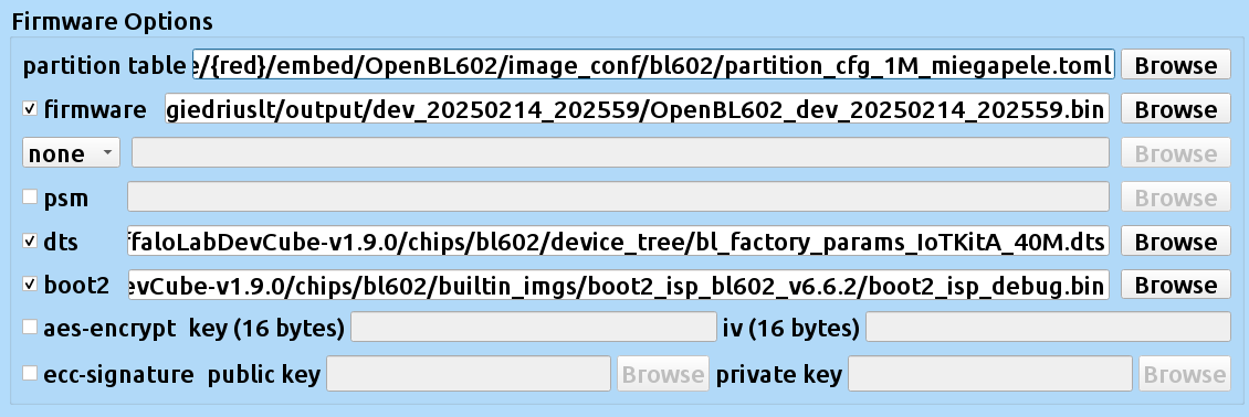

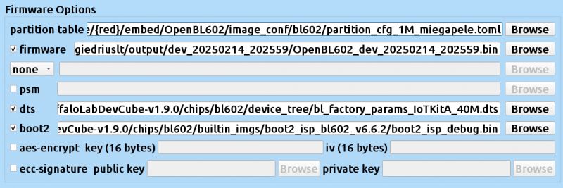

    >>21440260 Not really, found that even without that 10k it still enters download mode and successfully flashes.
    Added after 11 [minutes]:
    Attached toml I'm using, on standard 1M one it has issues.
    After reboot:
    • partition_cfg_1M_miegapele.zip (561 Bytes) You must be logged in to download this attachment.

    Yes, Open wifi is not working I tested that while porting, I think it might be possible to make it work, but did not try.
    While porting I had to set some PMF setting on the connect call to make connection reliable. Maybe you can try changing PMF on your router if It has such ability:
    It worked I think with all options for me.
    Wireless network security configuration on a router.
    Also try maybe WPA1 or WPA3.

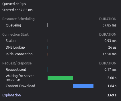

    Idk what changed but it connected today. Doesn't matter what 802.11w MFP setting is on AP (Optional on mine).
    Wifi SNR is pretty good.
    Wi-Fi signal parameters: signal strength -53/-95 dBm, speeds 6.0 Mbit/s and 72.2 Mbit/s at 20 MHz band, MCS 7, Short GI.
    It doesn't feel stable tho. Requests are often timing out. Sometimes responses are incomplete. Can't create autoexec, gpio finder loaded properly only once and it basically kills it with loads of /api/pins requests ... after maybe 5 it stops responding. It is slightly faster after fresh reboot.
    Configuration page for the OpenBL602_FD438A7F module with several configuration options.
    Network loading time statistics
    Screenshot of browser developer tools showing network details for 192.168.0.166/api/lfs/autoexec.bat.
    Screen area with the text drop file(s) or .tar here and file saving messages.
    Screenshot of the Network tab in browser developer tools showing various HTTP requests to IP 192.168.0.166.
    Notice that after Time 550 it stops managing memory ?
    After this it goes dark, you have to reboot it to access it again.
    While writing this post and after it went dark, uart log recorded this:

  • #81 21442277
    maxim2002
    Posts: 46
    Rate: 12
    I'm on kinna external psu already. Pretty sure it's stable.
    Programmable DC power supply connected to an electronic circuit on a desk.
  • #82 21442289
    miegapele
    Posts: 173
    Help: 15
    Rate: 29
    >>21442277
    That's nothing to do with any PSU issues, any computer can power such module. Much more likely it has something to do with noise coupled from the computer. You cannot avoid that unless you don't connect to a computer :) Also you might want to move the module away from the computer too for testing

    Powered it from fresh batteries and disconnected from everything. Stopped registering on ap. Tried a couple of times.
  • #85 21443050
    maxim2002
    Posts: 46

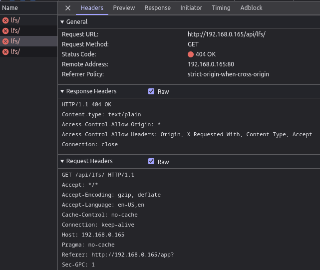

    Rate: 12
    Batteries hold at 3.37V. Reflashed with updated partition table. Disabled 802.11w MFP on AP. Put closer to AP (the only emf it gets comes from AP). Connected after 3rd attempt. Same behavior, gpio finder kills it. Wireshark tells what we already know.
    Screenshot of Wireshark showing TCP packets between IP addresses.
    Does the webserver api is complete in your port? I'm getting 404s on /api/lfs
    Screenshot of a developer tool showing headers for a failed HTTP request.
    Lmk if you have any suggestions what else could be checked.

    #89 21456497
    niterian
    Posts: 12
    This is amazing, I'm happy I stumbled into this topic, because even some recent posts gave no hope for BL602L10.
    I have: https://pl.aliexpress.com/item/1005005989938860.html
    Inside it looks exactly like: https://www.elektroda.com/rtvforum/topic4039283.html, but it has BL602L10 inside. Same pinout works for UART and flashing. Even has the same PCB text: XLD-QFLWP-YT2.1. No need to desolder the module.
    It flashed fine, connects to WiFi and saves to Flash with:
    * this TOML: https://www.elektroda.com/rtvforum/topic4086736.html#21432034 (partition_cfg_1M_miegapele.toml on the screenshot)
    * this build file: https://github.com/openshwprojects/OpenBK7231...ions/runs/13334744916/job/37247362962?pr=1534, direct link: https://github.com/openshwprojects/OpenBK7231...actions/runs/13334744916/artifacts/2594275994
    Settings in Buffalo Lab Dev Cube 1.9.0 (I did flash erase on that chip in the past, it's not selected here):
    Microcontroller management program interface.
    Flashing log:

    [04:20:22.478] - xip mode Verify
    [04:20:22.496] - Read Sha256/47808
    [04:20:22.497] - Flash xip readsha time cost(ms): 16.4189453125
    [04:20:22.497] - Finished
    [04:20:22.500] - Sha caled by dev: 2f44f91873a18ff35cf93ab5a35dcde41ab8f075e21af450e904699bdabb0c01
    [04:20:22.500] - Verify success
    [04:20:22.501] - Dealing Index 1
    [04:20:22.501] - ========= programming chips/bl602/partition/partition.bin to 0x0000E000
    [04:20:22.510] - ========= flash load =========
    [04:20:22.511] - ========= flash erase =========
    [04:20:22.511] - Erase flash from 0xe000 to 0xe0a3
    [04:20:22.515] - erase pending
    [04:20:22.593] - Erase time cost(ms): 82.110595703125
    [04:20:22.598] - Load 164/164 {"progress":100}
    [04:20:22.599] - Write check
    [04:20:22.604] - Flash load time cost(ms): 9.484619140625
    [04:20:22.604] - Finished
    [04:20:22.605] - Sha caled by host: 439c9bf16a27c6fdc62c57ec66b454793f14fb495587ee44764d067d0fd79e56
    [04:20:22.605] - xip mode Verify
    [04:20:22.612] - Read Sha256/164
    [04:20:22.613] - Flash xip readsha time cost(ms): 4.6552734375
    [04:20:22.613] - Finished
    [04:20:22.616] - Sha caled by dev: 439c9bf16a27c6fdc62c57ec66b454793f14fb495587ee44764d067d0fd79e56
    [04:20:22.616] - Verify success
    [04:20:22.623] - Dealing Index 2
    [04:20:22.623] - ========= programming chips/bl602/partition/partition.bin to 0x0000F000
    [04:20:22.636] - ========= flash load =========
    [04:20:22.637] - ========= flash erase =========
    [04:20:22.637] - Erase flash from 0xf000 to 0xf0a3
    [04:20:22.640] - erase pending
    [04:20:22.724] - Erase time cost(ms): 86.76123046875
    [04:20:22.729] - Load 164/164 {"progress":100}
    [04:20:22.730] - Load 164/164 {"progress":100}
    [04:20:22.730] - Write check
    [04:20:22.733] - Flash load time cost(ms): 8.04736328125
    [04:20:22.734] - Finished
    [04:20:22.735] - Sha caled by host: 439c9bf16a27c6fdc62c57ec66b454793f14fb495587ee44764d067d0fd79e56
    [04:20:22.736] - xip mode Verify
    [04:20:22.746] - Read Sha256/164
    [04:20:22.747] - Flash xip readsha time cost(ms): 6.9384765625
    [04:20:22.748] - Finished
    [04:20:22.751] - Sha caled by dev: 439c9bf16a27c6fdc62c57ec66b454793f14fb495587ee44764d067d0fd79e56
    [04:20:22.752] - Verify success
    [04:20:22.754] - Dealing Index 3
    [04:20:22.756] - ========= programming /home/niteria/Dropbox/backups/tuya/BL602/chips/bl602/img_create_iot/whole_img.bin to 0x00010000
    [04:20:22.775] - ========= flash load =========
    [04:20:22.777] - ========= flash erase =========
    [04:20:22.777] - Erase flash from 0x10000 to 0xd1bbf
    [04:20:22.780] - erase pending
    [04:20:23.439] - erase pending
    [04:20:24.085] - erase pending
    [04:20:24.714] - erase pending
    [04:20:25.336] - erase pending
    [04:20:25.943] - erase pending
    [04:20:26.545] - erase pending
    [04:20:27.127] - erase pending
    [04:20:27.760] - erase pending
    [04:20:28.390] - erase pending
    [04:20:29.001] - erase pending
    [04:20:29.595] - erase pending
    [04:20:30.168] - erase pending
    [04:20:30.219] - erase pending
    [04:20:30.289] - Erase time cost(ms): 7511.48779296875
    [04:20:30.290] - decompress write rx timeout: 12.288
    [04:20:30.470] - decompress flash load 438776
    [04:20:30.486] - Load 2048/438776 {"progress":0}
    [04:20:30.511] - Load 4096/438776 {"progress":0}
    [04:20:30.528] - Load 6144/438776 {"progress":1}
    [04:20:30.548] - Load 8192/438776 {"progress":1}
    [04:20:30.568] - Load 10240/438776 {"progress":2}
    [04:20:30.588] - Load 12288/438776 {"progress":2}
    [04:20:30.604] - Load 14336/438776 {"progress":3}
    [04:20:30.624] - Load 16384/438776 {"progress":3}
    [04:20:30.644] - Load 18432/438776 {"progress":4}
    [04:20:30.664] - Load 20480/438776 {"progress":4}
    [04:20:30.685] - Load 22528/438776 {"progress":5}
    [04:20:30.705] - Load 24576/438776 {"progress":5}
    [04:20:30.725] - Load 26624/438776 {"progress":6}
    [04:20:30.746] - Load 28672/438776 {"progress":6}
    [04:20:30.766] - Load 30720/438776 {"progress":7}
    [04:20:30.786] - Load 32768/438776 {"progress":7}
    [04:20:30.806] - Load 34816/438776 {"progress":7}
    [04:20:30.822] - Load 36864/438776 {"progress":8}
    [04:20:30.842] - Load 38912/438776 {"progress":8}
    [04:20:30.862] - Load 40960/438776 {"progress":9}
    [04:20:30.882] - Load 43008/438776 {"progress":9}
    [04:20:30.898] - Load 45056/438776 {"progress":10}
    [04:20:30.918] - Load 47104/438776 {"progress":10}
    [04:20:30.938] - Load 49152/438776 {"progress":11}
    [04:20:30.958] - Load 51200/438776 {"progress":11}
    [04:20:30.978] - Load 53248/438776 {"progress":12}
    [04:20:30.994] - Load 55296/438776 {"progress":12}
    [04:20:31.015] - Load 57344/438776 {"progress":13}
    [04:20:31.035] - Load 59392/438776 {"progress":13}
    [04:20:31.055] - Load 61440/438776 {"progress":14}
    [04:20:31.075] - Load 63488/438776 {"progress":14}
    [04:20:31.091] - Load 65536/438776 {"progress":14}
    [04:20:31.111] - Load 67584/438776 {"progress":15}
    [04:20:31.131] - Load 69632/438776 {"progress":15}
    [04:20:31.151] - Load 71680/438776 {"progress":16}
    [04:20:31.171] - Load 73728/438776 {"progress":16}
    [04:20:31.191] - Load 75776/438776 {"progress":17}
    [04:20:31.212] - Load 77824/438776 {"progress":17}
    [04:20:31.232] - Load 79872/438776 {"progress":18}
    [04:20:31.248] - Load 81920/438776 {"progress":18}
    [04:20:31.268] - Load 83968/438776 {"progress":19}
    [04:20:31.288] - Load 86016/438776 {"progress":19}
    [04:20:31.308] - Load 88064/438776 {"progress":20}
    [04:20:31.328] - Load 90112/438776 {"progress":20}
    [04:20:31.348] - Load 92160/438776 {"progress":21}
    [04:20:31.368] - Load 94208/438776 {"progress":21}
    [04:20:31.389] - Load 96256/438776 {"progress":21}
    [04:20:31.409] - Load 98304/438776 {"progress":22}
    [04:20:31.430] - Load 100352/438776 {"progress":22}
    [04:20:31.450] - Load 102400/438776 {"progress":23}
    [04:20:31.470] - Load 104448/438776 {"progress":23}
    [04:20:31.490] - Load 106496/438776 {"progress":24}
    [04:20:31.510] - Load 108544/438776 {"progress":24}
    [04:20:31.530] - Load 110592/438776 {"progress":25}
    [04:20:31.551] - Load 112640/438776 {"progress":25}
    [04:20:31.570] - Load 114688/438776 {"progress":26}
    [04:20:31.586] - Load 116736/438776 {"progress":26}
    [04:20:31.606] - Load 118784/438776 {"progress":27}
    [04:20:31.626] - Load 120832/438776 {"progress":27}
    [04:20:31.646] - Load 122880/438776 {"progress":28}
    [04:20:31.663] - Load 124928/438776 {"progress":28}
    [04:20:31.683] - Load 126976/438776 {"progress":28}
    [04:20:31.703] - Load 129024/438776 {"progress":29}
    [04:20:31.723] - Load 131072/438776 {"progress":29}
    [04:20:31.744] - Load 133120/438776 {"progress":30}
    [04:20:31.764] - Load 135168/438776 {"progress":30}
    [04:20:31.784] - Load 137216/438776 {"progress":31}
    [04:20:31.804] - Load 139264/438776 {"progress":31}
    [04:20:31.822] - Load 141312/438776 {"progress":32}
    [04:20:31.842] - Load 143360/438776 {"progress":32}
    [04:20:31.862] - Load 145408/438776 {"progress":33}
    [04:20:31.882] - Load 147456/438776 {"progress":33}
    [04:20:31.902] - Load 149504/438776 {"progress":34}
    [04:20:31.922] - Load 151552/438776 {"progress":34}
    [04:20:31.939] - Load 153600/438776 {"progress":35}
    [04:20:31.959] - Load 155648/438776 {"progress":35}
    [04:20:31.979] - Load 157696/438776 {"progress":35}
    [04:20:31.999] - Load 159744/438776 {"progress":36}
    [04:20:32.019] - Load 161792/438776 {"progress":36}
    [04:20:32.035] - Load 163840/438776 {"progress":37}
    [04:20:32.055] - Load 165888/438776 {"progress":37}
    [04:20:32.075] - Load 167936/438776 {"progress":38}
    [04:20:32.095] - Load 169984/438776 {"progress":38}
    [04:20:32.115] - Load 172032/438776 {"progress":39}
    [04:20:32.131] - Load 174080/438776 {"progress":39}
    [04:20:32.152] - Load 176128/438776 {"progress":40}
    [04:20:32.172] - Load 178176/438776 {"progress":40}
    [04:20:32.192] - Load 180224/438776 {"progress":41}
    [04:20:32.212] - Load 182272/438776 {"progress":41}
    [04:20:32.228] - Load 184320/438776 {"progress":42}
    [04:20:32.248] - Load 186368/438776 {"progress":42}
    [04:20:32.268] - Load 188416/438776 {"progress":42}
    [04:20:32.288] - Load 190464/438776 {"progress":43}
    [04:20:32.305] - Load 192512/438776 {"progress":43}
    [04:20:32.325] - Load 194560/438776 {"progress":44}
    [04:20:32.345] - Load 196608/438776 {"progress":44}
    [04:20:32.365] - Load 198656/438776 {"progress":45}
    [04:20:32.384] - Load 200704/438776 {"progress":45}
    [04:20:32.404] - Load 202752/438776 {"progress":46}
    [04:20:32.424] - Load 204800/438776 {"progress":46}
    [04:20:32.444] - Load 206848/438776 {"progress":47}
    [04:20:32.464] - Load 208896/438776 {"progress":47}
    [04:20:32.484] - Load 210944/438776 {"progress":48}
    [04:20:32.504] - Load 212992/438776 {"progress":48}
    [04:20:32.524] - Load 215040/438776 {"progress":49}
    [04:20:32.544] - Load 217088/438776 {"progress":49}
    [04:20:32.564] - Load 219136/438776 {"progress":49}
    [04:20:32.584] - Load 221184/438776 {"progress":50}
    [04:20:32.601] - Load 223232/438776 {"progress":50}
    [04:20:32.621] - Load 225280/438776 {"progress":51}
    [04:20:32.641] - Load 227328/438776 {"progress":51}
    [04:20:32.661] - Load 229376/438776 {"progress":52}
    [04:20:32.681] - Load 231424/438776 {"progress":52}
    [04:20:32.701] - Load 233472/438776 {"progress":53}
    [04:20:32.717] - Load 235520/438776 {"progress":53}
    [04:20:32.737] - Load 237568/438776 {"progress":54}
    [04:20:32.757] - Load 239616/438776 {"progress":54}
    [04:20:32.777] - Load 241664/438776 {"progress":55}
    [04:20:32.797] - Load 243712/438776 {"progress":55}
    [04:20:32.814] - Load 245760/438776 {"progress":56}
    [04:20:32.836] - Load 247808/438776 {"progress":56}
    [04:20:32.855] - Load 249856/438776 {"progress":56}
    [04:20:32.874] - Load 251904/438776 {"progress":57}
    [04:20:32.893] - Load 253952/438776 {"progress":57}
    [04:20:32.913] - Load 256000/438776 {"progress":58}
    [04:20:32.933] - Load 258048/438776 {"progress":58}
    [04:20:32.953] - Load 260096/438776 {"progress":59}
    [04:20:32.970] - Load 262144/438776 {"progress":59}
    [04:20:32.990] - Load 264192/438776 {"progress":60}
    [04:20:33.010] - Load 266240/438776 {"progress":60}
    [04:20:33.030] - Load 268288/438776 {"progress":61}
    [04:20:33.050] - Load 270336/438776 {"progress":61}
    [04:20:33.070] - Load 272384/438776 {"progress":62}
    [04:20:33.091] - Load 274432/438776 {"progress":62}
    [04:20:33.111] - Load 276480/438776 {"progress":63}
    [04:20:33.131] - Load 278528/438776 {"progress":63}
    [04:20:33.154] - Load 280576/438776 {"progress":63}
    [04:20:33.173] - Load 282624/438776 {"progress":64}
    [04:20:33.193] - Load 284672/438776 {"progress":64}
    [04:20:33.210] - Load 286720/438776 {"progress":65}
    [04:20:33.230] - Load 288768/438776 {"progress":65}
    [04:20:33.250] - Load 290816/438776 {"progress":66}
    [04:20:33.271] - Load 292864/438776 {"progress":66}
    [04:20:33.291] - Load 294912/438776 {"progress":67}
    [04:20:33.310] - Load 296960/438776 {"progress":67}
    [04:20:33.330] - Load 299008/438776 {"progress":68}
    [04:20:33.350] - Load 301056/438776 {"progress":68}
    [04:20:33.370] - Load 303104/438776 {"progress":69}
    [04:20:33.388] - Load 305152/438776 {"progress":69}
    [04:20:33.408] - Load 307200/438776 {"progress":70}
    [04:20:33.428] - Load 309248/438776 {"progress":70}
    [04:20:33.448] - Load 311296/438776 {"progress":70}
    [04:20:33.468] - Load 313344/438776 {"progress":71}
    [04:20:33.484] - Load 315392/438776 {"progress":71}
    [04:20:33.504] - Load 317440/438776 {"progress":72}
    [04:20:33.524] - Load 319488/438776 {"progress":72}
    [04:20:33.544] - Load 321536/438776 {"progress":73}
    [04:20:33.565] - Load 323584/438776 {"progress":73}
    [04:20:33.581] - Load 325632/438776 {"progress":74}
    [04:20:33.601] - Load 327680/438776 {"progress":74}
    [04:20:33.622] - Load 329728/438776 {"progress":75}
    [04:20:33.642] - Load 331776/438776 {"progress":75}
    [04:20:33.658] - Load 333824/438776 {"progress":76}
    [04:20:33.678] - Load 335872/438776 {"progress":76}
    [04:20:33.698] - Load 337920/438776 {"progress":77}
    [04:20:33.719] - Load 339968/438776 {"progress":77}
    [04:20:33.739] - Load 342016/438776 {"progress":77}
    [04:20:33.759] - Load 344064/438776 {"progress":78}
    [04:20:33.778] - Load 346112/438776 {"progress":78}
    [04:20:33.795] - Load 348160/438776 {"progress":79}
    [04:20:33.815] - Load 350208/438776 {"progress":79}
    [04:20:33.835] - Load 352256/438776 {"progress":80}
    [04:20:33.855] - Load 354304/438776 {"progress":80}
    [04:20:33.872] - Load 356352/438776 {"progress":81}
    [04:20:33.893] - Load 358400/438776 {"progress":81}
    [04:20:33.915] - Load 360448/438776 {"progress":82}
    [04:20:33.934] - Load 362496/438776 {"progress":82}
    [04:20:33.956] - Load 364544/438776 {"progress":83}
    [04:20:33.977] - Load 366592/438776 {"progress":83}
    [04:20:33.997] - Load 368640/438776 {"progress":84}
    [04:20:34.017] - Load 370688/438776 {"progress":84}
    [04:20:34.037] - Load 372736/438776 {"progress":84}
    [04:20:34.057] - Load 374784/438776 {"progress":85}
    [04:20:34.073] - Load 376832/438776 {"progress":85}
    [04:20:34.093] - Load 378880/438776 {"progress":86}
    [04:20:34.113] - Load 380928/438776 {"progress":86}
    [04:20:34.133] - Load 382976/438776 {"progress":87}
    [04:20:34.150] - Load 385024/438776 {"progress":87}
    [04:20:34.170] - Load 387072/438776 {"progress":88}
    [04:20:34.190] - Load 389120/438776 {"progress":88}
    [04:20:34.225] - Load 391168/438776 {"progress":89}
    [04:20:34.259] - Load 393216/438776 {"progress":89}
    [04:20:34.280] - Load 395264/438776 {"progress":90}
    [04:20:34.314] - Load 397312/438776 {"progress":90}
    [04:20:34.335] - Load 399360/438776 {"progress":91}
    [04:20:34.369] - Load 401408/438776 {"progress":91}
    [04:20:34.390] - Load 403456/438776 {"progress":91}
    [04:20:34.423] - Load 405504/438776 {"progress":92}
    [04:20:34.444] - Load 407552/438776 {"progress":92}
    [04:20:34.465] - Load 409600/438776 {"progress":93}
    [04:20:34.499] - Load 411648/438776 {"progress":93}
    [04:20:34.520] - Load 413696/438776 {"progress":94}
    [04:20:34.554] - Load 415744/438776 {"progress":94}
    [04:20:34.574] - Load 417792/438776 {"progress":95}
    [04:20:34.609] - Load 419840/438776 {"progress":95}
    [04:20:34.630] - Load 421888/438776 {"progress":96}
    [04:20:34.664] - Load 423936/438776 {"progress":96}
    [04:20:34.698] - Load 425984/438776 {"progress":97}
    [04:20:34.719] - Load 428032/438776 {"progress":97}
    [04:20:34.740] - Load 430080/438776 {"progress":98}
    [04:20:34.774] - Load 432128/438776 {"progress":98}
    [04:20:34.809] - Load 434176/438776 {"progress":98}
    [04:20:34.830] - Load 436224/438776 {"progress":99}
    [04:20:34.849] - Load 438272/438776 {"progress":99}
    [04:20:34.883] - Load 438776/438776 {"progress":100}
    [04:20:34.884] - Load 438776/438776 {"progress":100}
    [04:20:34.884] - Write check
    [04:20:34.895] - Flash load time cost(ms): 4604.290771484375
    [04:20:34.896] - Finished
    [04:20:34.903] - Sha caled by host: 8c9d52f4b076bee53f64217ec1942569402674466c4fdc8f4775c79df62d1b31
    [04:20:34.903] - xip mode Verify
    [04:20:35.124] - Read Sha256/793536
    [04:20:35.126] - Flash xip readsha time cost(ms): 219.52099609375
    [04:20:35.127] - Finished
    [04:20:35.130] - Sha caled by dev: 8c9d52f4b076bee53f64217ec1942569402674466c4fdc8f4775c79df62d1b31
    [04:20:35.131] - Verify success
    [04:20:35.132] - Dealing Index 4
    [04:20:35.133] - ========= programming chips/bl602/device_tree/ro_params.dtb to 0x000F1000
    [04:20:35.161] - ========= flash load =========
    [04:20:35.163] - ========= flash erase =========
    [04:20:35.164] - Erase flash from 0xf1000 to 0xf275d
    [04:20:35.167] - erase pending
    [04:20:35.231] - erase pending
    [04:20:35.304] - Erase time cost(ms): 139.348388671875
    [04:20:35.304] - decompress write rx timeout: 12.288
    [04:20:35.316] - decompress flash load 1584
    [04:20:35.332] - Load 1584/1584 {"progress":100}
    [04:20:35.334] - Load 1584/1584 {"progress":100}
    [04:20:35.335] - Write check
    [04:20:35.357] - Flash load time cost(ms): 52.94140625
    [04:20:35.358] - Finished
    [04:20:35.360] - Sha caled by host: 2030ce2a98174d1e1bc02905472a5c55ff0df9d7274c49efd787982af2430e58
    [04:20:35.360] - xip mode Verify
    [04:20:35.369] - Read Sha256/5982
    [04:20:35.370] - Flash xip readsha time cost(ms): 5.438232421875
    [04:20:35.371] - Finished
    [04:20:35.374] - Sha caled by dev: 2030ce2a98174d1e1bc02905472a5c55ff0df9d7274c49efd787982af2430e58
    [04:20:35.375] - Verify success
    [04:20:35.376] - Program Finished
    [04:20:35.376] - All time cost(ms): 16841.05322265625
    [04:20:35.478] - close interface
    [04:20:35.478] - [All Success]
    This is my second BL602, I had way easier time with this one:
    * soldered jump wires
    * breadboard I trust
    * power supply backed by AMS1117 https://botland.store/power-modules/1482-supp...ontact-plates-mb102-33v-5v-5904422300739.html
    * CH340G usb2uart
    EDIT: exactly the same config from https://www.elektroda.com/rtvforum/topic4039283.html works
    OpenBL602 user interface with LED settings and device information.
